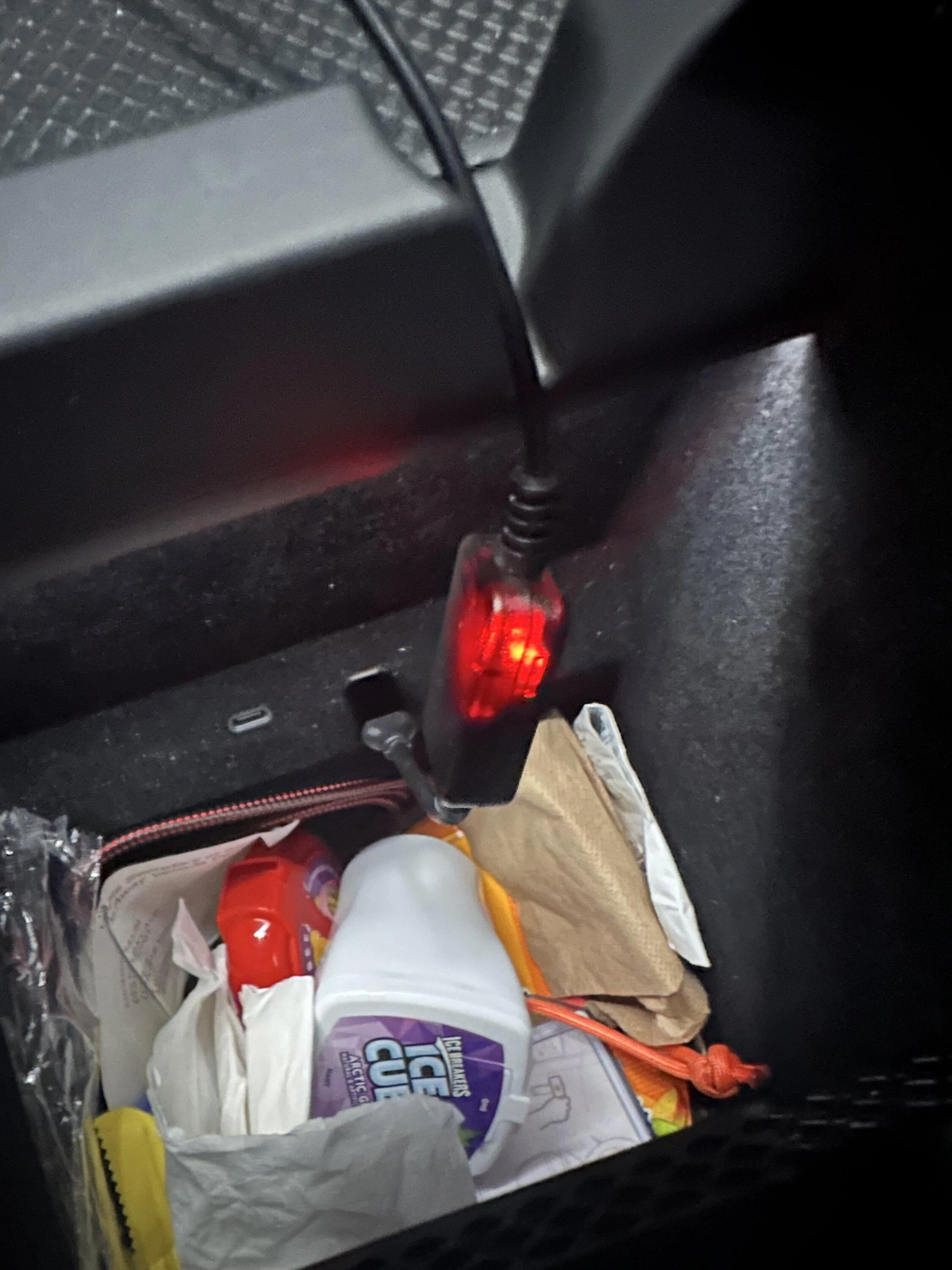

I ordered this usb-c to phone jack cable from the stickerfab just to check it out. It works when plugged in to the center console usb ports but not the ports in the back of the headrests- maybe these have a different power output? The cord is about 2 feet too short for any reasonable use in a Rivian, but I was ordering to have just as a backup for a loaner truck without a cigarette adapter.

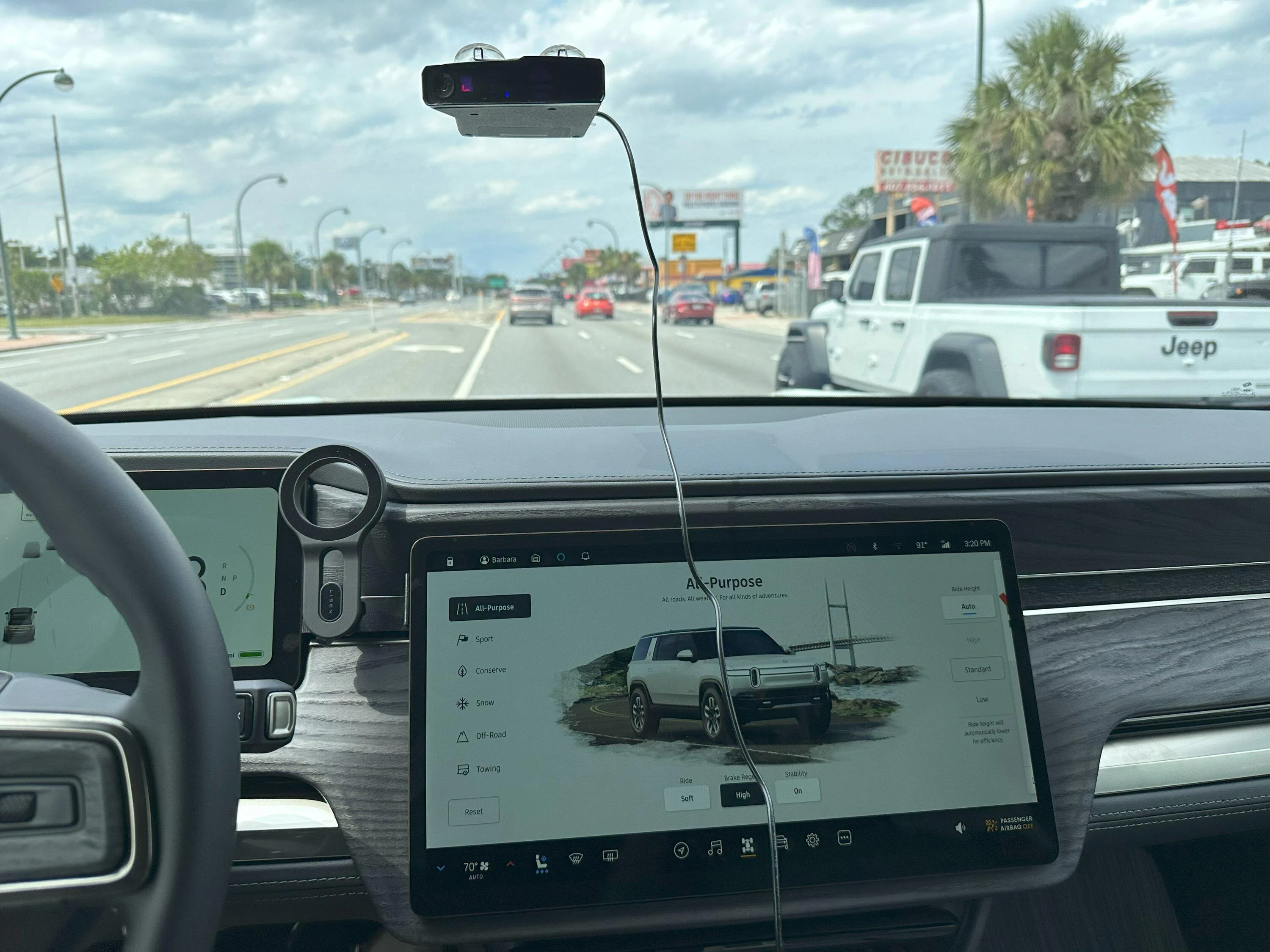

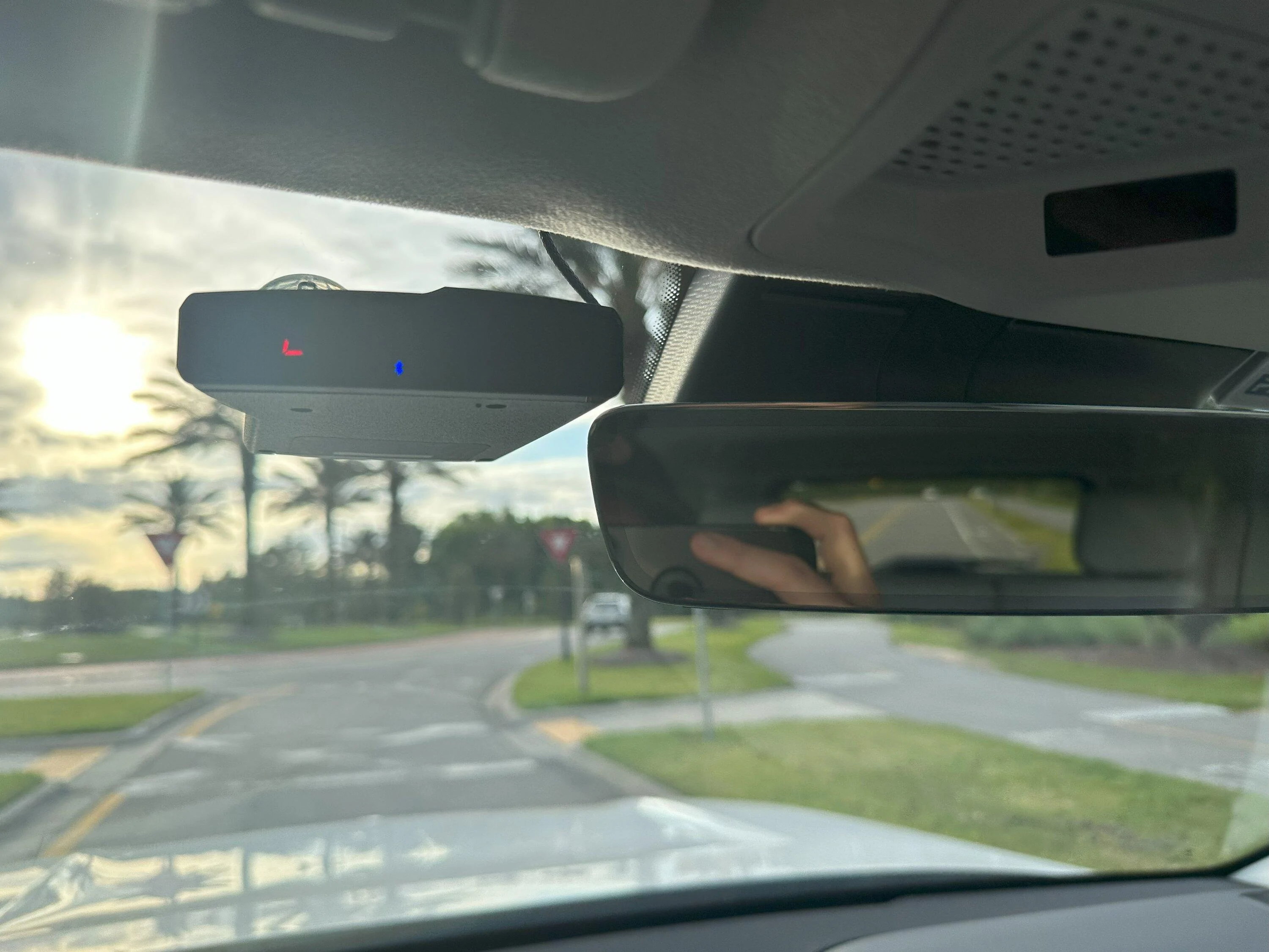

I installed my Uniden earlier this week using a pre-wired harness that taps the connector. The install is completely reversable and would leave no evidence the detector was ever installed.
I used 3M Dual Lock (clear plastic velcro like stuff used for FastPass, etc) on the windshield. There's already a wide cut-out in the front of the mirror panel that is more than adequate for bringing out the cable, but it seems like most are adding a hole near the mirror? Any particular reason for this? I think it's cleaner to bring the cable out the front, it's not really noticeable looking in the windshield.

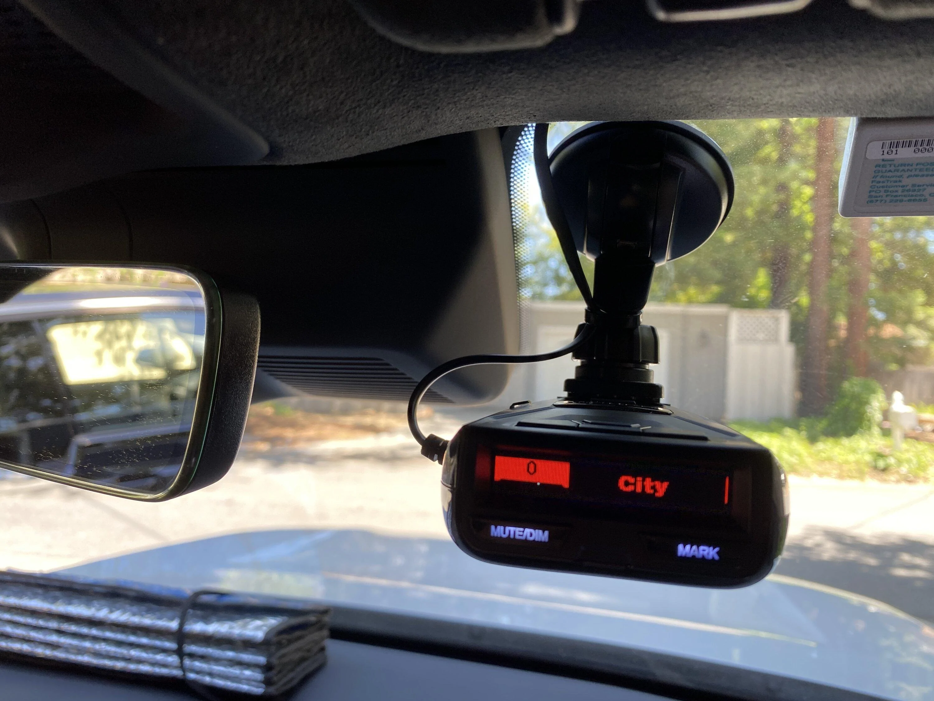

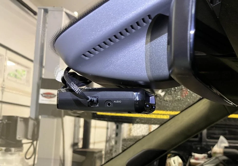

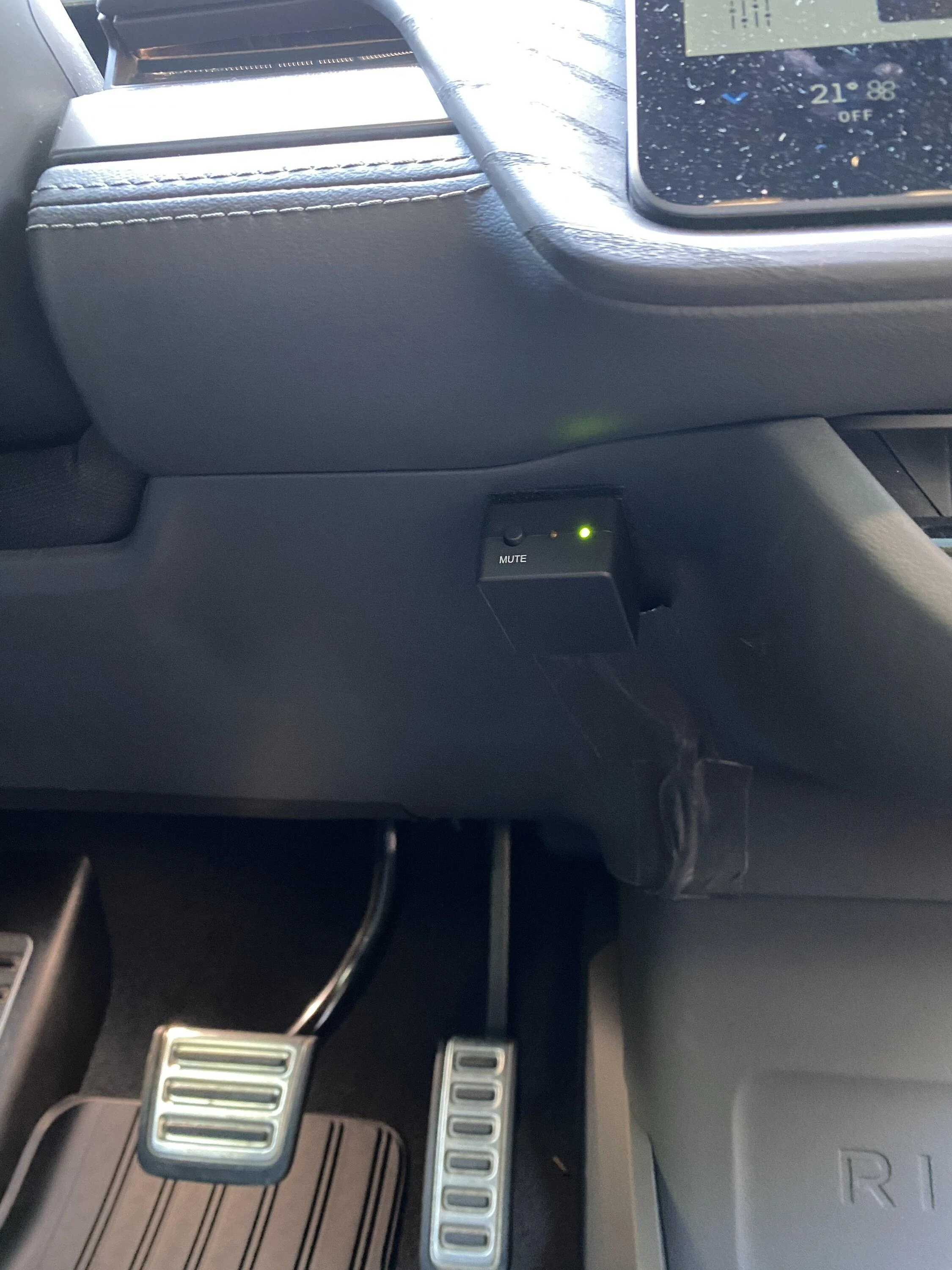

After seeing the poor built in dashcam quality I decided to install a regular dashcam. This meant relocating my radar detector.
I don't think anyone did this before and I thought it was kind of neat so here are the pics. So simple and works beautifully with my Uniden. The only button I hit on a regular basis is the mute which is on the side.

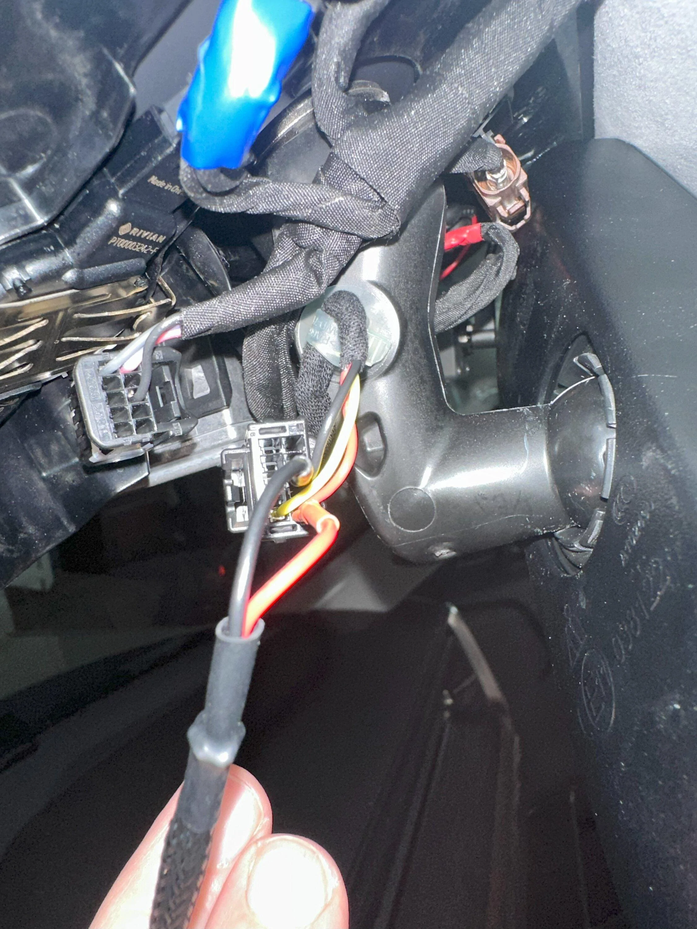

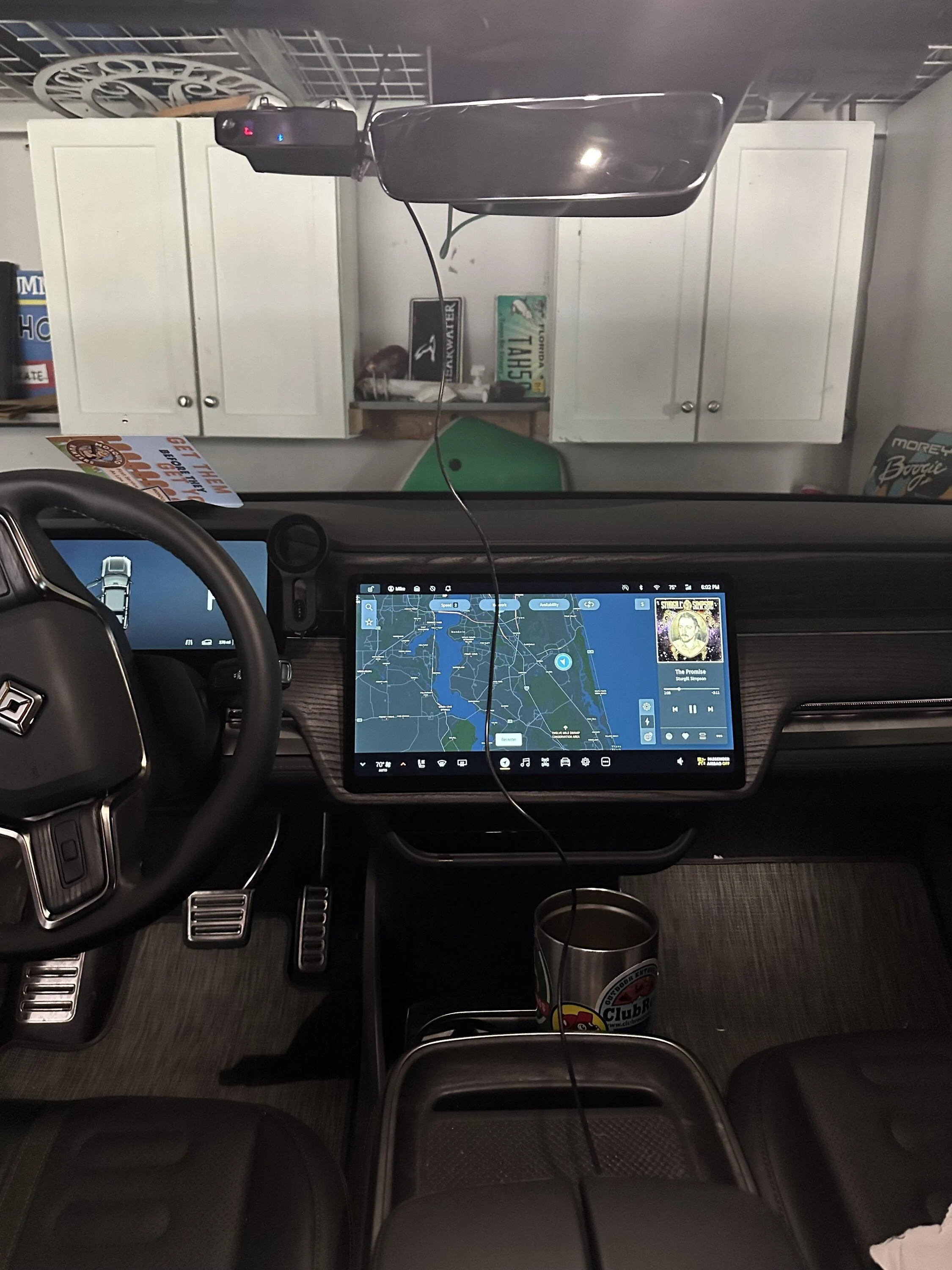

I just used these instructions again this morning for a hardwire. My new R1S is one without the underdash cigarette lighter plug, so on the two hour trip home from the delivery center I had to use the usb-C to telephone plug that is referenced in another thread. It worked, but I knew I had to hardwire immediately, which I did the morning of day two of ownership. Thanks again to all who have posted. It seemed a little more difficult this time to get the taps into the wire harness. But after some patience and some careful work with needlenose pliers all is good. Thanks to someone earlier in this thread for recommending the V1 app for iphone - definitely a game changer.

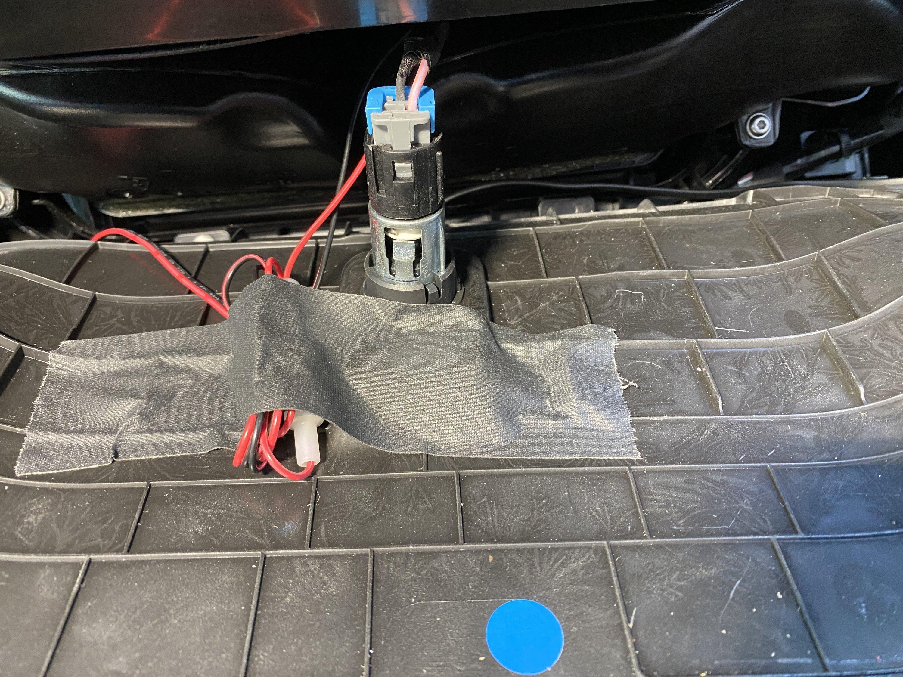

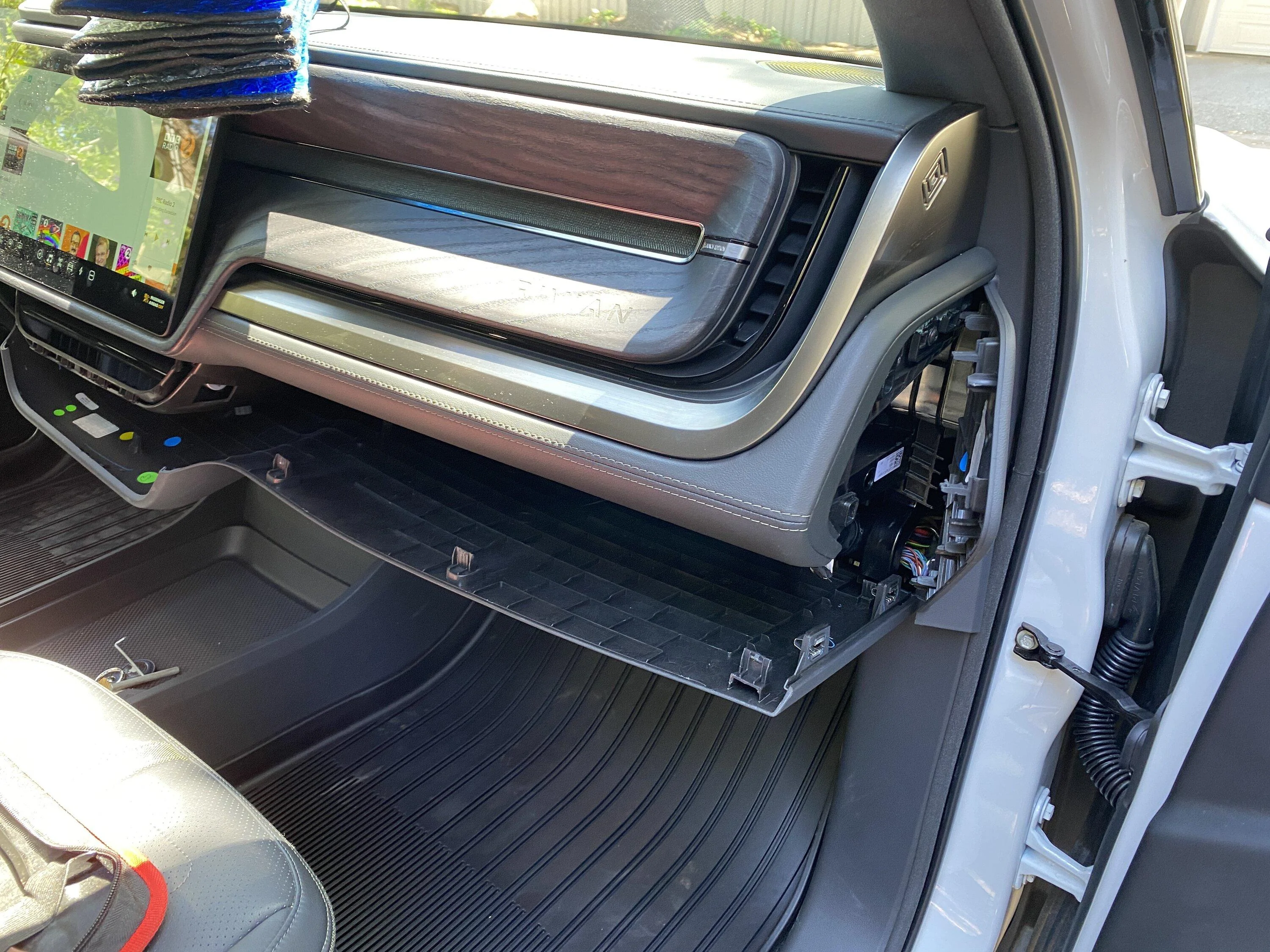

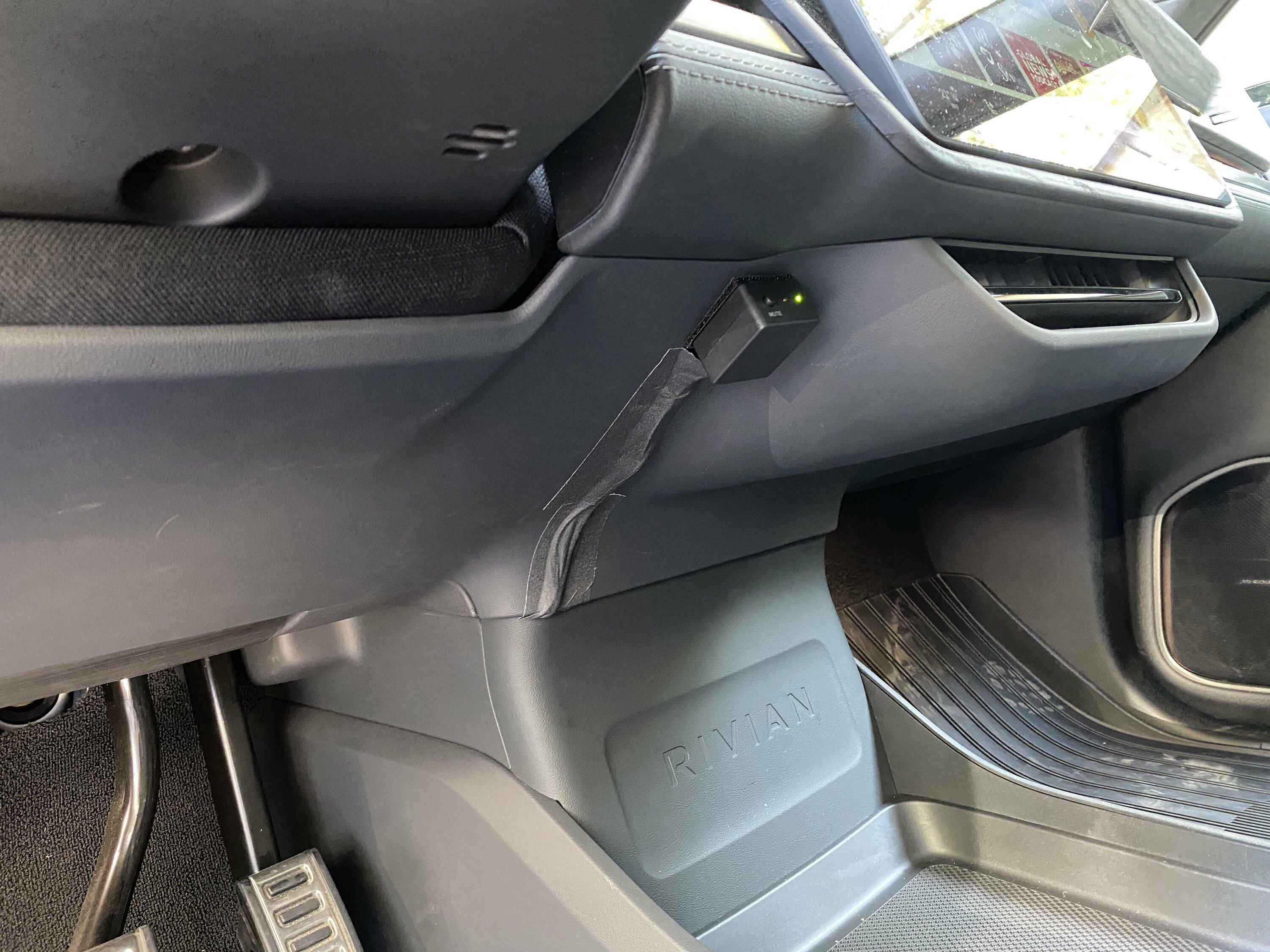

I don't like the mirror option for my Uniden R3 as those could be ADAS sensor wires which were not expecting other traffic or specced for random additional loads, and I also wanted the remote mute switch under the dashboard by my knees.
I hardwired from the central 12V cigarette lighter socket, then ran the cables inside the dash, up the passenger A pillar trim then behind the roof liner. Took an hour from start to finish. I left enough coiled cable up by the mirror so I can relocate the unit to a mirror mount should one later become available.
I tapped into the positive and negative cables by peeling back a little insulation, wrapping the Uniden power cable around it and soldering them together. Sealed with heatshrink then automotive insulation tape. (I still need to replace the grey tape covering the wires to the remote mute switch, as it wrinkled when I put it on.)
The unit turns itself on when I open the door and powers itself down a minute after I lock the truck.
