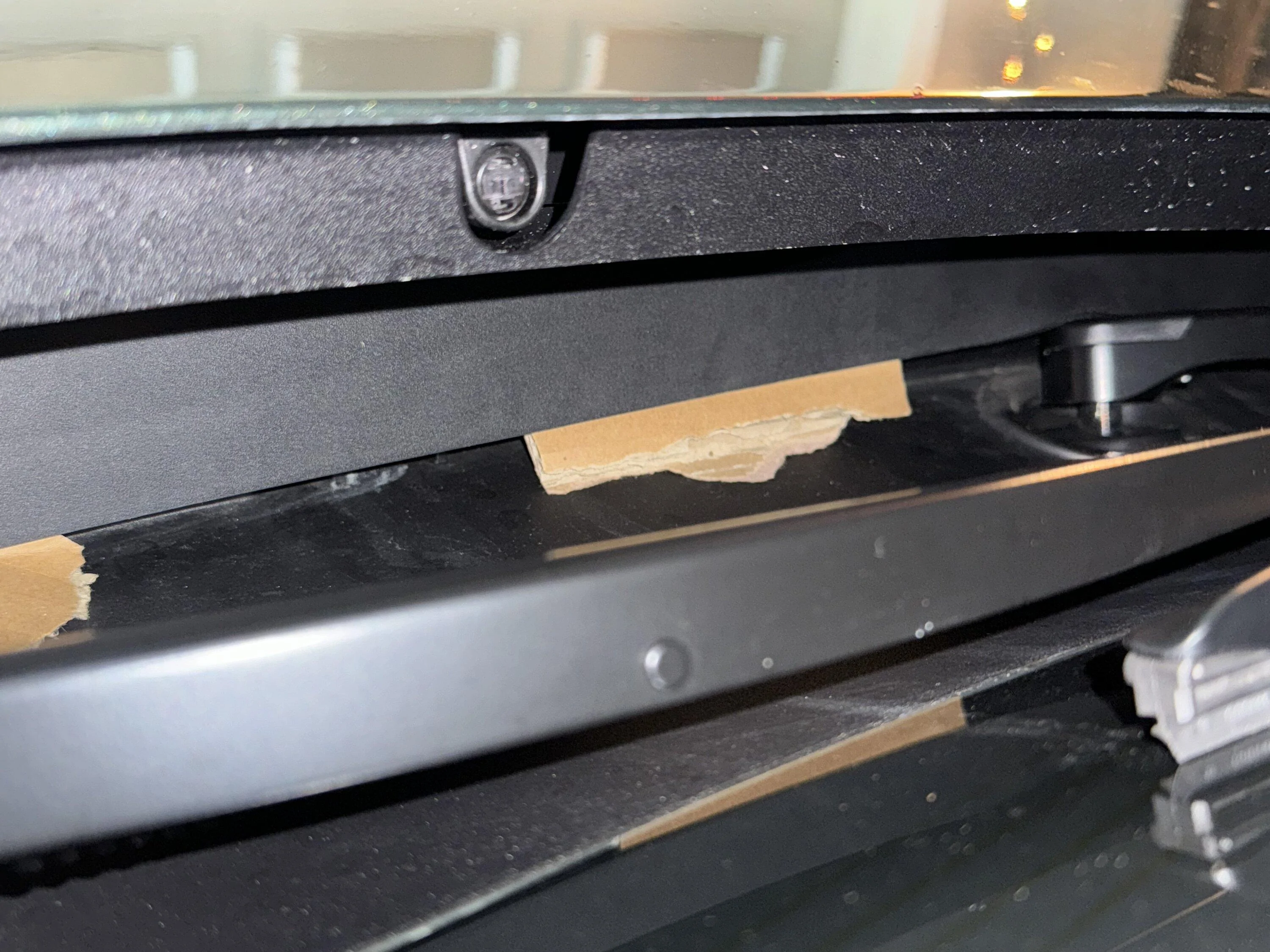

Found the culprit. It’s the rubbery cover of the vens under the hood, it has a flap that is not fully flush and flaps in mid speeds. I put some cardboard there just to try out and noise is gone. at least I can tell service exactly what the issue is.
Try to remove and reinstall the cover it may snap into place. You can watch rivian air cleaner replacement videos to see how the cover is supposed to be removed and reinstalled. Go to 4:30 on this video for removal
