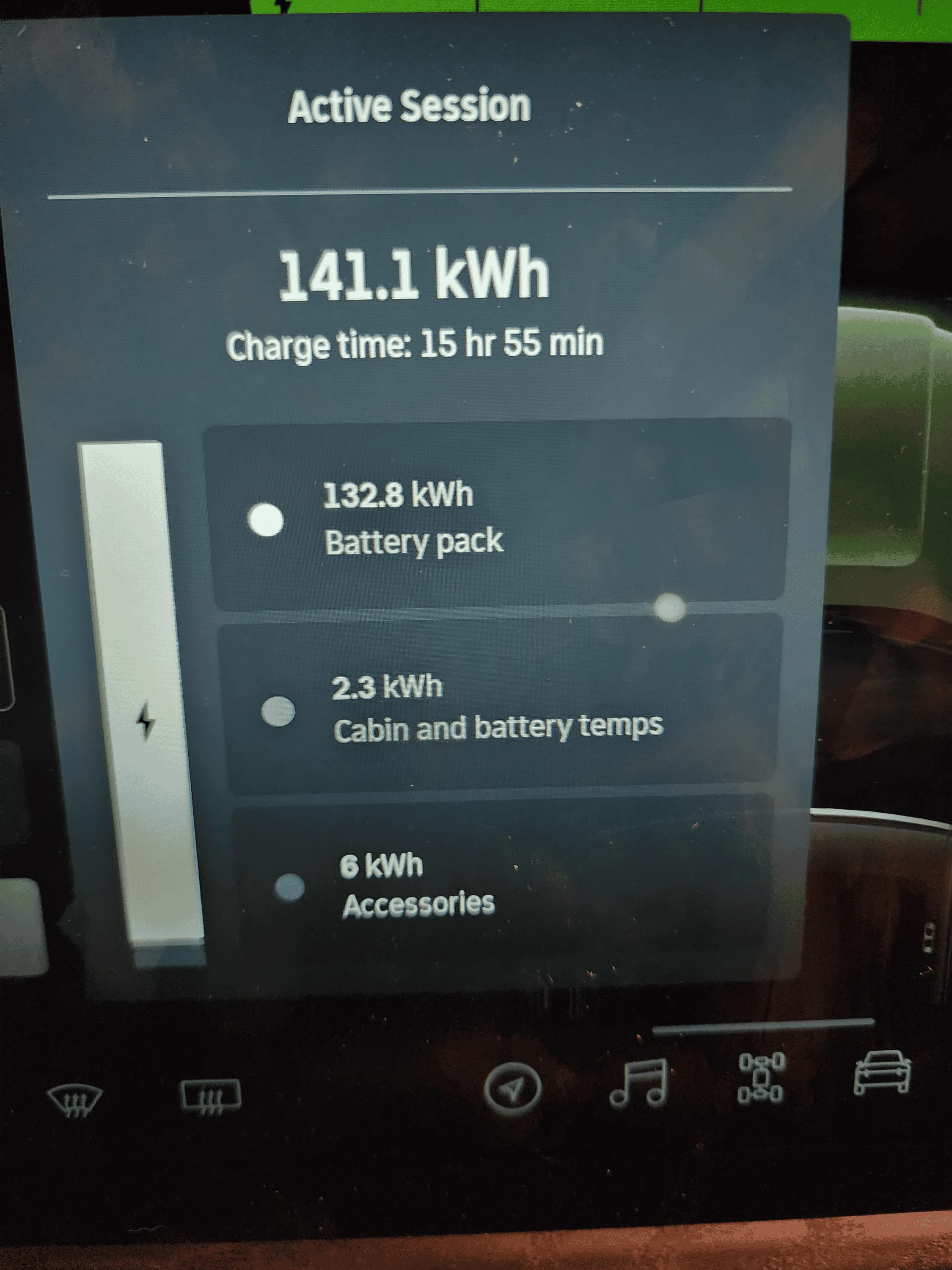

Had my dual motor for 3 weeks or so. Haven't been able to drive it much, the return trip I went from 100 percent to 23 on a 237 mile trip, 75 percent freeway where I was going 80mph. I did have ideal conditions with a 12mpg tailwind the whole way and Temps were 72 degrees so didn't need any cabin cooling or heating. I loved the range as I've taken this trip many times before and always had to charge mid way.
Off road I cannot compare it to the quad but the instant torque is incredible, handled deep ruts and wet slimey hillsides no problem. Hope to do some more 4 wheeling in the u.p. soon. Pass poor mpg on screens hot is due to lots of phantom drain.

MissGoElectric shared her new DCFC experience from 1% of SoC.
Some good charging curve info here. I’m impressed she got 287 miles of range back in 38 minutes of charging!
"As you can see via the session breakdown, 135kWh went to the battery.
@Rivian was quoted saying the pack was 149kWh.. I arrived at 1%.."

How long does it take a Large Pack to get 287 miles of range from 1% SoC?
More than 38 min? Less?
To me, this would be the most useful stat to know. I’m rarely going to be charging to full 100% (which also takes forever).

Really just depends on what you are factoring kWh/mi at?
Edit to add
Way more than 38 minutes for 287 miles of range, on 7/29 i charged at the Front Royal, VA RAN arriving at 4% and charged too 93% and Rivian says i added 111 kWh at 252 miles of range in 1 hr 3 min.
Edit to add
To clarify, are your stats on 7/29 for a large pack or max pack?
Large pack, 20" wheels.
So they are guessing my efficiency at 2.27. Which is worse than i was getting on that trip because i had all seasons on.
I just drove up from Houston, Texas to western NY and i averaged 1.91 the standard A/T's.
The first picture is my trip meter when i arrived at the RAN on 7/29
