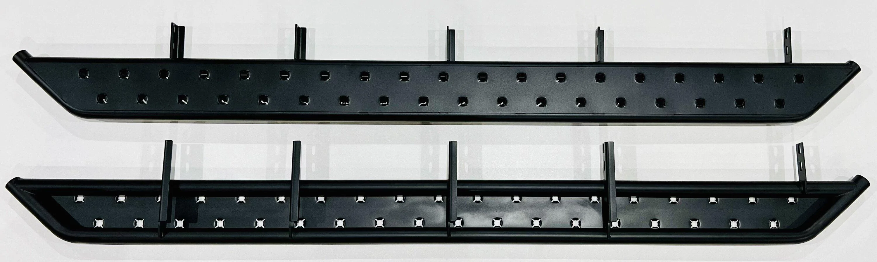

I got a few photos together of the underside and the basic steps for install so you know what you'd be looking at. We are working on an install video too. I'll get more specs like weight and clearance height for the doors, and post that info once I have it. Here is what I have right now @Chris TX @Stevetom84 @iansriv @Ademarog @TPL @davew Thanks!
Here is photo showing top and underside of the running boards.

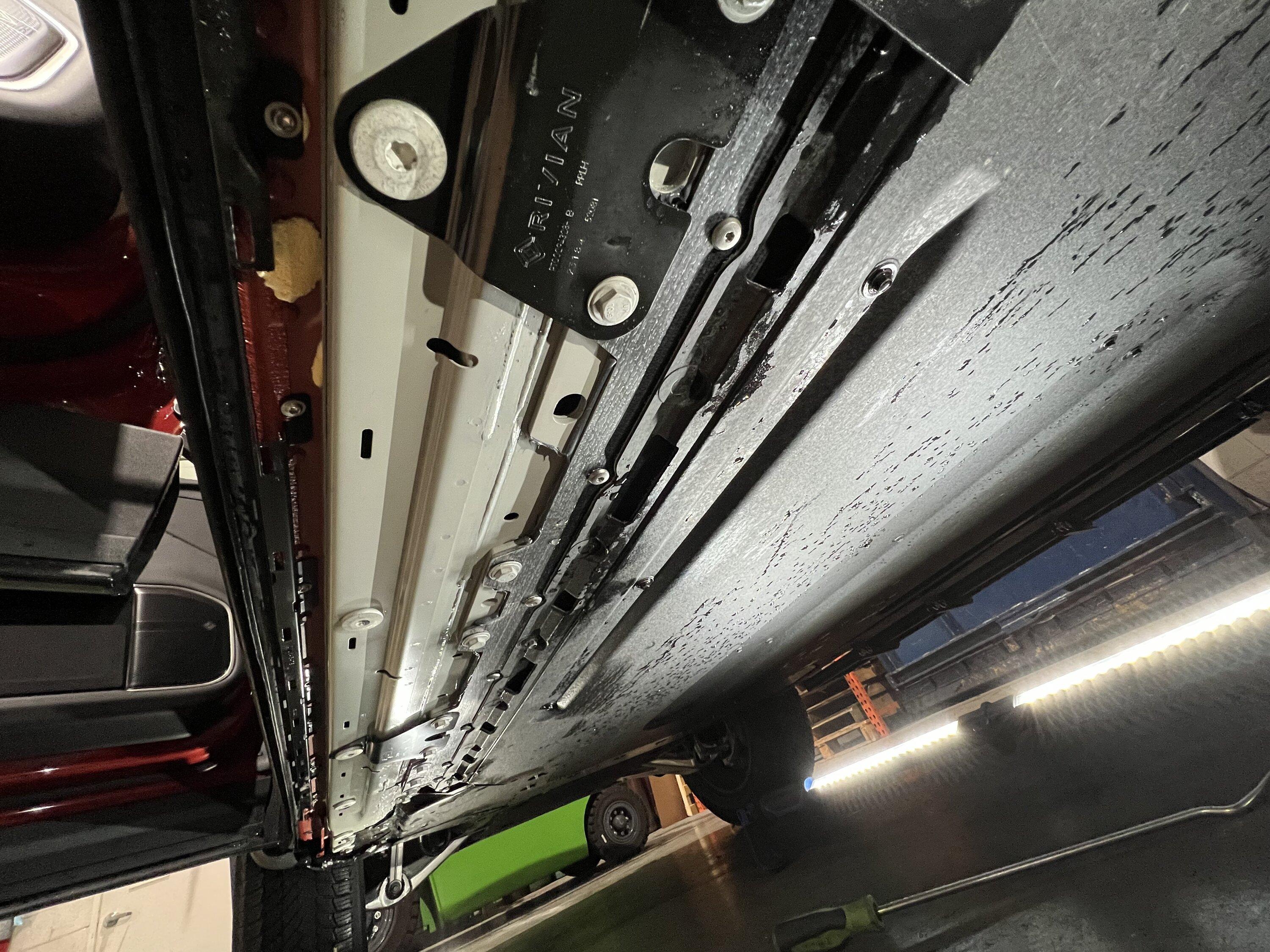

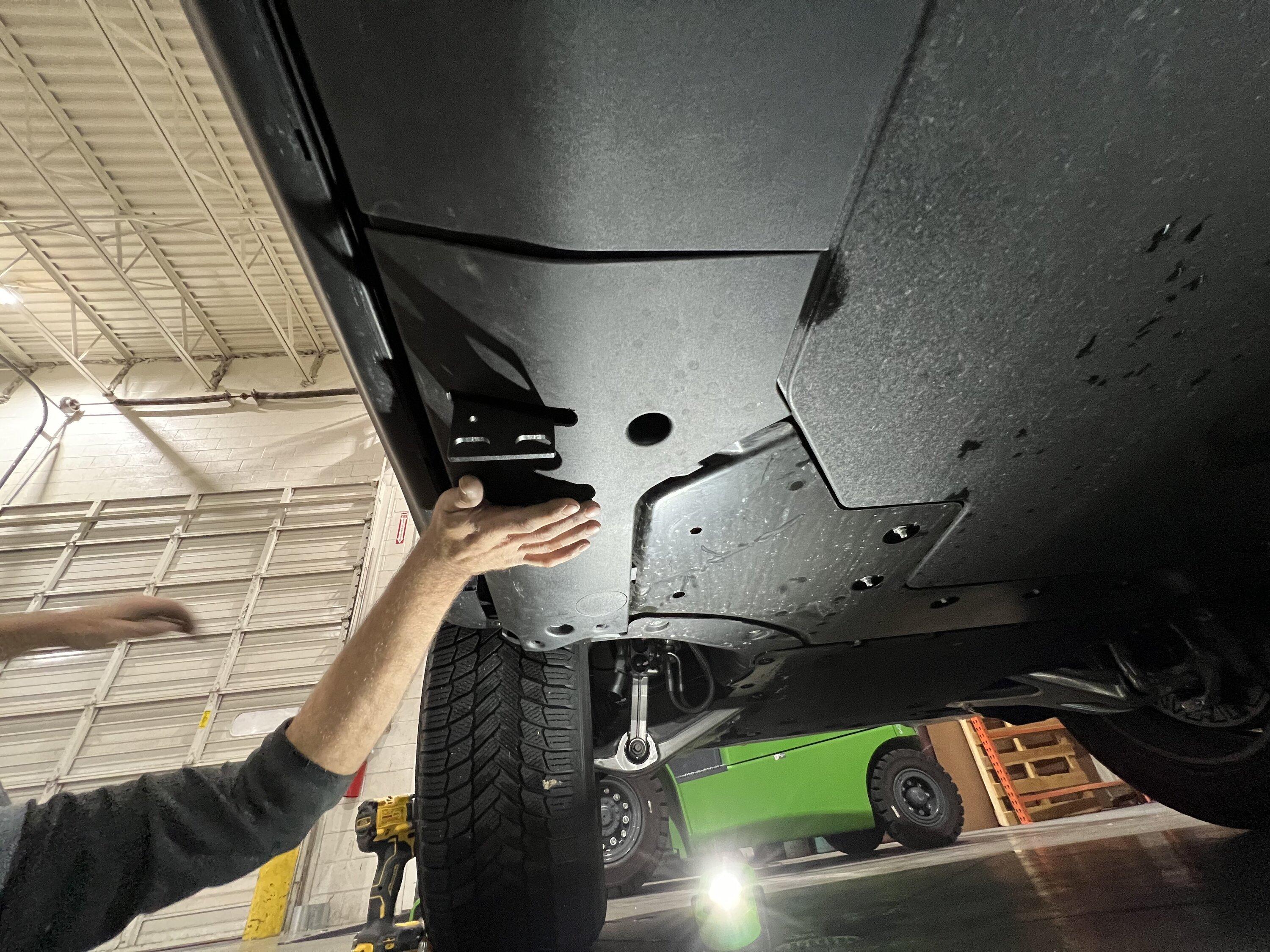

To install, start with removing the lower trim.
Rivian R1T R1S RealWheels EV Stainless Steel Running Boards IMG_3302

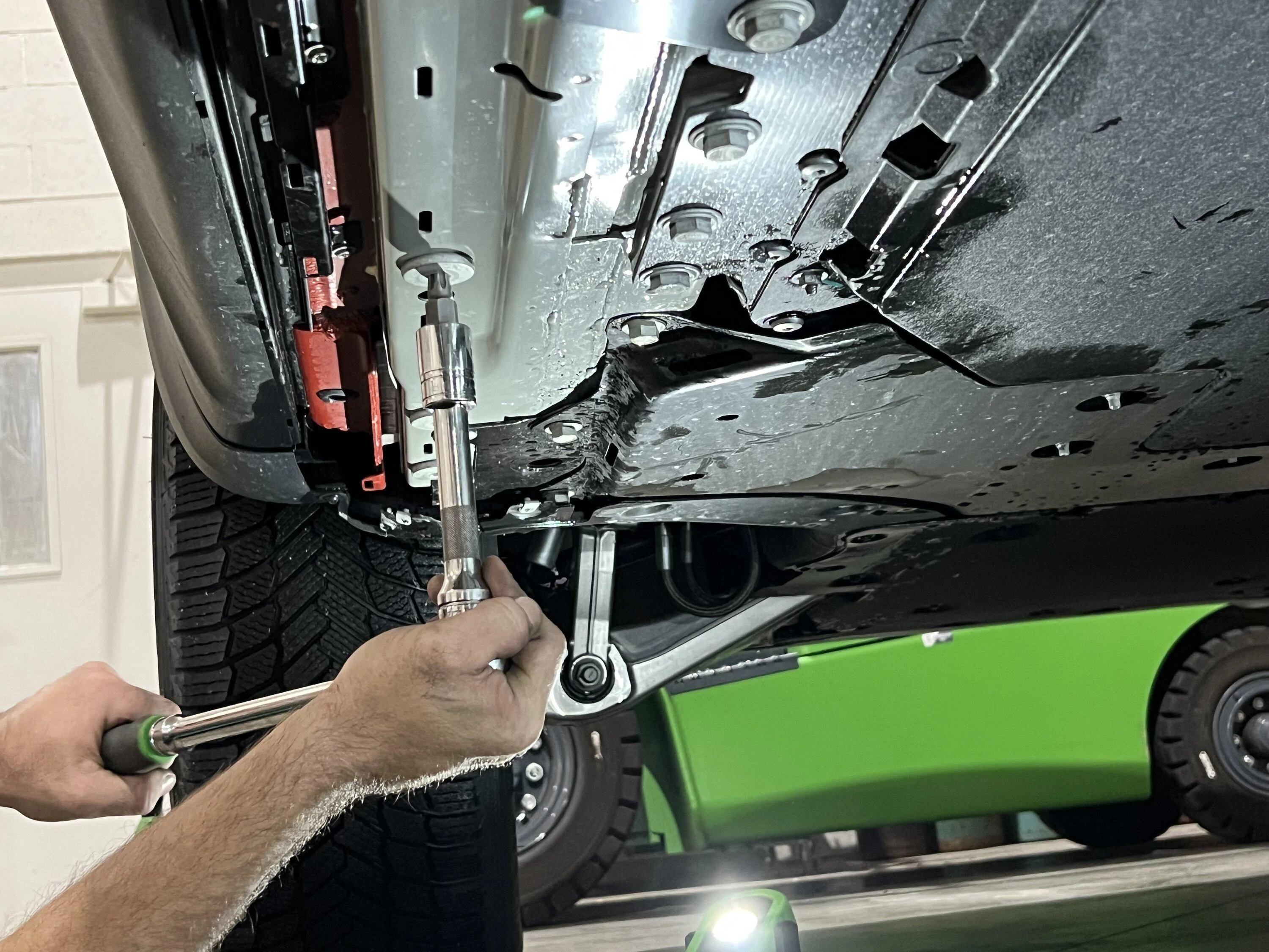

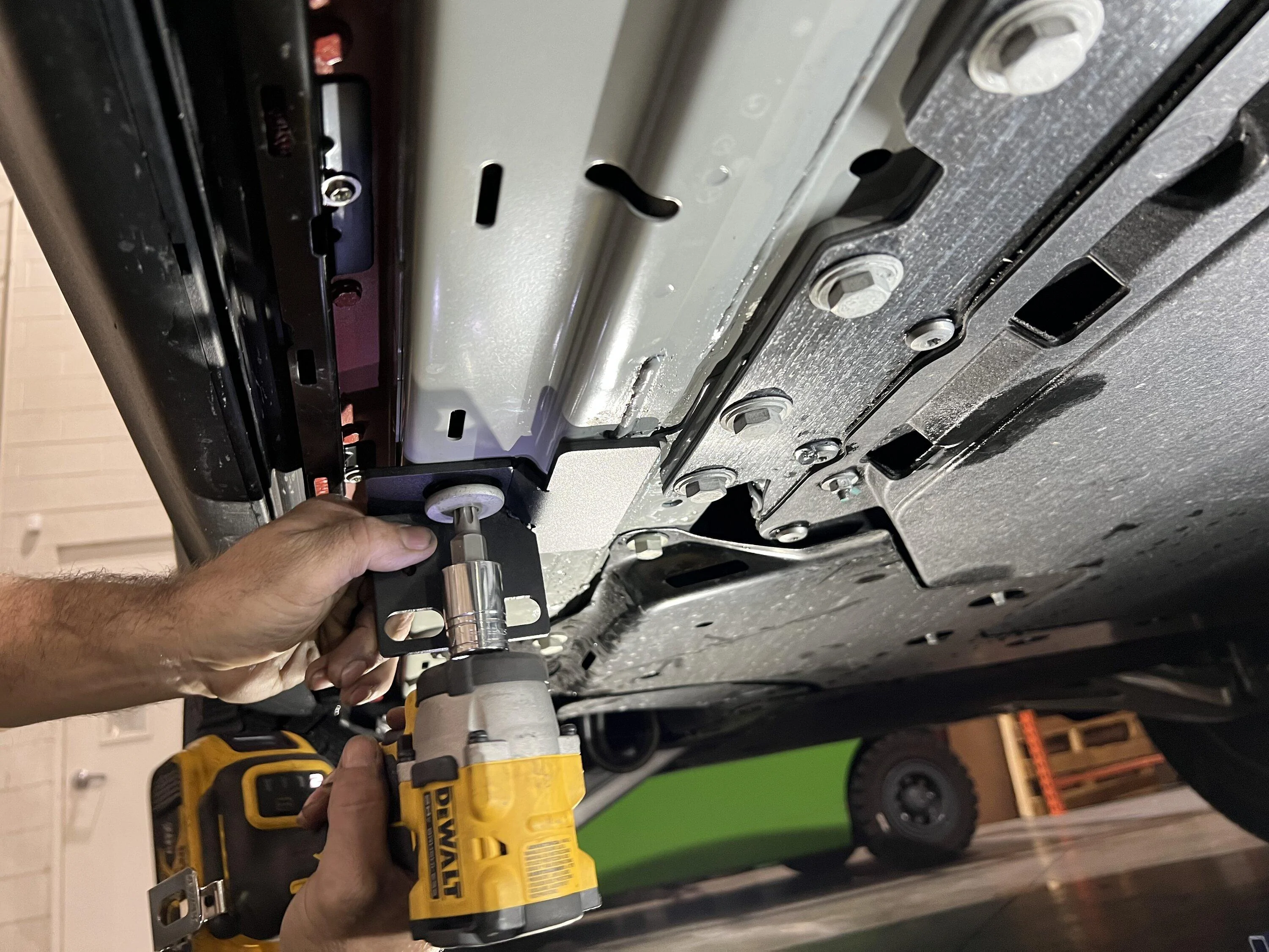

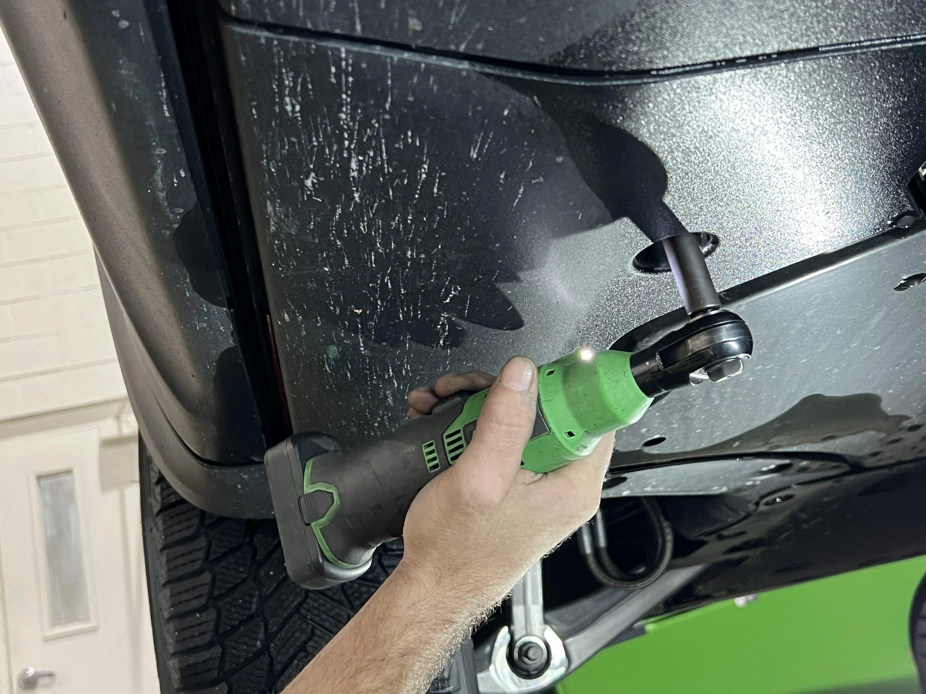

Next remove 4 bolts (5 for the R1T) using a TP55 and mount the supplied brackets in place.
Rivian R1T R1S RealWheels EV Stainless Steel Running Boards IMG_3334
Rivian R1T R1S RealWheels EV Stainless Steel Running Boards IMG_3354

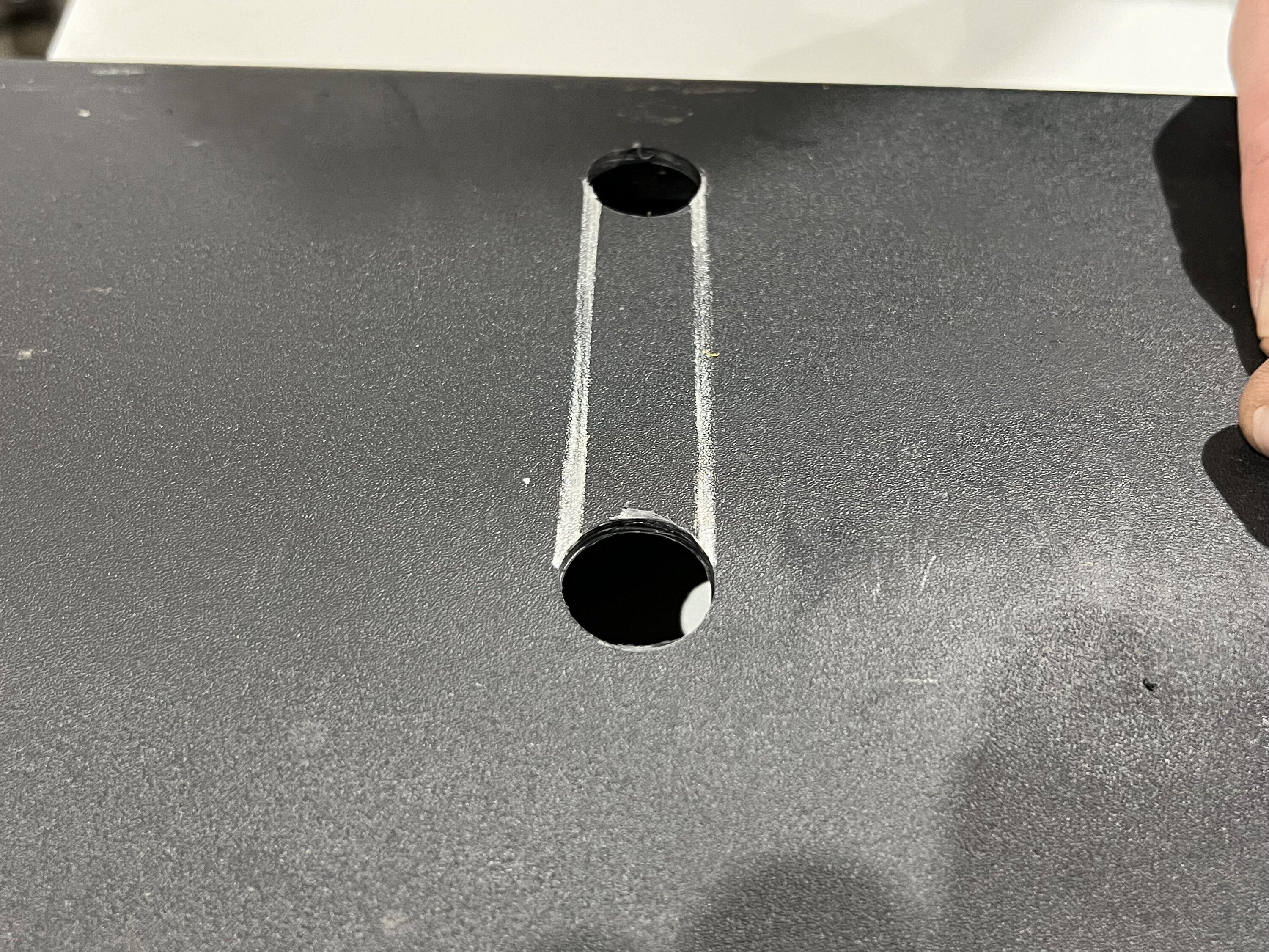

If you do not want to put the lower plastic trim back on, you can mount the boards right here. If you would like to slot the lower plastics and reinstall, we provide info for modifying them.

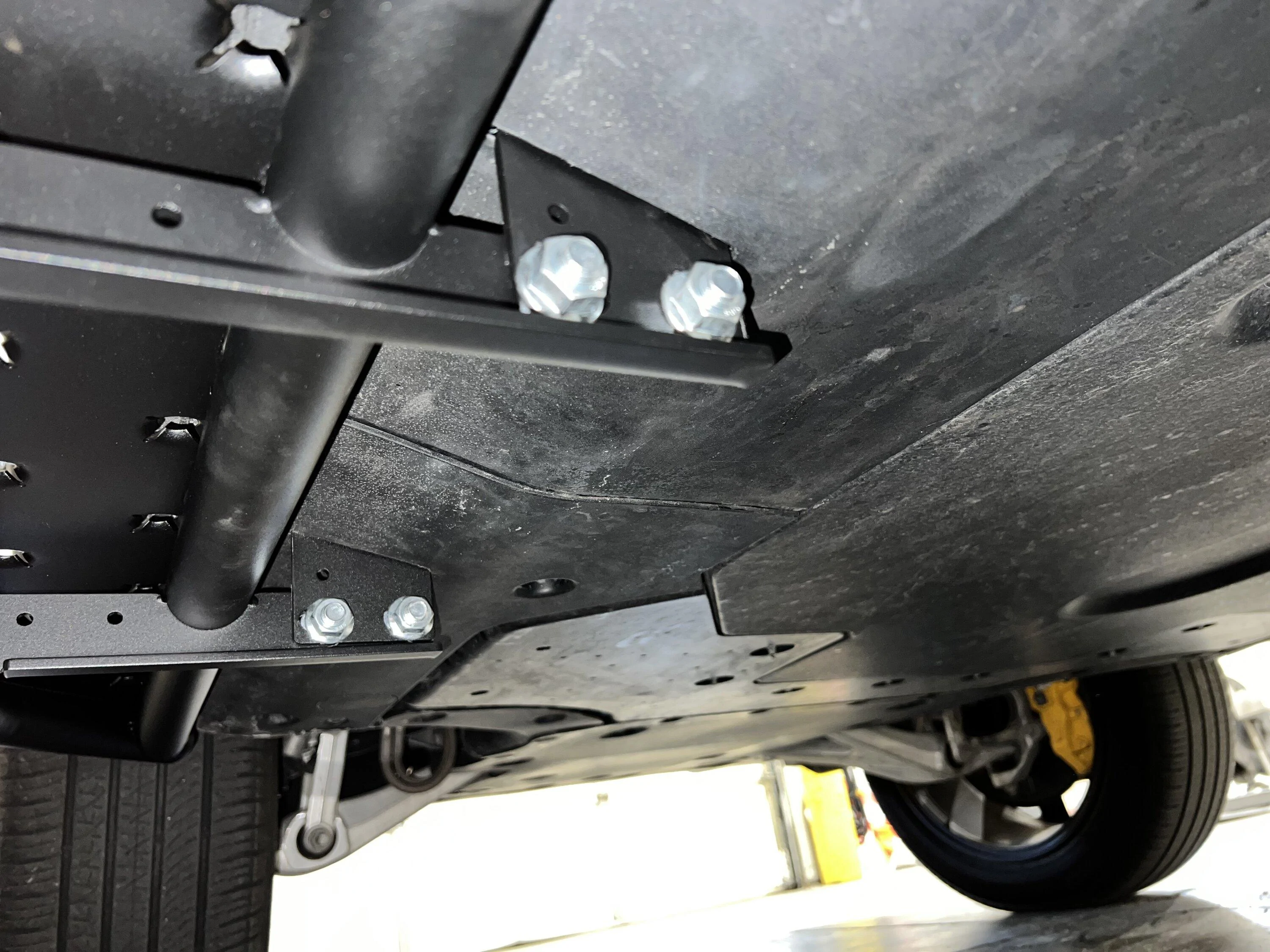

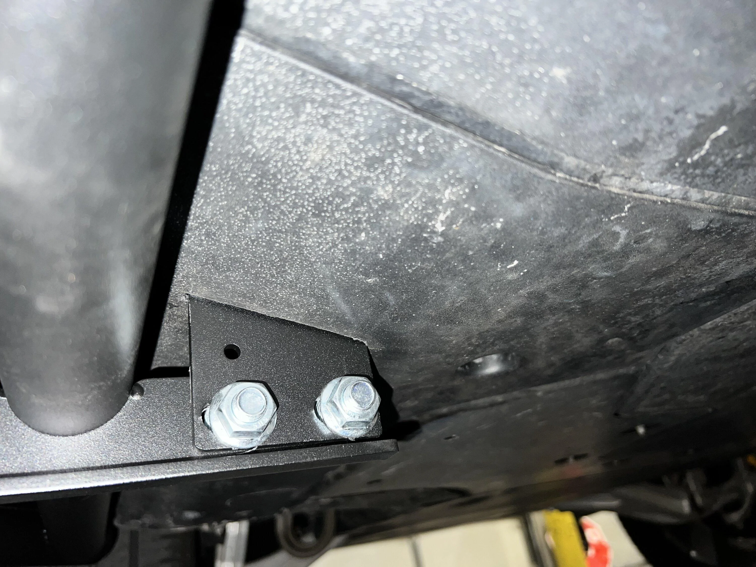

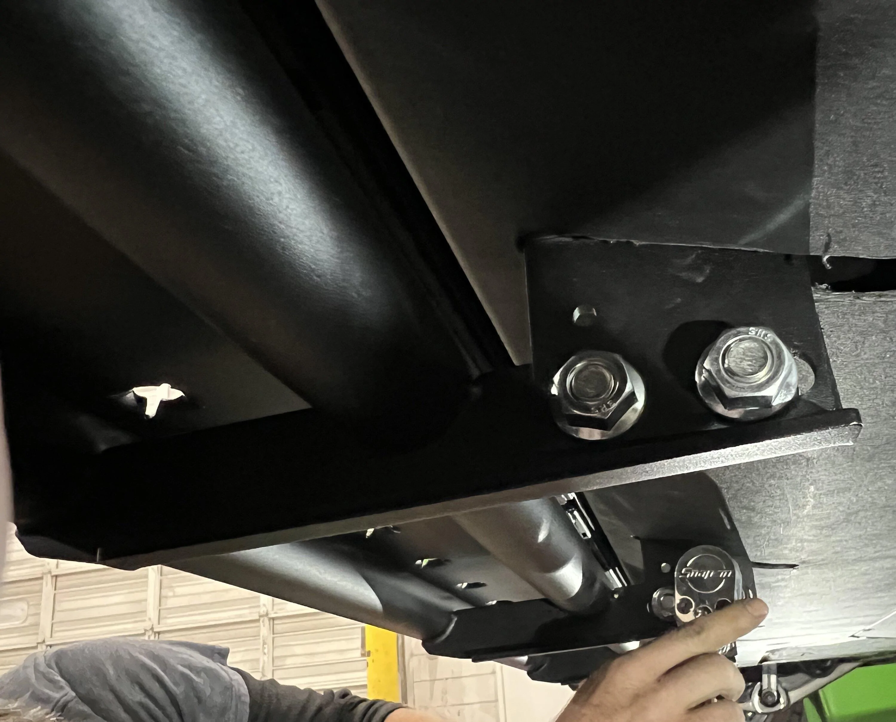

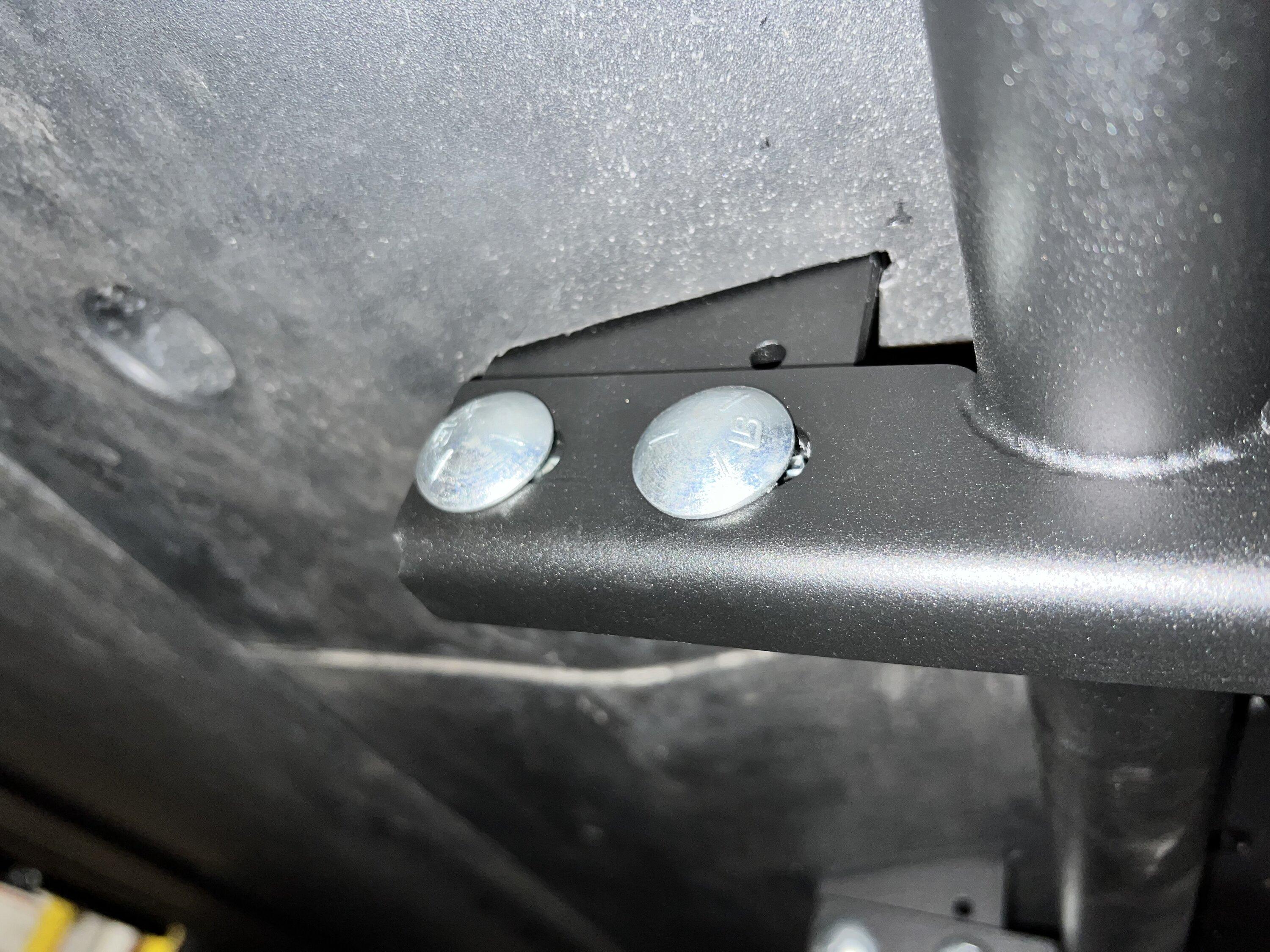

Next up is mounting the running boards. This is as simple putting in and tightening 2 bolts per bracket. You do have some adjustability inwards and outwards to find your perfect spot.
Rivian R1T R1S RealWheels EV Stainless Steel Running Boards IMG_3438
Repeat for the other side and you're finished!

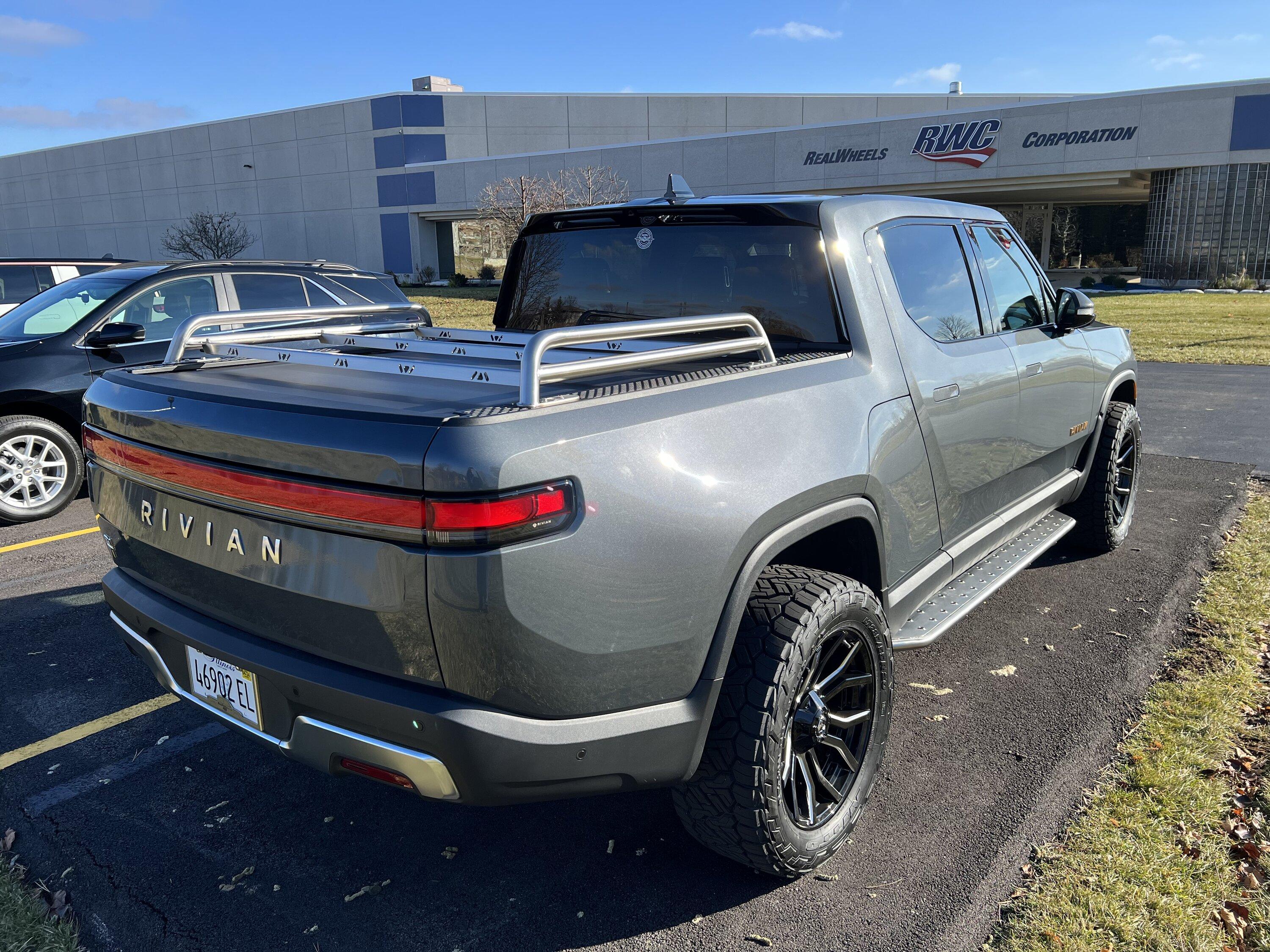

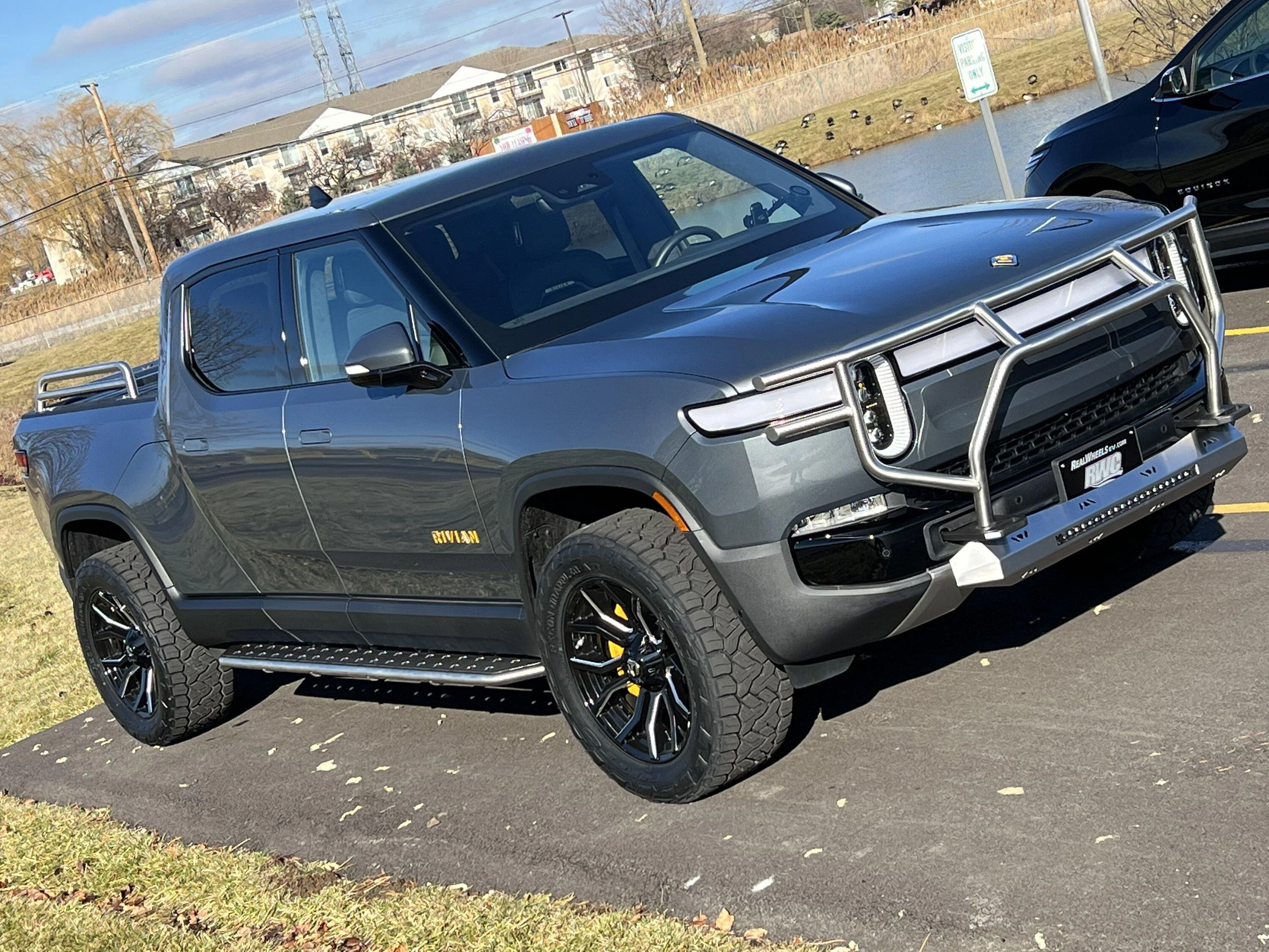

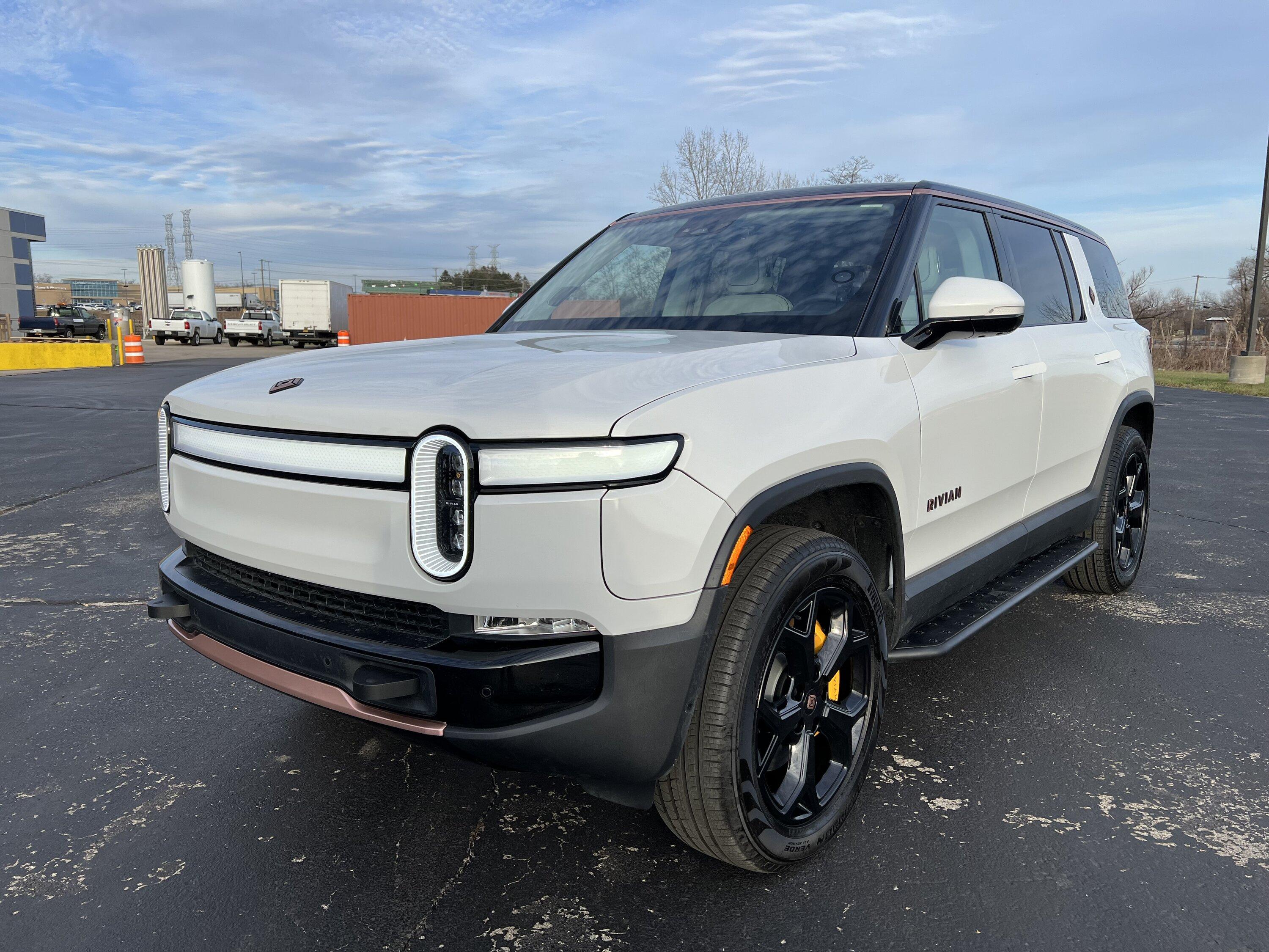

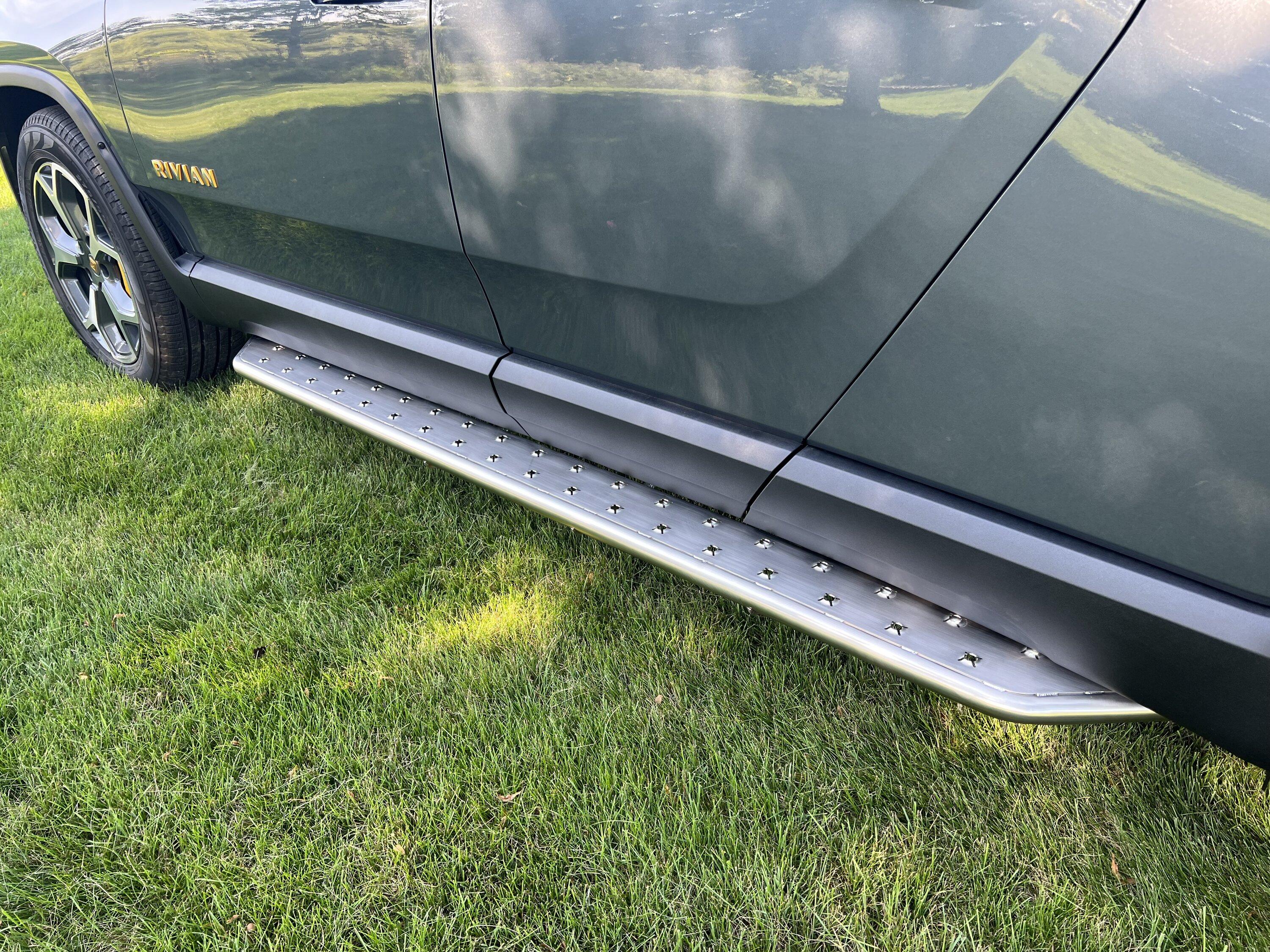

I am happy to introduce the RealWheels EV All Stainless Steel Running Boards. We’ve engineered these Rivian specific stainless steel running boards to be able to endure the toughest elements while enhancing the appearance and function of your Rivian. We offer them in both a hand-polished satin finish to compliment the factory silver trim, or a classic black powder coated finish. They feature our Real-Grip™ stepping surface for maximum grip and water drainage.
What differentiates RealWheels EV Running Boards from the other ones out there?
  • All Stainless Steel Construction
  • Real-Grip™ Stepping Surface
  • Two Finishes available
  • Full Length to Maximize Stepping Surface
  • Made in the USA
  • What most people would consider the biggest benefit, RWC EV Running Boards and mounting brackets are made completely from 304 Non-Magnetic Stainless Steel, not carbon steel like other available Rivian running boards. That means that our running boards will NEVER rust. Carbon steel may be less expensive, but they will not allow you the durability and longevity that only Stainless Steel can offer. You’ll have peace of mind knowing that you’ll never have to worry about seeing any unsightly rust with the RWC EV Stainless Steel Running Boards.

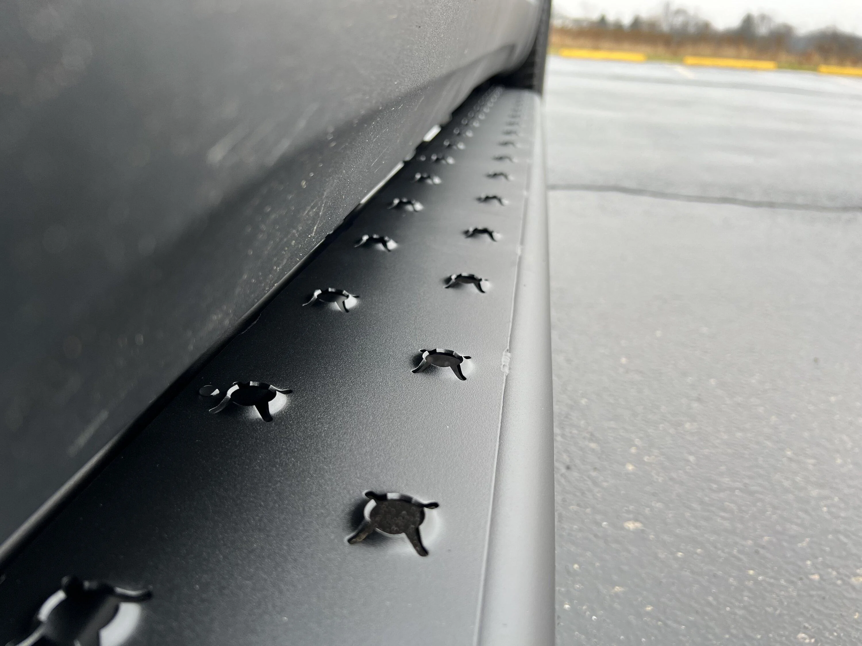

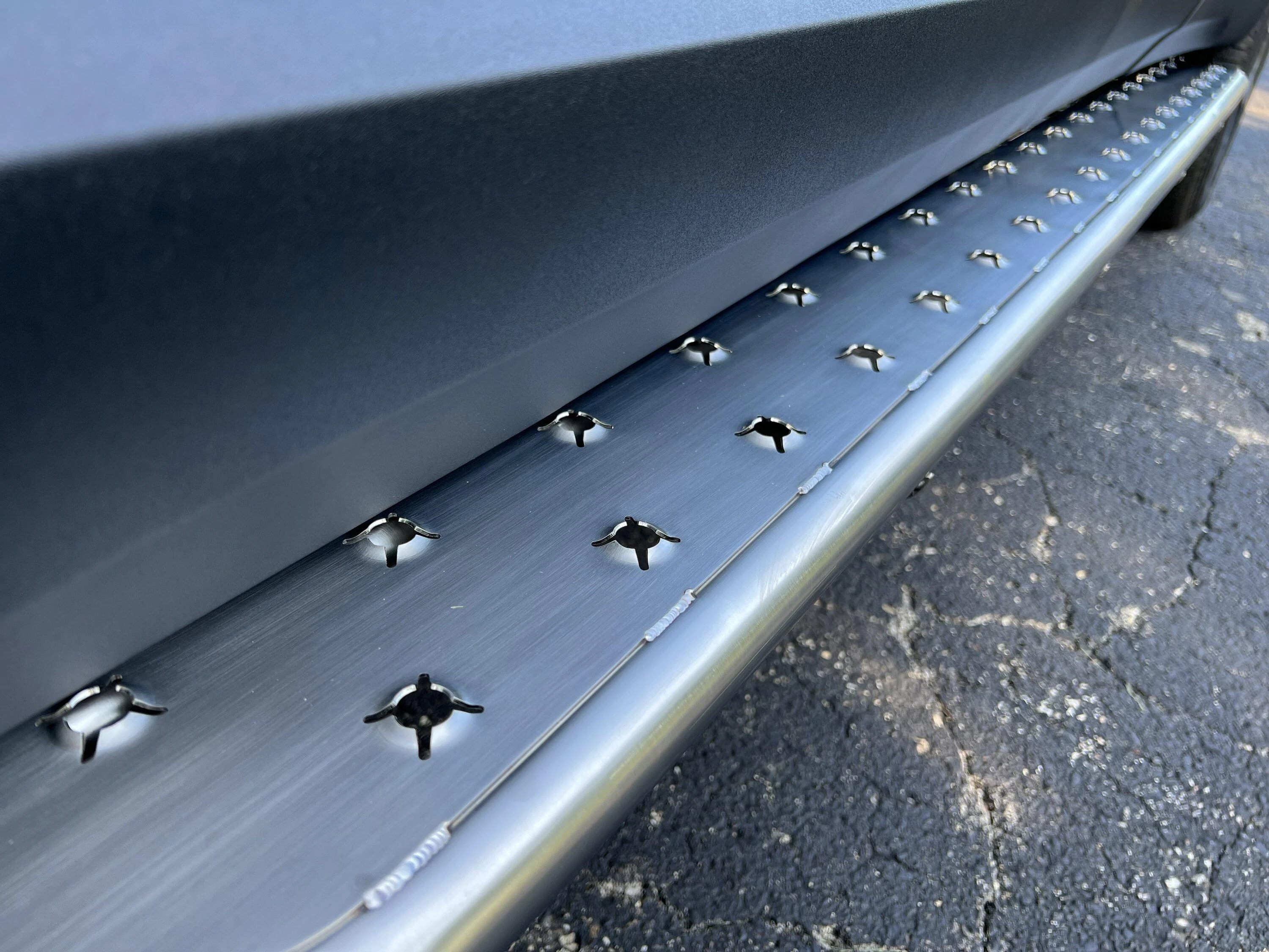

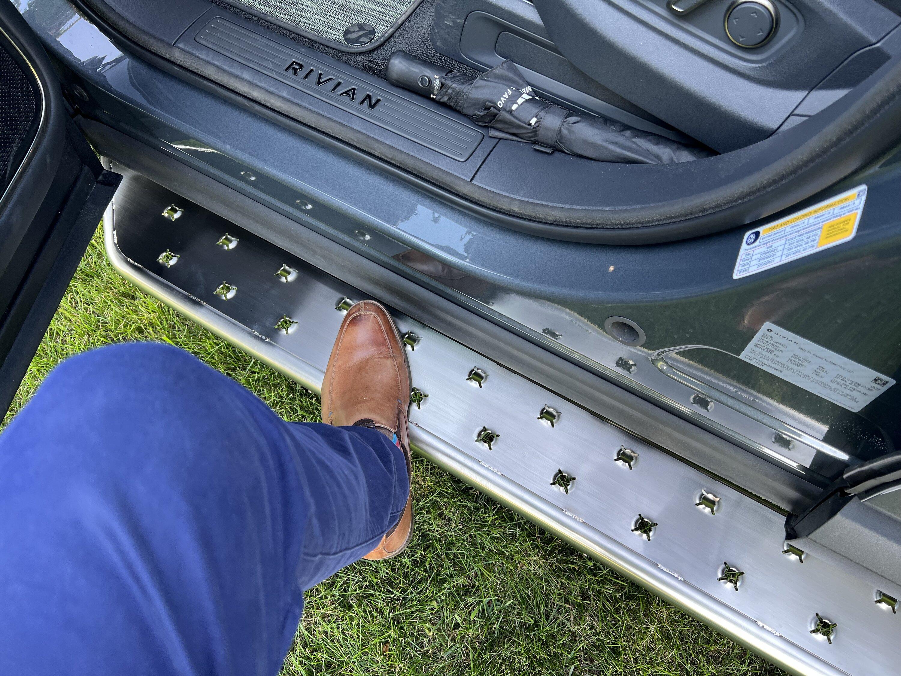

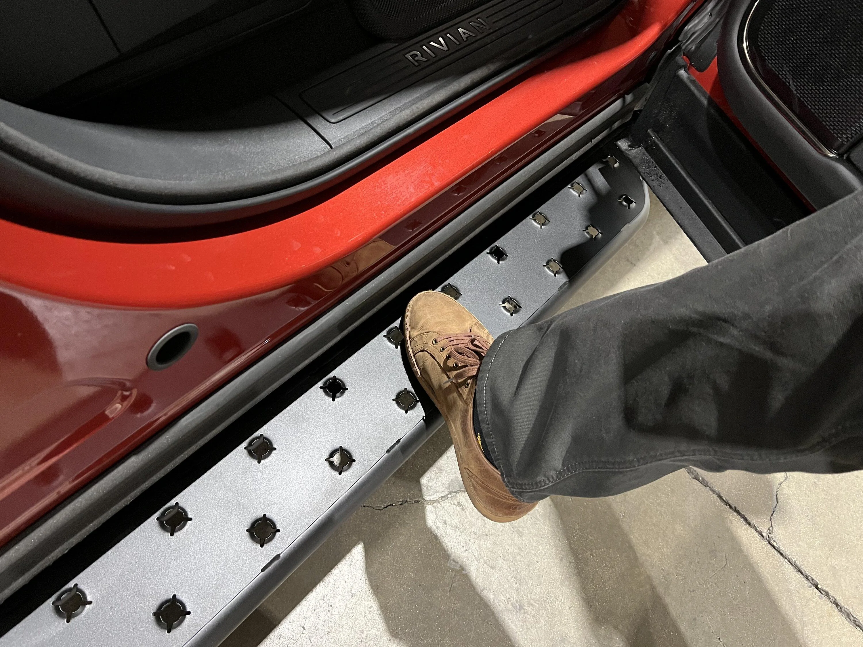

  • A highly important measure that doesn’t get discussed about much, is the actual step surface. RWC EV offers Real-Grip™ a true non-slip extruded tread design. This unique cut pattern gets extruded upward creating multiple contact points and ensures that you will have maximum grip stepping into or out of your Rivian, regardless of if it is dry, wet, oily, or snow packed. These same openings also allow for rapid water drainage, so you won’t have to worry about puddles on your boards. The unique 3D look of the stepping surface is exclusive to the Real-Grip™ tread design.
Two Finishes Available
  • The choice is yours, satin brushed or classic black? The RWC EV Running Boards are the only ones available in a hand-polished satin finish. Because we make our boards out of stainless steel, we can offer a bold unique look that complements the factory silver touches on your Rivian.
  • Prefer the black powder coated finish to match the lower trim? No problem. Since our boards are made from stainless steel regardless of finish, you will get all of the same benefits plus a durable black finish that is designed to last without ever having to worry about rust.
  • The RWC EV running boards are designed to go from end to end to maximize your stepping surface. On the R1S we brought the Real-Grip™ stepping surface as far back as possible and rounded it out to give you the most surface area for people or your little ones stepping in or out of the back. Giving full confidence being able to plant your foot completely on the stepping surface. The boards for the R1T extend all the way towards the rear to allow you bed or roof access from the running boards.
Made in the USA
  • Our Stainless Steel Running Boards are made right here in the USA. We look at the little things that add up to making a difference. We fully weld each tube closed, so you don’t have to worry about plastic end caps falling off. We tig weld each and every component of boards, so you don't have to deal with bolting down the stepping surface. We hand polish the finish. From the first bend in the tubing, to laser cutting, welding, satin polishing or powder coating, we handle every operation to ensure the highest level of quality for your Rivian.

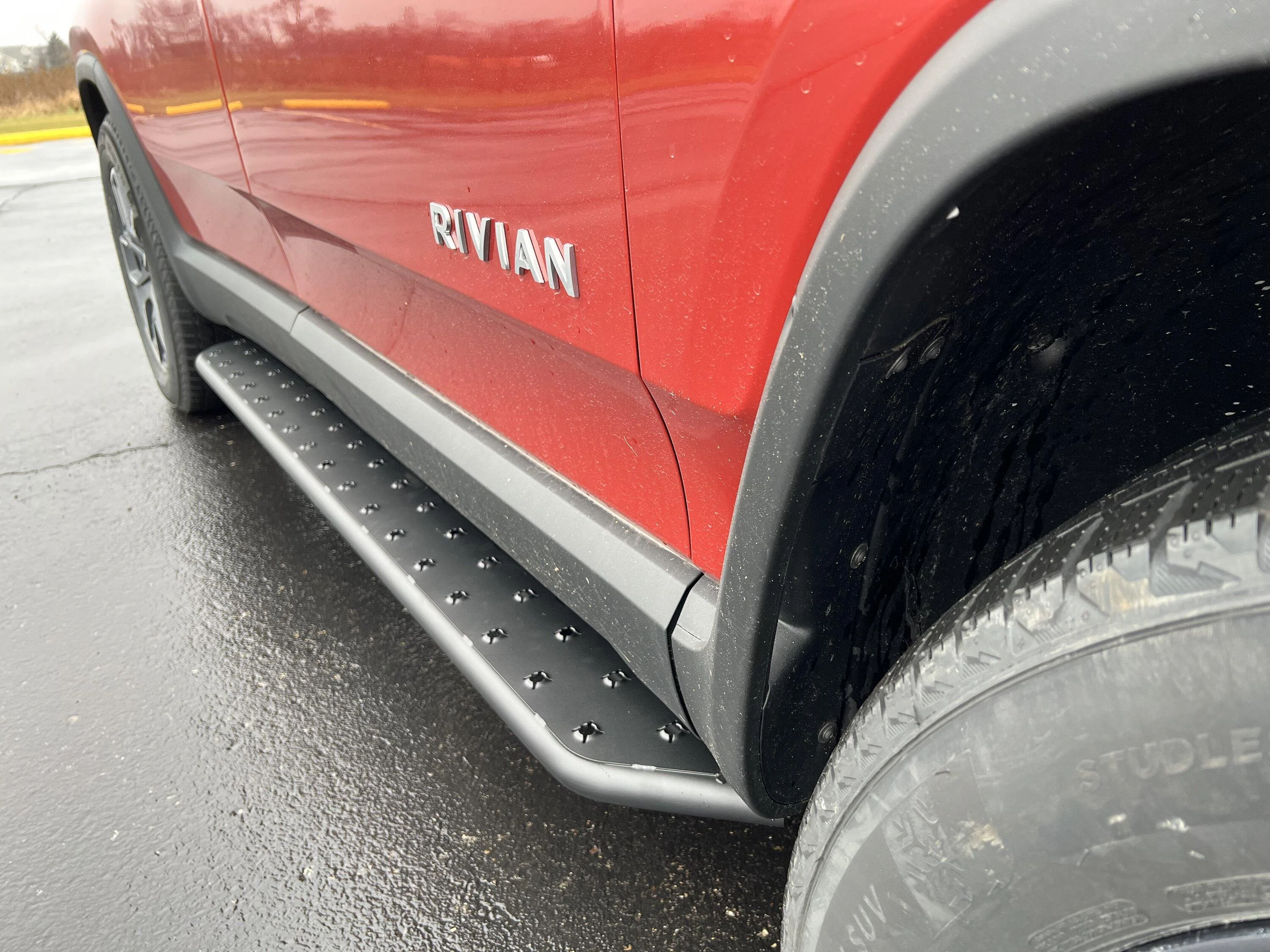

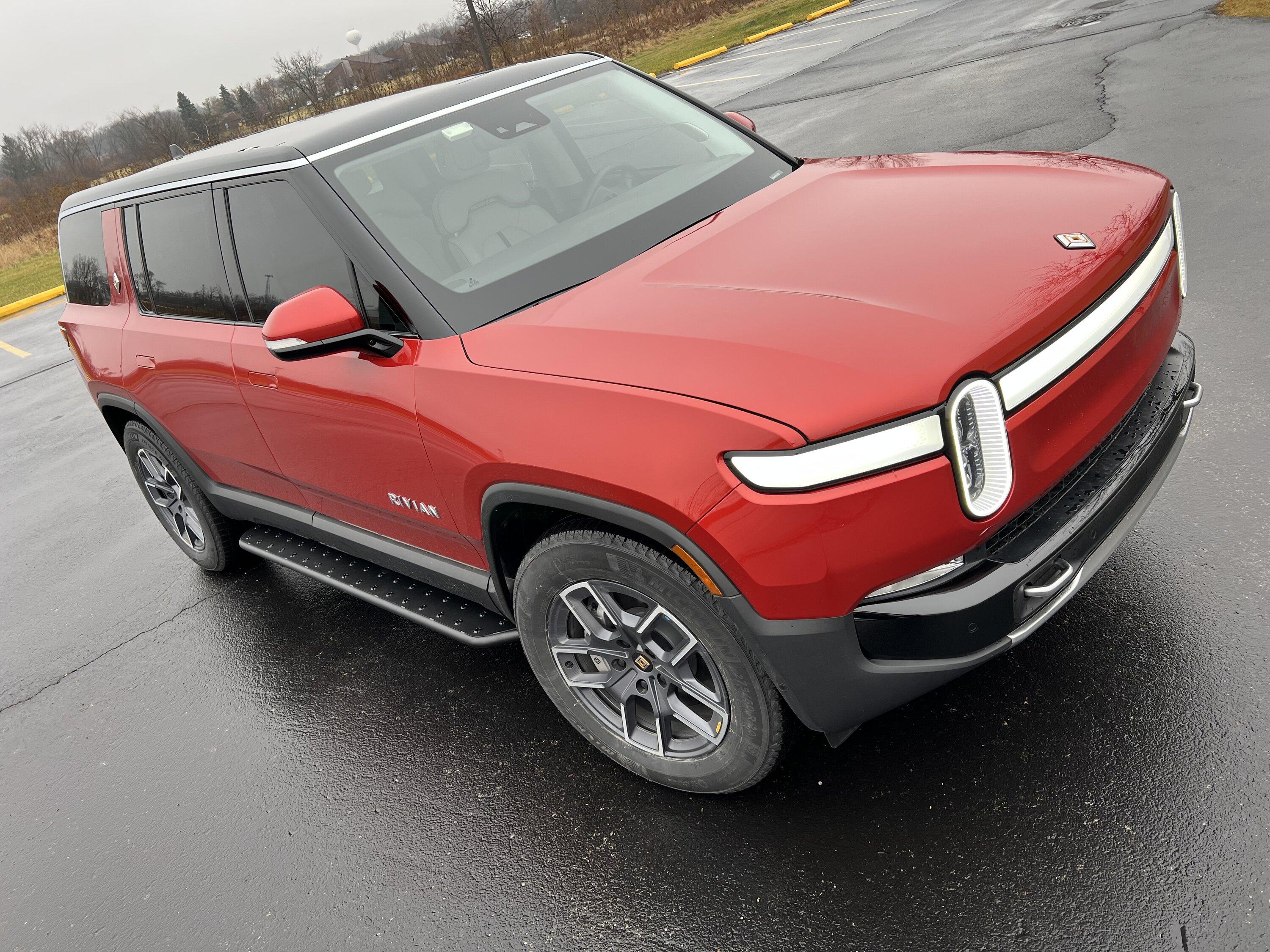

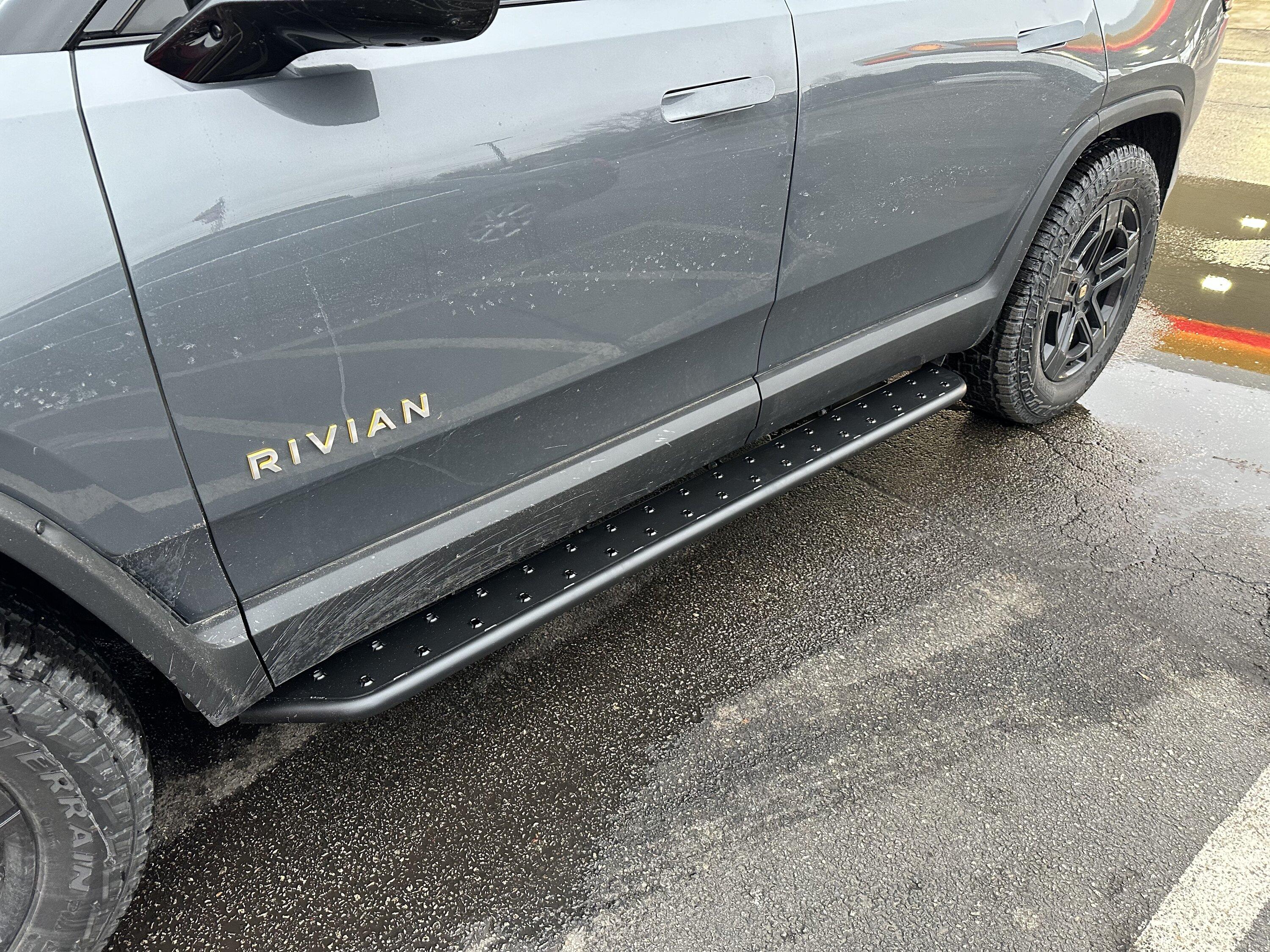

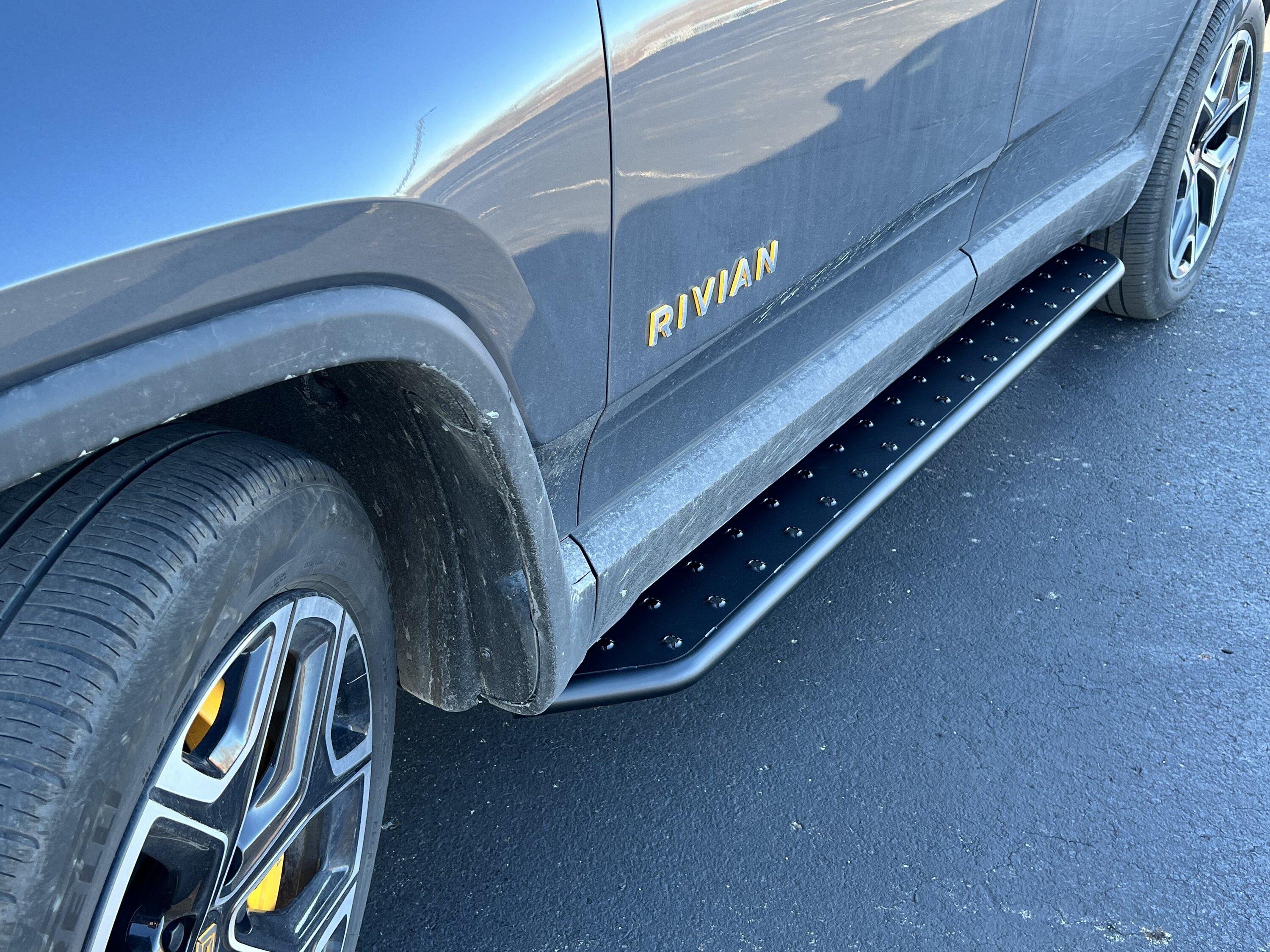

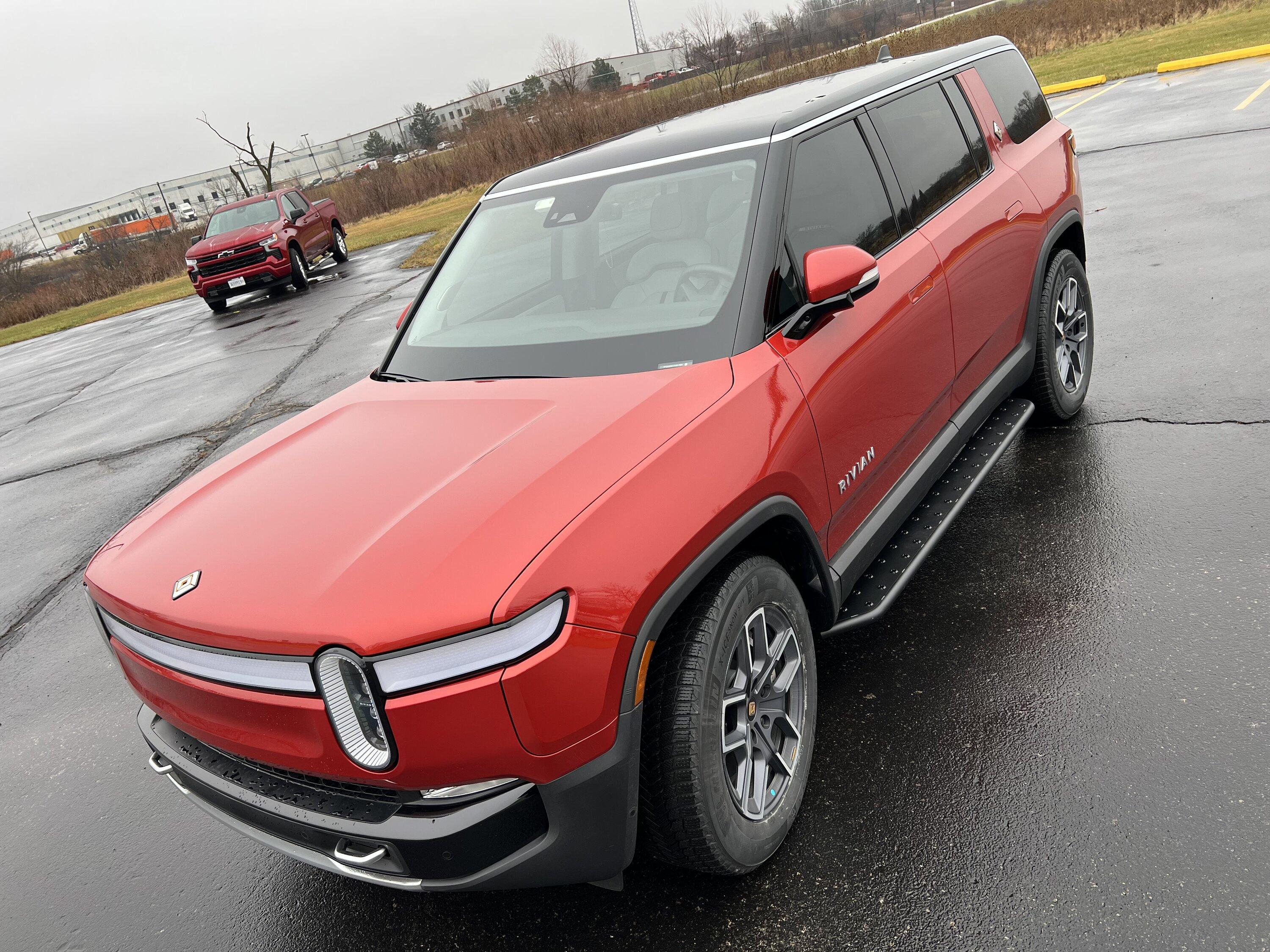

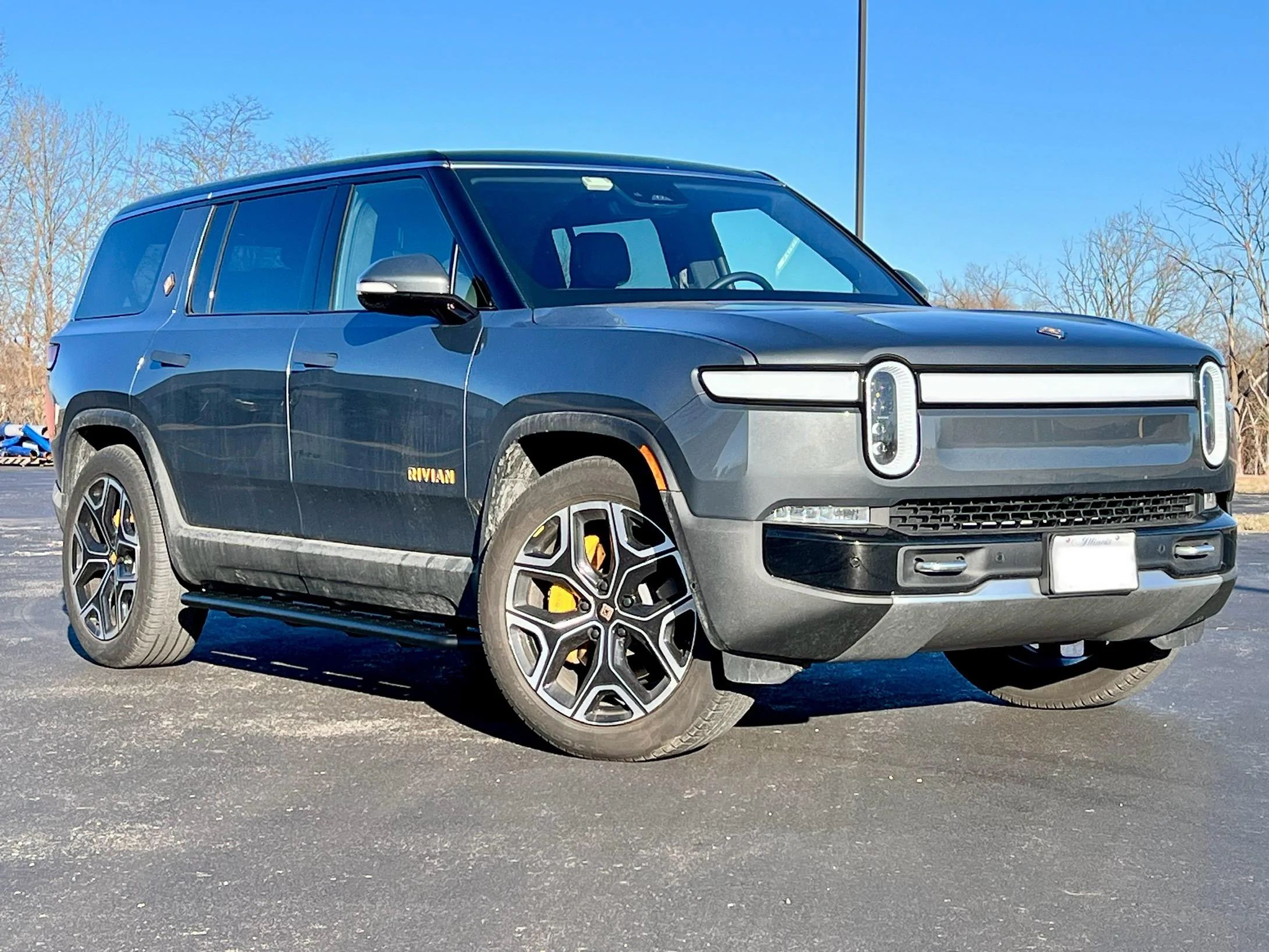

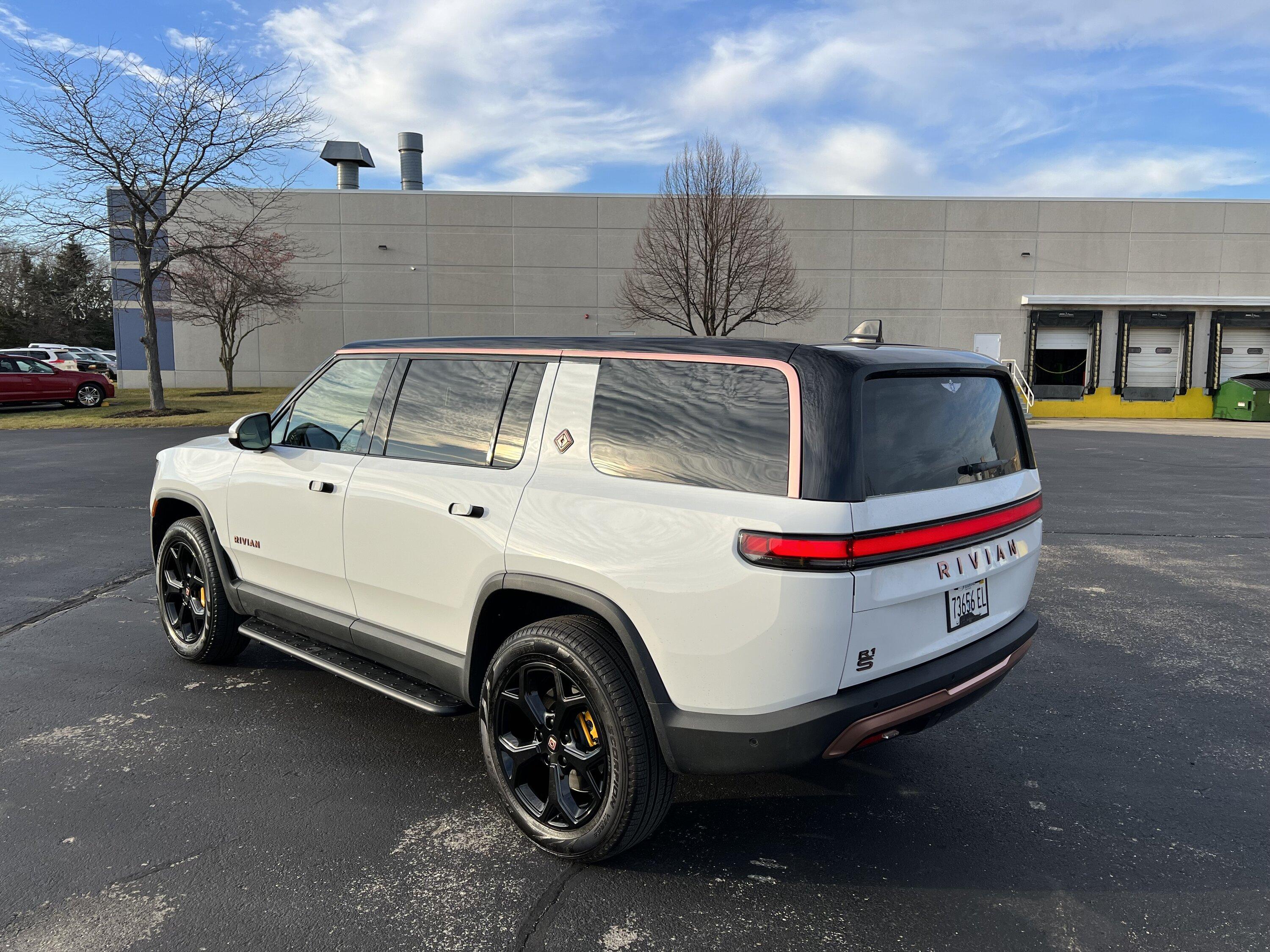

We had to opportunity to meet another great forum member and install a set of our black Stainless Steel running boards on his R1S the other day. They came out awesome! The R1 will be getting a bath soon after the freshly installed RWCev running boards.
And take a look at the lower plastic trim panels after installation, I don't think you could get a tighter fitting set. Our instructions give you the option for a fine fit allowing you to install yours this same way. Thanks again Robert!
