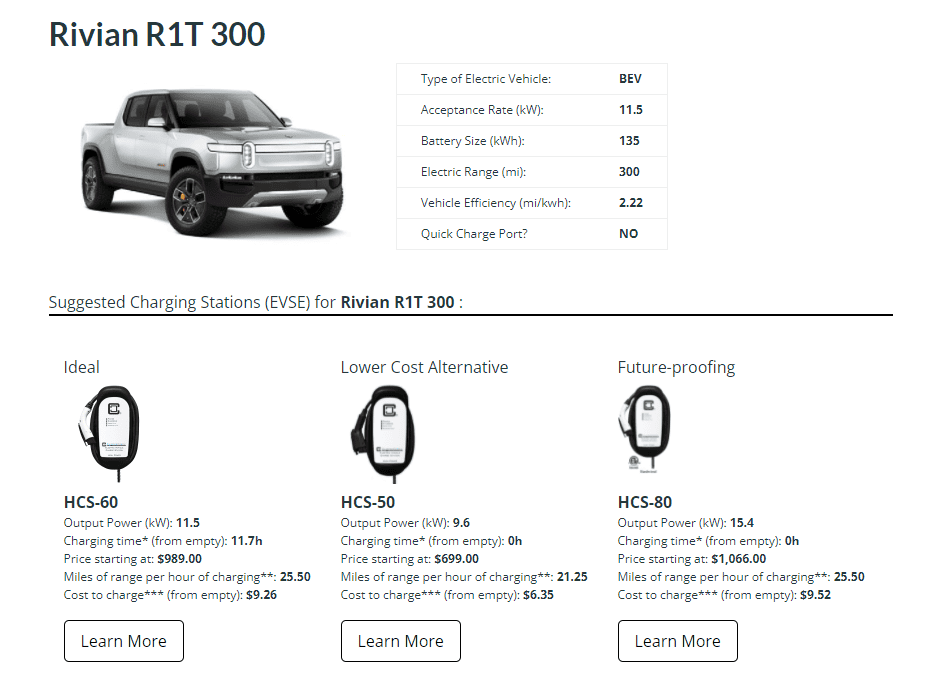

I currently have a Clipper Creek 32A charger that I purchased in 2013. Used it first with my Nissan Leaf and then a Model 3. It was always fast enough to charge my vehicle up during my overnight super off-peak 6 hour window. I knew the Rivian has a bigger battery but I never really did the math on how long it would take. Sadly I only get about 11 miles added in an hour to the R1T. So if I drive a lot in a day I can't quite get back to 70%.
So now, I'd like to get the Rivian charger. However, it's not in stock and costs a $700 vs $500 with the pricing update. Ok, fine I'll pay more I guess. I tried asking my guide if I could still get it and he directed me to the gear shop where you can enter you email when it comes back in stock (which I don't think it will for a long time since they are reserving them for deliveries). Doh! I'll be looking at other chargers - the Chargepoint Flex looks like the best option.
Anyways - this is my PSA. Think twice before not ordering the Rivian Wall Charger, especially if you have the $500 pre-price increase. You might regret it like me!
ClipperCreek has some upgrade options...talk to them, maybe even a trade-in. To my mind, the chargers with wifi and apps simply introduce additional points of failure for no real upside. What would you get from the app that you can't get from the app for the truck? Here's ClipperCreek's current for the R1T:

I do understand that 11mi/hr charge would be hard to live with. Call them and ask some questions...that's worked for me.
