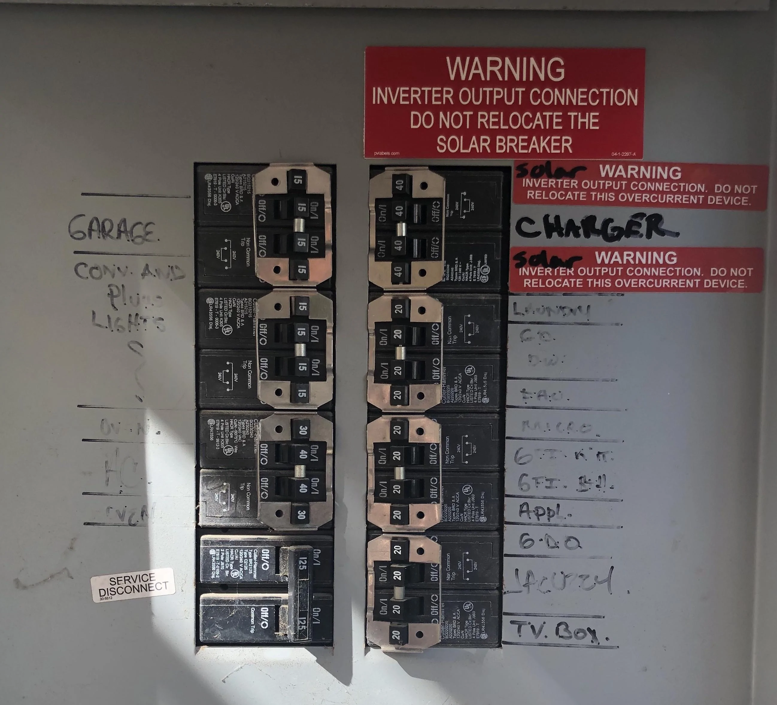

Yes, I plan on getting a more quotes for sure. I know he didn't like the look of my current setup as well - I have a double 40 sharing the charger and solar. My panel is pretty full.
I think your panel has gone beyond pretty full to FULL!
Beyond that, and maybe this is something new, all of your breakers are paired so if one trips then its mate will get turned off, too. I’ve only seen this in 240V applications where both breakers are used for a single device. Typically I’ve seen the other 120V circuits like your lighting, GFCIs, regular outlets, etc. have the joiners removed so they trip individually to aid in troubleshooting. I’m not an electrician but I had to read up on the NEC for a permitted and inspected remodel project where I did the wiring. Maybe something changed since then and my thinking is outdated.
Yeah definitely full as @SoCal Rob already stated.
You might be better off upgrading your whole panel to 200A service rather than adding a sub panel but electrician will have to advise your there.
I know my panel upgrade to 200A in Portland OR cost not much more than your other quote, as I recall it was ~3200 but included running the service line into my basement.

Apparently it's about $5000 to go to 200A service here - before the EVSE install prices. I have 125A service, electrician didn't seem to think the 48A charger would be an issue with my load, especially since you mostly use it in the middle of the night.
