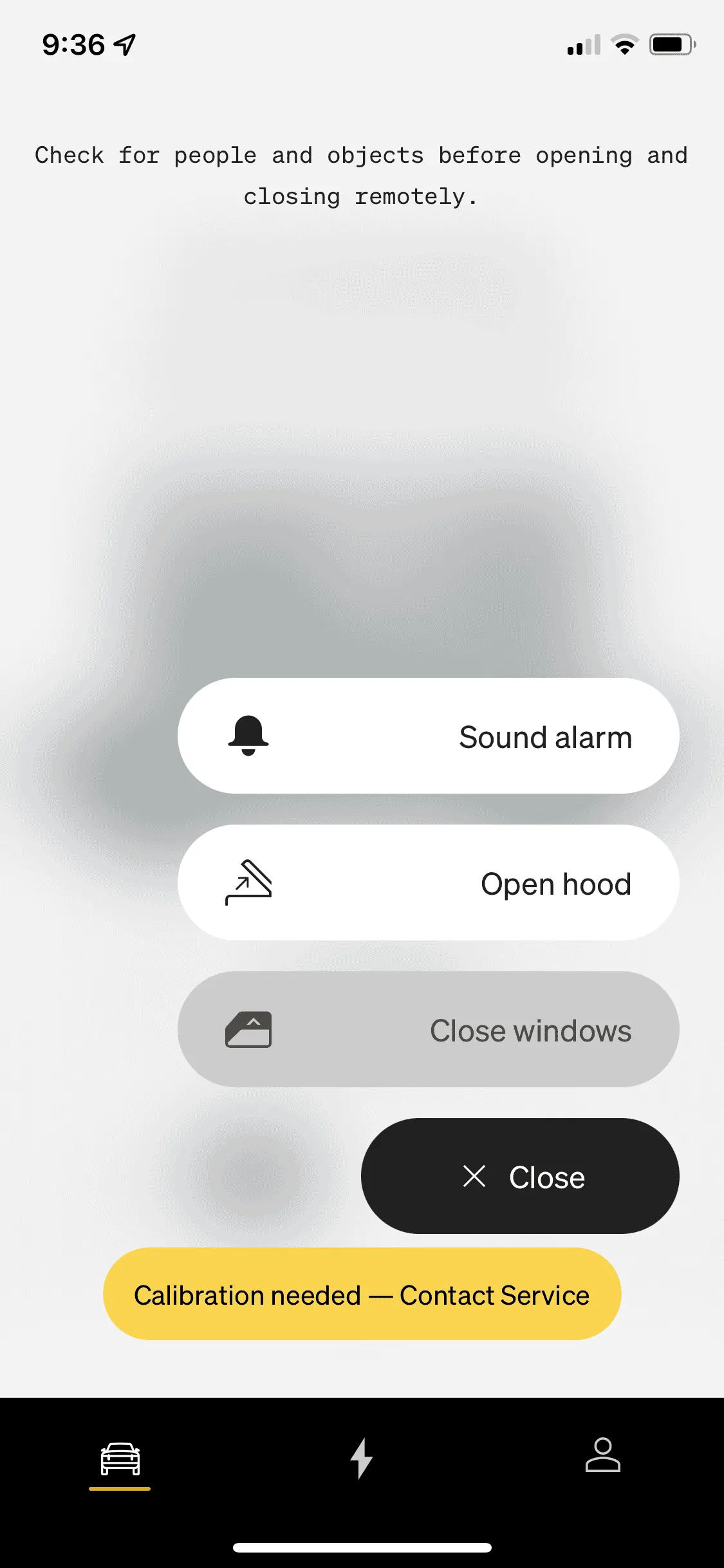

Window venting feature does not work for me. Called Rivian and they had me open/close my windows to calibrate, but no luck. Waiting to hear back from them on this.
