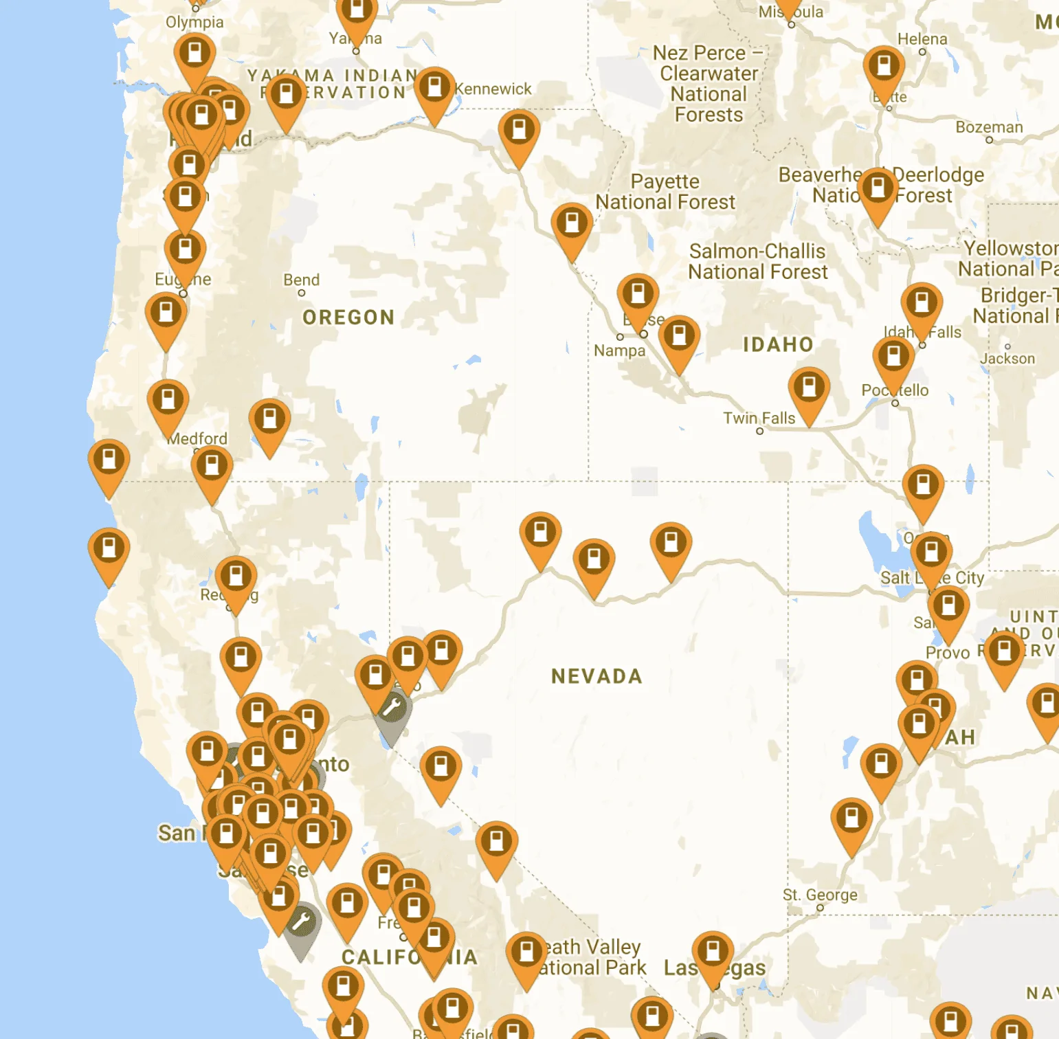

  3. The Rivian will be extremely unlikely to have 400 miles of range for the trip/usage you describe. Highway range, particularly with dirt bikes in the bed or pulling a trailer will be shorter. How much less will depend greatly on your speed.
  4. As to the ~900 miles to Death Valley from WA (Yakima? Tri Cities? Vancouver?), available charging will dictate route, stops and time. You are unlikely to get a full charge overnight at a motel, even with a L2 charging (240V) available. Almost all charging at hotels/motels will be 7 kW or less, which translates to 25 to 30 hours for a full charge. As of today, high speed DCFC is only available by routing down I5 or thru Salt Lake.
    Rivian R1T R1S Reservations About My Reservation 1602193513716
    The above stations will allow the Rivian to charge at it's fastest level (300+ kW). There are other options, but they would be slower than using these stations.
  5. As to the time of the trip and charging, there is a bit more planning involved that plugging start and end into google maps. Charging station location and speed need to be considered, as well as the "taper" when charging a battery. Very rarely will it make sense (time and $$ wise) to charge to more than ~80% when using a fast charger on the road. Optimizing charging stops for the Rivian is still a complete unknown as we do not have any idea what the taper looks like (as the battery fills, charging slows)
    Model 3 as an example (V3 Superchargers will be faster):
    Rivian R1T R1S Reservations About My Reservation 1602194324856
    If you get a chance, have one of your friends with the Model 3 (preferably a LR version) put in a route from your home to Death Valley. It will show suggested charging stops, time at each of those stops, etc. If you are reasonably near a Tesla store (Portland?), drop in and have them show you.
