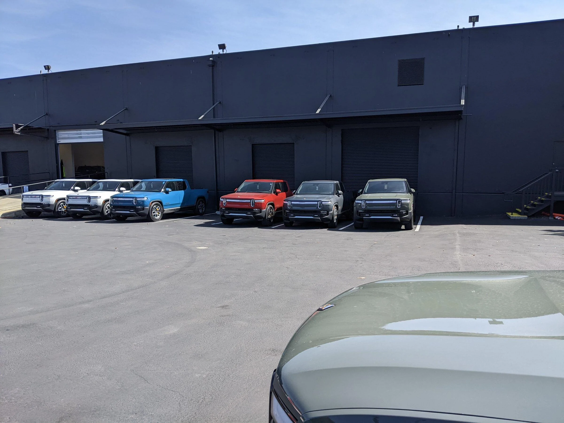

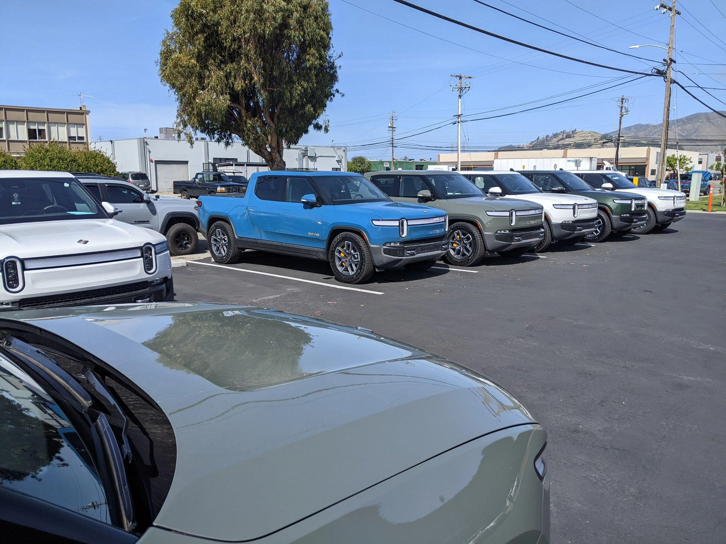

Things were sure busy at the service center. There were a ton of new R1T for delivery. The rep mentioned that it was the end of their quarter and racing to deliver as many as possible. Note, spied the first Red R1T!
Rivian R1T R1S [RESOLVED] My R1T is leaking brake fluid PXL_20220331_180518957
Rivian R1T R1S [RESOLVED] My R1T is leaking brake fluid PXL_20220331_180535190

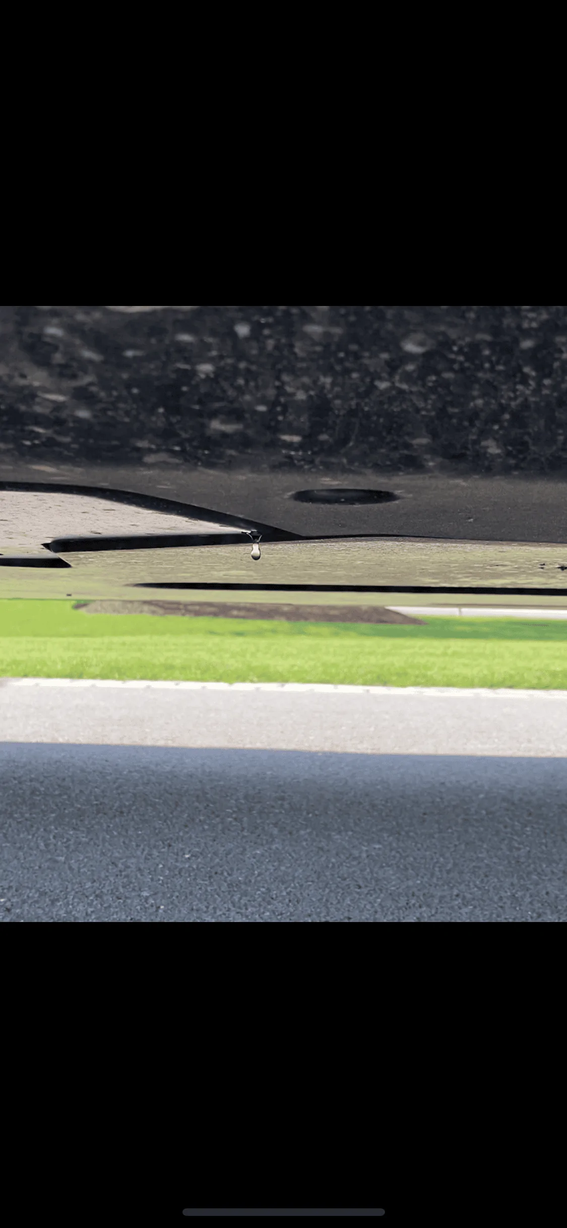

@plasmdude does this look familiar to you? Got my truck yesterday. It was 97 degrees out and I had the ac blasting to see how well it was working. Problem vs condensation?
