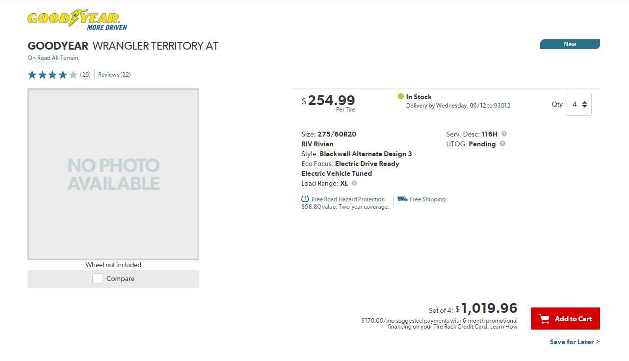

These tires do not seem to be available in the R1T size. Nor is there any all season in this size on the tire rack site.
Rivian uses 33” and 34” sizing:
21” and 22” are size 33” diameter
20” is size 34” diameter
There are sizes equivalent to 33”, 33.5”, 34”, 34.1”, 34.5”, and even 35” that may fit depending on the rims.
If moving from 21 or 22” rims to 20”, using the 33” size is a perfect fit (275/60R20).
If staying OEM 20” size (275/65R20), then there are few lightweight options…OEM Pirelli and Nitto Recon Grappler being some better options. I don’t have a problem with the speedo being slightly off…

I am looking at a new vehicle with max battery. Want 20" rims for smoothness over rough pavement and smoother ride. But don't want 20" AT tires due to noise and especially range hit. So you are saying that Pirelli and Nitto Grappler are available in 275/65R20 and are all seasons and not all terrain? I will look.
Sorry - There are so many options for the 20" rims, but if you want a non-AT tire you need to go to the 275/60R20 tire size (not 275/65)...
Read here for 275/60 options (~2.3-2.5 MPK):
Affordable high efficiency 20" wheels and 33" tires options (275/60R20)
Here for decent 275/65 options (but best case scenario is ~2.0-2.1 MPK)
High efficiency 20" wheels and ~34" tires options (R20 - 285/60 - 275/65 - 285/65 - 295/65)
Lots of other useful threads here too on a number of other options available, 21"/22" are extremely limited...
