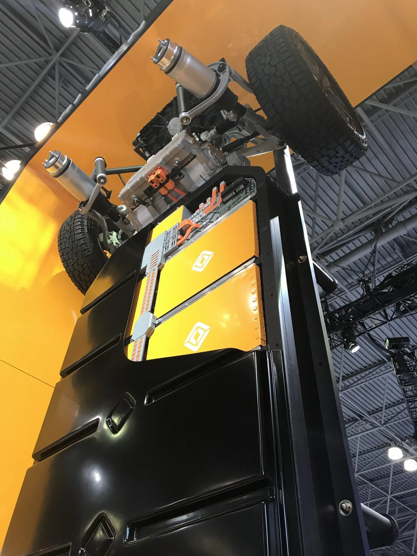

This pic is from 2019, but here is a decent look. The supplier is Dunlop Systems (confirmed late 2020). Looks to me like it would be pretty tough to retro a coil spring in there...
You would definitely need a module or "hack" to trick the SW, but I know similar things have been done on many different vehicles for a multitude of reasons.
