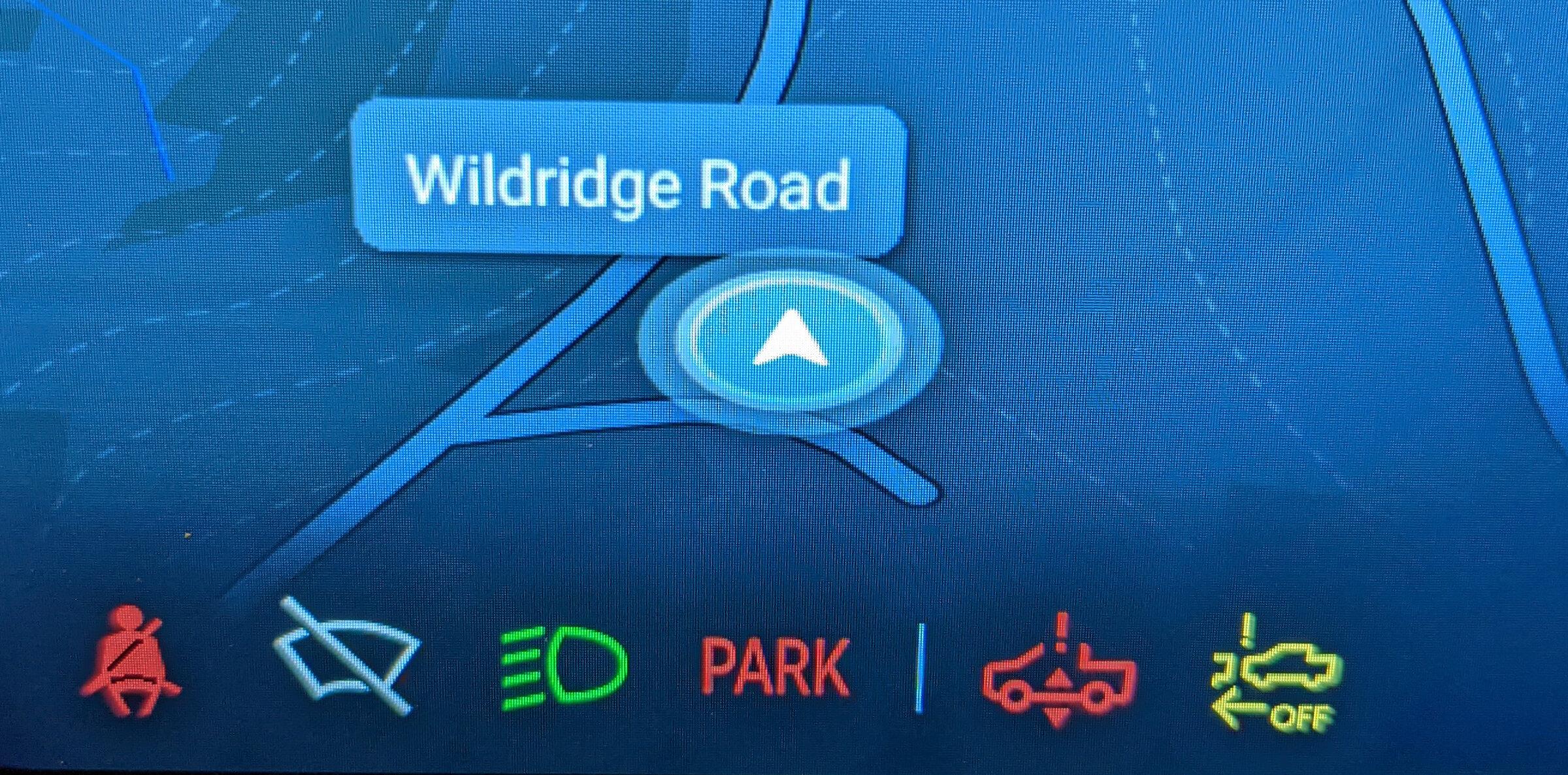

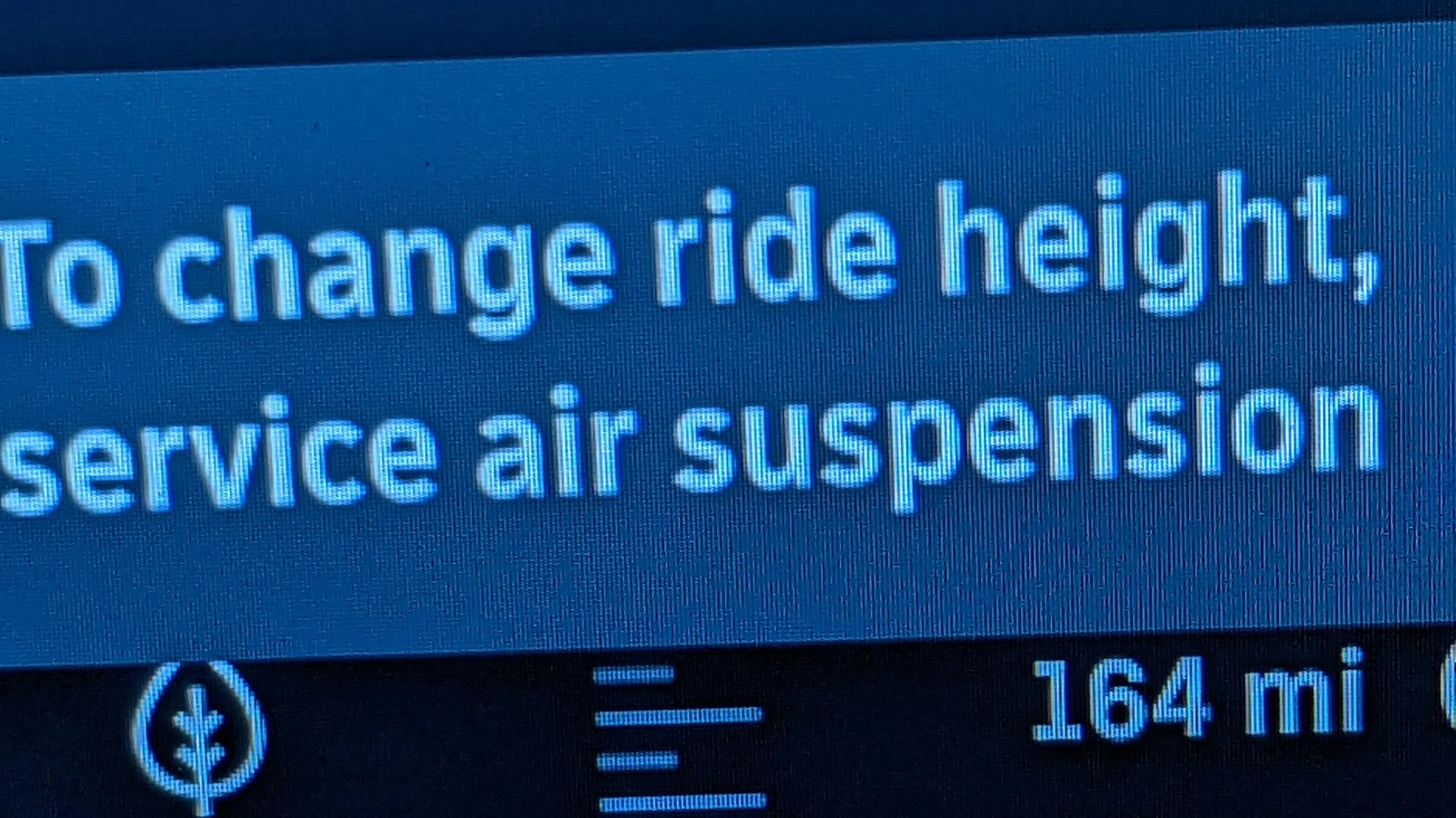

Driving the truck for only the second time yesterday. She had been sitting in a parking lot for about 5 hours while I played golf in 50-degree temperatures. Going about 30mph down a normal street, received the “Ride height change not possible due to overheated air compressor” error on the dashboard screen. I was not attempting to change it, just driving down the road. Almost immediately the back end started bouncing like a spring-loaded Jack-in-the-box without a bump in sight.
I pulled over and tried to adjust the height from “conserve” to “all-purpose,” and the error then said, “To change ride height service air compressor” and two error 'codes' were showing on the left side of the drivers screen.
“Automatic Emergency Braking (AEB)” is turned off or malfunctioning
“System Failure” One or more system failures
Made it home and was told via online chat to attempt a sleep cycle to see if that fixed the problem.
I let her sit in the garage for about an hour, locked. Upon unlocking, I immediately heard the air compressor attempting to do something, but once I sat down and put my foot on the brake I had the same errors.
This morning was the same result, and when I tried to drive around the block had to hold my coffee tight so it wouldn’t spill. The bouncing backend got really old really fast.
Now I’m waiting 24-48 hours to hear if they can send out the mobile tech unit (I’m two mountain passes and 130 miles away) or if they’ll need to come tow her back to Denver.
On the positive side, both service people I talked to (one online chat and the other live on the phone this morning) were very helpful and responsive, and both were aware of the issue, meaning I’m not the first.
Good thing I haven’t sold my 2019 Chevy Colorado yet…

This sounds like a leak or valve issue to me. Assuming it’s like what Land Rover is doing, I think there isn’t enough air pressure to inflate one or more air springs and the vehicle was running the compressor to build pressure. Either it was leaking out faster than the compressor could pump or the air was prevented from reaching the corners which were too low.
The compressor isn’t meant to run continuously so eventually it shuts down to protect itself from overheating and causing expensive damage.
The severe bounce would probably be from whichever corners were deflated so the vehicle was sitting on the bump stops with nothing to act as a spring.
