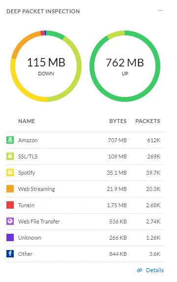

That is a disturbing amount of data going to/from Amazon. Hopefully it's just misidentifying AWS as Amazon.
It's definitely going to be AWS. Rivian has been clear so far, about using AWS for analytics on the vehicles. 700MB is actually pretty low for an EV/Smartcar. These things will be screaming data with more miles driven and use of Driver+.

So i did some digging around on my network today. It seems the Rivian software is android based and hopefully this could lead to bigger things. Ignore the phone picture, it's just what Ubiquiti assigns to Android.
Also i looked at the packets it's sending and here's what it sent after a few days:
Amazon could be the gear guard video, the diagnostic logs, or other random information. This data was sent BEFORE i turned Alexa on.
I'm going to keep digging through my pihole and see if anything else interesting comes up.
What the heck is Facebook doing in that list??
I hope it was due to your preference or conscious decision to either use them for some saml or Oauth login option (for some other app)?
I hate Facebook (and all it's services) and hope there is no passive data sharing or telemetry with Facebook services.
