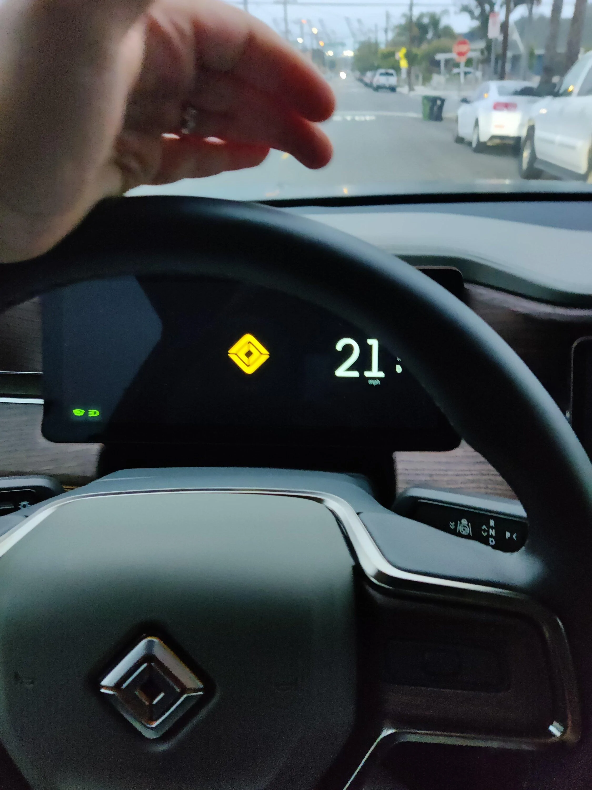

Any one run into this issue before? While driving to work the r1s just decided it needed to reboot.
Kinda scary when driving and your whole car shuts off. Stereo system, screens, etc.
On the bright side the vehicle remained operational on basic functionality, such as acceleration and braking. I have no idea if I could have shifted to park or if the vehicle lights (brake, headlights, turn signals, etc) were working.
I submitted an issue ticket with rivian but based on my service experience so far with rivian I have little faith they will even look into it and provide anything besides an "it's normal" response. Sorry for the crap photo but I don't use my phone while driving and it was difficult to snap.
Edit: after looking at my photo it appears the lights work and the shifter info was displayed. It looks like this is a backup computer system that does the absolute basics of vehicle driving while the main computer reboots.
