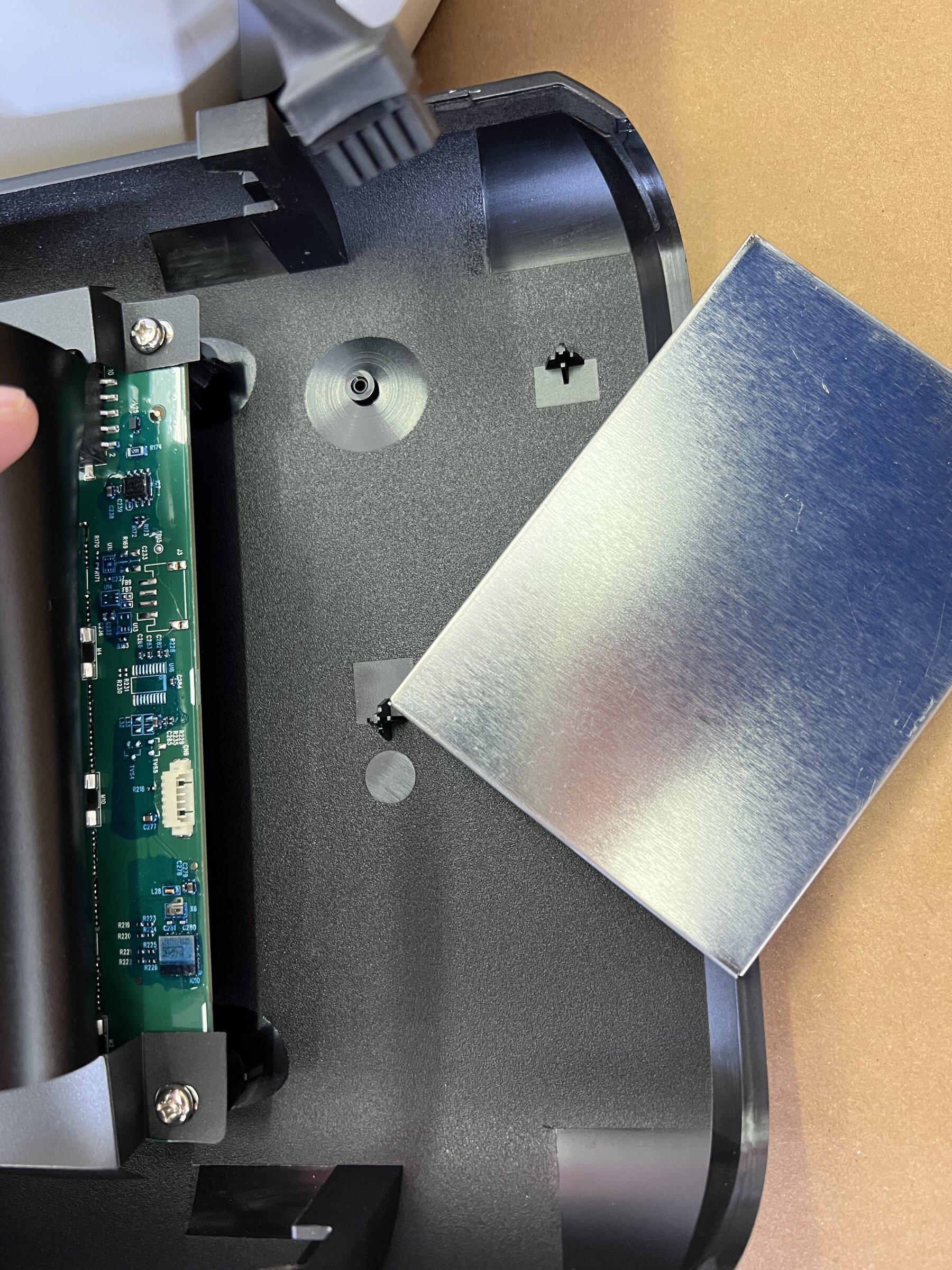

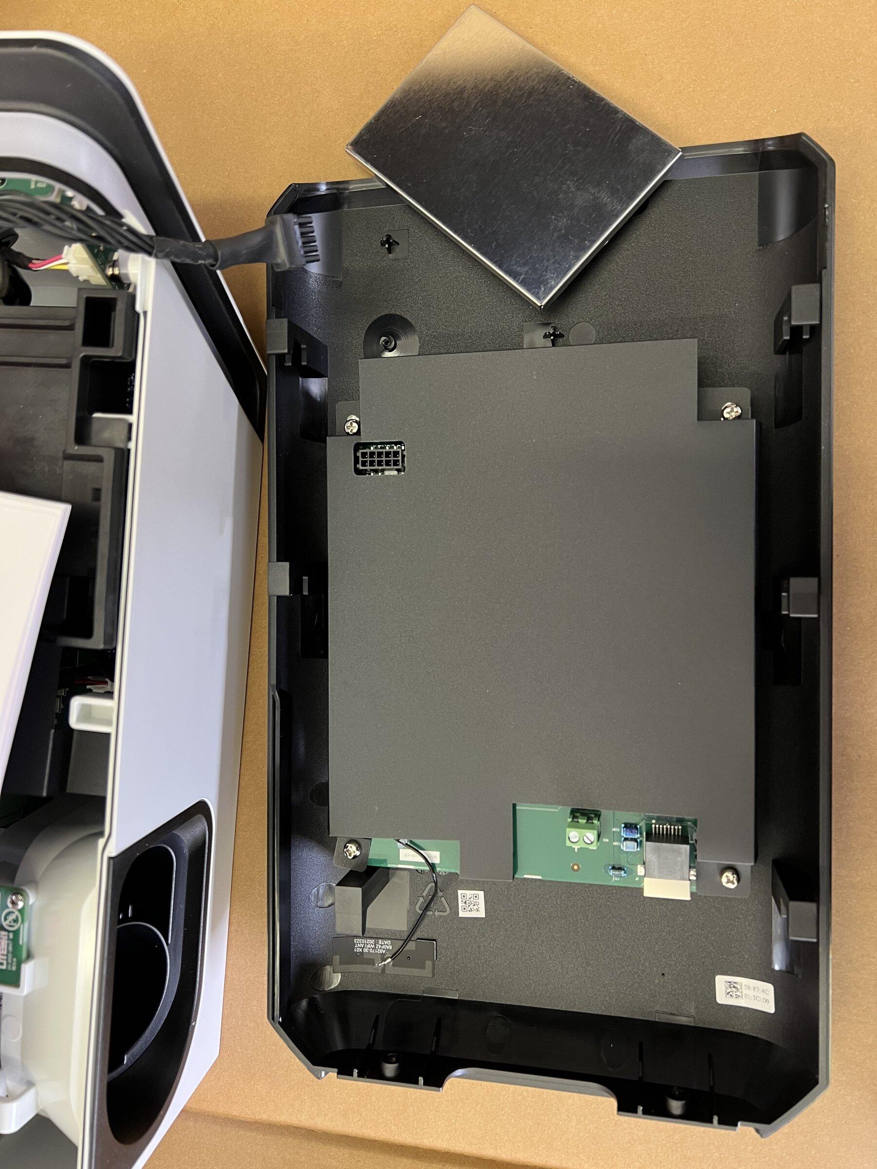

When I went to install my charger yesterday the network plug was not connected, which is easlily fixed, but there was also a metalic shield loose in the unit, picture 1&2 below, anybody got a picture of the inside of their 'working' unit? as looking at the charger manual, picture 3, there apprears to be another circuit board in the charger that is missing from my unit. Rivian support are currently looking into this as well.

I didn't plug the network board in while finishing the install but I watched the electrician do it. I hope a missed connection isn't the case for me. I'd think Bluetooth is on that board too and I connect via that fine.
