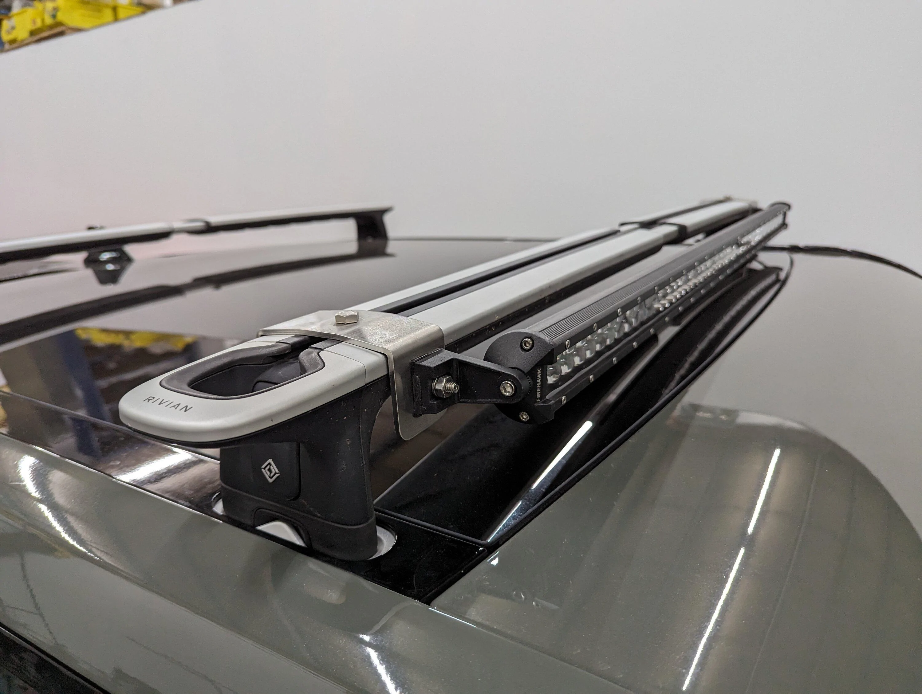

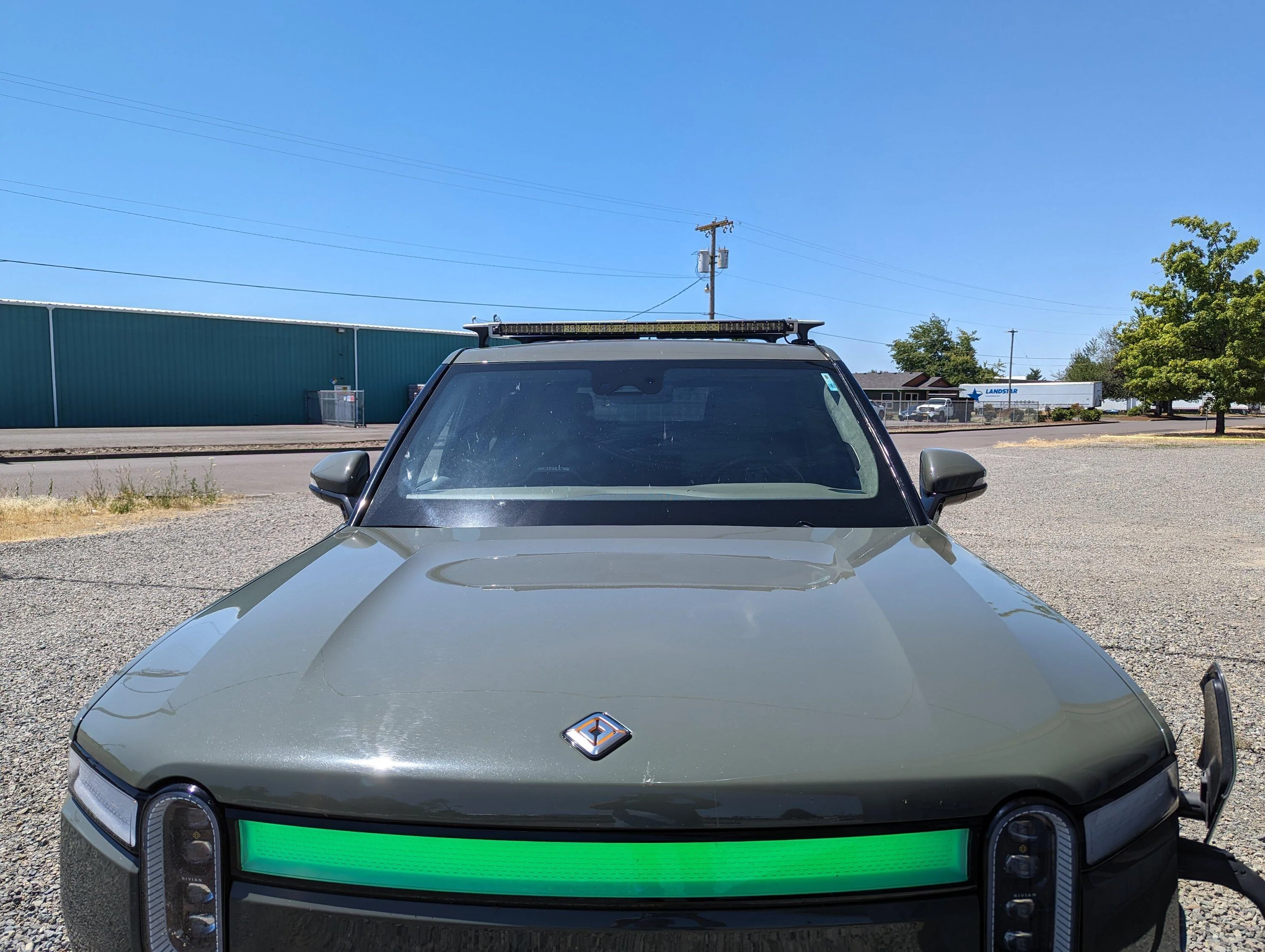

They are ok, but it is unlikely that they will mold one for the R1's. The demand just wouldn't pencil. If you are interested, I added a light bar to my front cargo bar. Top of it sits just below so I can still use the bar.

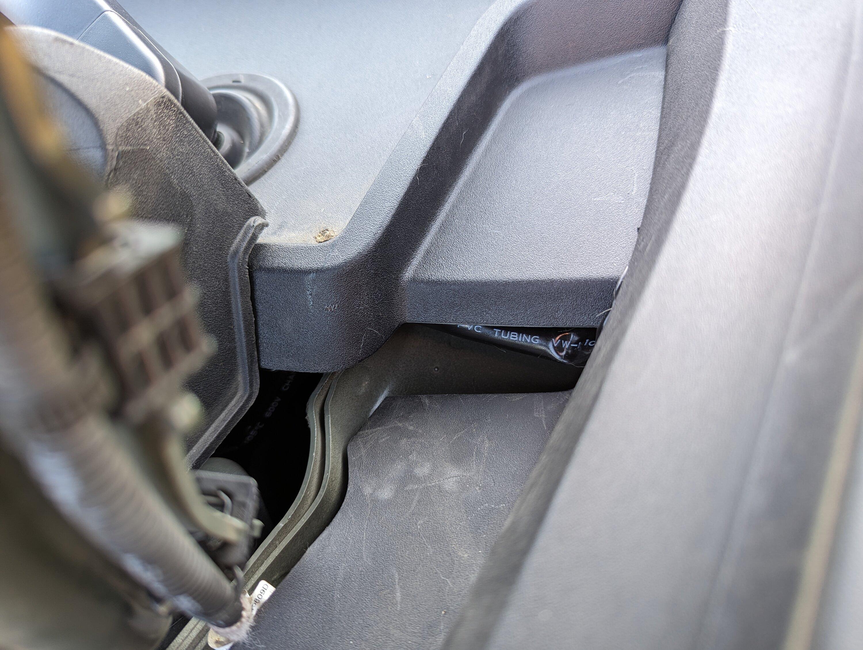

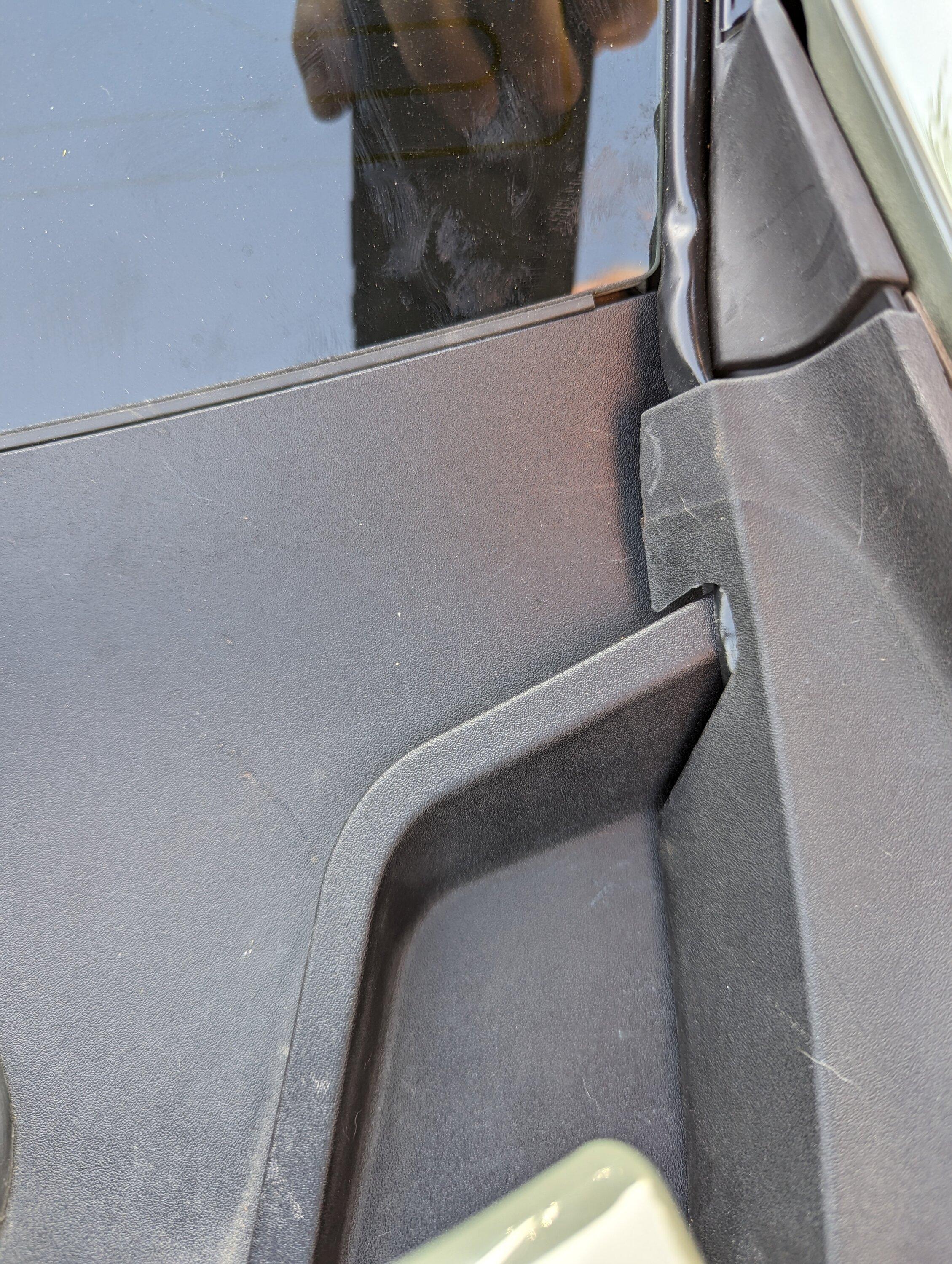

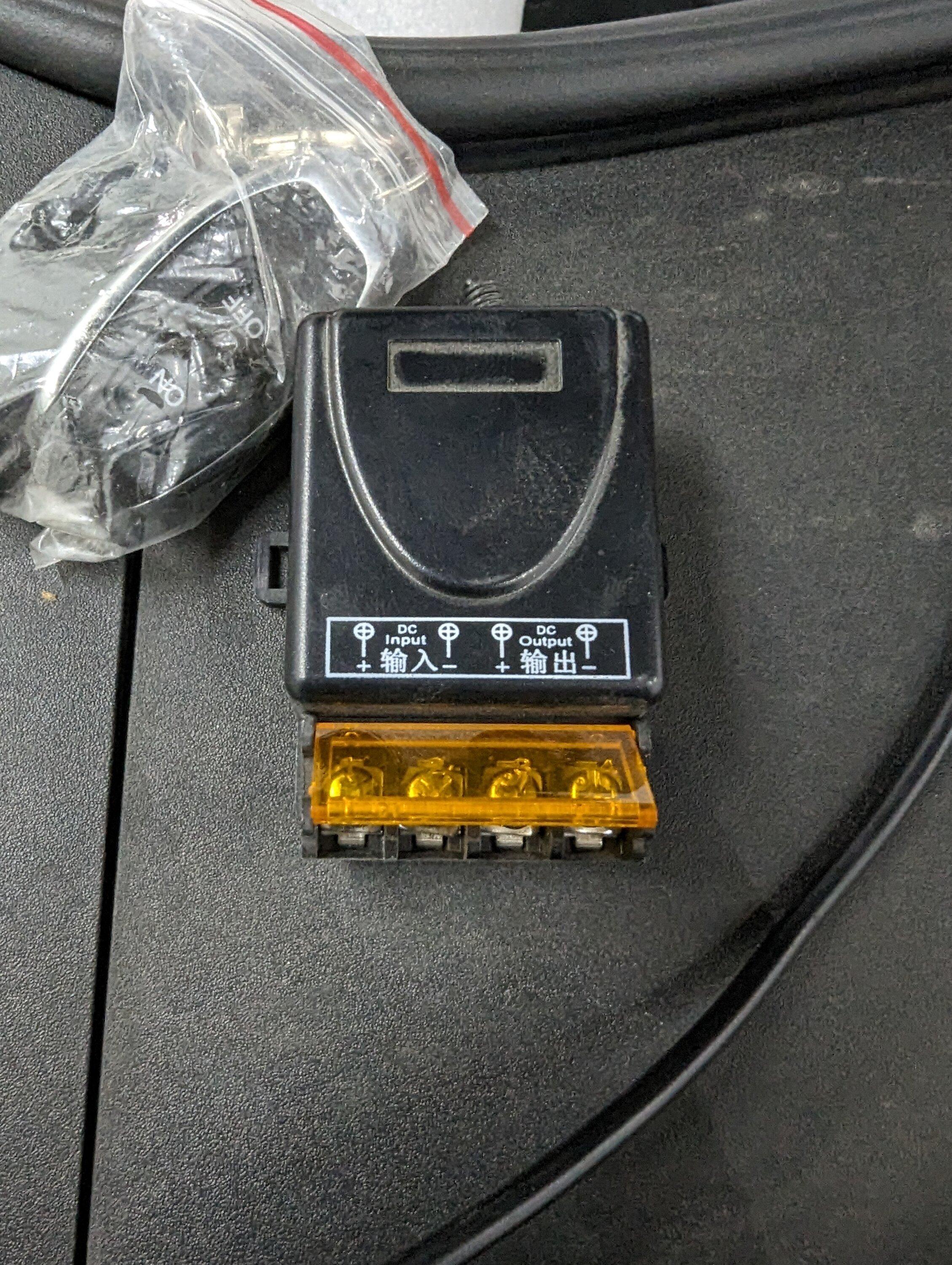

The cable fit very nicely in the slot next to the windshield. Then I just pathed it thru gaps in the plastics to behind the frunk where the 12v batteries are. I have a wireless switch under the with a fob switch inside the cab.

How did you mount the light bar to the crossbar? Do you have a link or is the mount custom made?
Also did you have to run a wire into the interior or just have a wireless go controller?
I made the bracket to mount them, that you see in my photos. I own a metal shop and can make sets for anyone that wants them.
As for the wiring, I ran it down the edge of the windshield (tucks in there very nicely) then routed it under the plastics to where the 12v battery area is. I used a wireless switch in there so there was no having to

Nice! Do you have a link for the wireless switch or any info for the install?
I would definitely be interested in the metal. I’ll shoot over a dm!
This is the one I purchased, but there are many out there. YETOR Remote Control Switch, DC 12V/24V/48V/72V Wireless Switch for Anti-Theft Alarms, Security Systems Roller Lind Door. https://a.co/d/8wgjglK

This is my "work in progress" setup. Unfortunately didn't have much time to finish the wiring, but my plan is to tuck wires in the panel gaps, and use wireless switch as well.
The idea is to mount them during off road trips, and remove during everyday driving...
