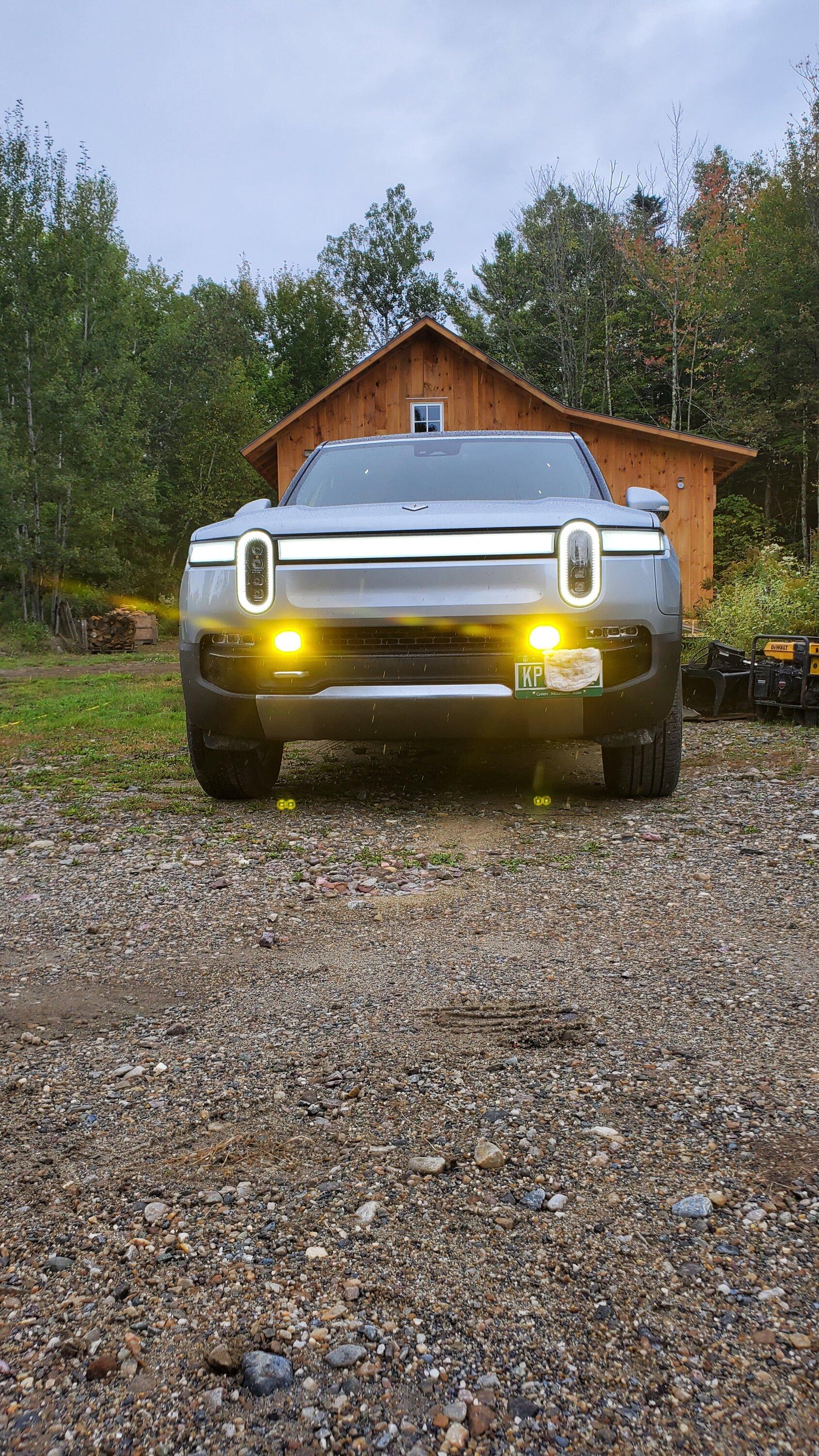

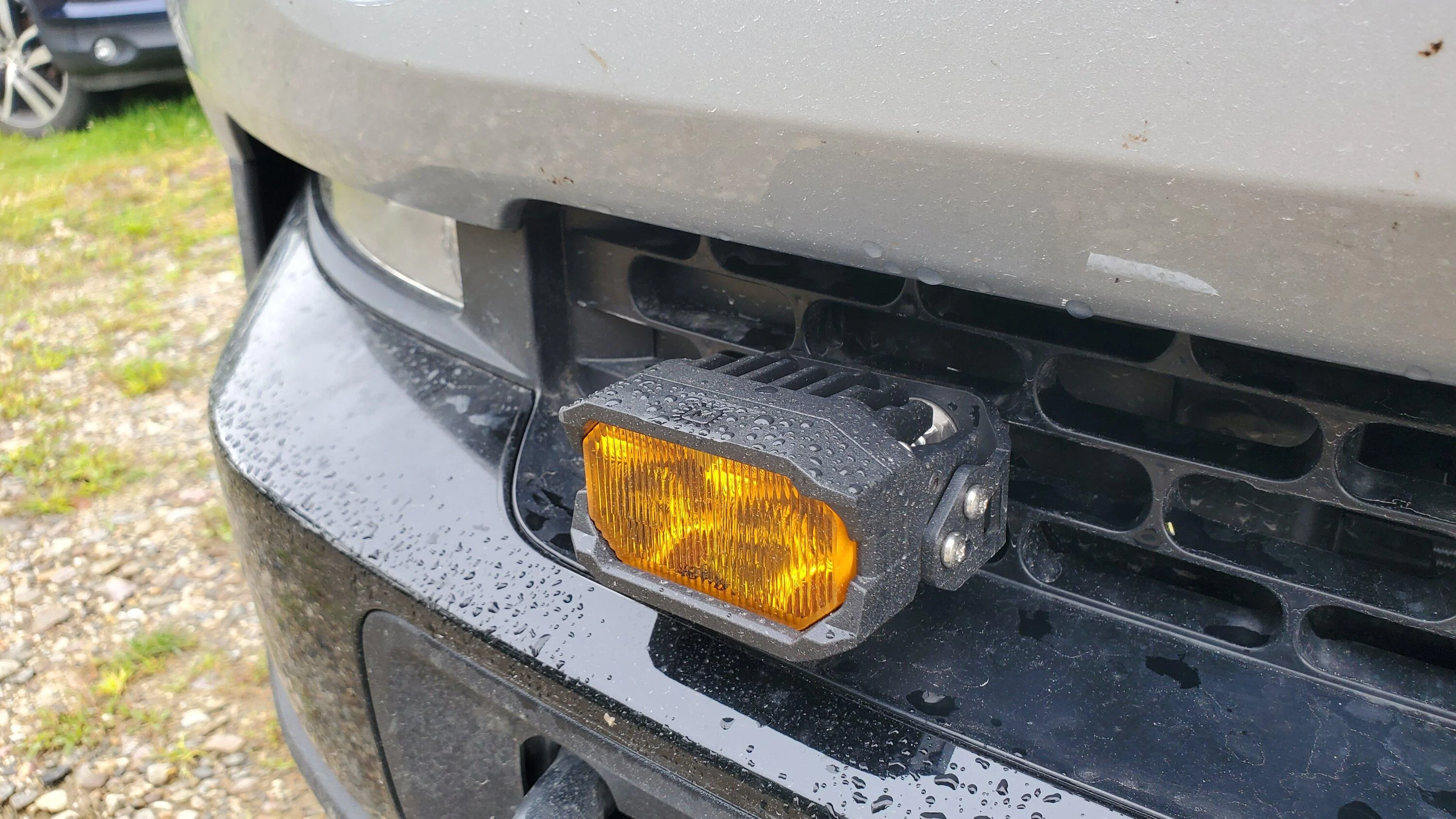

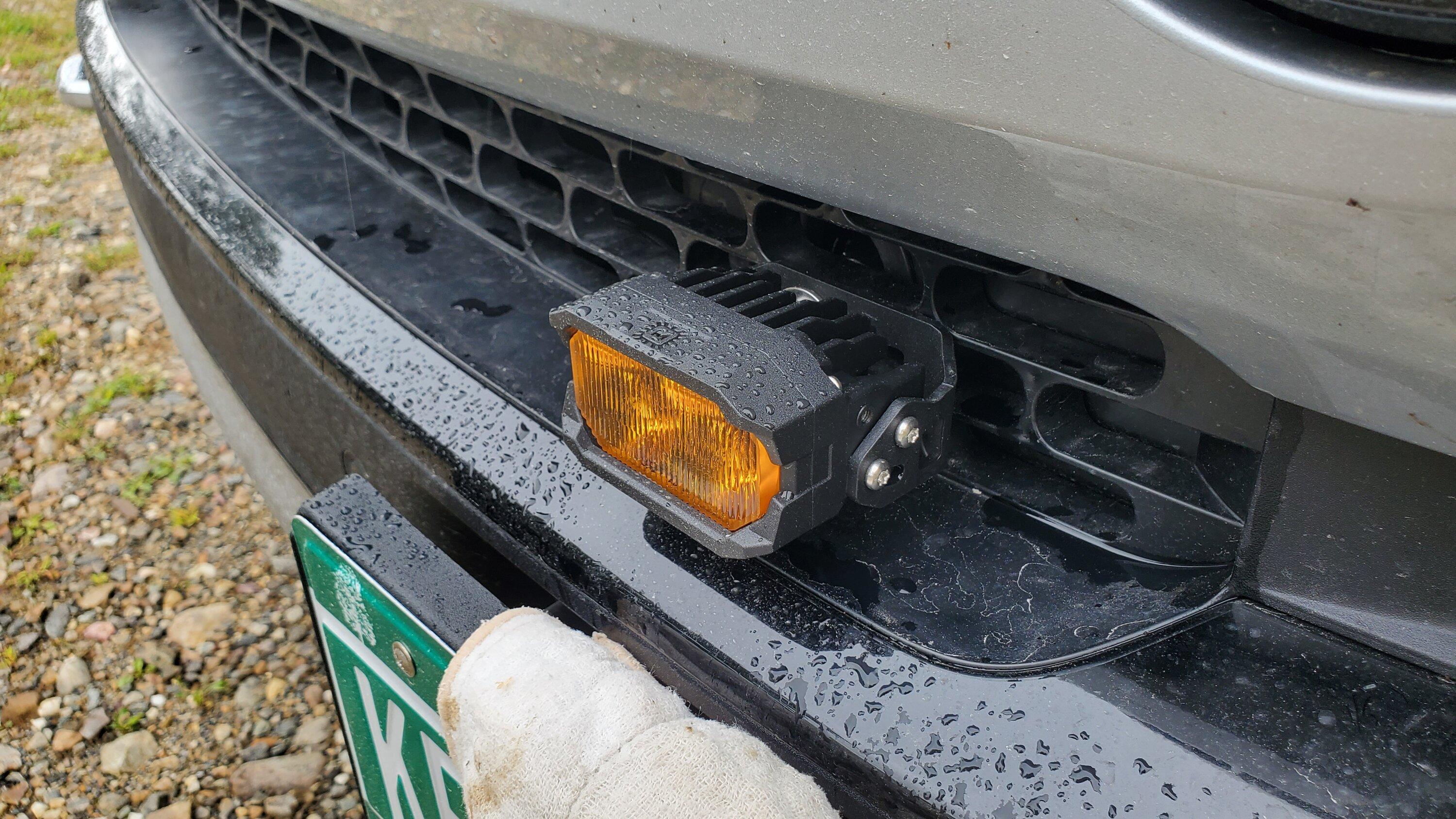

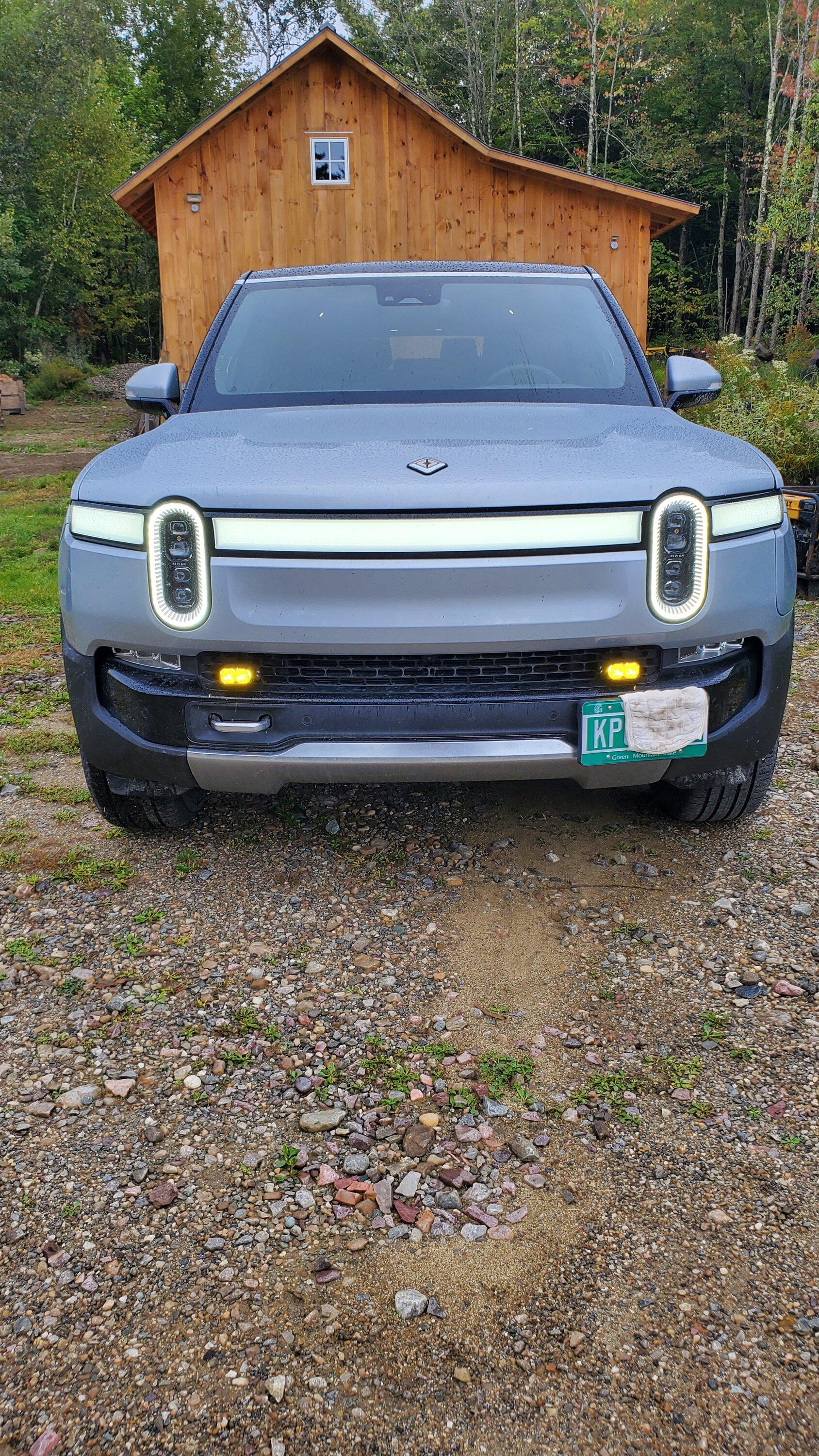

I installed a set of Morimoto 2Banger Amber SAE Fogs like this...
I used the supplied Morimoto brackets, a pair of stainless, cut-to-length (about 1.25") 3/8-16 carriage bolts with galvanized anti-turn washers as the behind-the-grill support. No permanent grill mods needed, only hole is for the wiring behind the passenger side light.
These and the in-process roof-mounted ditch lights are switched through a Trigger 4 Plus mounted right of the cabin air filter under the trim panel.
I'll get some night pics soon.
Overall, I am very happy with the addition.
That's exactly what I was thinking of. I'd be interested to hear more about the installation. I assume that you are wired directly to the 12 volt battery.

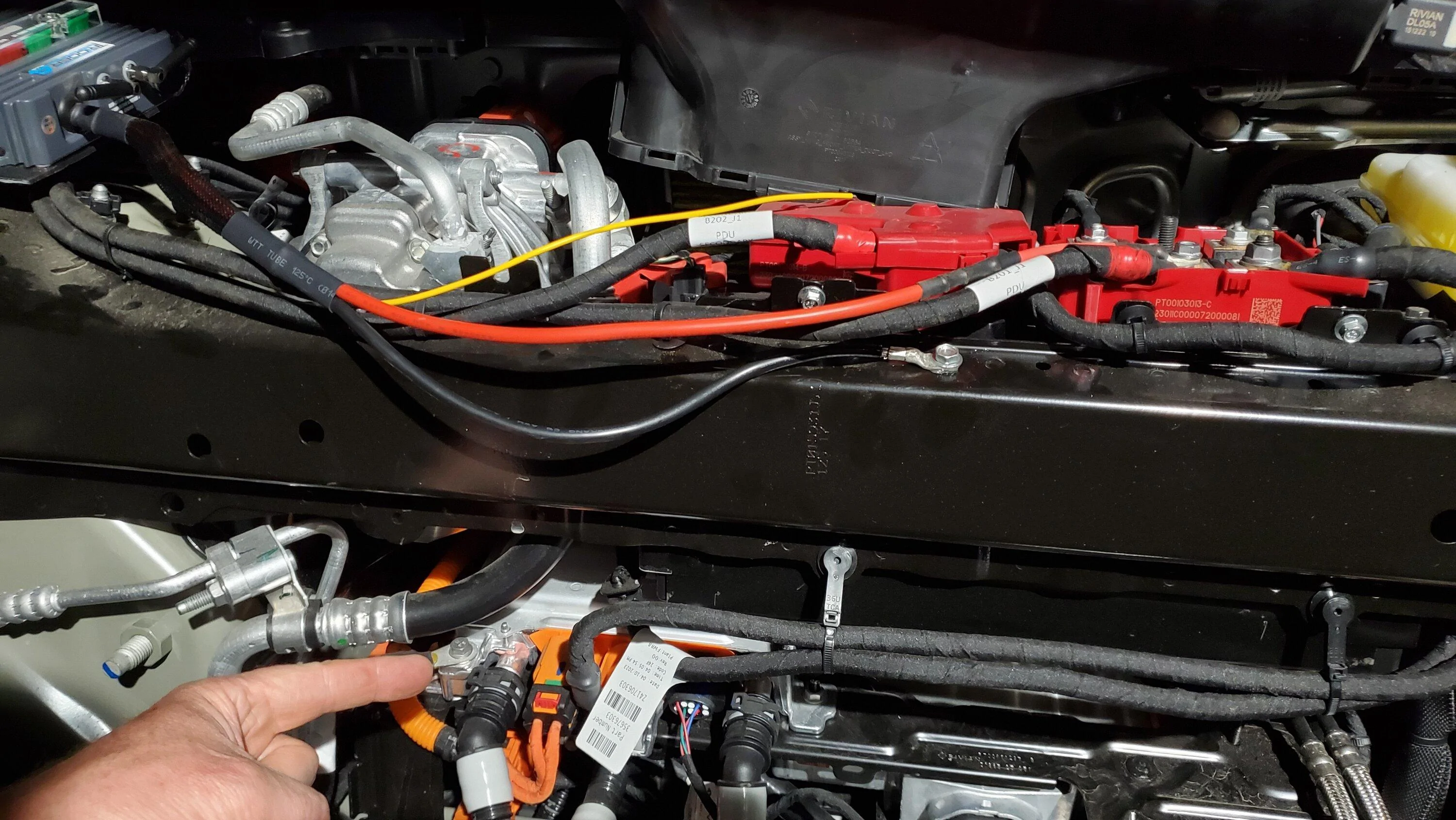

Here is my power wiring. I drilled and tapped a ground in the cross-member before seeing the ground strap I am pointing to in the picture. On the battery, I connected to the Primary PDU lug. There are multiple options for lugs that all tie to 12V primary battery.
I routed 12V switched power from the 12V lead for the frunk power outlet. Connector is above the driver front wheel and, AFAIK, exists on all vehicles regardless of frunk 12V port status.

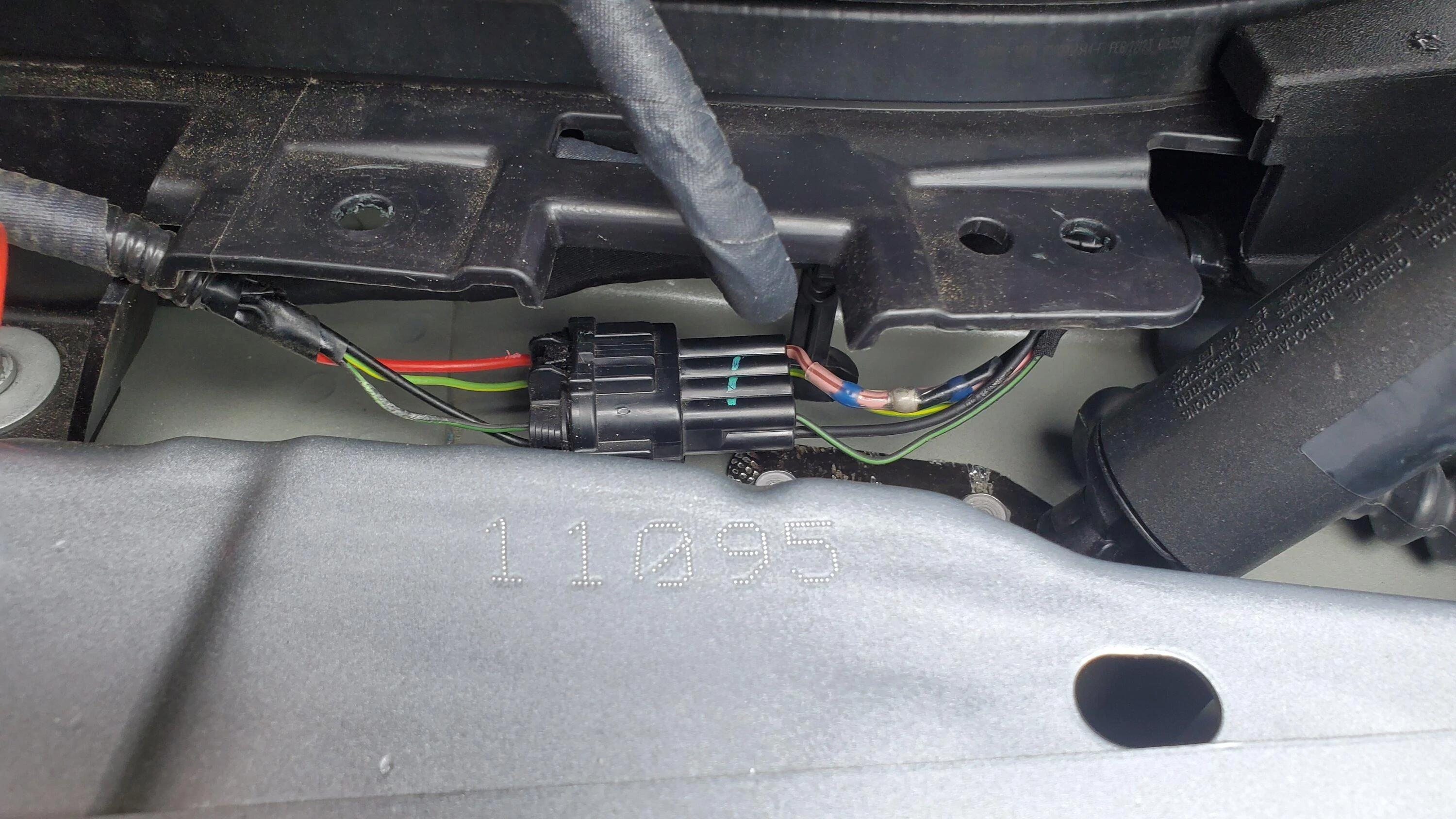

Switched power came from the pink wire on this connector.

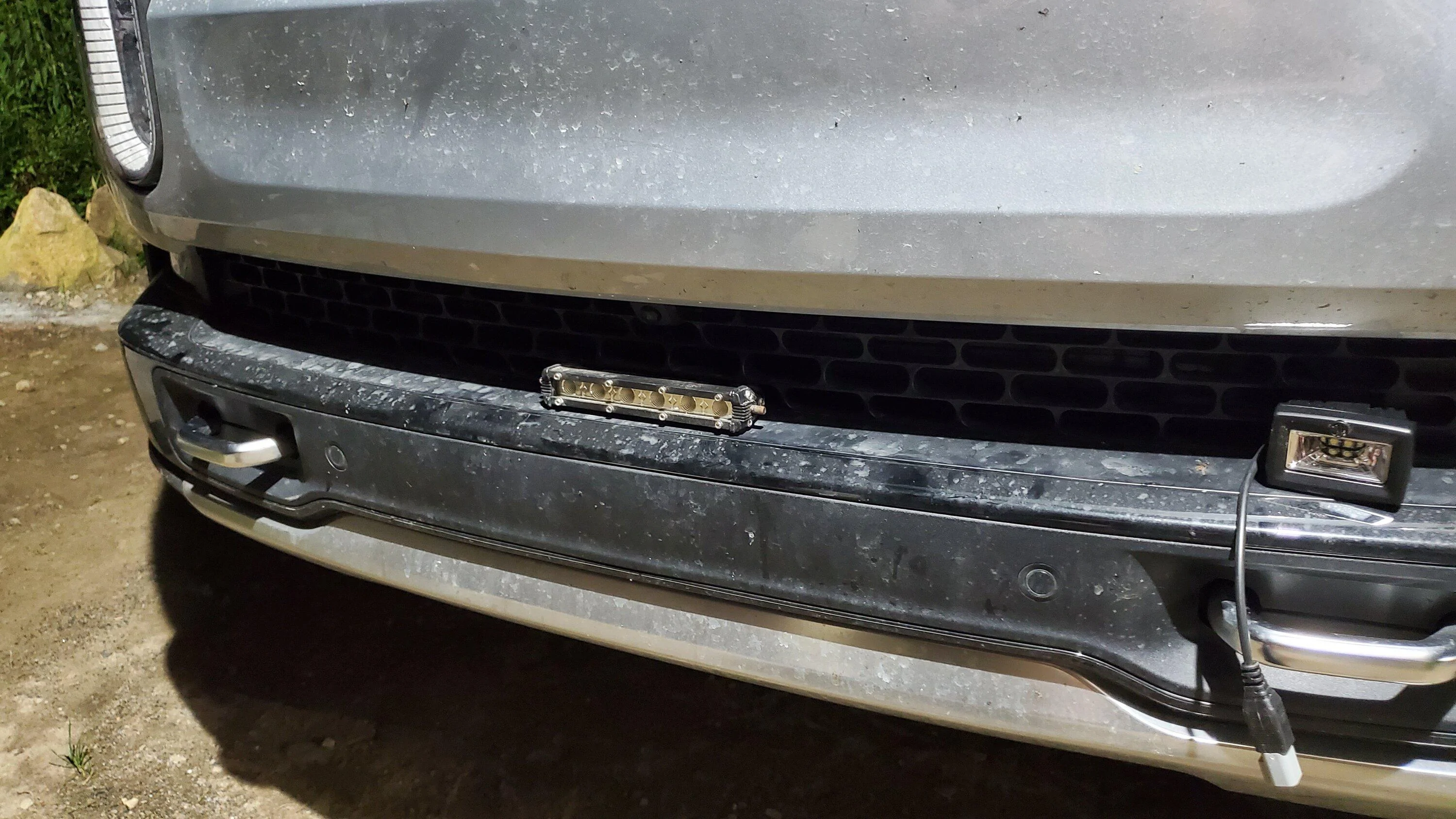

I wonder if a light bar with dual function would work in that area. There are a couple that make bars that have amber on the sides and white for the center. That would be really practical and your switch set up would simplify the install.

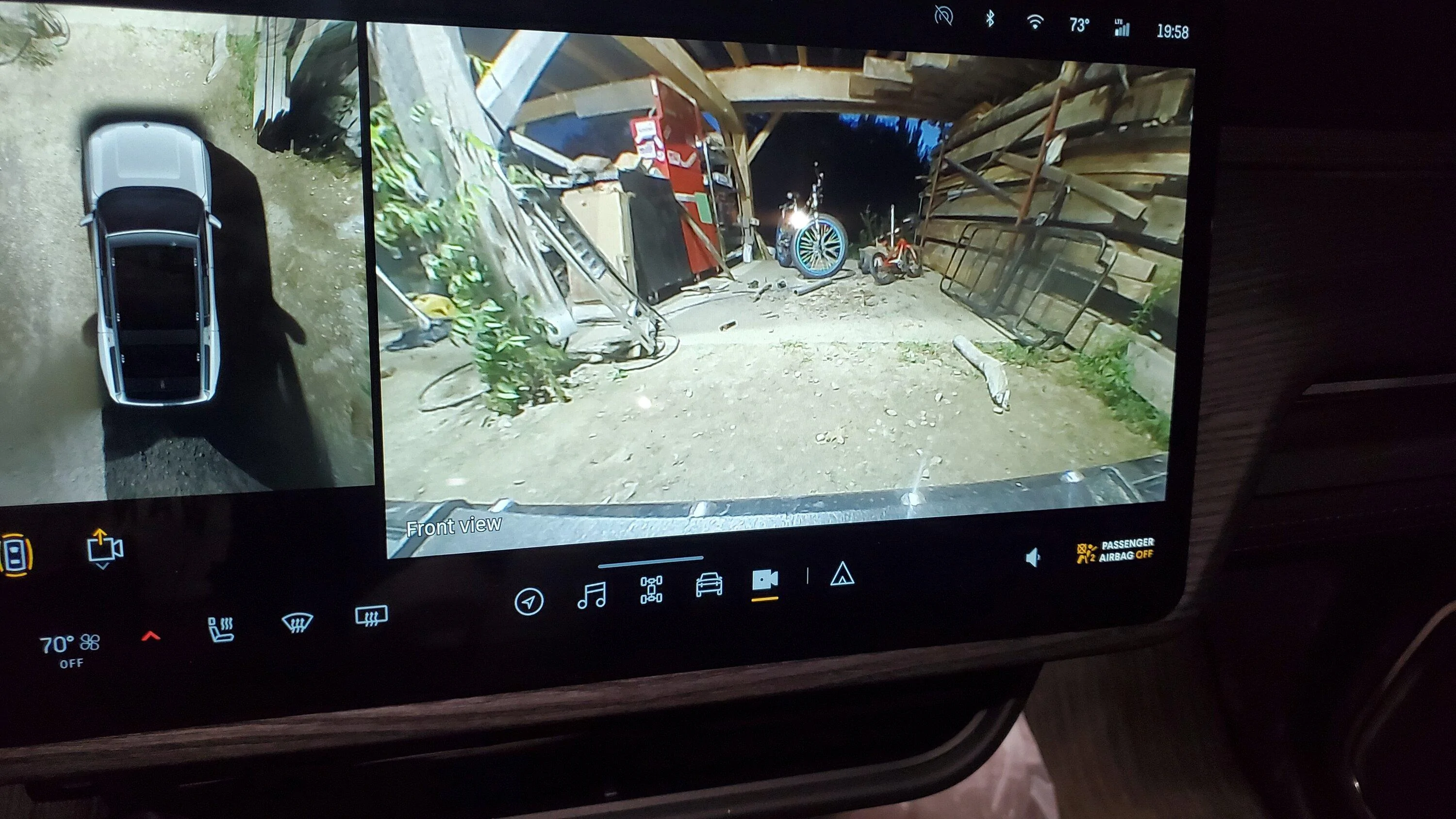

It could. I test fit a single row LED bar under the camera and it doesn't obstruct the view any more than the bumper. First pic is the light set on the bumper. Second is camera view.
