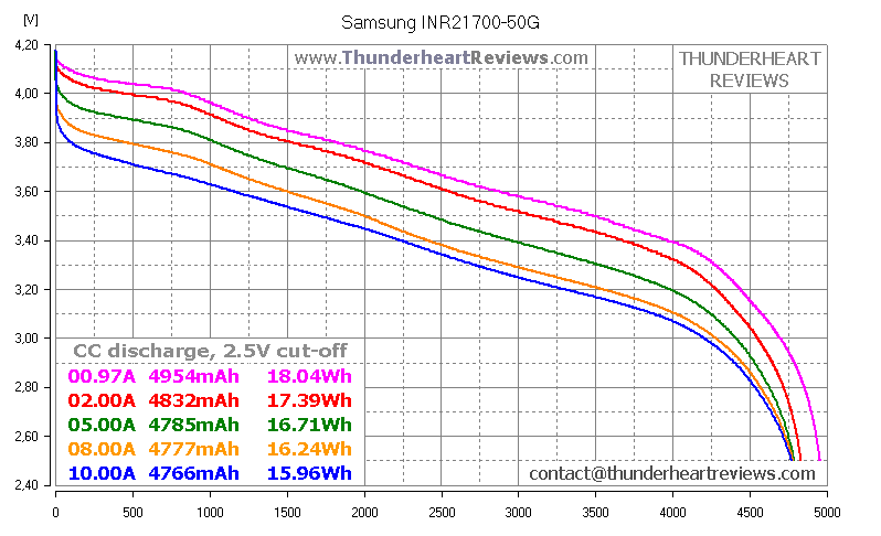

Looks like they are using the Samsung INR21700-50G Lithium-ion cell.
INR21700-50G
Minimum capacity: 4850mAh
Nominal voltage: 3.6V
Standard charge current: 1.6A (0.33C)
Charge cut-off current: 121mA (0.025C)
Max. charge current: 4.85A (1C)
Charge end voltage: 4.2V
Max. discharge current: 9.7A (2C)
Discharge cut-off voltage: 2.5V
Max pulse discharge: 14.55A (3C)
AC impedance at 1kHz: 14±5mΩ
Max weight: 69.5g
The math works correctly out for that cell:
4.85Ah X 3.6V = 17.46Wh
7,776 cells X 17.46Wh = 135.8kWh pack capacity
Here's test results of that particular cell compared to two other Samsung cells:
https://www.thunderheartreviews.com/2021/12/samsung-21700-50G-48G-50E-test-comparison.html
If you want to skip to the results... the cell Rivian uses is excellent!

Here's the discharge curve for the 50G cell Rivian uses... one picture is worth a thousand words for sure.
The green plot line is closest to 1C discharge rate. If Rivian is claiming 135kWh pack capacity that should be at the advertised 1C cell discharge rate which means they will have to charge the cells pretty close to 4.2V and discharge them down close to 2.4V to get 17.36wH out of each cell (17.36wH x 7776 cells = 135kWh).
If the 135kWh pack rating is for discharge at less than 1C rate then they can use lower cell top voltage and higher bottom cell cutoff voltage as shown by the magenta plot line.
