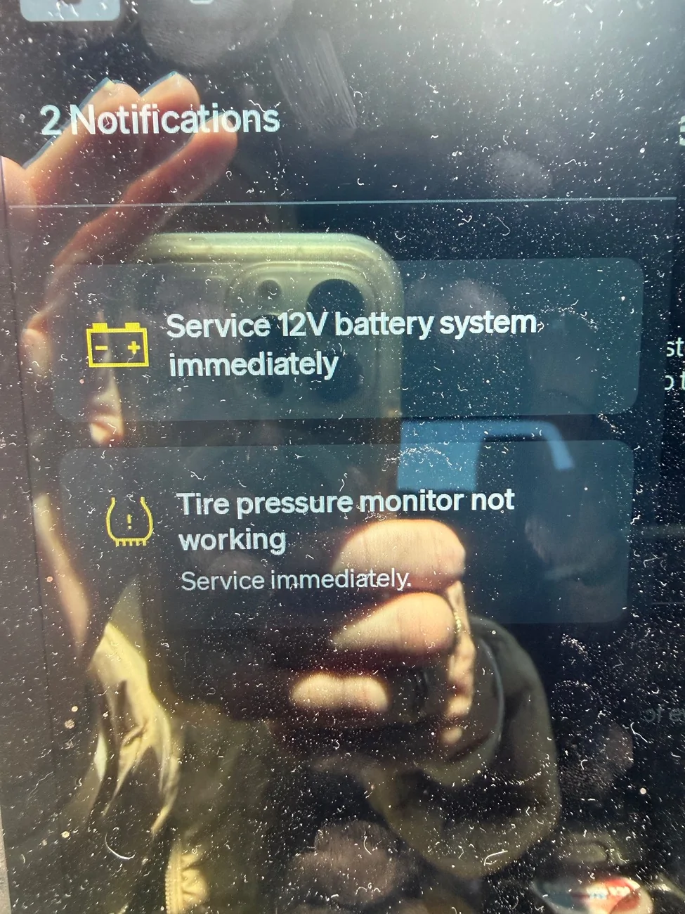

As someone who just got this warning last night for the first time, I would very much like to know this as well... I am considering just replacing myself after setting up a service appointment and being told they cant do it mobile because the work requires the use of a lift, in the shop, which from what I understand is complete horsepoop.?

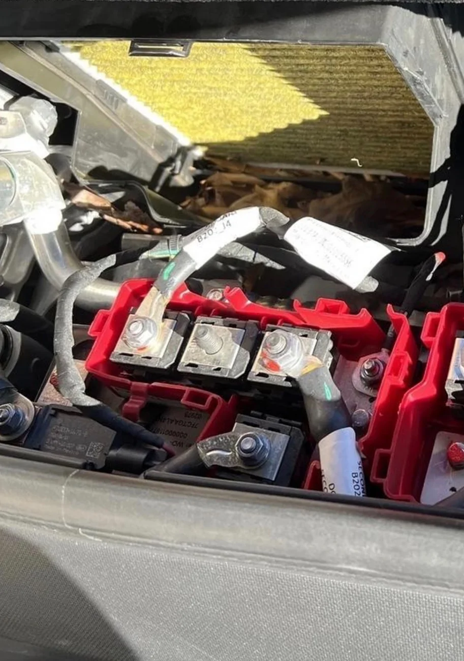

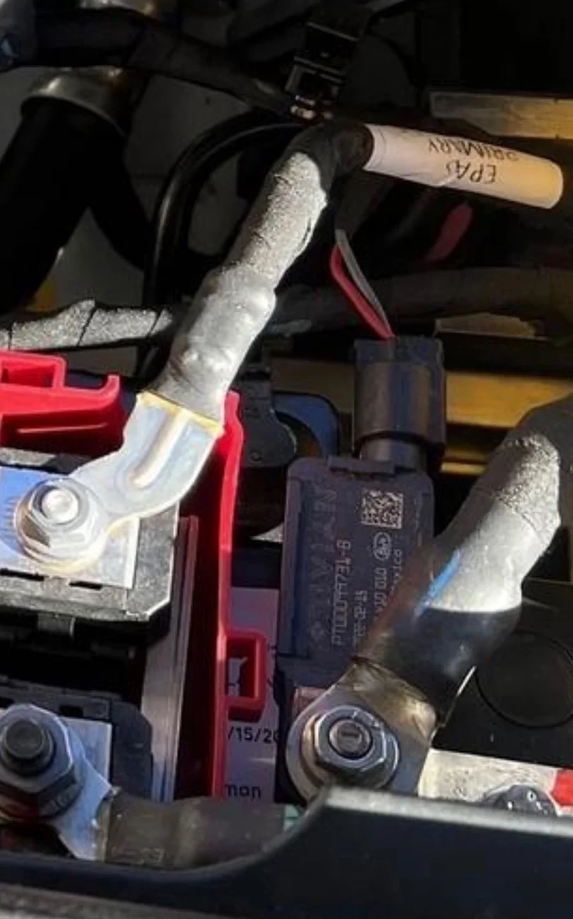

Well, just got word from the service center.
Turns out the problem was not a “faulty sensor“ but a loose wire to the secondary 12V battery originating at the fuse box.
How it go loose is up for discussion but I did take it in previously to get the HVAC system repaired according to their Customer Satisfaction Campaign Bulletin RCA-26-24-002-1 which could have involved the very area where the wire/fuse box is.
