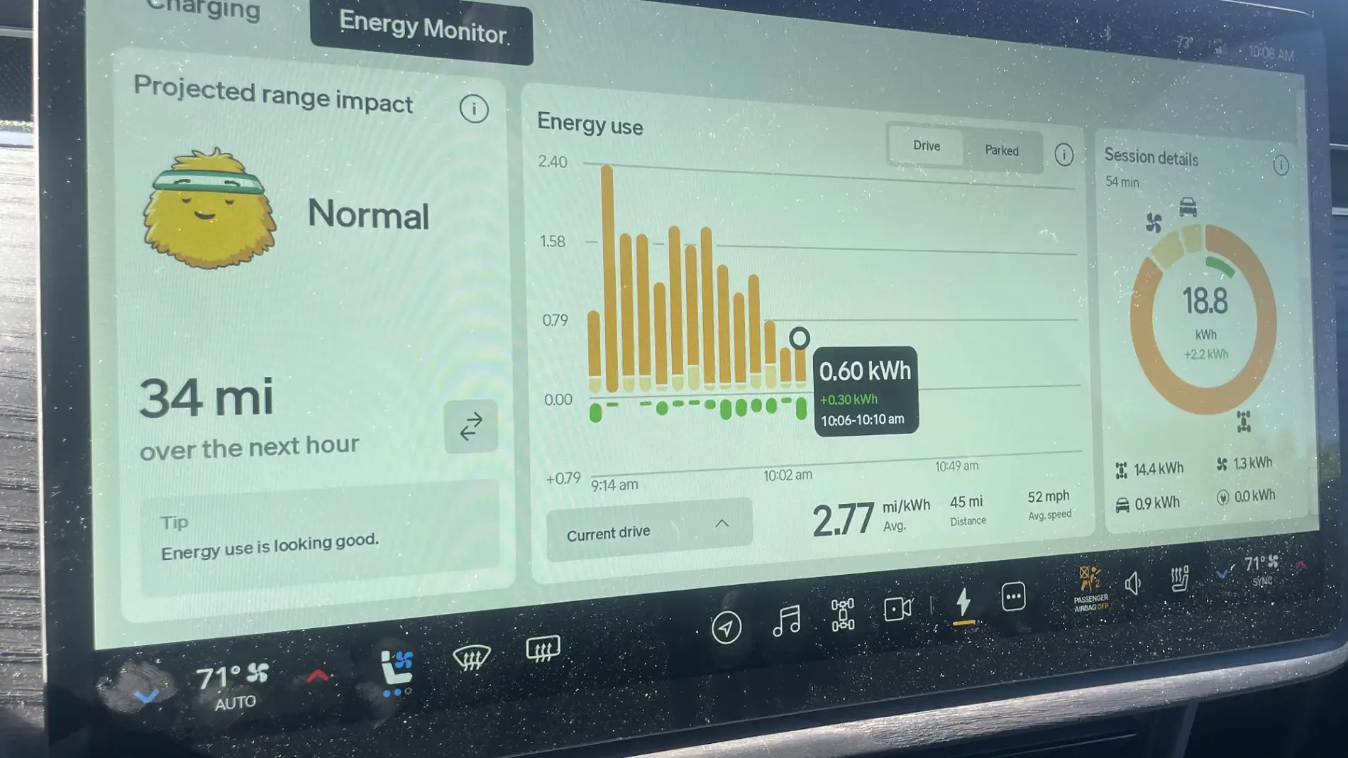

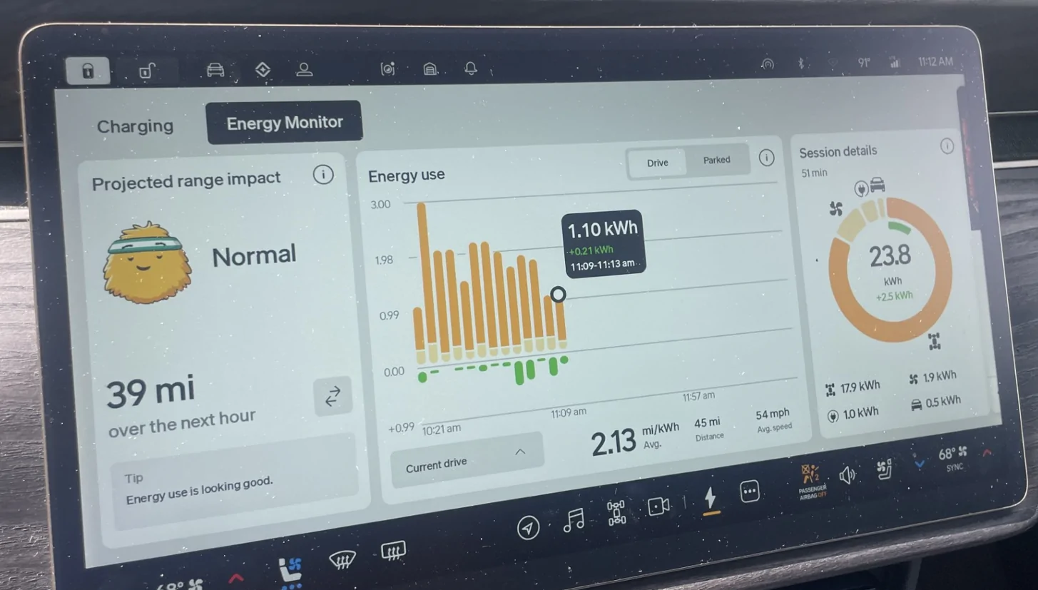

  • Efficiency was noticeably better on my comparable commute (photos below).
After a week with the Gen2, I actually felt less urgency to upgrade. Efficiency and autonomy would be the two big things that could convince me. The efficiency gains are impressive, and they give me confidence Rivian can achieve the R2's efficiency targets.
Gen2

Gen1

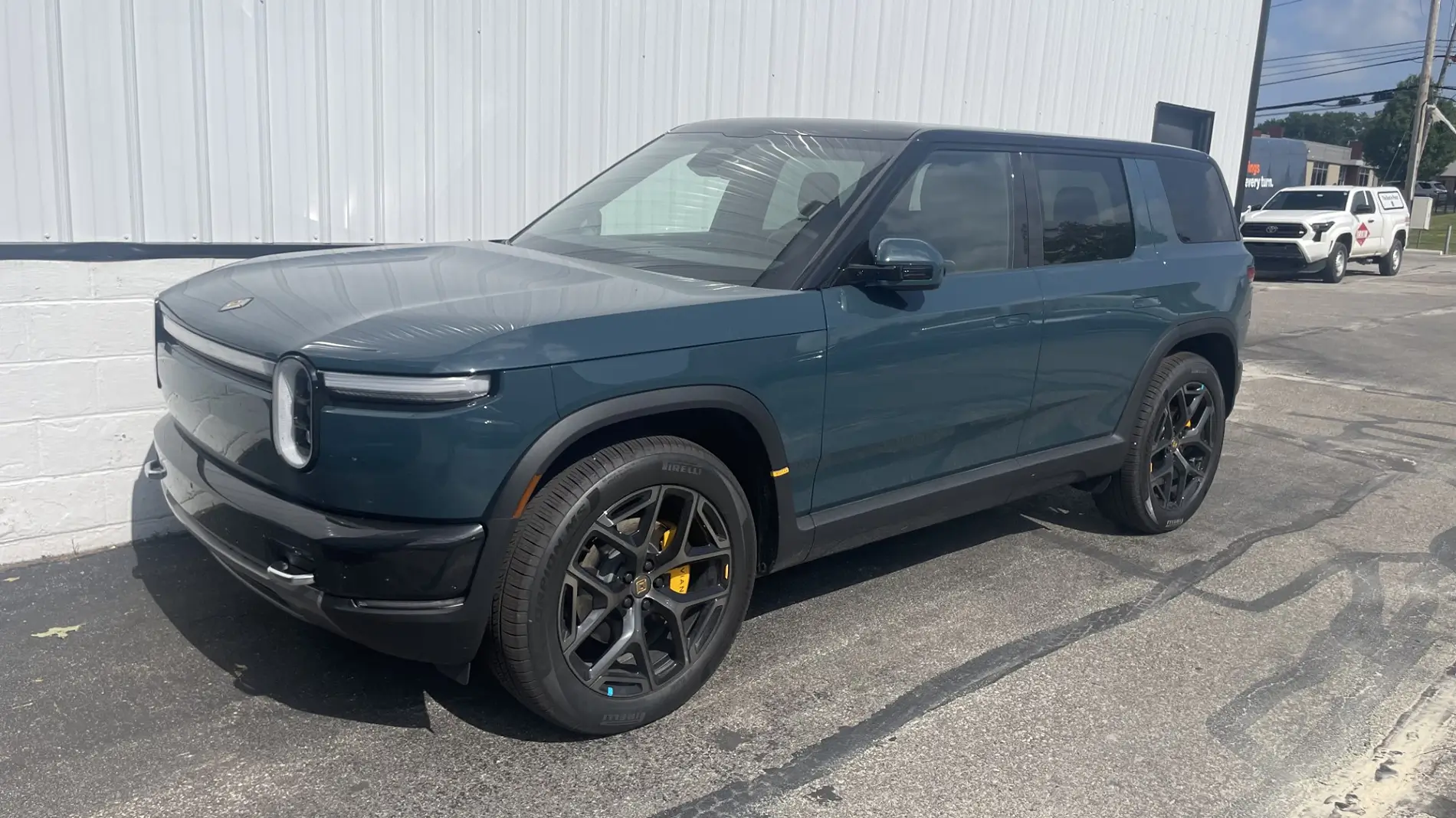

Ohio's franchise laws mean our service centers can't demo or sell R2s, but I did get to see my first one in Catalina Cove waiting for customer delivery. It's a great-looking vehicle, and I'm still torn between keeping the R1S a while longer or moving to an R2.

@oliv3r Is this your R2? I should've taken a picture of the VIN, but was in a hurry.
oliv3r
Feb 18, 2025
Cleveland OH
2023 R1S
Not sure, I don't have a VIN or anything scheduled yet. This was at Cleveland or Columbus service center?
Cleveland
