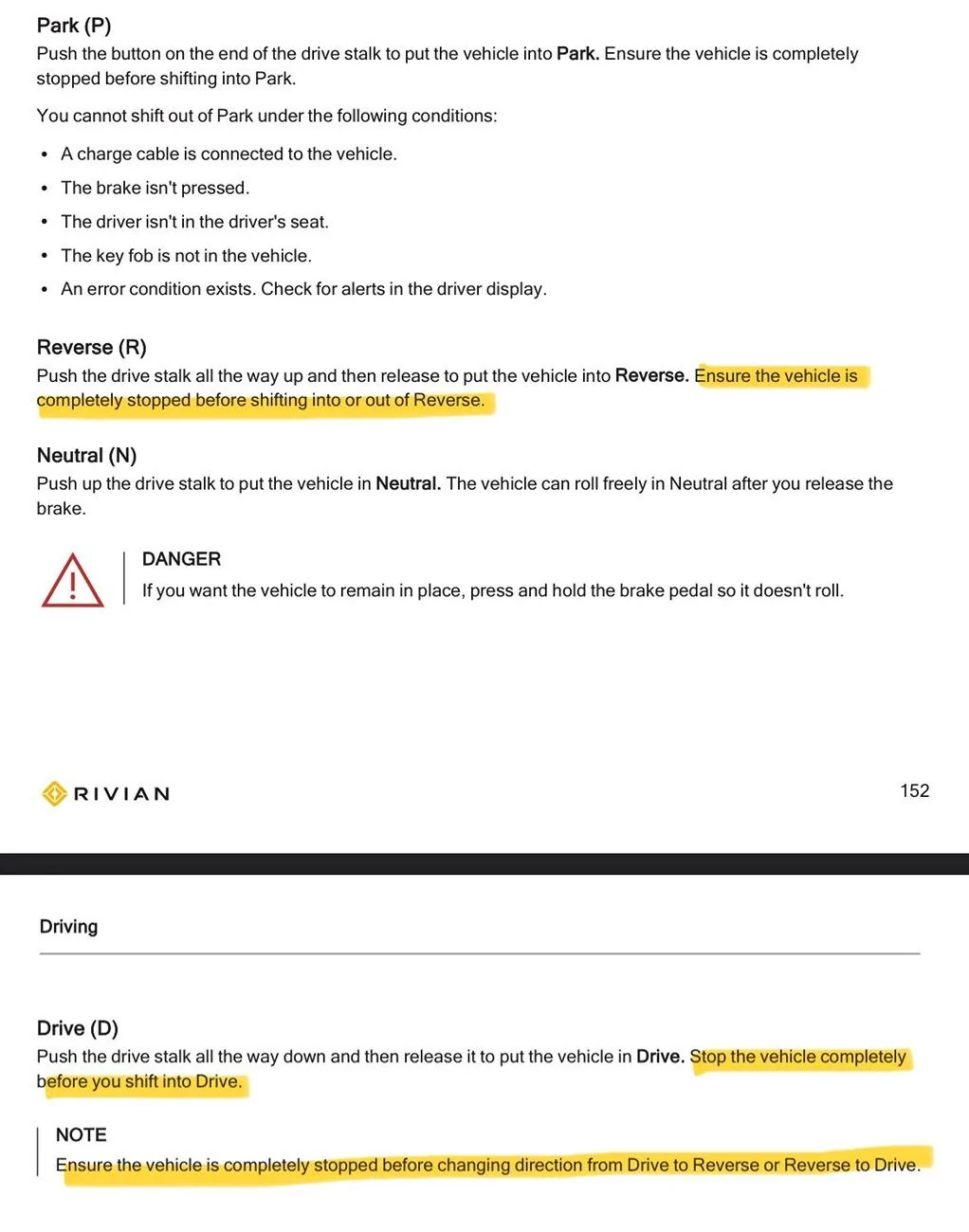

Well I found the answer in the owners manual. Guess we all need to listen to My Great Uncle!
Is that for safety or to prevent damage to the vehicle? The computer definitely prevents it at a certain speed threshold.
It doesn’t say, but my assumption is that doing so consistently over time can slowly damage the drivetrain.
For the record, I do it all the time out of parking spaces. It’s quick. It’s fun. But every time I did it I wondered if it was bad for the vehicle. Now I know the manufacturer warns against it (3 times!), so I’ll try to stop doing it.
