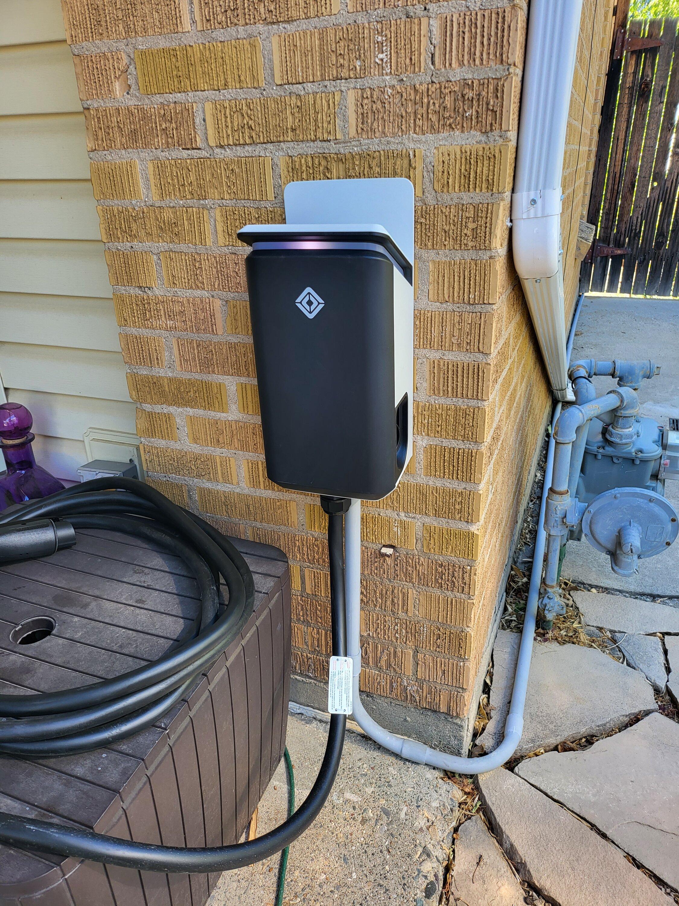

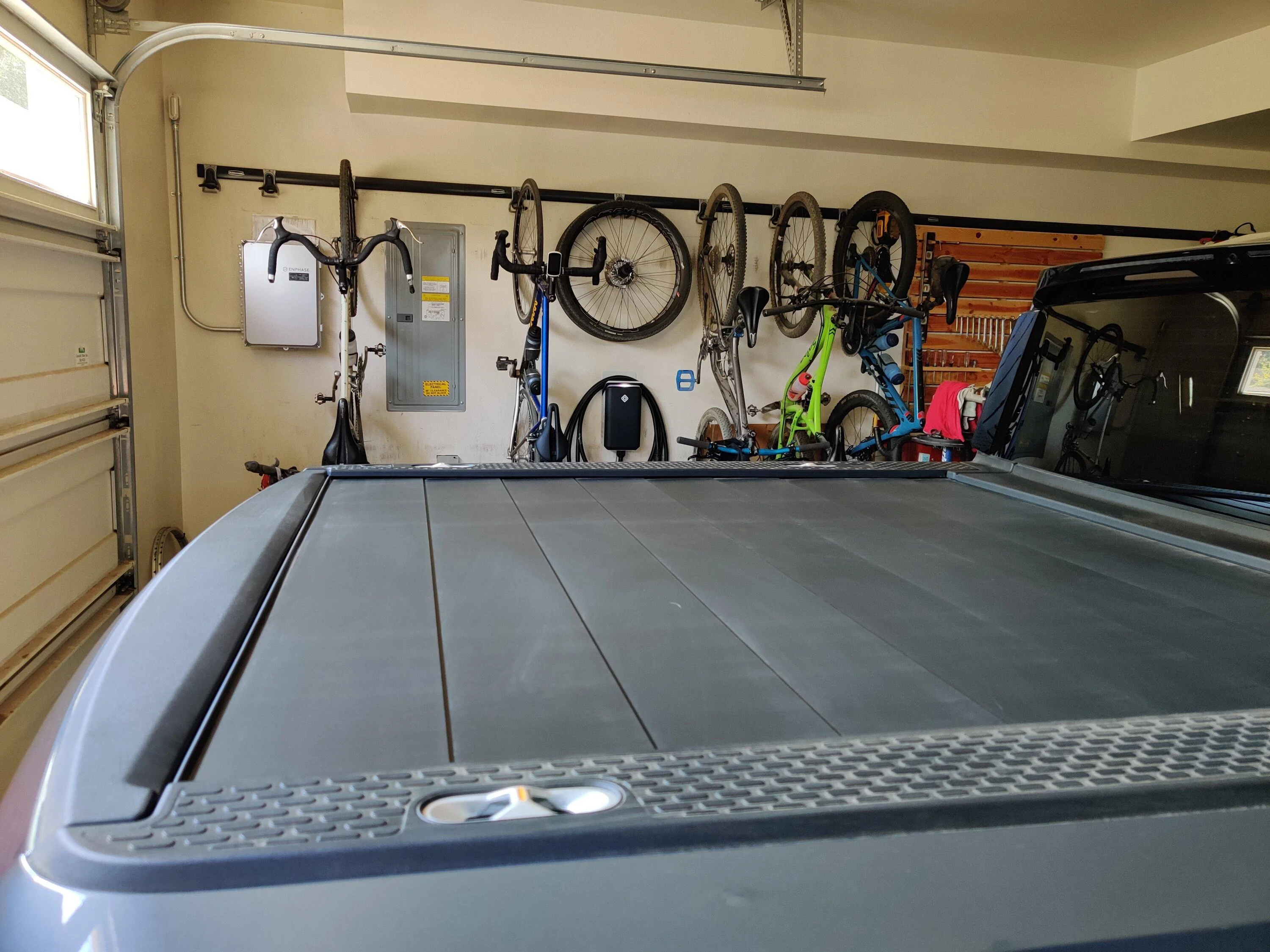

My friend and I ran approx. 25 feet from main panel at back of house and had it up and running in 3+/- hours. About $175 in wire, conduit, etc. Gonna install another one in garage on Bear Lake.

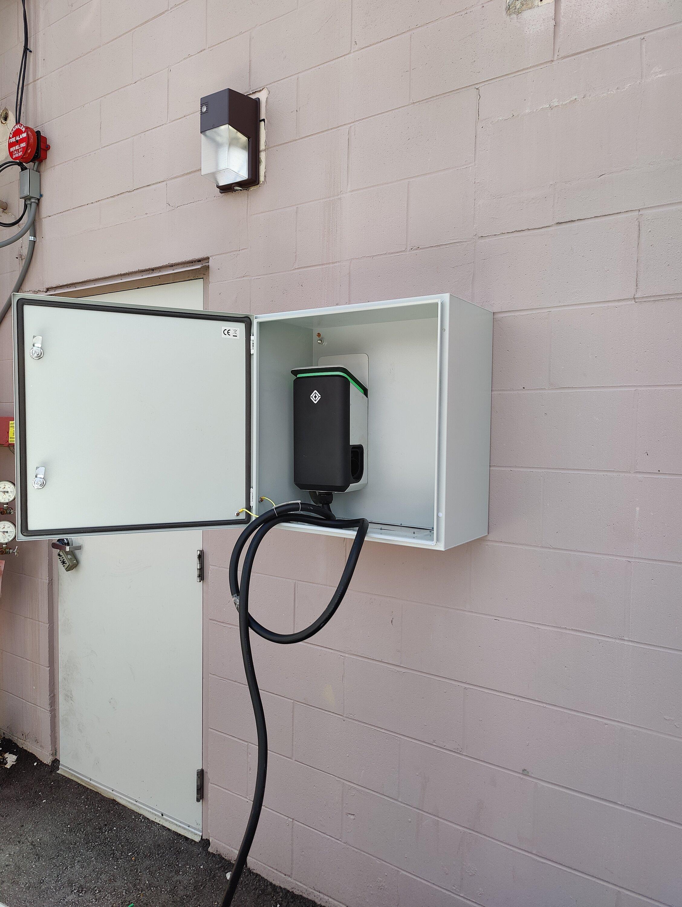

Rivian R1T R1S Show off your Level 2 Home Charger installs here IMG_20220901_145238
Rivian R1T R1S Show off your Level 2 Home Charger installs here IMG_20220901_145200

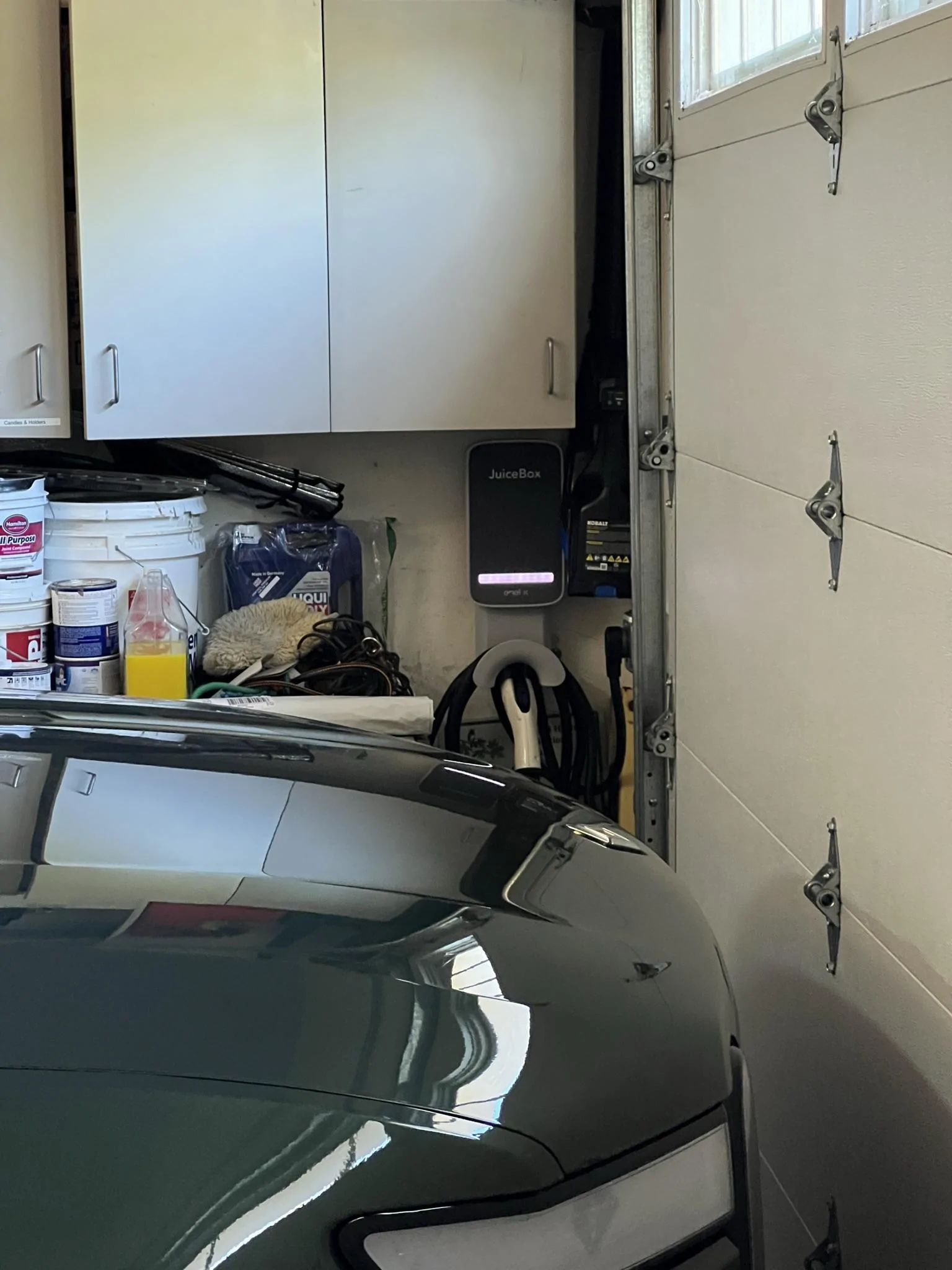

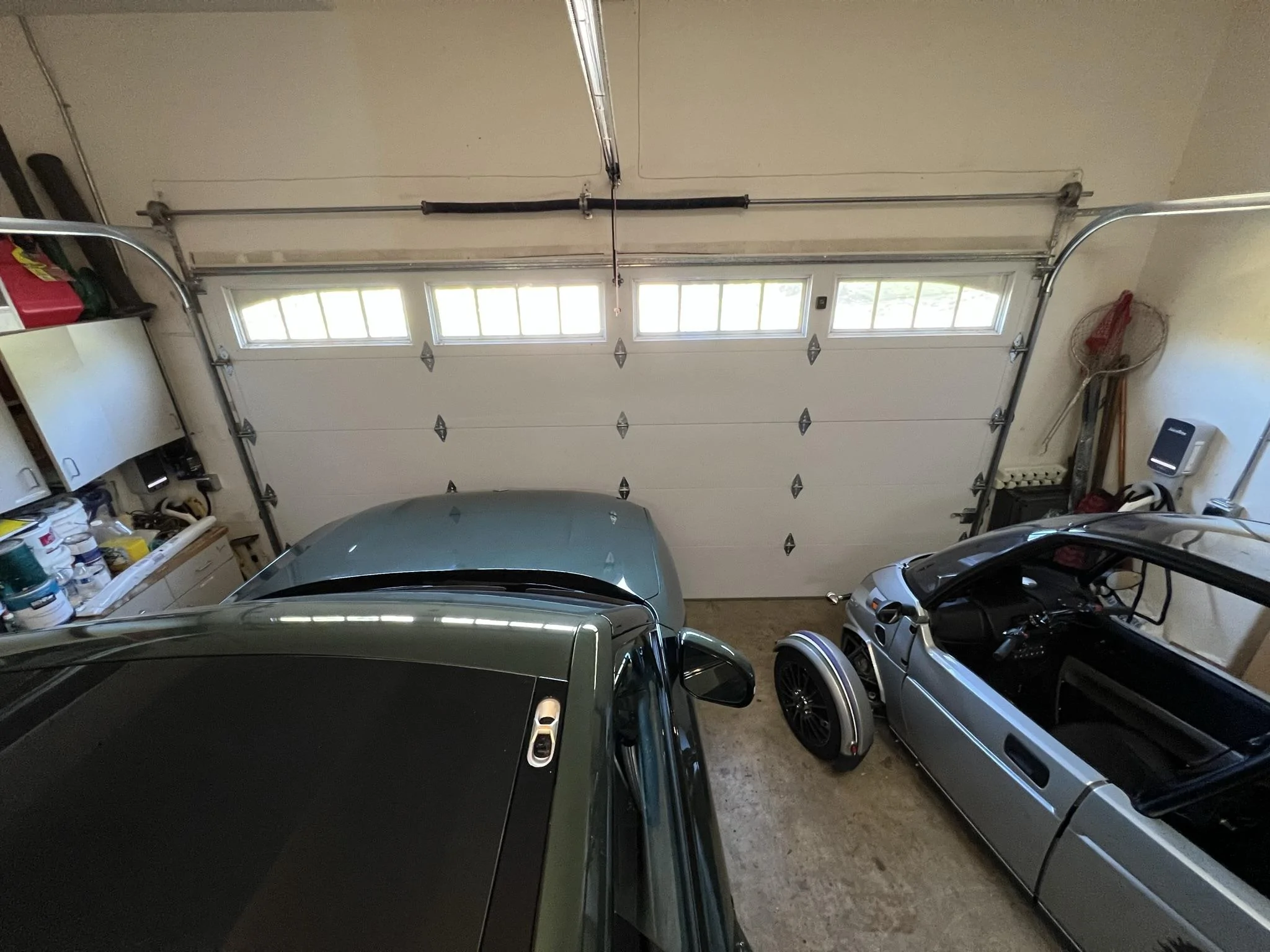

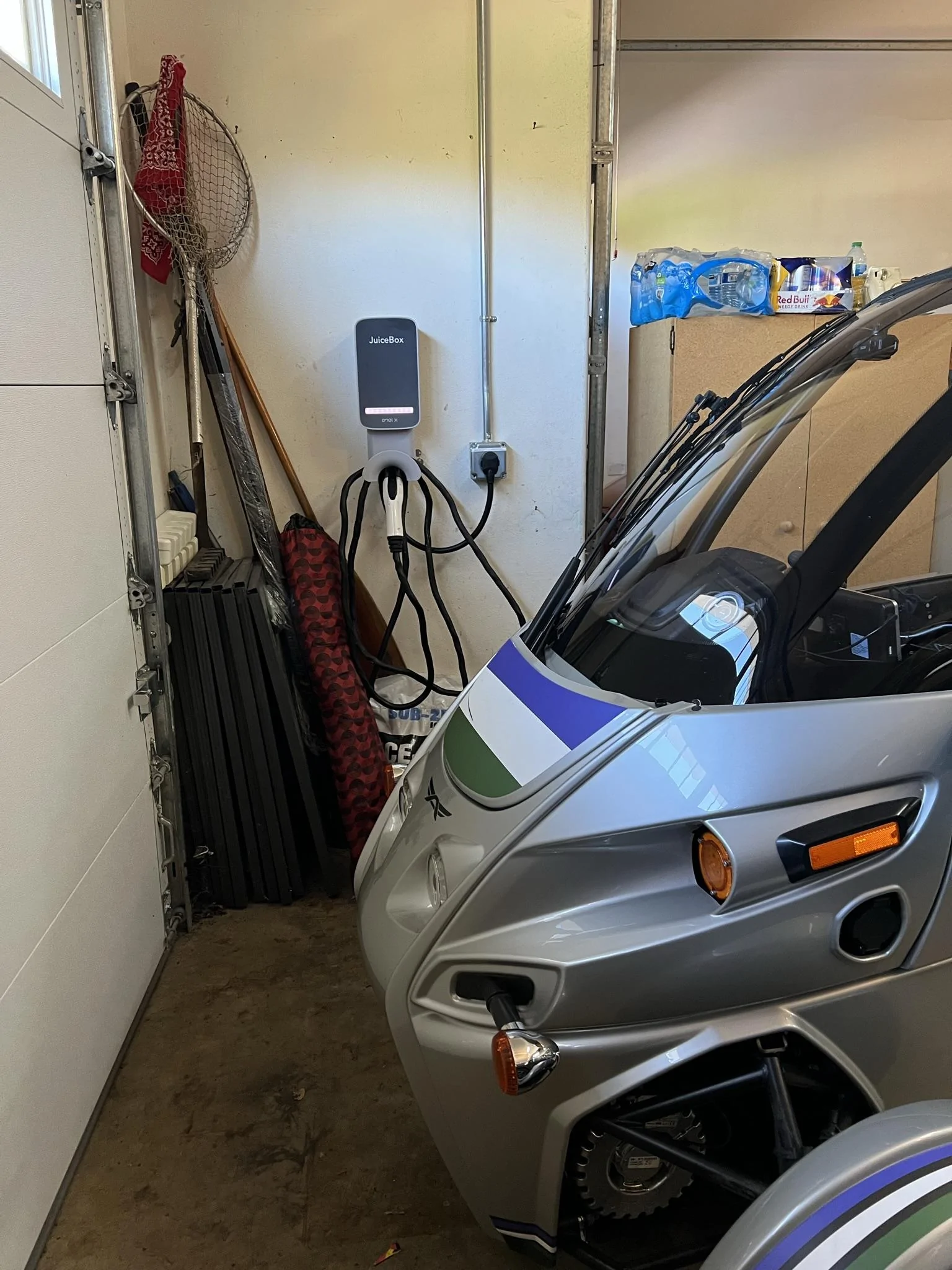

Two Enel-X JuiceBox 40s. Each plugged into a NEMA 14-50 outlet, the two outlets are on one single 60 Amp circuit.
Rivian R1T R1S Show off your Level 2 Home Charger installs here IMG_7578
Excuse the clutter - my garage is the opposite of DaveA's. :-D
Rivian R1T R1S Show off your Level 2 Home Charger installs here IMG_7579
Rivian R1T R1S Show off your Level 2 Home Charger installs here IMG_7580
JuiceBoxes support "load sharing", the two are set up to share 48 Amps (80% of the full-circuit's 60 Amps,) so if only one vehicle is plugged in, it will get 40 Amps (EVSE maximum) if two are plugged in, they'll split 48. (24 Amps each if both are trying to draw max, although the Arcimoto only draws 15 Amps max, so if it is one of the two, the other can get 33 Amps.)
That's enough for our three EVs, since it's ridiculously rare that we would drain all three on the same day and need to charge all three. Although there is a 120V 30A "RV" outlet in the third garage bay that I would plug a TurboCord Dual in to to charge the Arcimoto in the rare event all three EVs needed charging at once.
And yes, two NEMA 14-50 outlets on one 60 Amp breaker passed code inspection - with the proviso that there are labels on the outlets and the breaker reading "load-shared EV charging only"

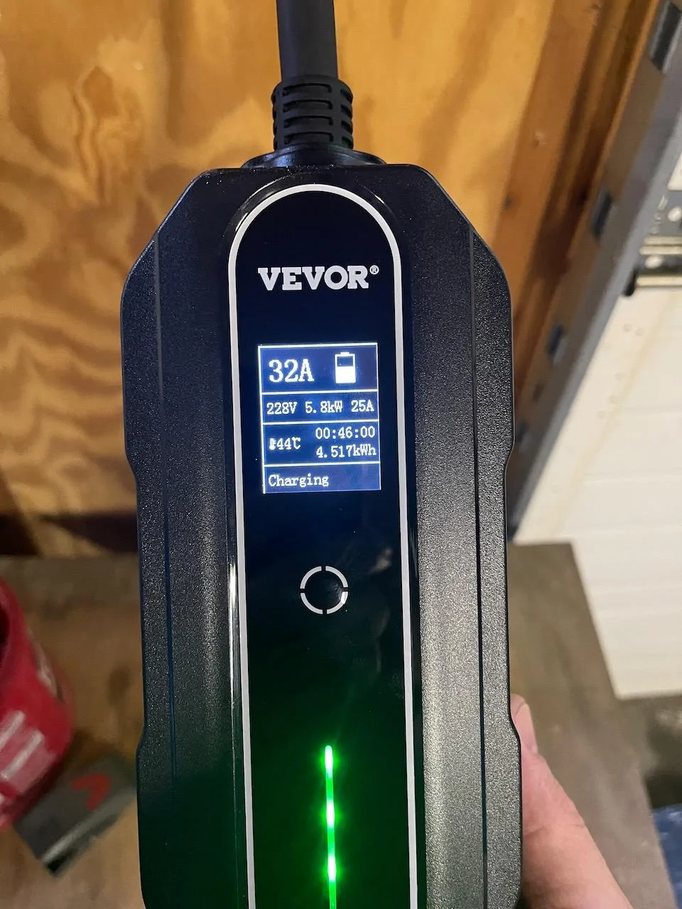

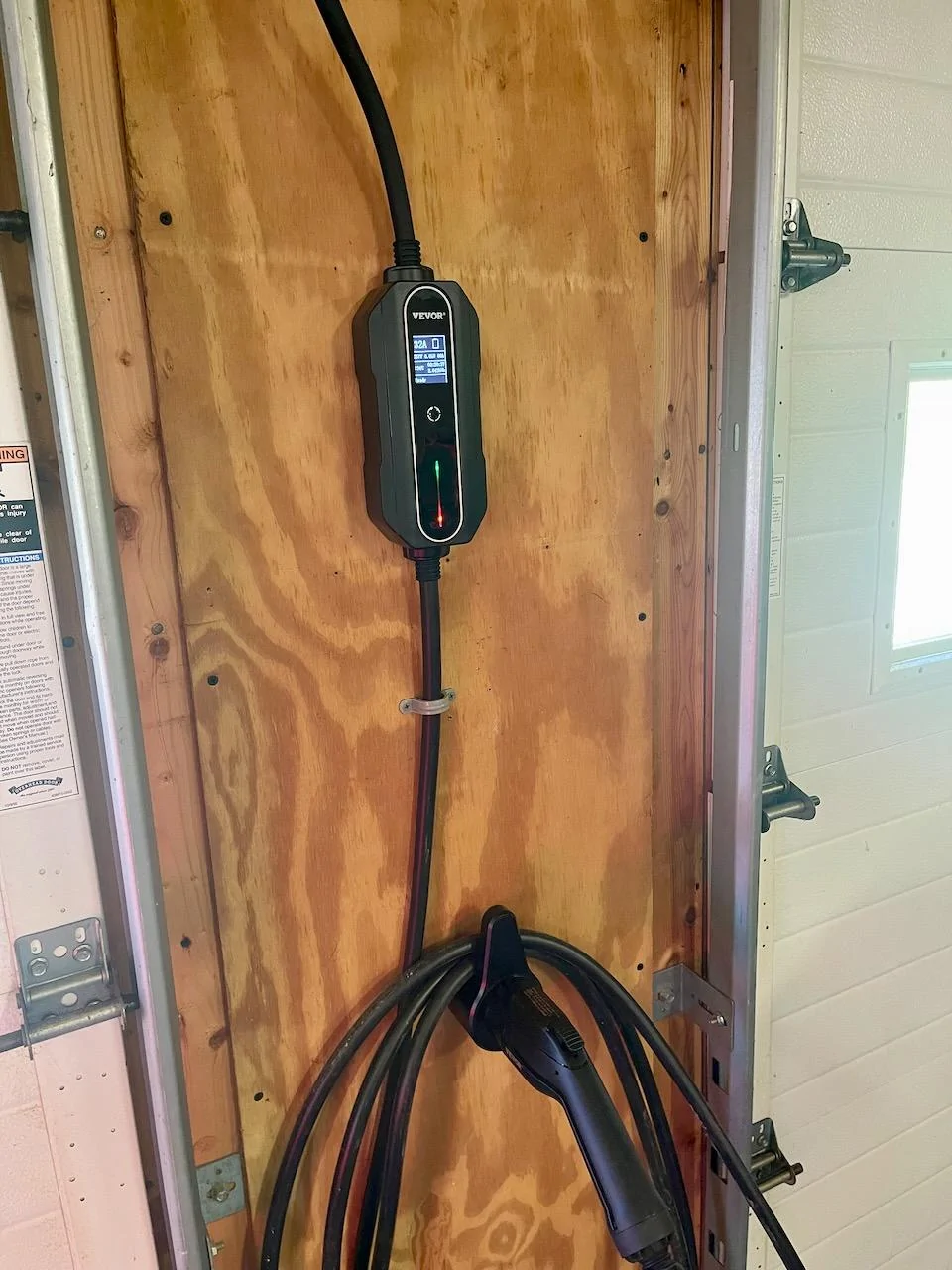

I was determined to find the cheapest 32A charge solution on Amazon, and I am totally thrilled with it. Love the live power display. It also has a thicker, longer cable than the Rivian charger. Mounted between garage doors so it can reach front or back either bay, and parking outside too. Plugged into a 14-50 just above.
VEVOR charger
Cable holder

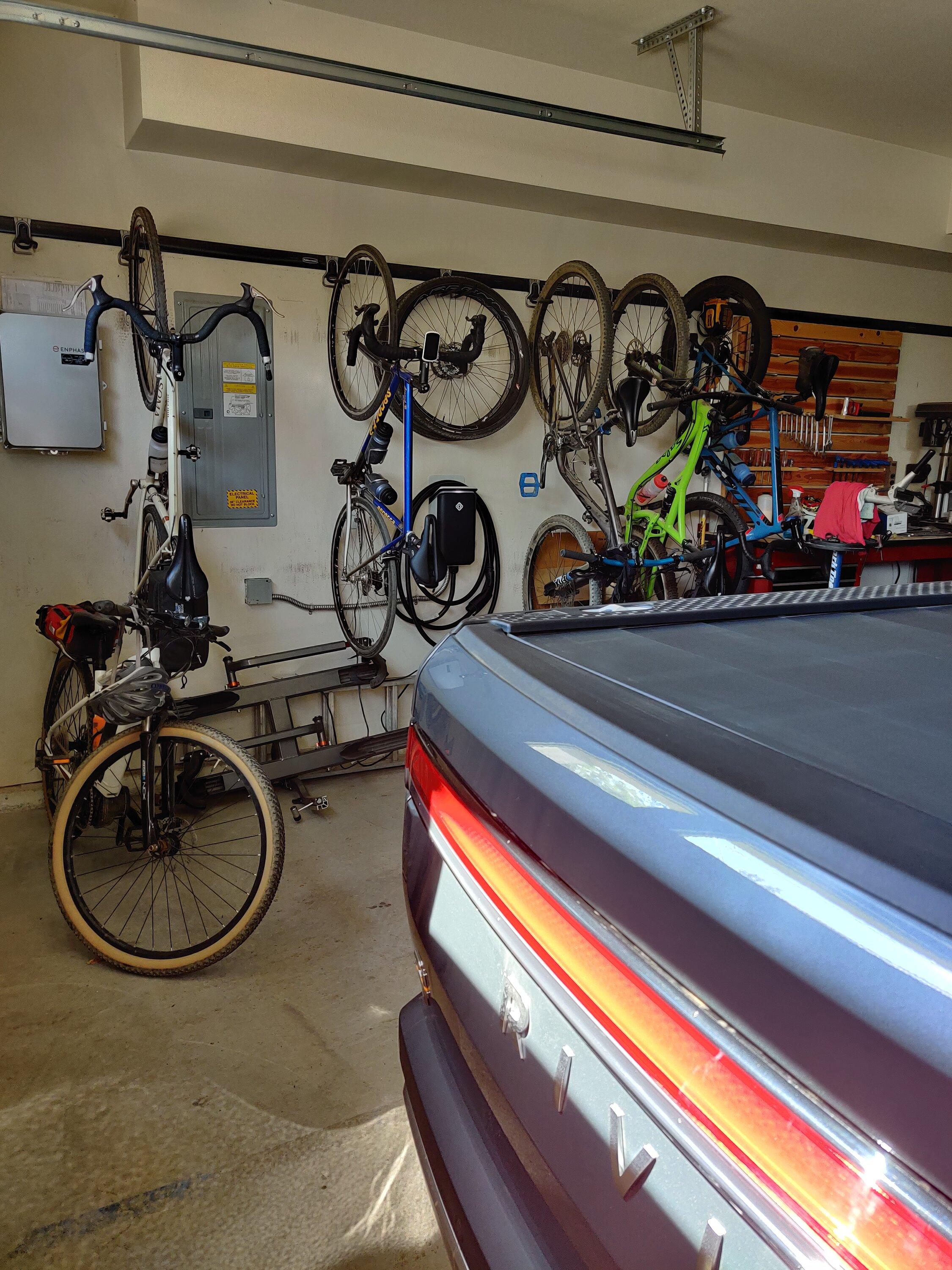

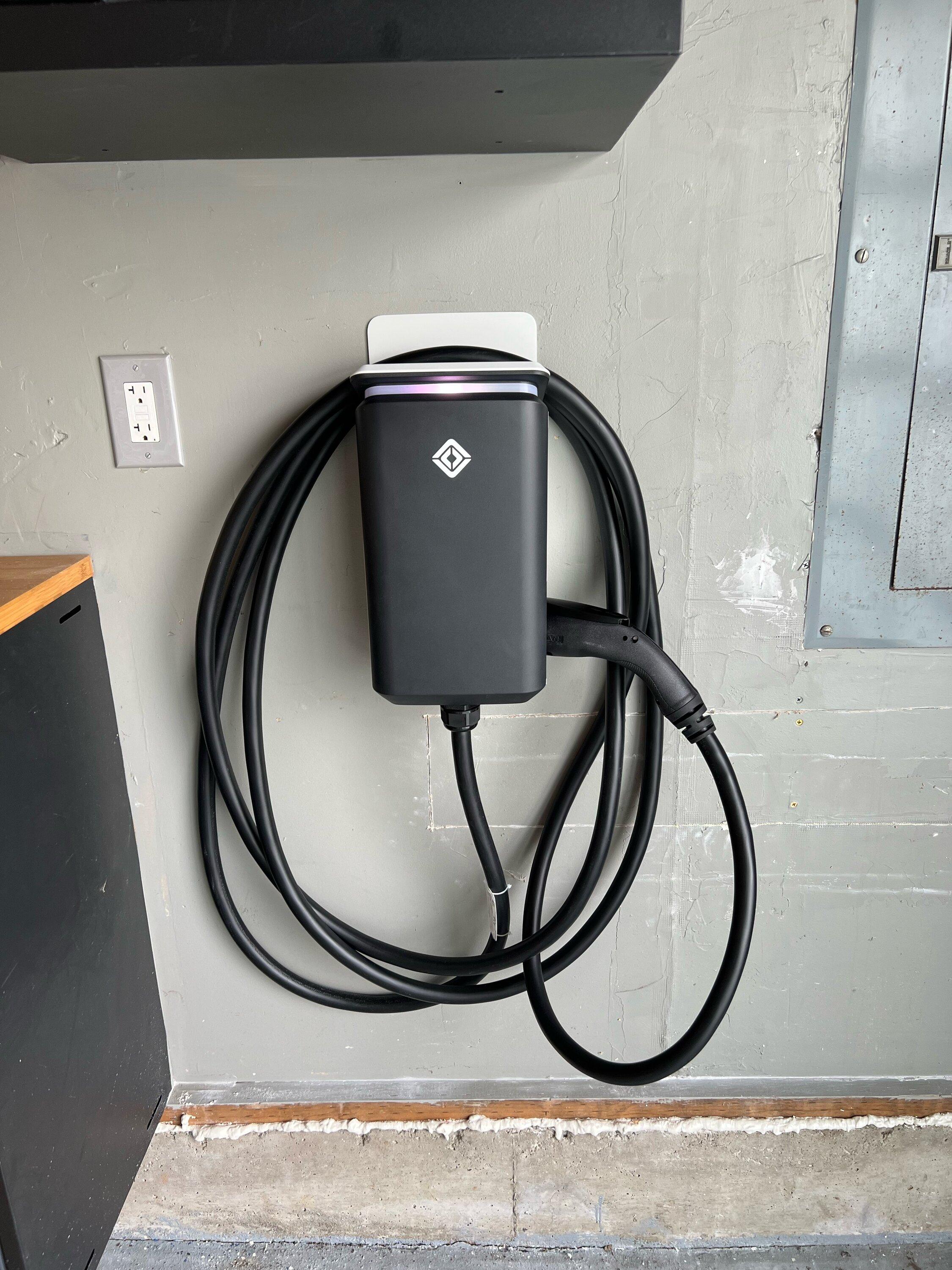

I struggled with this idea as well. This is my Rivian Wall Charger install. 60A breaker, delivering a smooth 48A. It's a very sweet setup. A tip of the hat to those here that provided the advice of how simple it could be due to the proximity of my main. I couldn't be happier with the results.
Rivian R1T R1S Show off your Level 2 Home Charger installs here IMG_0375
After some simple rearranging, I was able to back the R1T inside my garage - with barely enough room front and rear (literally inches for both front and rear). I will show you how tight a fit around September 13 or so, as that's when my baby will be able to show off her full Xpel wrap. Right now I have extremely ugly temporary film protecting the front end, and nobody needs to see that!
By the way, while everyone's operating experience may vary for whatever reason, I have not found it difficult at all to back into the garage. Even with the ridiculous tight spacing front and rear it has not been an issue. But then again, I don't have to worry about smacking into concrete. It does take a bit of practice, but the accelerator pedal is sensitive enough that even this old guy can do it with ease.
