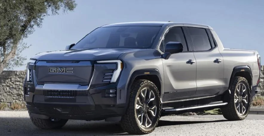

The GMC version is fantastic looking. I like it much more than the aero-inspired Chevy.

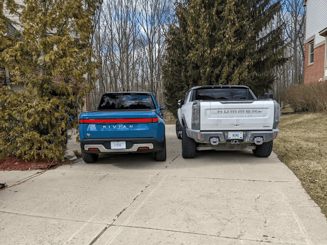

It seems like there is something fishy about these numbers. I assume the Silverado is more efficient aerodynamically, and maybe less weight (?) than the Hummer, but It is hard to see how they are basically getting a 37% range increase with the same usable battery capacity. I know some Hummer owners claim to get more range than EPA, so maybe they underestimated the Hummer, but by that much?
Hummer's windshield is a disaster for aero. As are the tires. As is the frontal area of the entire vehicle. This is the Silverado that can achieve those numbers.
Rivian R1T R1S Silverado 450 Miles of Range 1684519388943
This is the R1T compared to the Hummer.
Rivian R1T R1S Silverado 450 Miles of Range 1684519465104
Externally it's just a much larger vehicle even if the platform is the same.
I suppose that is true. Tires alone could be 10-15%.
