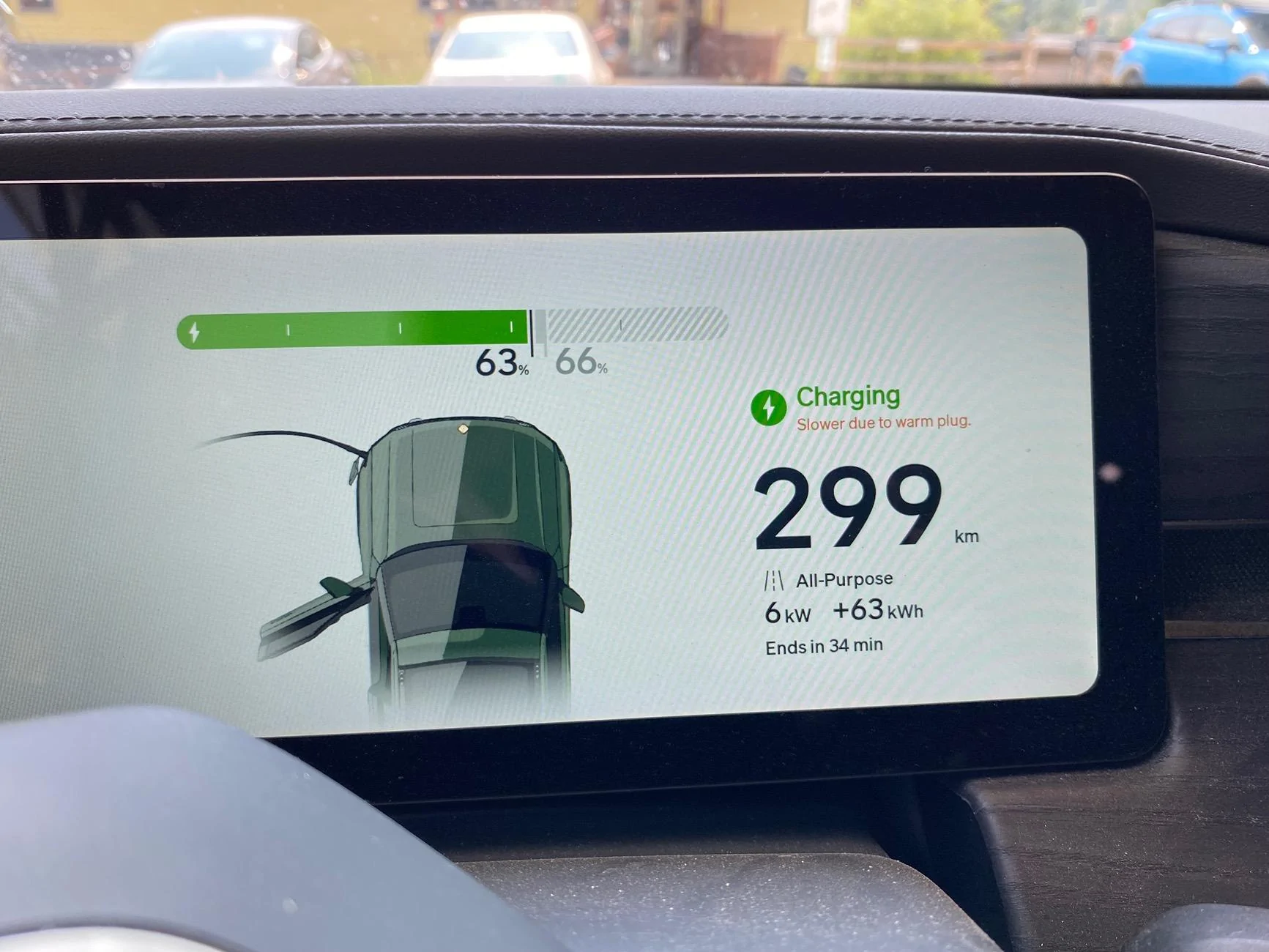

YellowR1T
Oct 12, 2020
146
123
83704
R1T and soon R2
Retired Air Force
I have never seen "warm plug" until I picked up my R1T from the svc ctr, sitting on their charger. After taking one month to replace a door with a bad factory seal causing loud squeaking, the door was fine but now charging is not. Does this mean everyone with this issue needs a new charging plug receptacle?

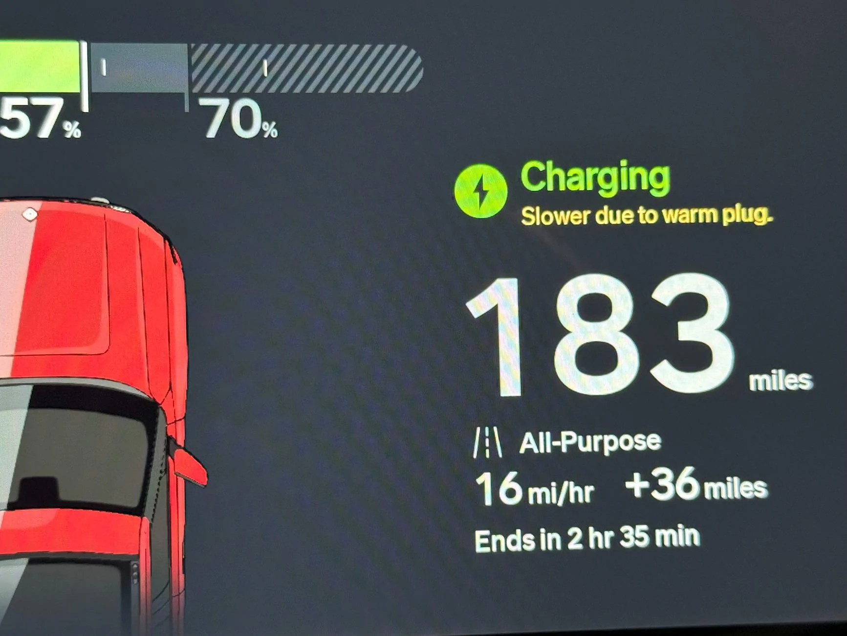

KootenayEV
Andrew
Sep 22, 2021
619
591
Nelson, BC
R1T, Tesla Model 3
Environmental Engineer
I chatted with a rep yesterday and he said it's either due to the heat or perhaps our electric company throttling us. I'm not holding my breath that it's either of those....we'll see if it recurs after the heat dies down this week.
I’ve had a few chargers overnight lately where it slows down and wasn’t sure what to make of it. It has been quite hot during the day (mid 90s) but cools down overnight to high 60s. I haven’t seen any messages but haven’t been in the truck either.

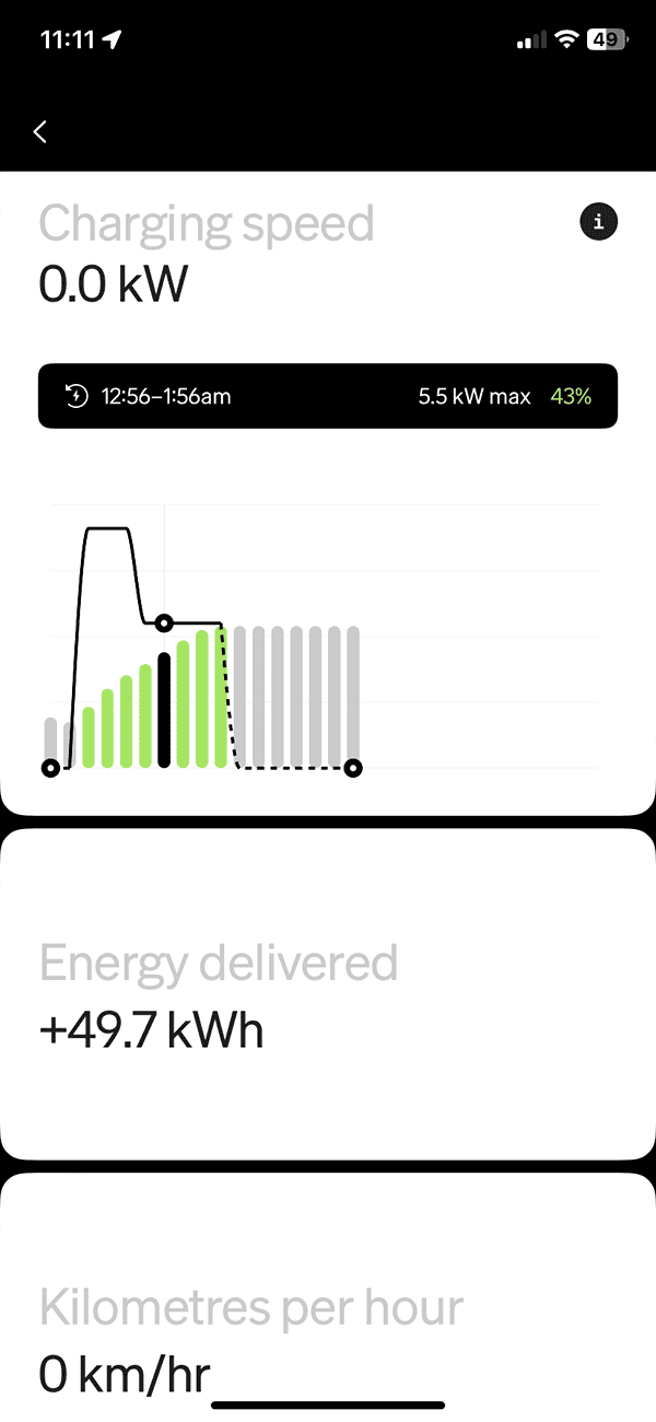

KootenayEV
Andrew
Sep 22, 2021
619
591
Nelson, BC
R1T, Tesla Model 3
started charging mid-day and it throttled pretty quickly to 6kW. The handle wasn’t particularly hot. Odd that it restricts L2 but wouldn’t restrict DCFC handle at about the same temp. Wonder if my charge port has an issue too… I live so far from the SC I won’t be getting it checked anytime soon though.
