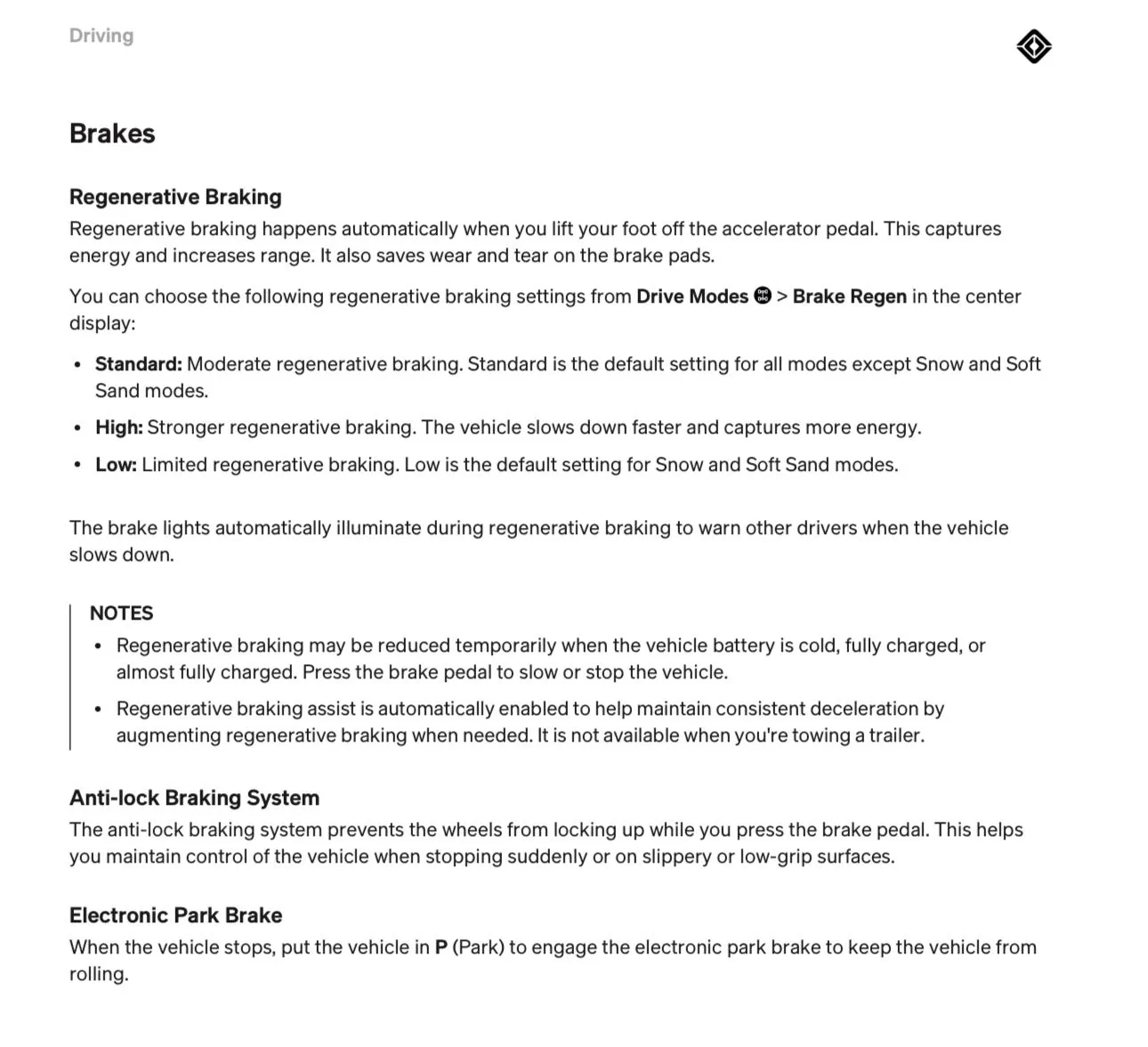

The Snow Mode documentation says it “reduces” regen, but that was not enough in this case. There should be no regen braking at all or only some sort of anti-lock regen if any (if that is possible).
Unfortunately, you can't turn off regen completely. The best you can do is low, but Snow mode doesn't even default to that anymore, it stays in the last used setting. They need some serious work on Snow mode IMHO...
At some point they stopped carrying over drive-mode specific regen. I think/hope this is a bug. It's still documented in the manual that it should default to low, and the "reset to default" button puts it to low if tapped.

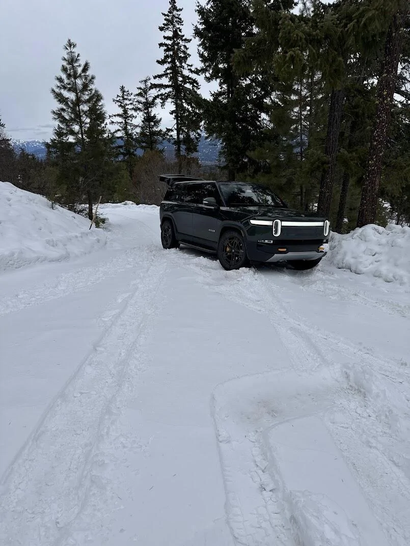

I had a similar experience this past weekend - fortunately with no harm done. We were heading up to our place in Cle Elum and there was about 2" of fresh snow on the plowed driveway - I figured it wouldn't be a problem in Snow Mode. Well, every time I let off the accelerator the regen immediately kicked and locked (in particular) the front wheels, and the car would slide to the side (moderate uphill slope, gentle side slope).
You can see it perfectly in the foreground of this picture. Repeated attempts to back down the driveway went exactly the same. I was able to back down eventually but it was a bit tense.
In hindsight I should have at least tried to turn regen off.
There is no off.

Snow mode is an ass covering hack. When you drive a Rivian in the snow, you don’t have antilock brakes. Let me repeat that: there is no antilock brake capability with regen. Rivian has taken us back to the 1980s in this respect.
Rivian R1T R1S Snow Mode fail - costly result IMG_7183
For all modes other than snow mode, I get the priority of regen over antilock braking. But snow mode needs to be the exception.
I think I speak for most drivers that, when intentionally selecting snow mode, I’m doing it because there is snow or other slippery stuff on the road. I really want antilock brakes to kick in before any regeneration. No one wants to fight the regeneration on the truck to get the antilock brakes to kick in.
