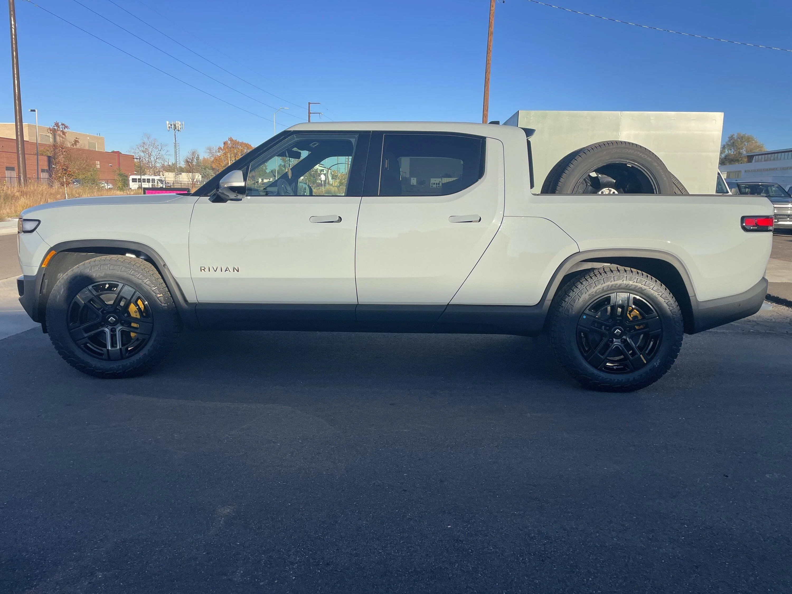

Just picked up the 20" Dark wheelset and tires from Denver RSC this afternoon. Given the season change and fresh snow in the high country yesterday, timing was good.
Though they were not officially confirming so, the local RSC team did indicate a snow mode was in the works and would include low regen, moderated throttle, and other special sauce involving torque vectoring, certain wheel spin prior to ABS kicking in and other TBD features.
Further, they stated that the existing vehicle had certain of these changes enacted below 32F ambient temps, and another threshold at "single digit temps and below", whereby regen and throttle response were reduced further. A local customer in Nederland reported being surprised in yesterday's 9F temps and 8+ inches in snow to find regen was considerably lowered on the way down from Boulder. Seem to recall seeing something like this on the forums but not sure.

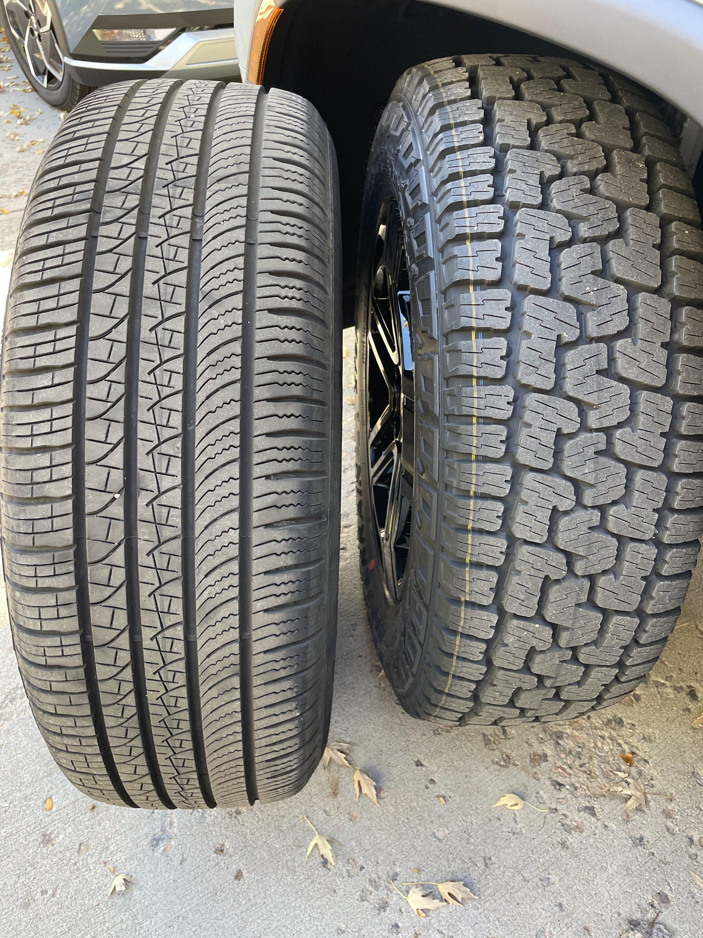

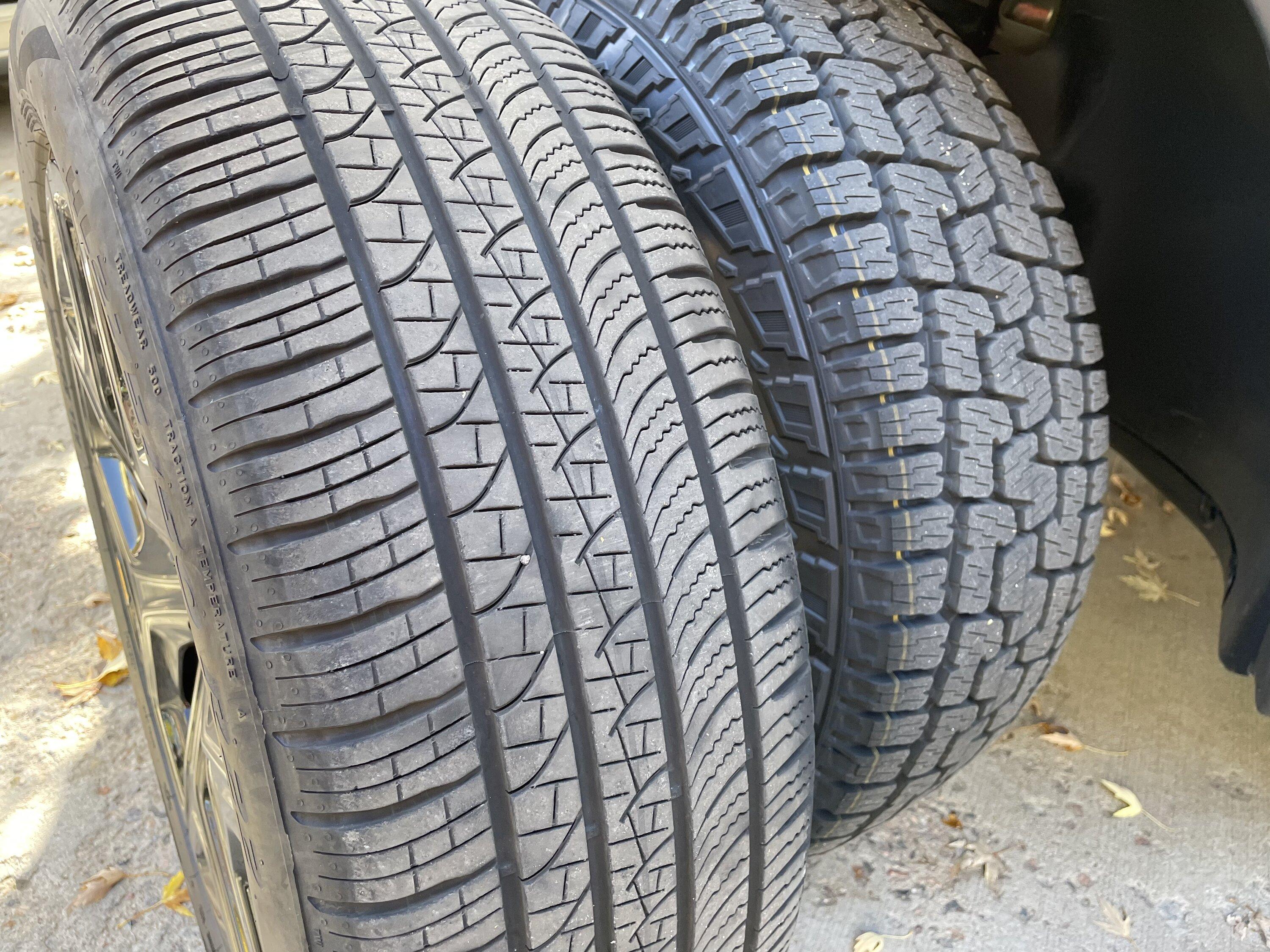

Here’s the Scorpion vs AT tread.
The AT’s have a decent 8.4 snow rating on TIre Rack consumer ratings.
While they have some hum at speed, they are not nearly as loud as our GY Duratracs, a more aggressive and typical non EV designed AT tread.
