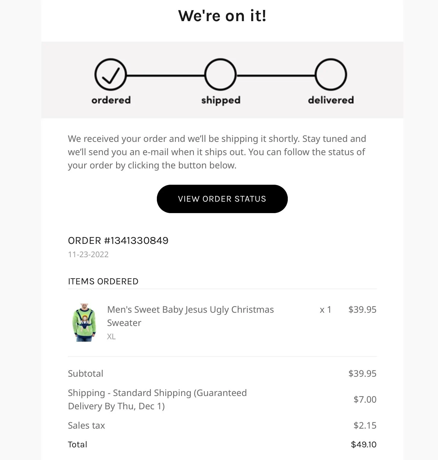

Do you find that your snow tires aren't enough? I haven't put mine on yet, but hopefully tomorrow. We don't have any snow left and none in the forecast.
Dear Sweet Baby Jesus,
I would wear this Sweet Baby Jesus Sweater for the month of December if we can please get Snow Mode for Thanksgiving?
Too s00n? Cause we’ve been askin nice since sand mode came out.

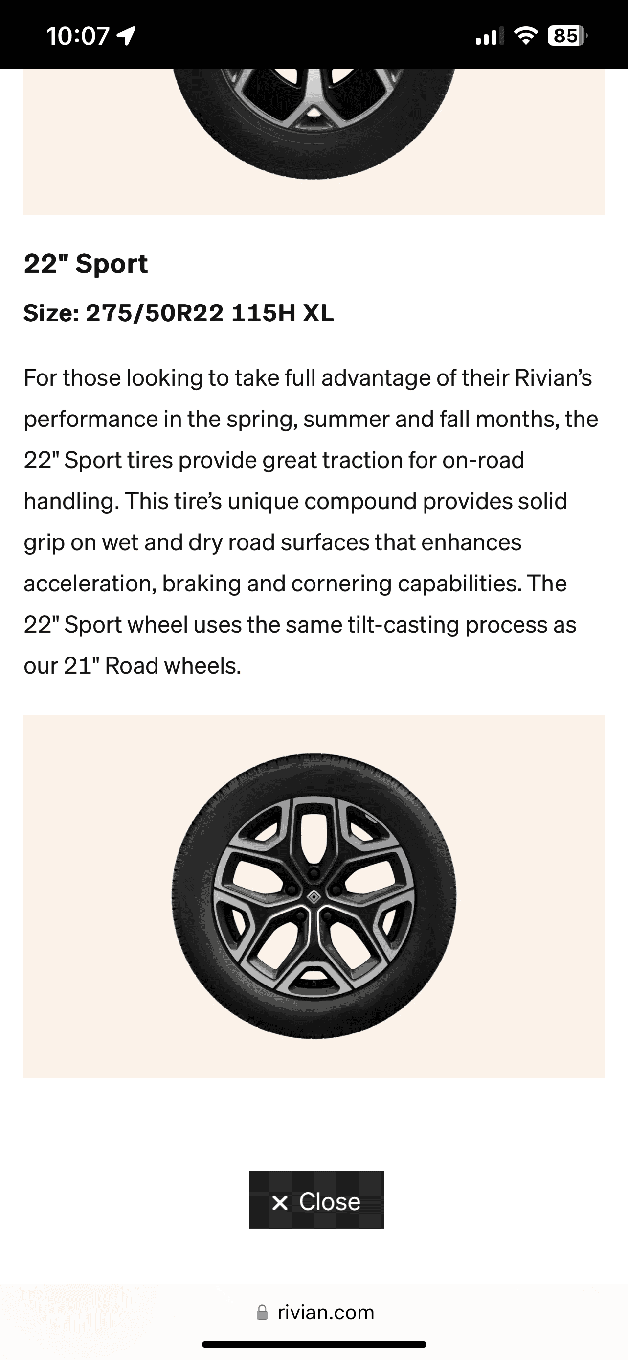

We got about a foot of snow friday/saturday, and one trip out on the 22s and it was clear that these are not going to make it through the winter. Regen (standard) caused sliding as soon as I took my foot off the accelerator at 25 mph. ABS functionality seemed normal, but the transition from Regen induced slide into ABS might be all that it takes to get me into a fender bender someday. I'd also like to know if Regen is disabled when ABS is activated - I'll pose that to Rivian this week.
I posted this in another thread, but Rivian describe the 22s as three season tires. In their description of them the mention Spring, Summer, and Autumn, not winter or snowy/icy conditions.

You are right, never saw that before. Even mentions they provide traction in light snow, probably very light snow (flurries).
Yeah, that is a carefully worded description. I sure wouldn't want to drive in the CO mountains in winter with those, even if I was just staying on I-70.
Sure - that is how a tech writer at Rivian wrote up that webpage. But, Pirelli call it an "All Season" tire and has that molded into the sidewall of each one. For more than half the country that includes snow...
I was hoping it would be at least adequate in snow because I am not overly thrilled with current winter wheel/tire options (not to mention the problems getting TPMS sensors currently) and was hoping to hold off getting snowies until next year. One drive proved they are not up to the task so I ordered (and received today) a set of 22" Hakka R5s that I will have mounted on the factory wheels as soon as I can get an appointment.
