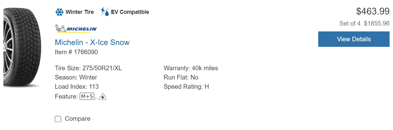

Found these on costco for my 21". Do you think costco would give me any problems installing these 21" on my rivian?
I think they would give you a hard time, even though it would be fine (load rating is a bit less). But that's a pretty high price for these tires. I paid $280 per tire for these last month from tire rack (different size)
They won't do it. I've tried and seems like Costco will only do oem spec.
