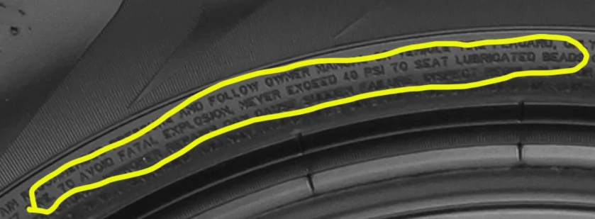

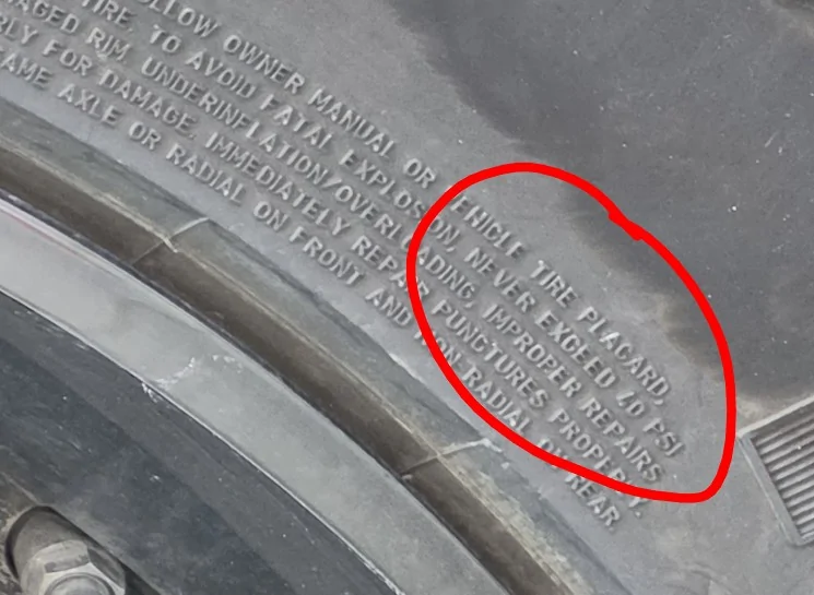

I was just checking my OEM scorpion tires and noticed in the fine print on the sidewall that they caution never to exceed 40 PSI or they might explode. This seems completely contradictory to everything I've read and how the trucks are set up upon delivery. Can anyone explain this anomaly? Does anybody know what is the true maximum PSI that we should run?

If you read the entire message, it probably is referring to never exceeding 40 psi while seating the tire on the bead (installing and inflating the tire).

As I mentioned previously, it's a mounting warning, not an operating pressure warning:
