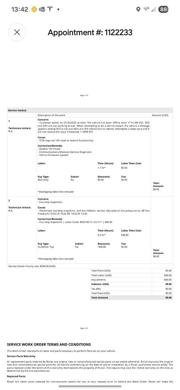

Service center disconnected my r1t 12v to fix it. Been fine since.
Rivian R1T R1S SOS Call Button - service message pop up 1000003255
pointless
Jan 21, 2023
269
193
US
Awaiting R1T
Thanks for the Service Work order.
TCM requires 12V reset to restore functionality.
Not coming to me, any idea what TCM stand for?
