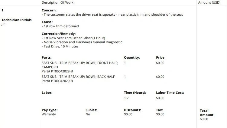

teddyang
Ted
Jun 16, 2022
250
565
Los Angeles, CA
R1T Adeventure Edition, RB, BM, 21"
Mine had the same issue, service center fixed it.
