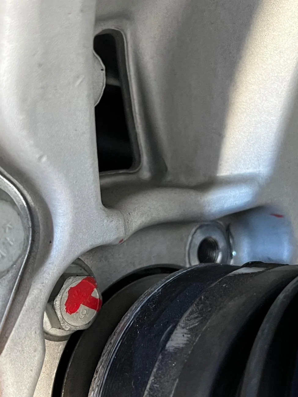

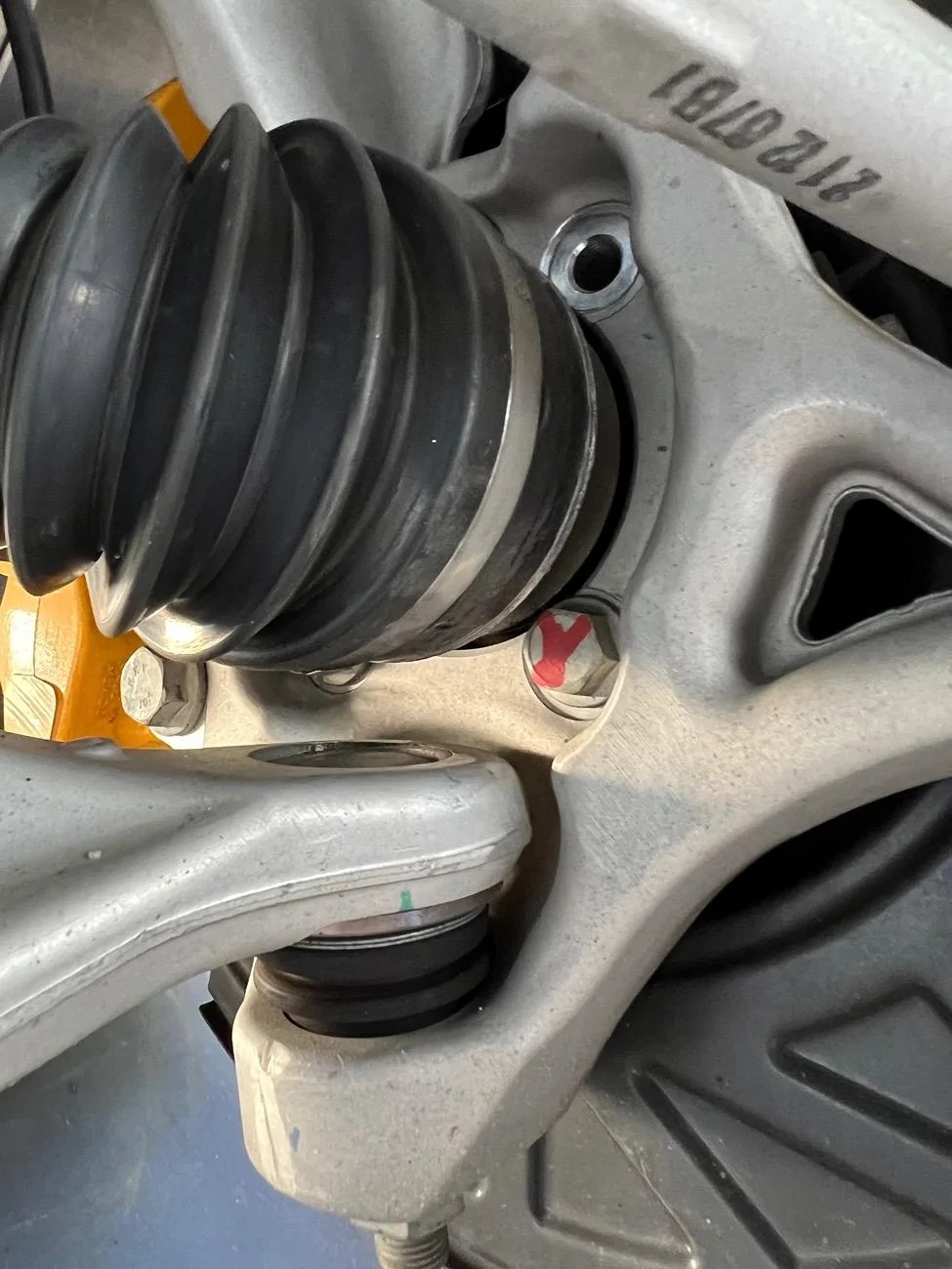

GANTZ
Orlando
Aug 3, 2023
121
217
SD Cal
2023 R1T, Tesla, Lexus
Yes
I recently had the same issue the culprit loose bolt check the pictures. It stopped making the noise once the bolt hot all the way out somewhere on 15 freeway in southern california. Raise your vehicle turn the wheel and check the bolts.
