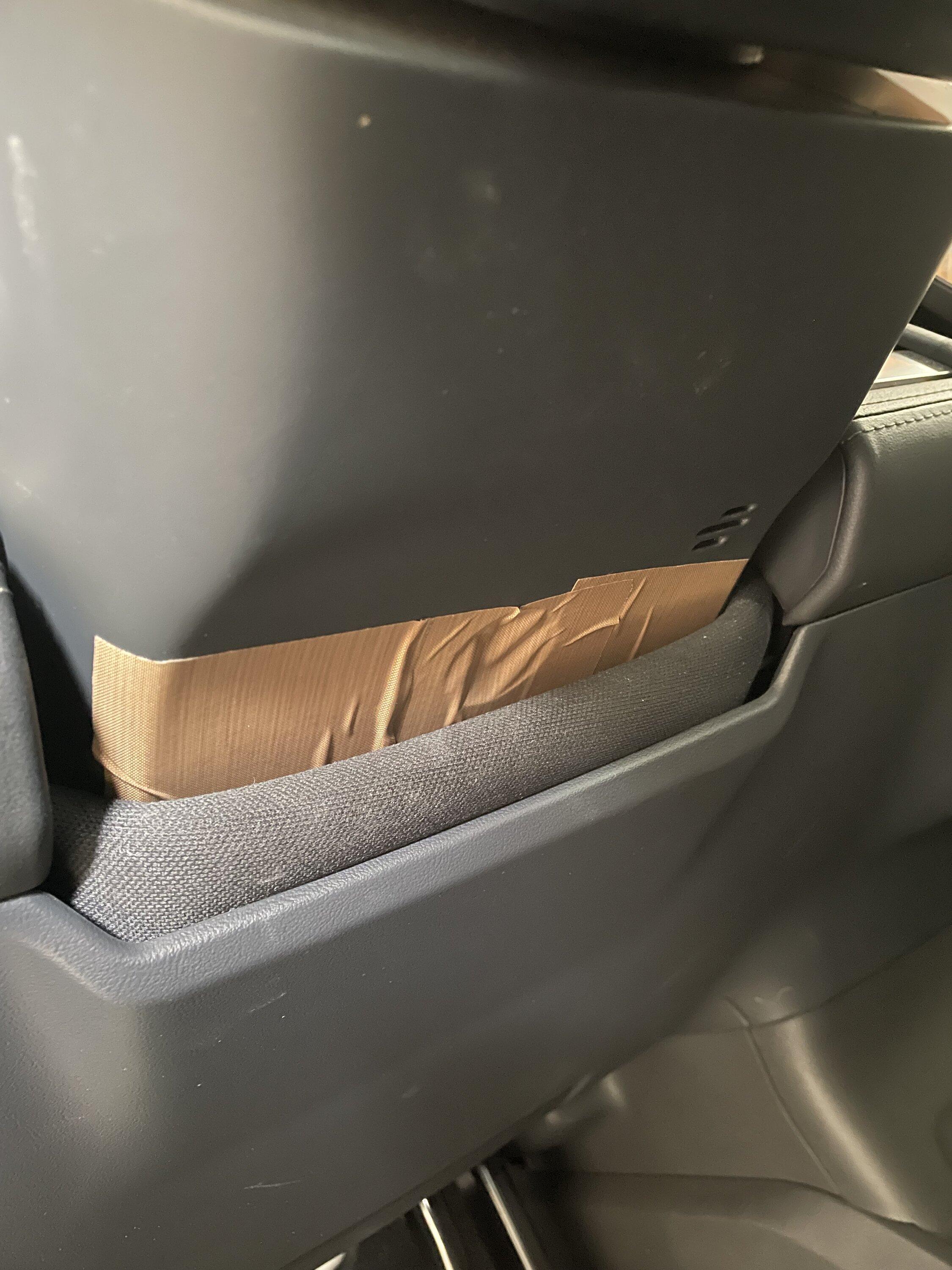

Solution found. This has really been bugging me. Had to stop the easy entry. Then thought of putting teflon tape on the underside. Found this on Amazon and just put it on. Sound is gone. Now I have to wait to see how long it’s going to last but I’m hopeful.

Ours started to do this just recently. Though about spaying silicone lubricant but the image with the teflon tape makes me think that its not something a spraying a moving mechanism would fix...

Well, after a week or so... the noise isn't gone. It's better at times, but thinking there is some rubbing on the sides where the tape isn't.
It's annoying sound. If continues, I'll request a mobile service...
I think the mobile service is just going to spray it, and say good luck.
