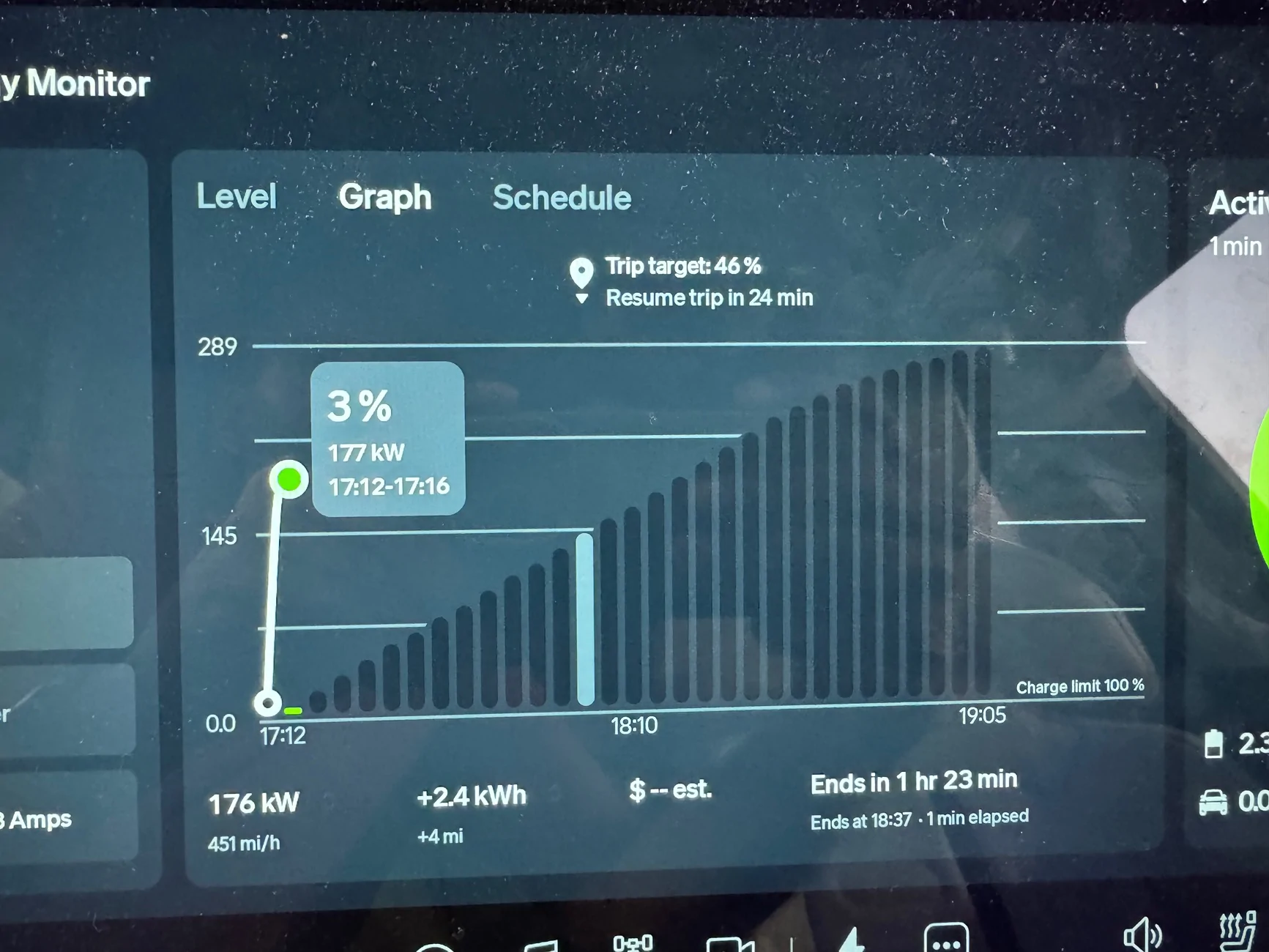

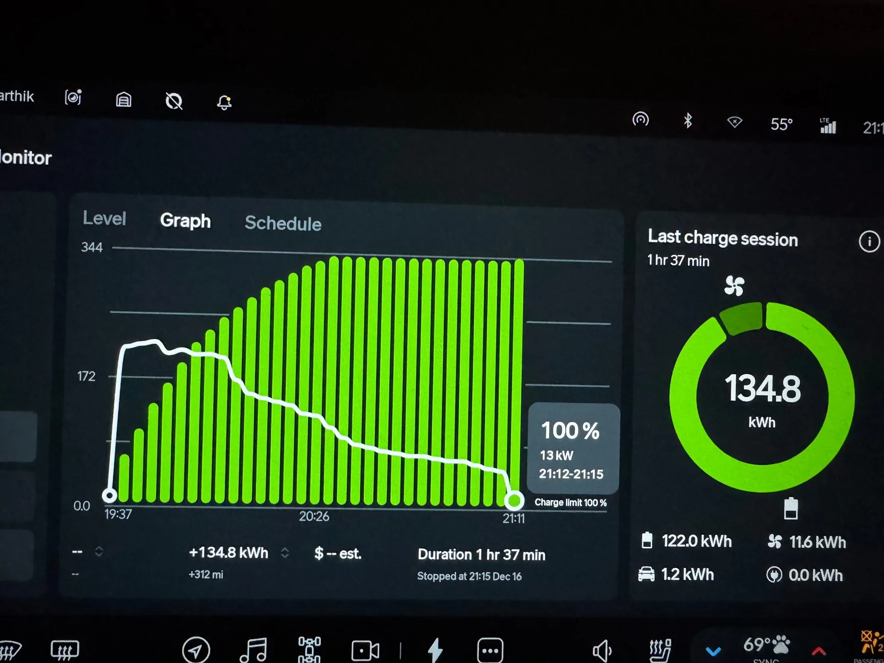

Here's a way to see the issue visually, if you charge to 100%. If you look at the graph at 3%, you can see the EXPECTED graph in the unfilled black bars. It's expected to gradually rise to 99%, of course slowing as it gets full, but then just spending a few minutes at 99%.
If you look at the completed graph, instead it gets to 99% much sooner than expected, then flatlines there for half of the charge time. Not matching the expected curve from the first graph. And it's supposed to be a curve after all, not a plateau like this.
Until July 20 of last year, my curve looked like the black bars when complete. Then it changed on July 21 (per ElectraFi), this was a couple days after getting 2025.22.30 and I theorize some BMS calibration code got messed up then. When I have a gen1 Large loaner, it looks like the black bar graph as well, not a plateau.

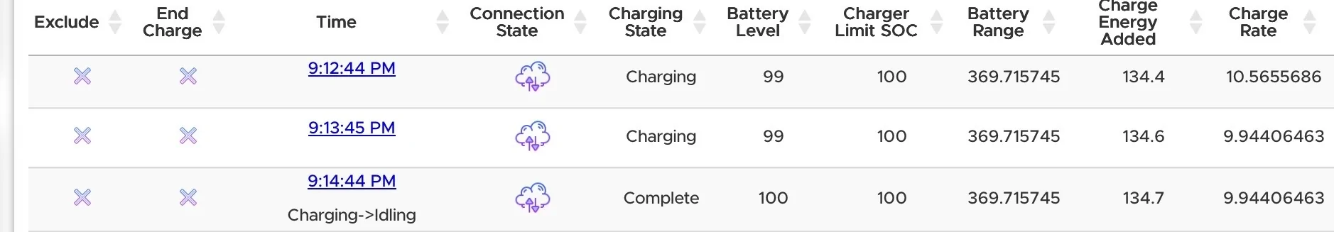

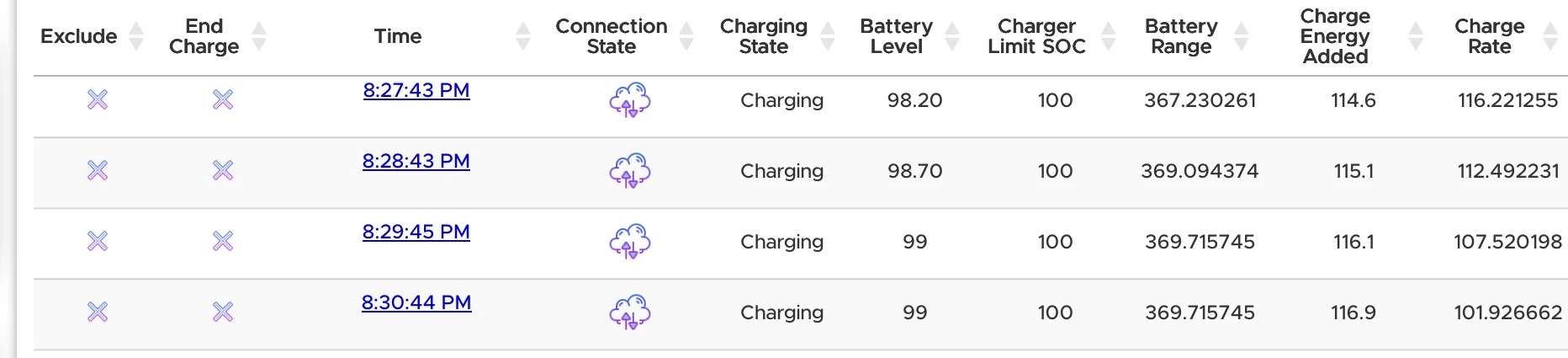

To see if the problem exists, check ElectraFi data for the "Charge Energy Added" value right when it flips to 99%, and then again when it hits 100%. Calculate the difference.
See my attached example, it hits "99%" with 116.1kWh added, and then 100% at 134.7kWh. So it adds ~19kWh after hitting "99%"! While the rated range remains the same, too. (The kWh values are not necessarily exact, I don't think ElectraFi adjusts for degradation so they are probably ~5% too high for my vehicle. But the proportions are correct, with ~15% of the pack being added after it hits "99%".)
