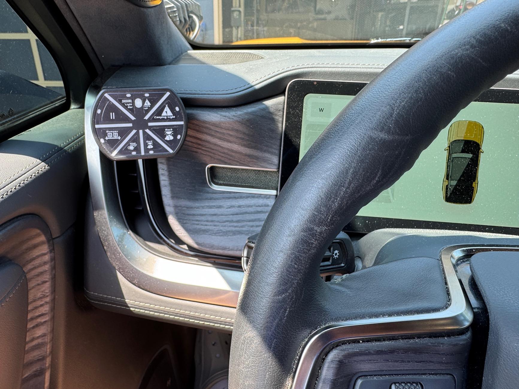

Rivian R1T R1S Switch Panel Install IMG_5993
Magnets! 🧲 I also opted for a wireless RF switch to avoid the need to run wires from the switch box to the switch.
It’s mounted to one my MagSafe iPhone mounts.
@Polar Nice install. I like the idea of the wireless controller to avoid feeding wires through the firewall (is it even called that anymore for our cars?)
Can you please share more about your switch box? Which brand and model.
Also, where is your "signal wire" tapped into? I'm assuming you selected one of the fuses that's under the dashboard?
Thank you.
Thank you.
Here my lighting install post -
https://www.rivianforums.com/forum/threads/accessory-lighting-all-of-the-accessory-lighting.34410/
All wiring was done under the hood/exterior only for this project.
I have done fuse taps for a separate project that was putting MagSafe powered phone mounts on either side of my screen.

This is the controller I’m using.
