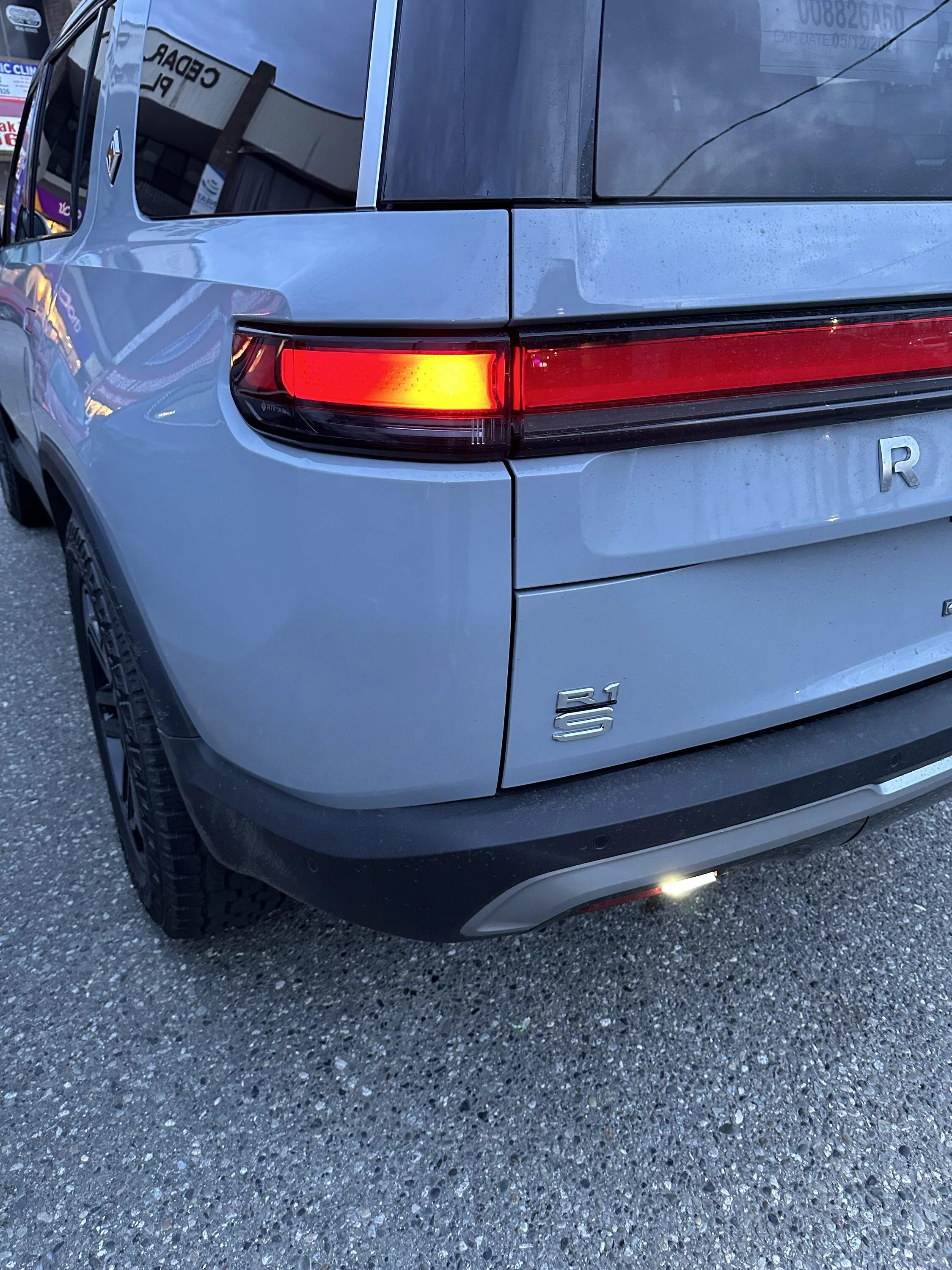

I have a related question, I think...my new R1S does something odd: the driver's side brake light stays on for a long time after I lock and leave the vehicle. I tried to see why, poured over the manual, etc... something tells me this is a bug, but, wanted to ask.
Not normal. Put in a ticket.
