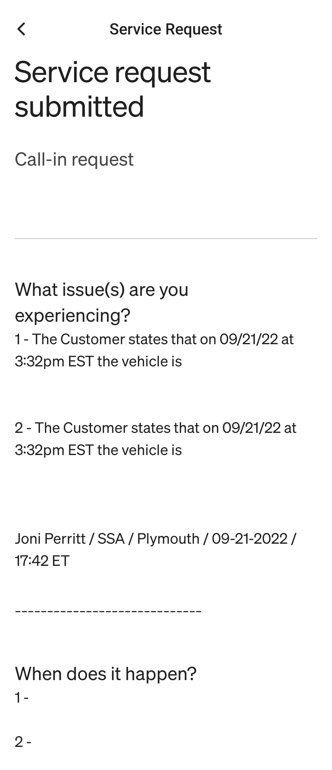

My R1T also does this seemingly non-stop and I think it is never able to sleep. I've done everything to rule it out except take the battery out of the fob.
I also have a service request in, but haven't heard anything yet; Although, that could be because the associate filling out the form left it empty. (At least I was able to attach a video to that request, so hopefully that gives them some context.)
Rivian R1T R1S Taillights blinking randomly while truck is locked and off Screenshot_20220926-093342_Rivia
