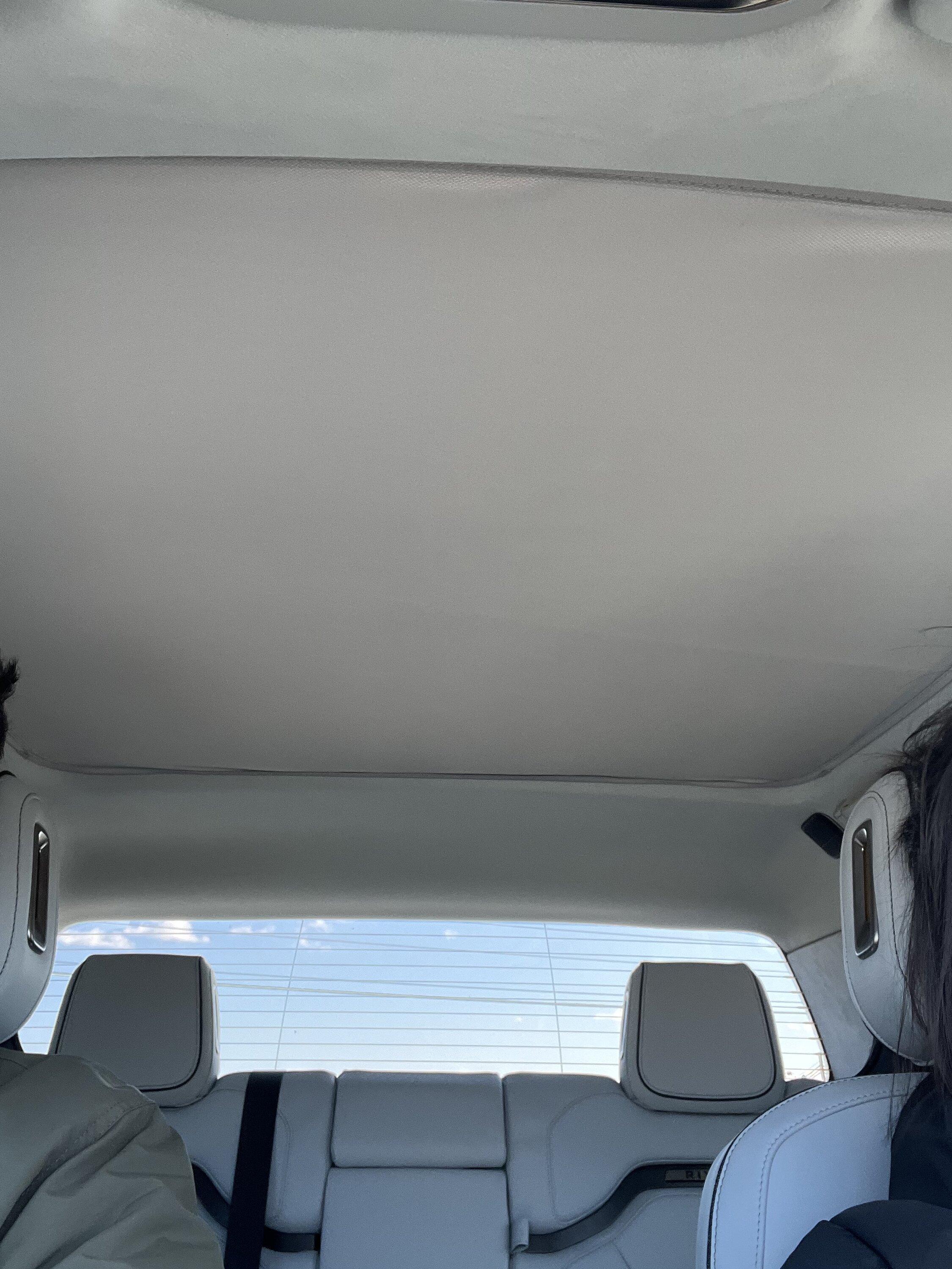

Thank you for that! Very helpful. What are your thoughts on doing the roof? I don’t really care about having a moonroof anyway so I might just get one of the fabric screens that are starting to come out now…
Don’t do the roof. You’ll end up feeling more heat. Ceramic tint absorbs heat, which will then radiate against your head and shoulders. Ask me how I know.
Go IRX for your side glass, and then Llumar Air Blue 90/80 or FormulaOne Stratos 70 for the windshield. If you can tolerate darker on the windshield, IRX 50 or Stratos 50 is an option. That choice will come down to visibility preference and local laws.
The roof shade works very well anyway. Great work @BestEvMod(AOSK)
