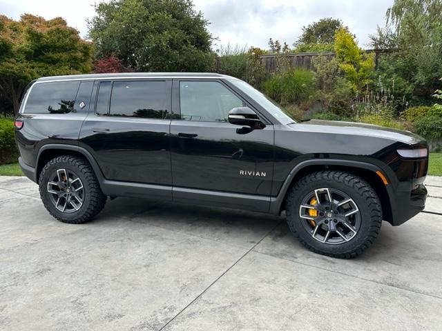

I got my R1S with 22 Dark wheels and they rode great, ... and I got a set of 20s off ebay and put KO3s on them. Ride is slightly softer, a little noisier, and probably a litte less efficient!
Rivian R1T R1S Tire Conundrum IMG_3712
