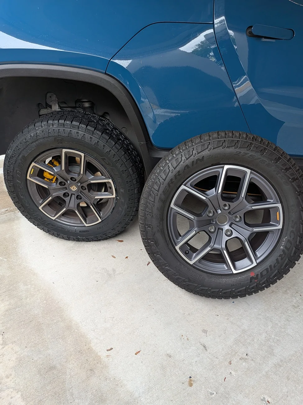

Thanks to everyone who replied. I'm down to these two:
GOODYEAR WRANGLER ELECTRICDRIVE AT
Pro - Looks pretty aggressive and has the sound attenuating feature.
Con - Can't find much about them from actual owners online .
MICHELIN DEFENDER LTX M/S2
Pro - Owners seem happy with them. Better price. Quiet.
Con - Look like they belong on a Prius.
I'll update when the horse gets shoed..

Electric Drive has same UTQG of 580 as Territory, but ~$160 more per tire. IMO, why? If service life is about the same, get lower cost tire. Especially if you just want AT for looks and don’t go off-road much. If you do want more off-road capability, at $400+ price point, you might as well get the Toyos. If it’s all about looks and nothing else, Nitto is a brand that prioritizes appearance.

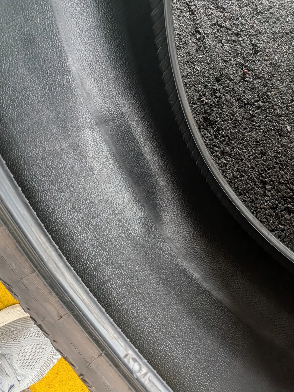

Broken belt.
@Winger I agree with @Dark-Fx , this appears to be something structural (internal) like a broken or delaminated belt; it's clear this isn't a rotation issue as some have suggested.

While OEM tires of all brands (including Michelin) don't typically have treadware warranties, they all have warranties against manufacturing defects.
A broken belt could be a manufacturing defect. I don't think Pirellis are any more or less prone to that. I haven't seen any previous posts about broken belts, so it's not common, but it could happen.
A broken belt could also be because you hit a pothole or a curb really hard - hard enough to break the belt but not pop the tire. I suppose you would remember that if it happened.
You have nothing to lose by making a warranty claim.

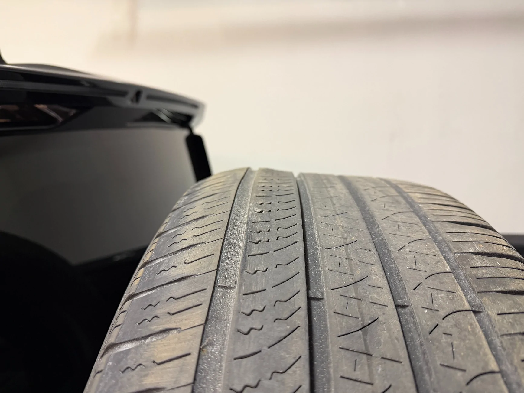

Factory Pirelli ATs are 640 UTQG and most folks have stretched those to just over 30k.
36k miles and still 7.5/32 of tread left on my OEM 20" tires. Yes I rotate. About 20% of that in Conserve (on the highway).
I don't think I'm unusual. What would be unusual is if lots of people like me who had normal treadwear were constantly posting about how normal their treadwear was. So consider the selection bias implicit in all these posts from people burning through tires ...

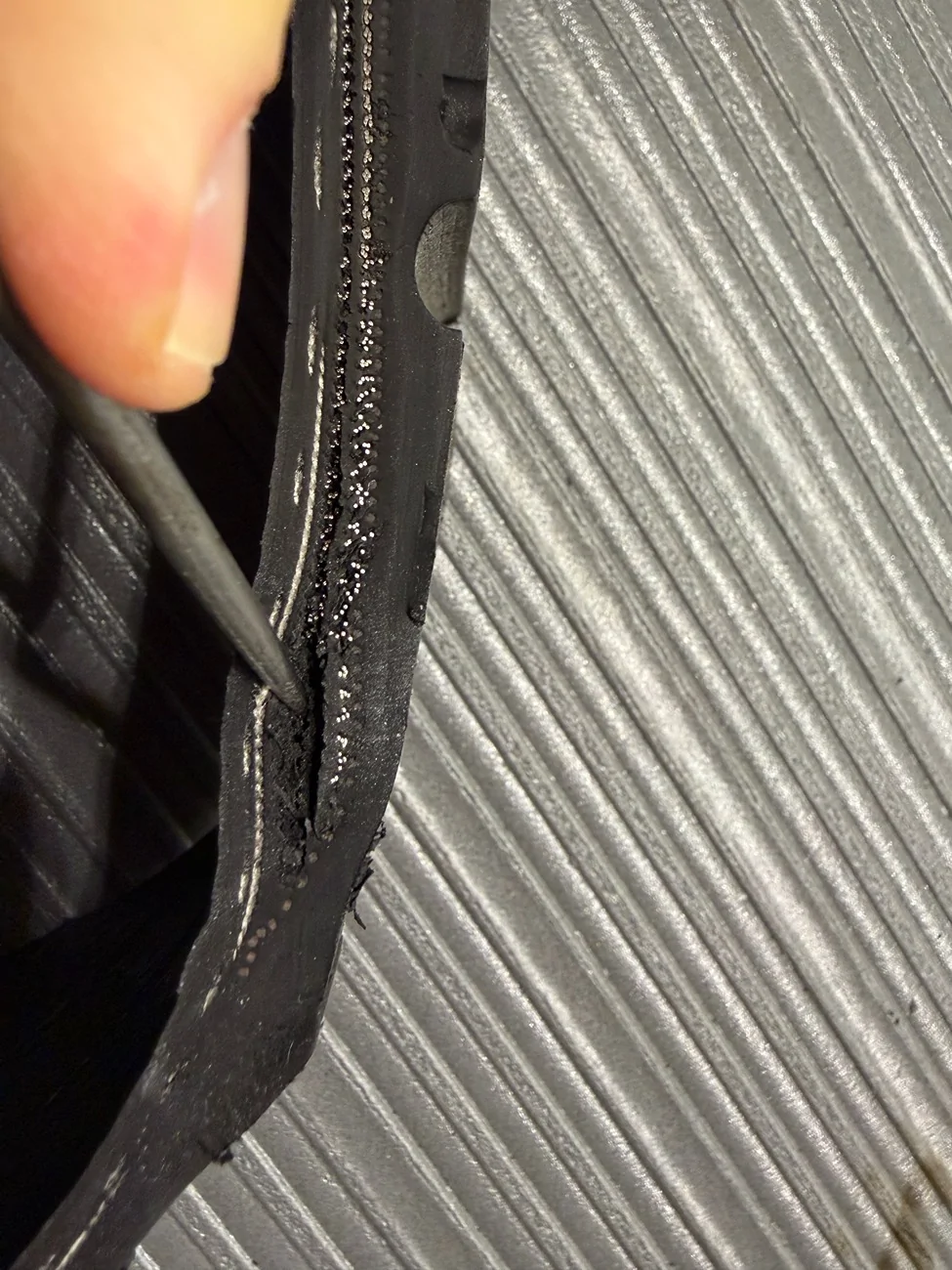

I had a similar thing happen with my HL275/50R22 OEM Pirelli tires.
I started to develop a vibration that progressively got worse. I thought I had lost a wheel weight as it felt similar to an out of balance wheel/tire.
Rivian R1T R1S Tire question: What could have caused this? IMG_3057
This happened on the inside shoulder of only the rear tires. These tires were original to the vehicle (3yrs old; 22k miles), while the front tires had been replaced before I bought the truck.
Once I got replacement tires, I kept the rear tires and cut one of them open. The separation of the rubber from the belt material is likely what caused the bulge, which caused the vibration. *NOTE the missing belt cords were a result of me cutting the tire.
Rivian R1T R1S Tire question: What could have caused this? IMG_3062
I thought others might find these details interesting like I do.

So here is what the inside of the Pirelli looked like. There was no hard pothole hit or curb contact and it seems layers of rubber delaminated from the steel belt on both sides. The black on black picture makes it hard to see, but the bubble on the inside runs to the center of the tread and about half of the circumference.

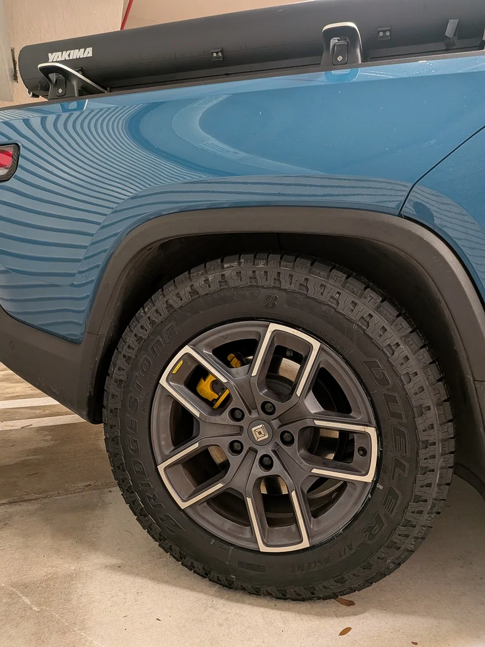

Decided to go for the Bridgestone Dueler AT Ascent 275/65R20 based on price, looks and a couple of pounds lighter
Since they are not EV rated I expect a little loss of range and more treadwear, but load, service, temp and everything else is equal to stock tires (including the diameter, which is important).
We shall see how the experiment works out!

Close to $100 less per tire (SL)? If efficiency is on par... definitely a winner. Same 640 UTQG as the Pirelli.
