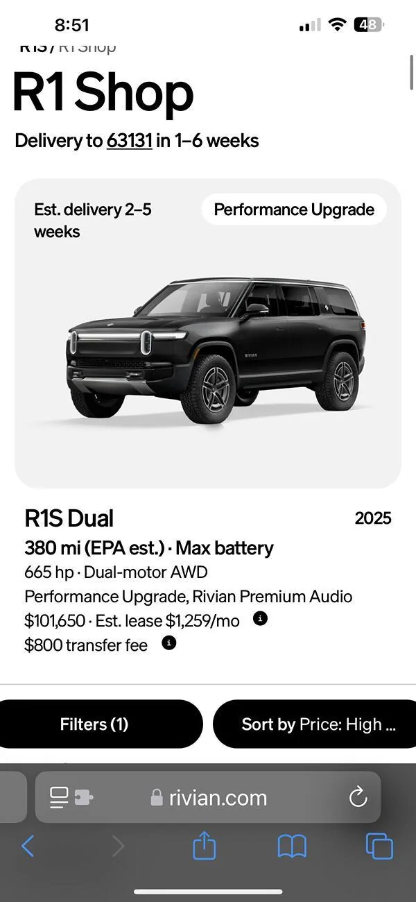

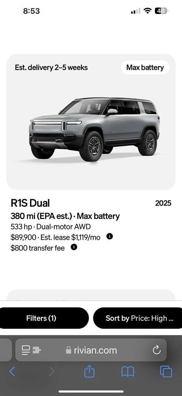

You can’t build with 20” all season and max pack but there are bunch configured with them in the shop. No idea why they do that but here’s an example.
Rivian R1T R1S Tire recommendation for R1S Dual / Max Battery? IMG_2656
Rivian R1T R1S Tire recommendation for R1S Dual / Max Battery? IMG_2657
thank you for the post!
