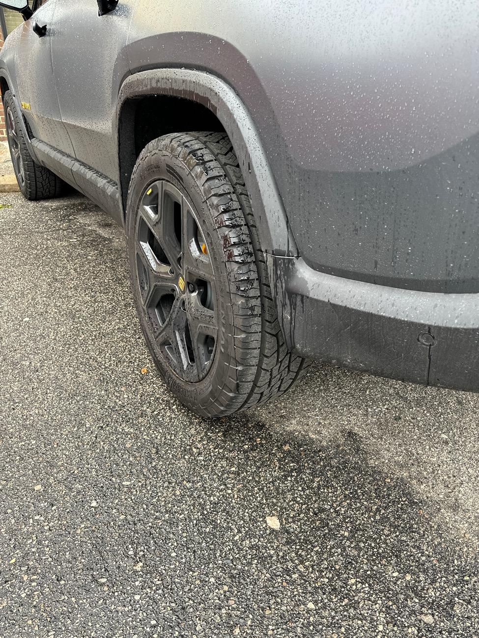

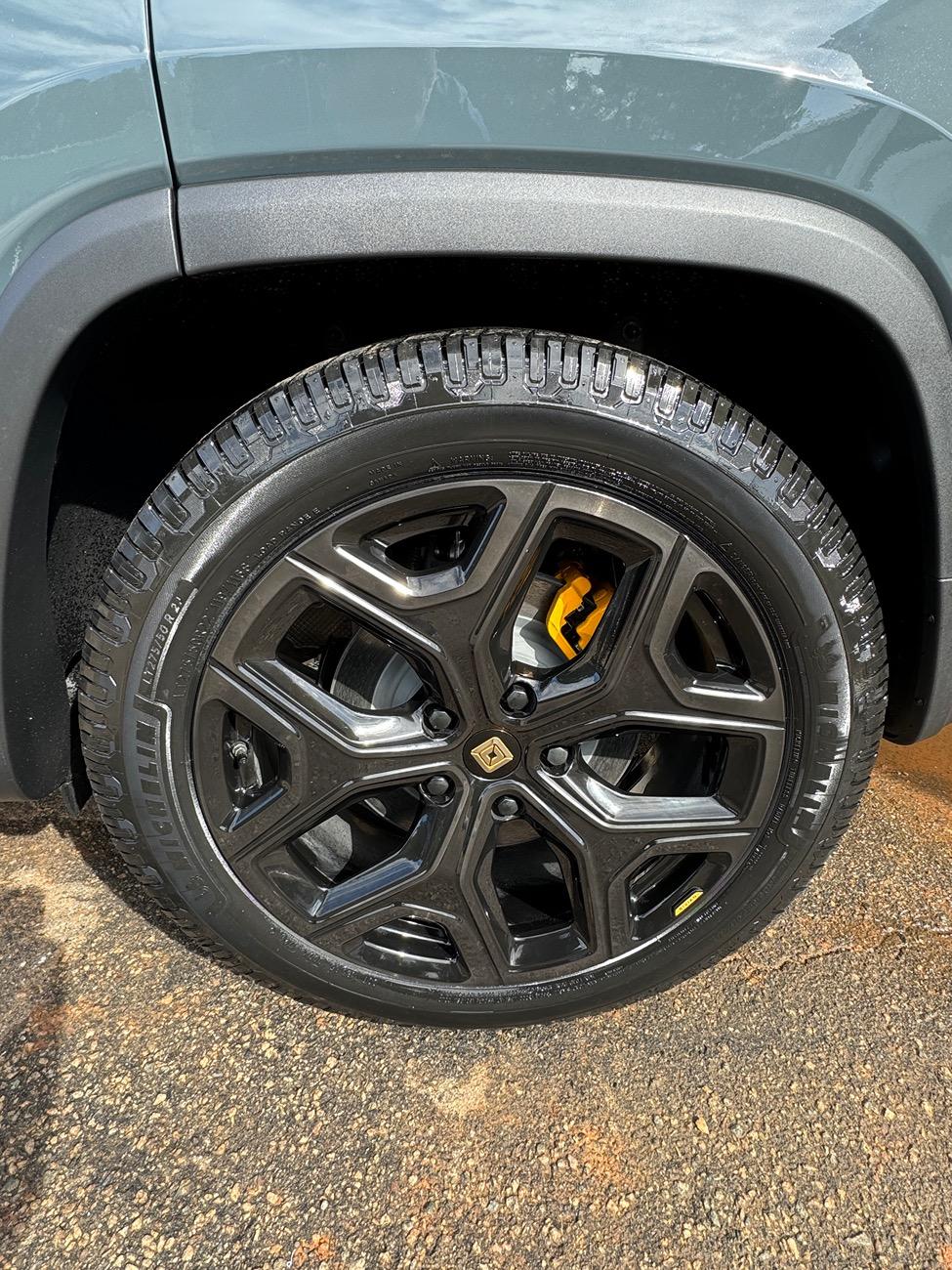

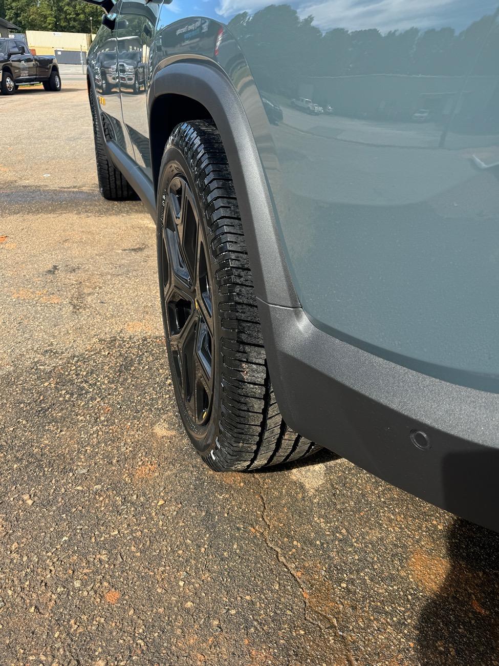

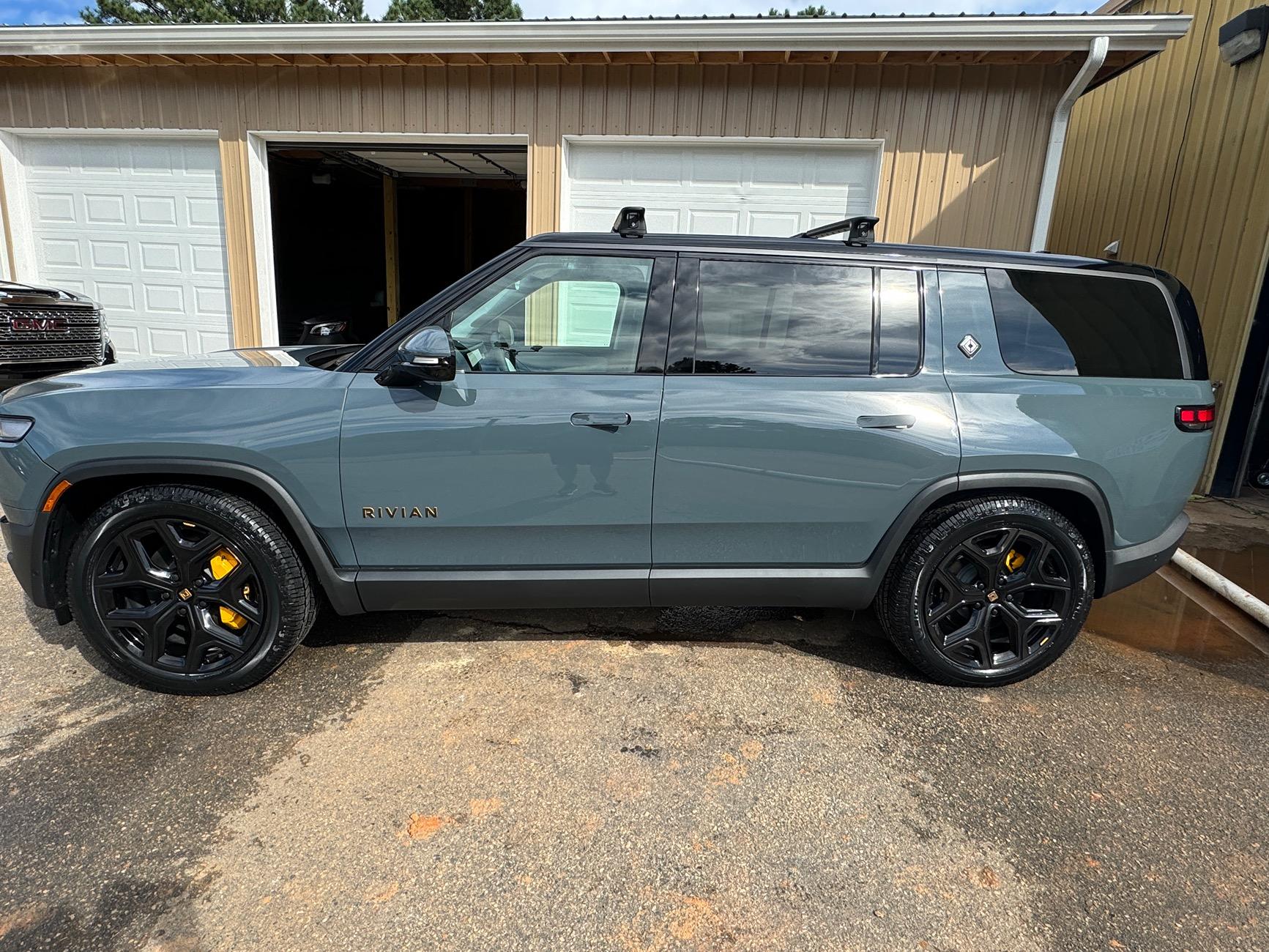

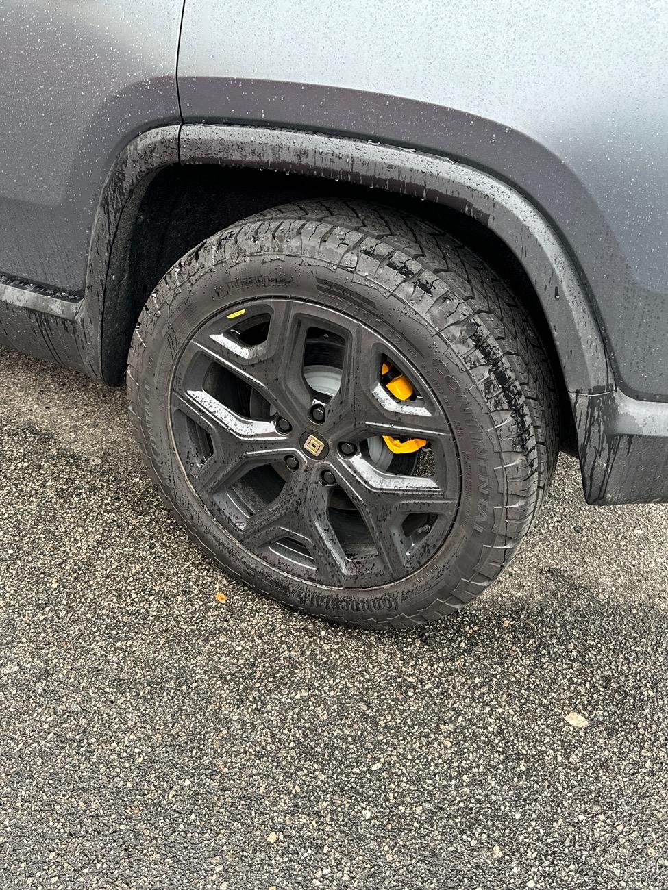

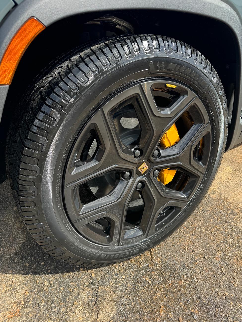

There is always the Continental Terrain Contact AT for 22” gives a nice aggressive look.
I have played around with tires and tire sizes a lot. I love the look of the 22” with AT tires or even the Michelin Defender LTX MS2 (lower pics) but I still find myself defaulting back to 20 AT. The ride is smoother and I unless you are an efficiency junky…the vehicles belong on 20 AT. ?
I just put 20 ATs on my tri max yesterday to see how it rides when I put running boards on….the smoothness and ride is so much better.
Rivian R1T R1S Tire switch question 2025 R1S IMG_7018
