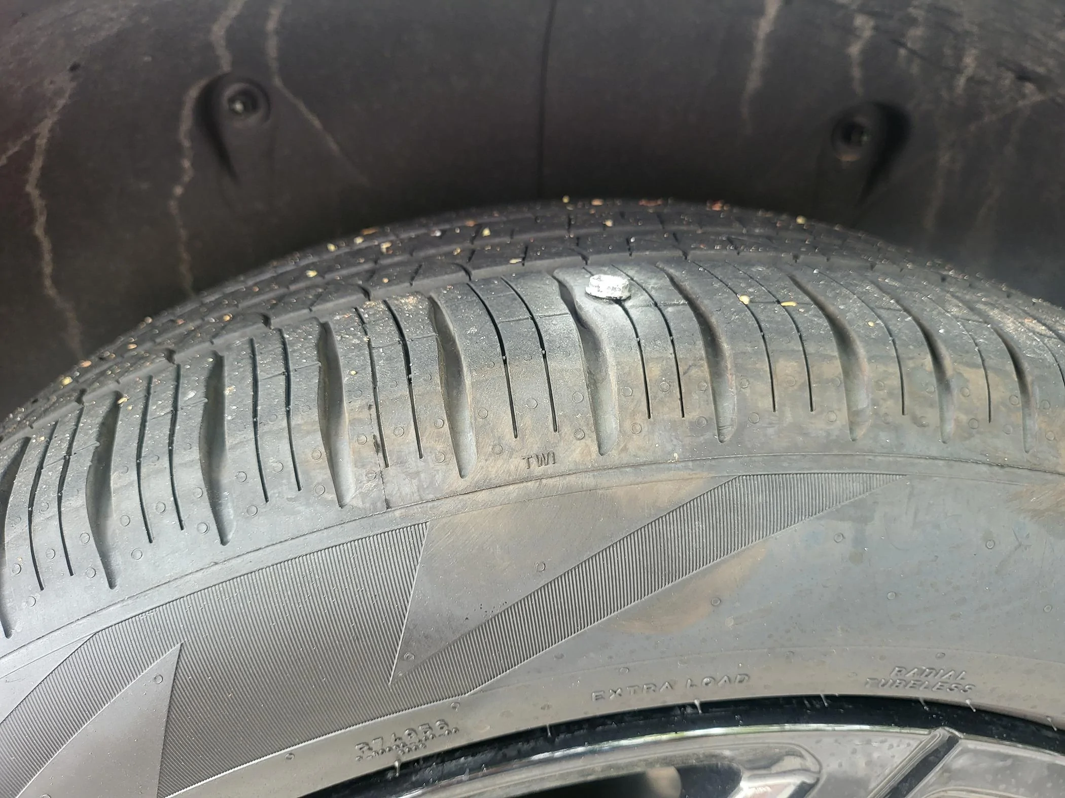

I keep having this issue. One at day two of ownership and another yesterday. Sheesh
