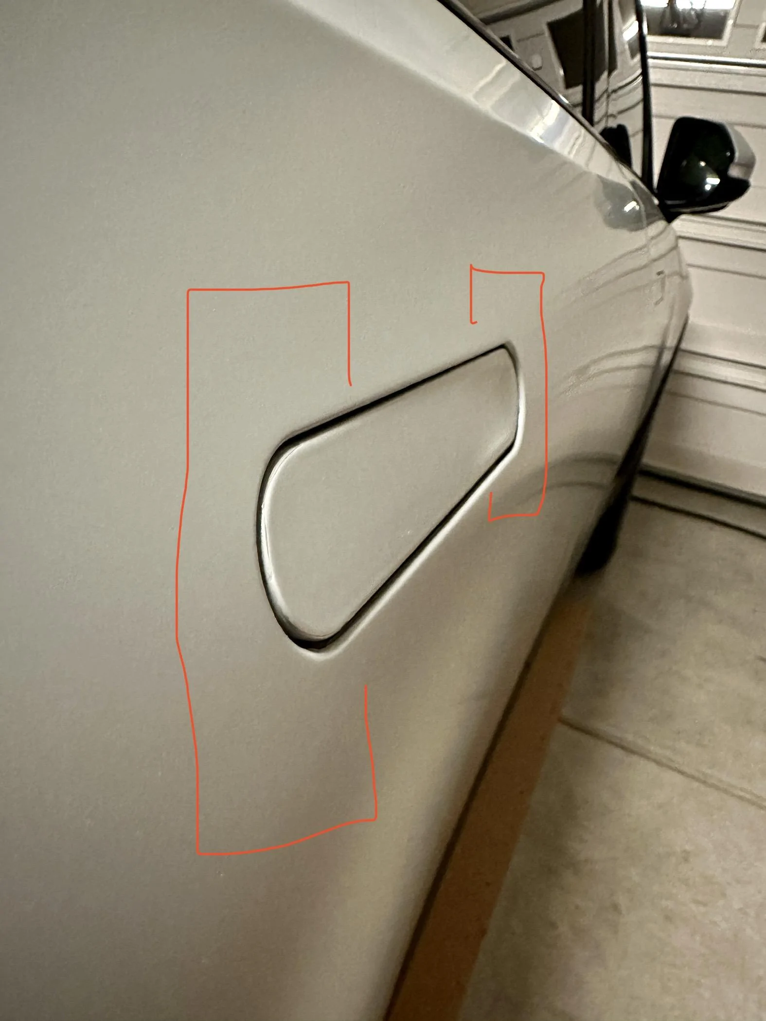

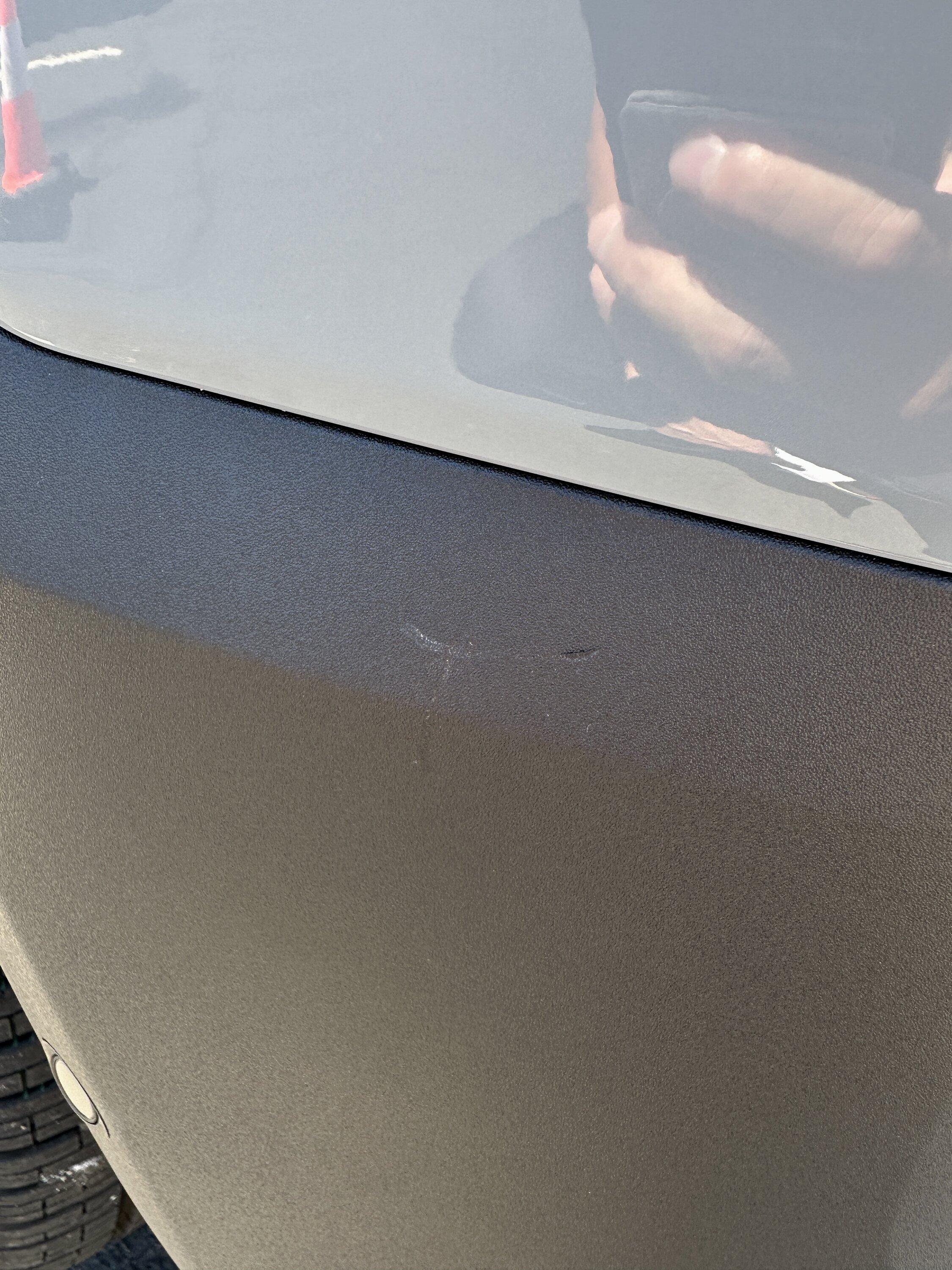

  1. Chip, scrapes along the edge of body panel adjacent to charge port. Someone tried to fix this with a paint pen, looks terrible.

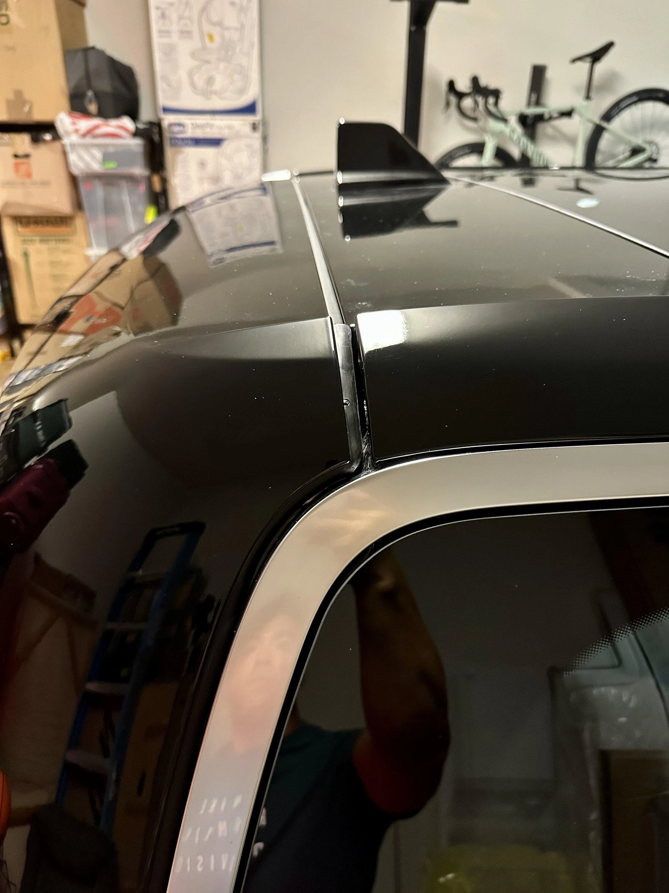

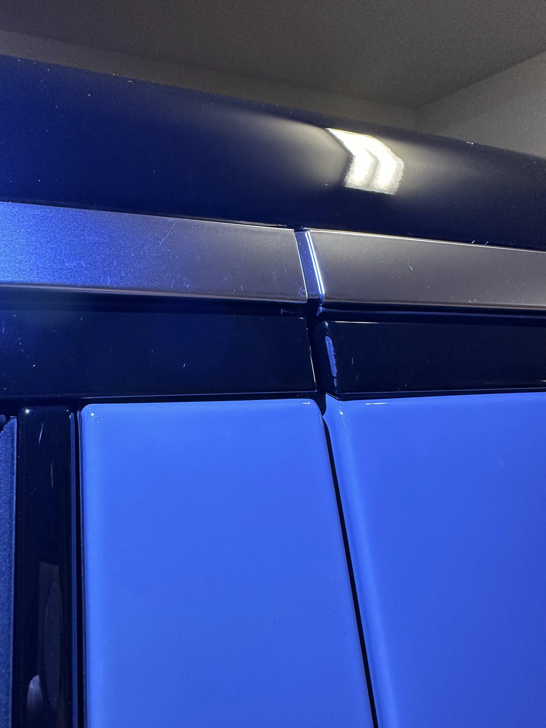

  2. Scrape along glossy black trim on top of driver side rear door.

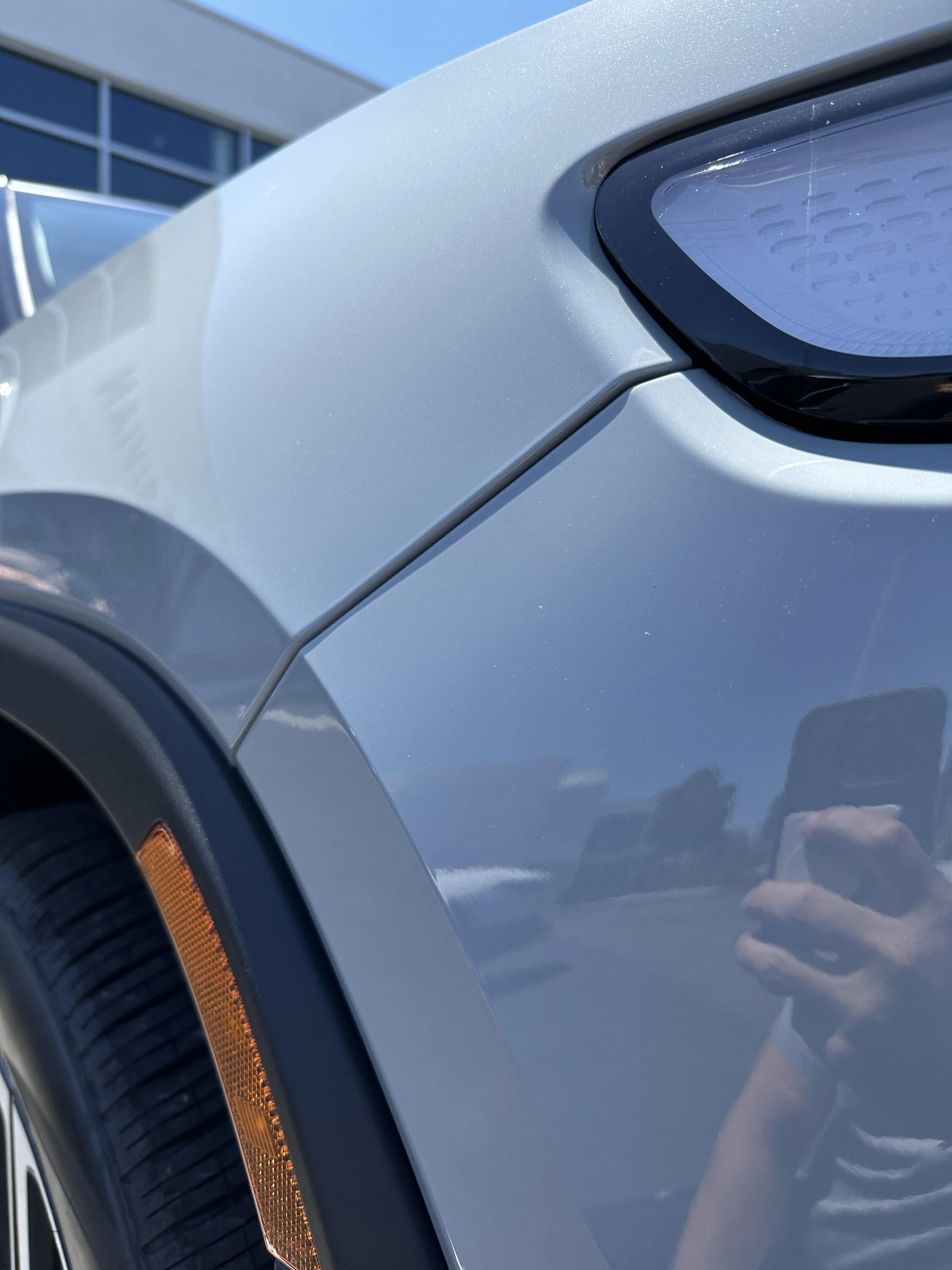

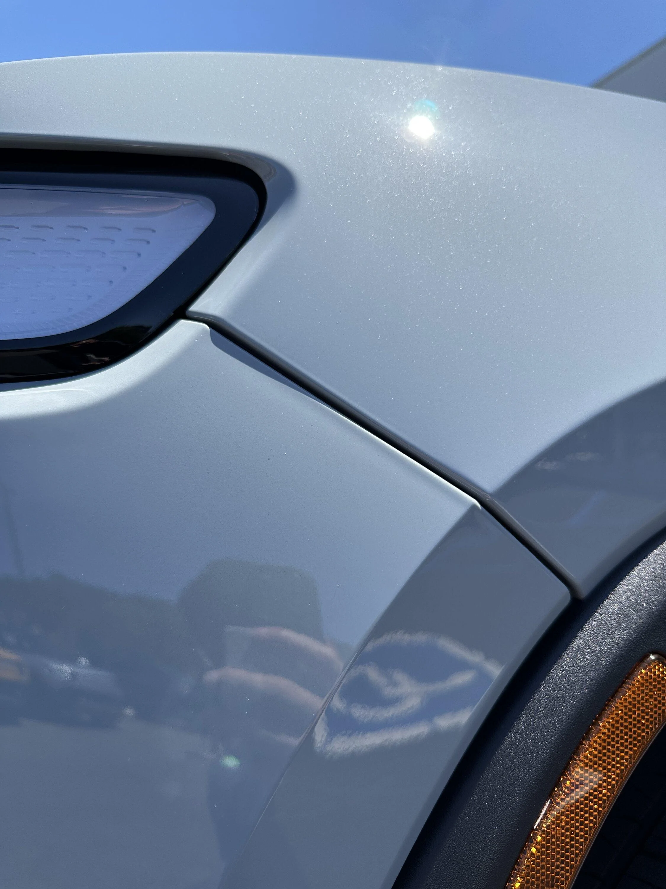

  3. Miscellaneous panels that seem out of alignment (charge port door, passenger front where fender meets front panel, rear driver side door looks too high).

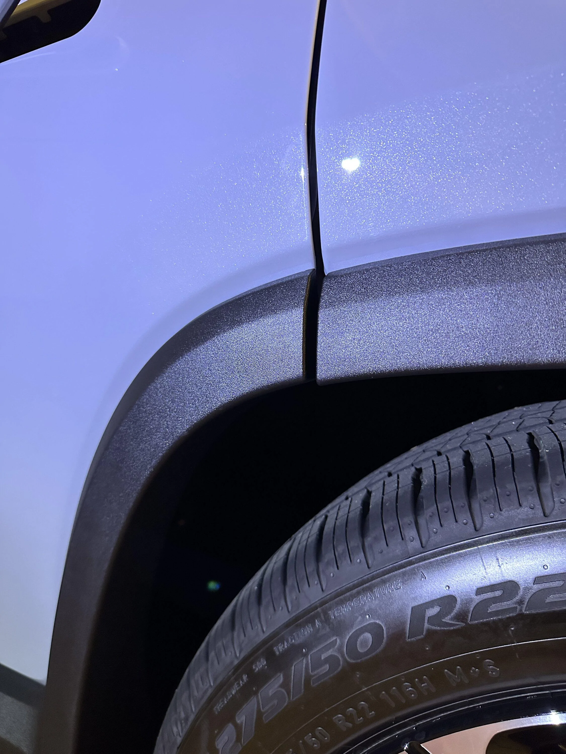

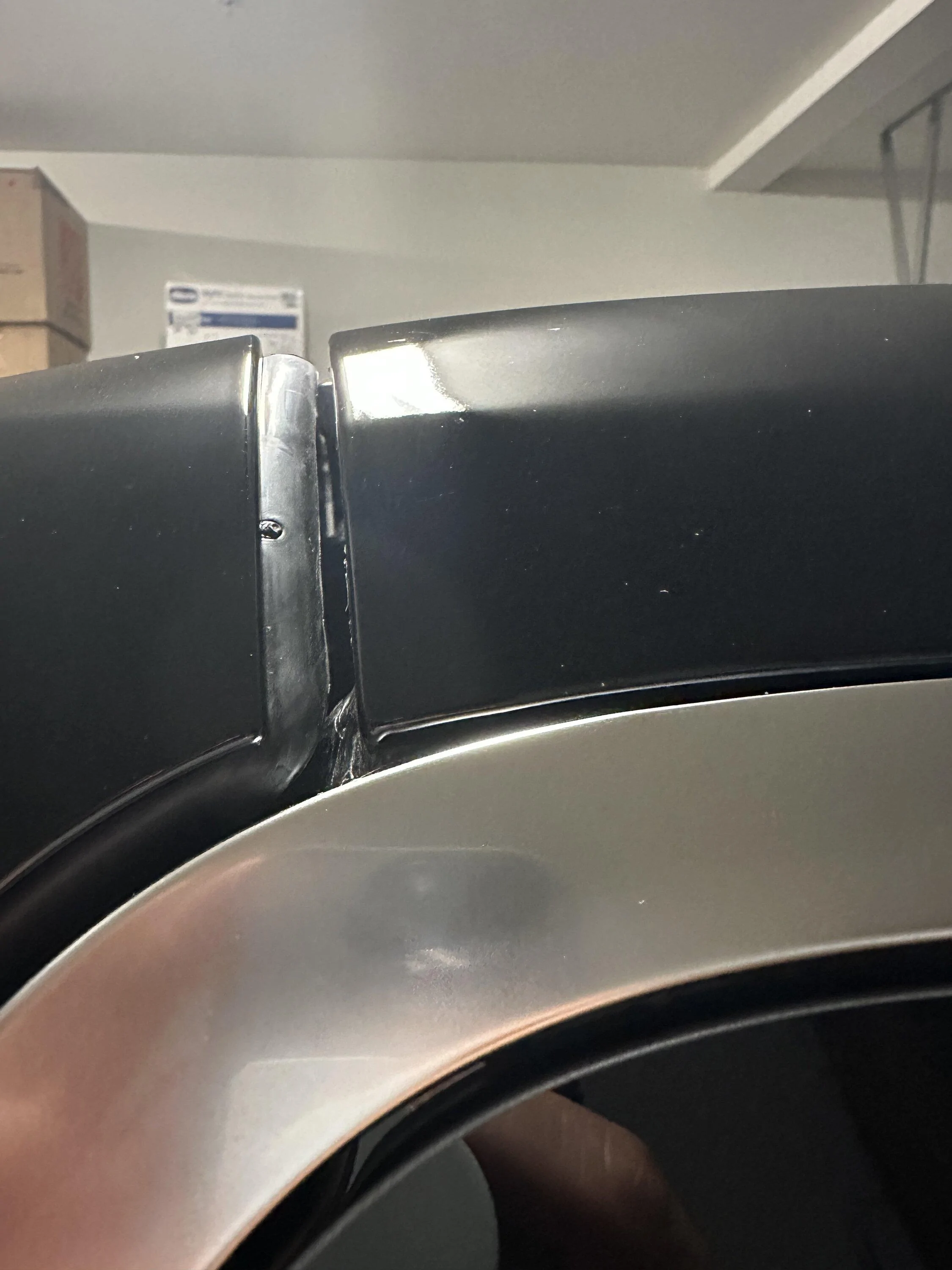

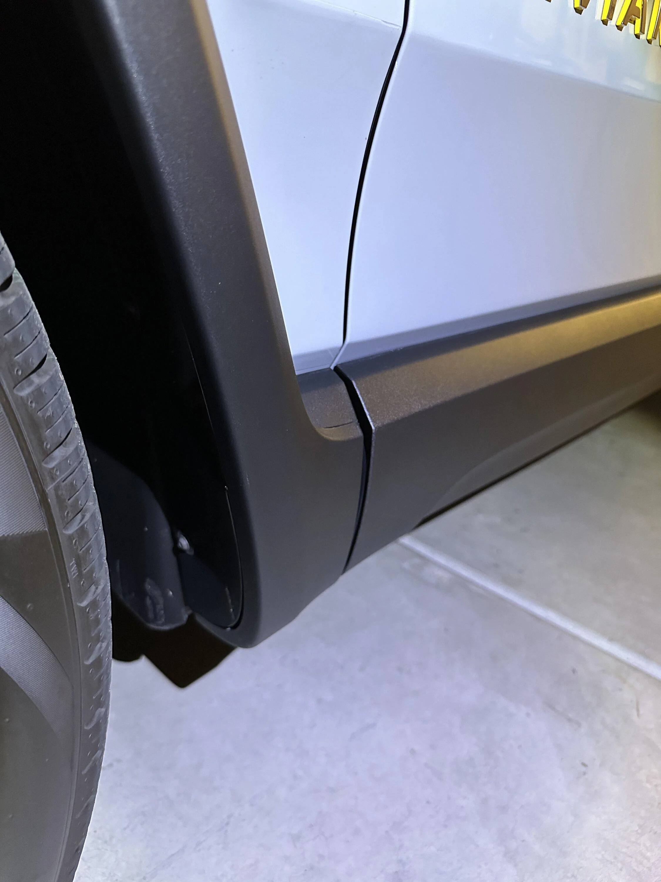

  4. Miscellaneous lower plastic trim out of alignment (where driver door meets front fender), passenger side doesn't seem to have as noticeable of a gap.

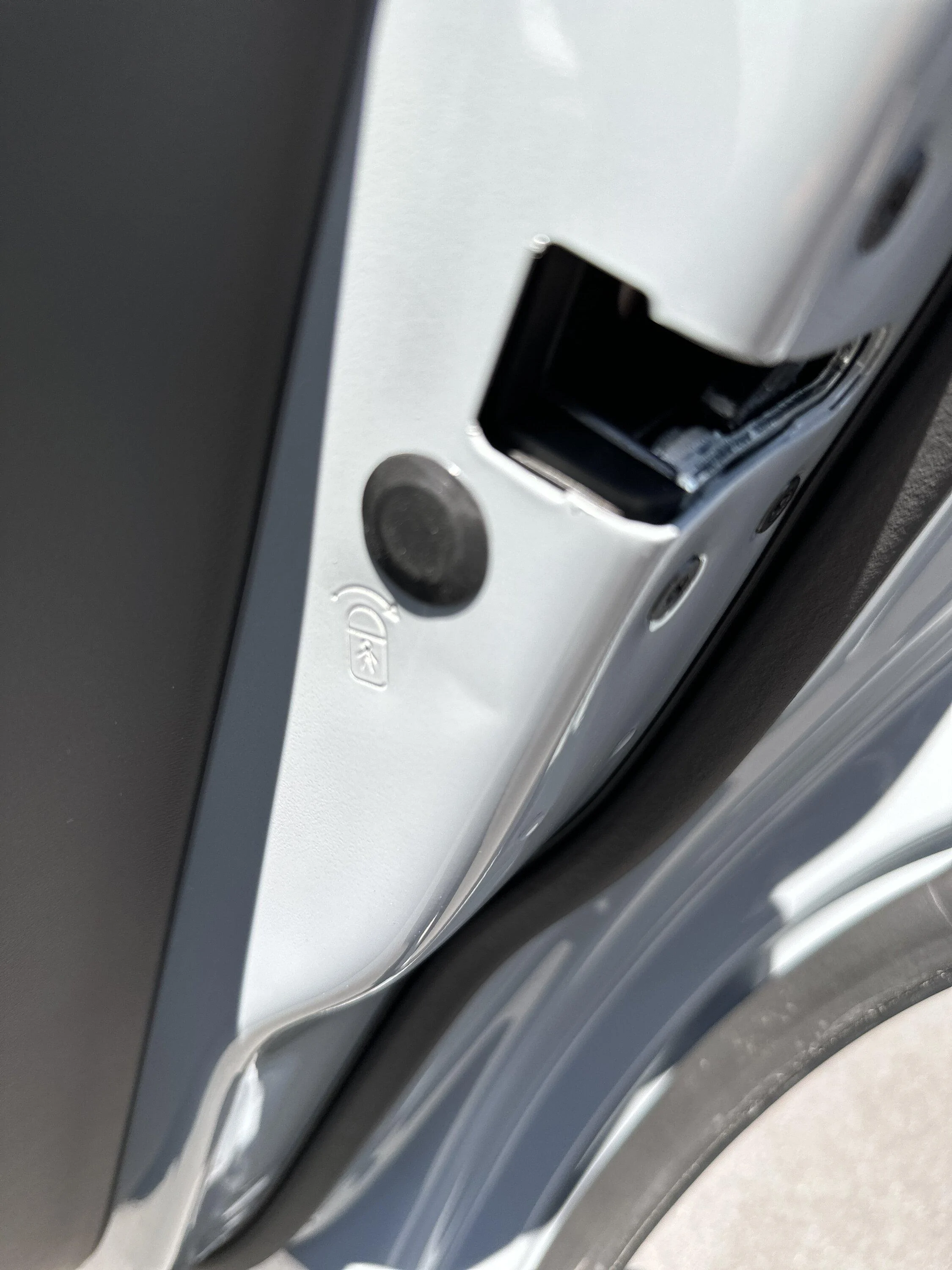

  5. Small dent on passenger rear door near child lock icon.

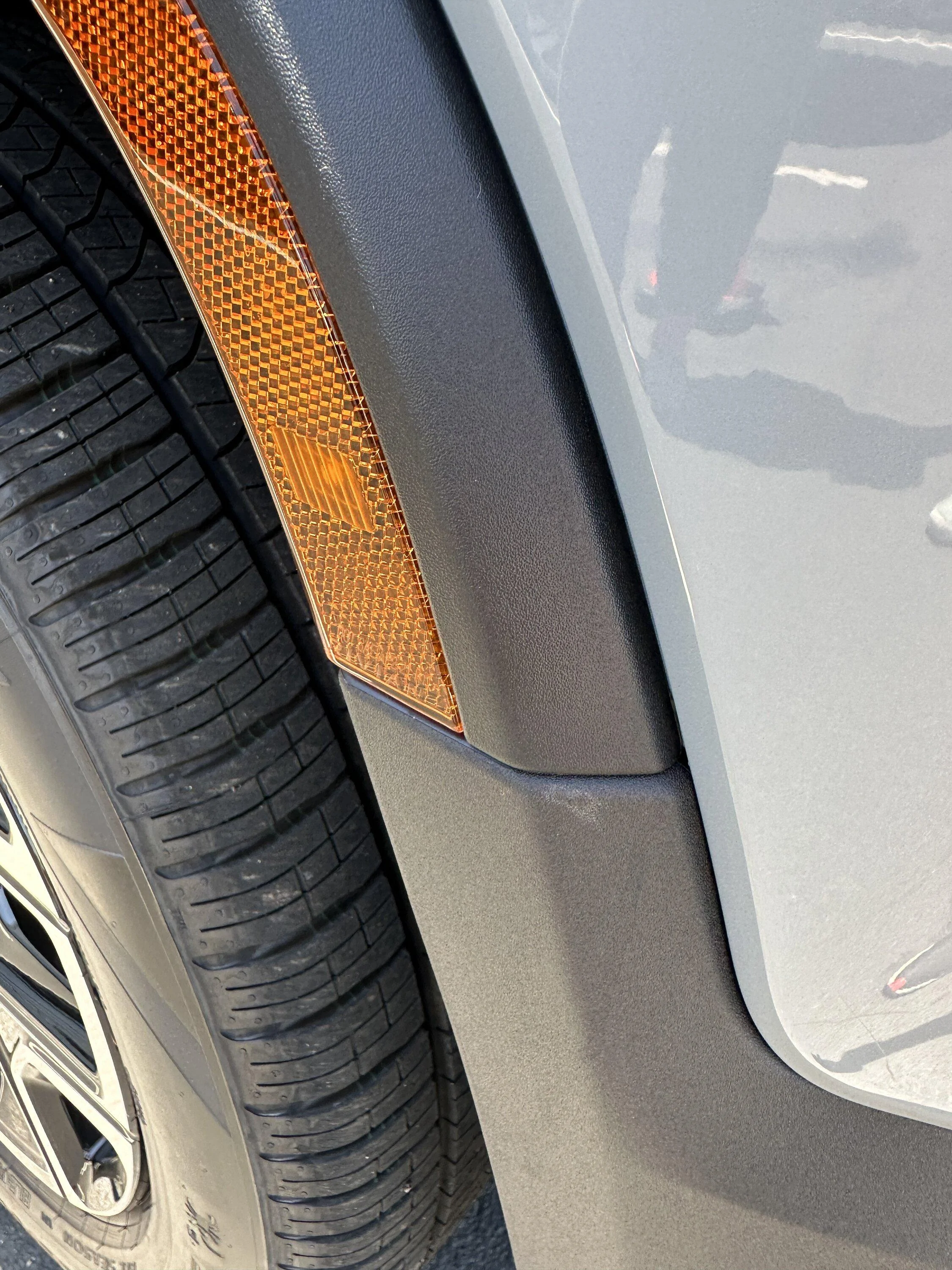

  6. A few scrapes along front passenger side bumper plastic trim.

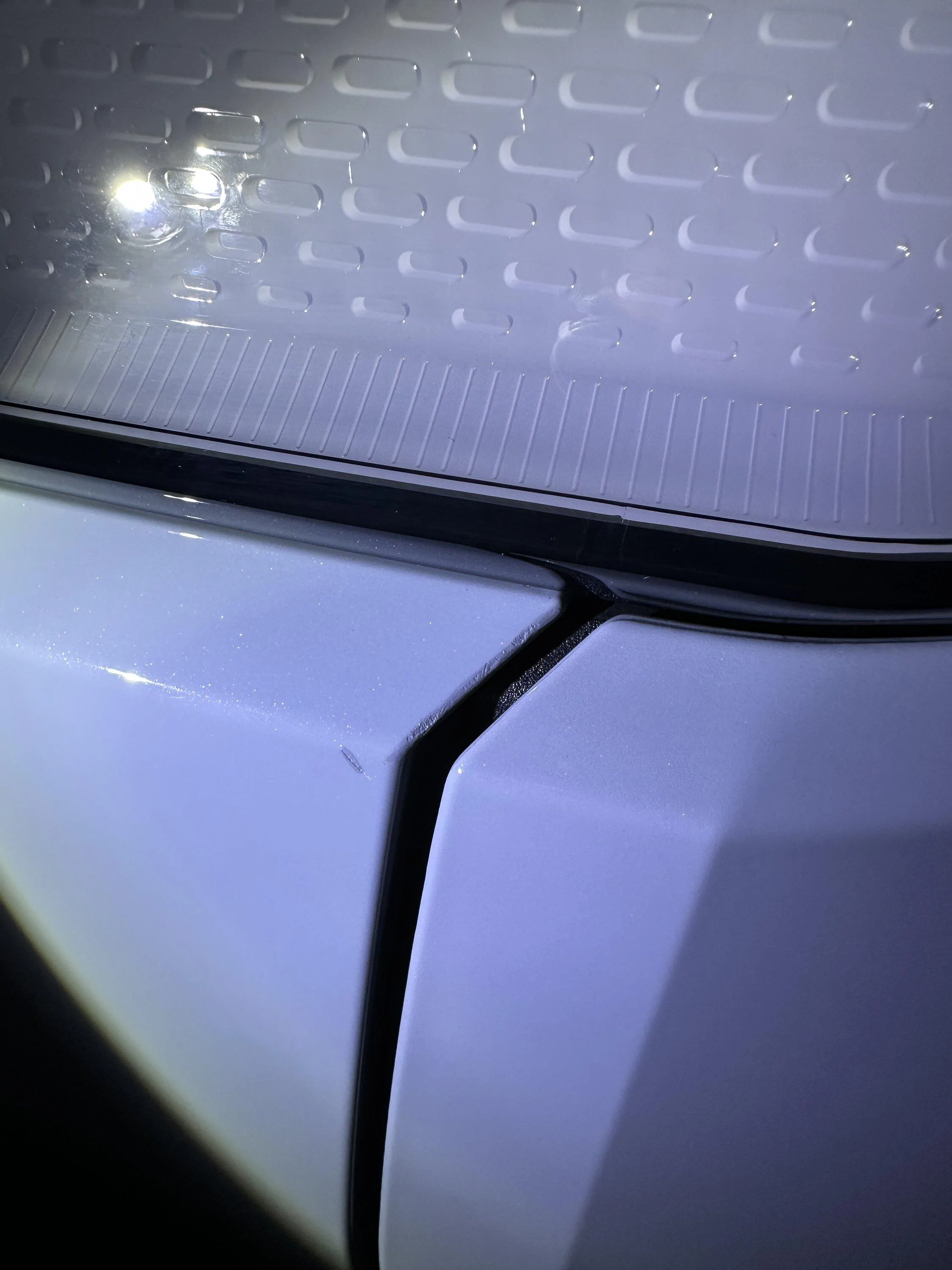

  7. Top of tailgate sits far away from body, I can see through to the other side?
    Rivian R1T R1S Took delivery at Costa Mesa SC [R1S 149##] IMG_6933
    Rivian R1T R1S Took delivery at Costa Mesa SC [R1S 149##] IMG_6929

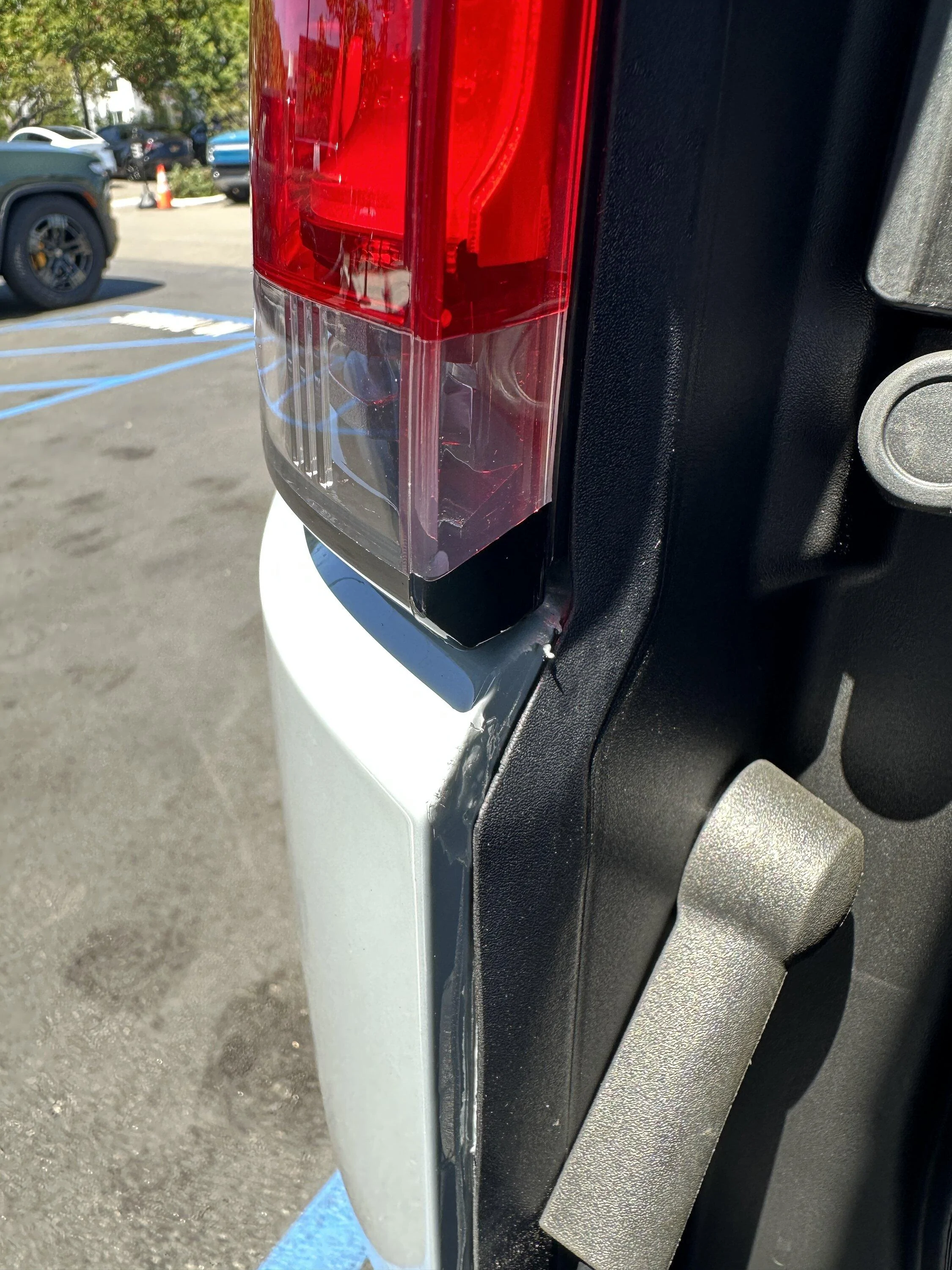

  8. Rough, unfinished metal/paintwork on driver-side trunk area beneath tail light, passenger side has minor imperfections

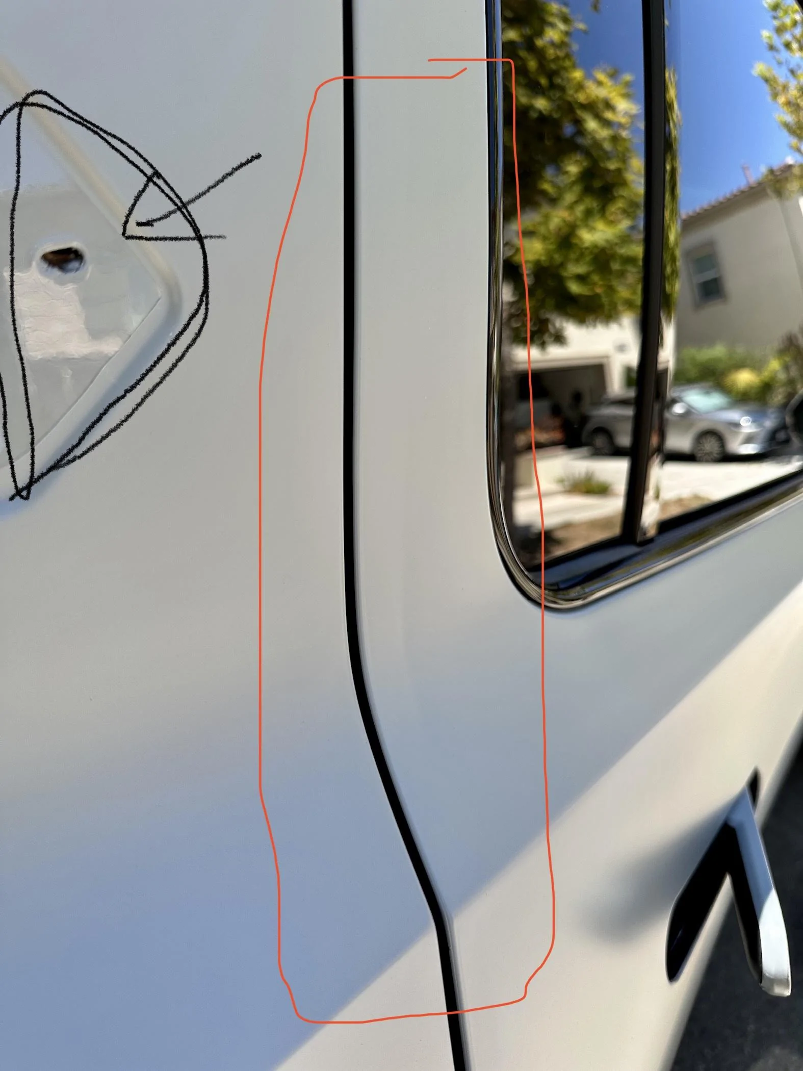

  10. Passenger rear door seems to jut out a little even after slamming it to close.

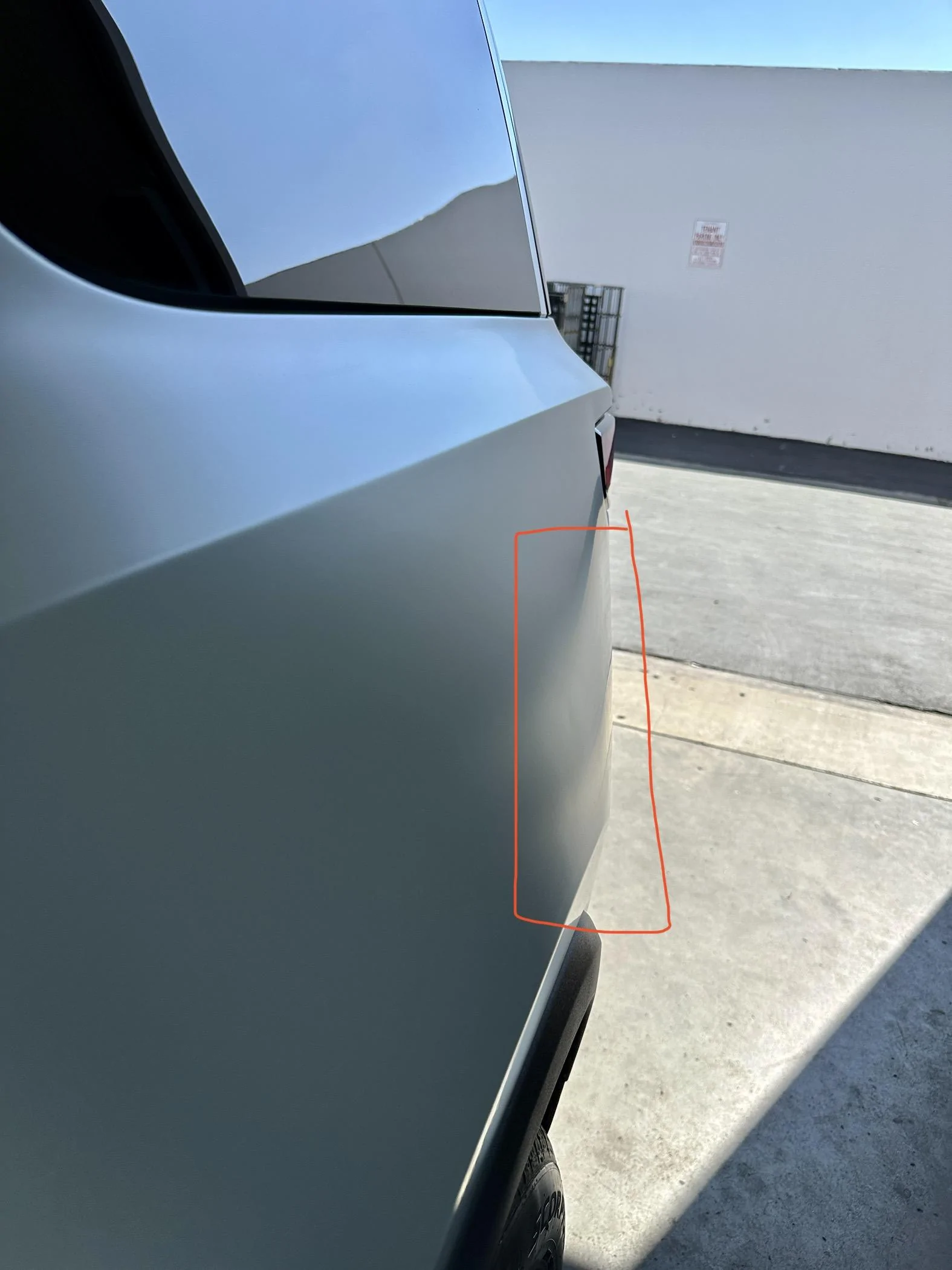

  11. Noticed a small dent on driver side rear fender

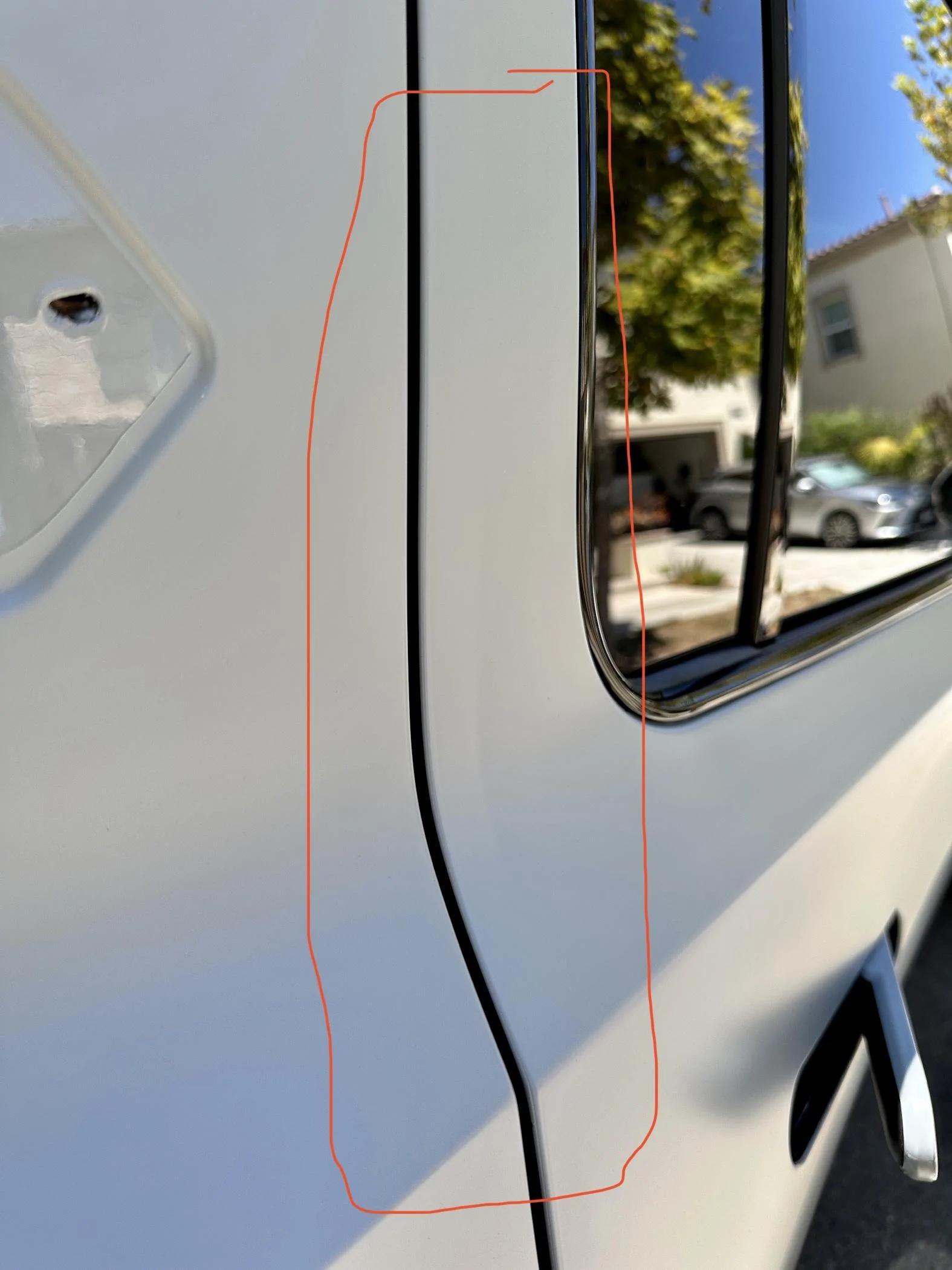

  12. Probably part of the manufacturing process but there’s a distinct indentation line down the passenger rear door
    Rivian R1T R1S Took delivery at Costa Mesa SC [R1S 149##] IMG_7222

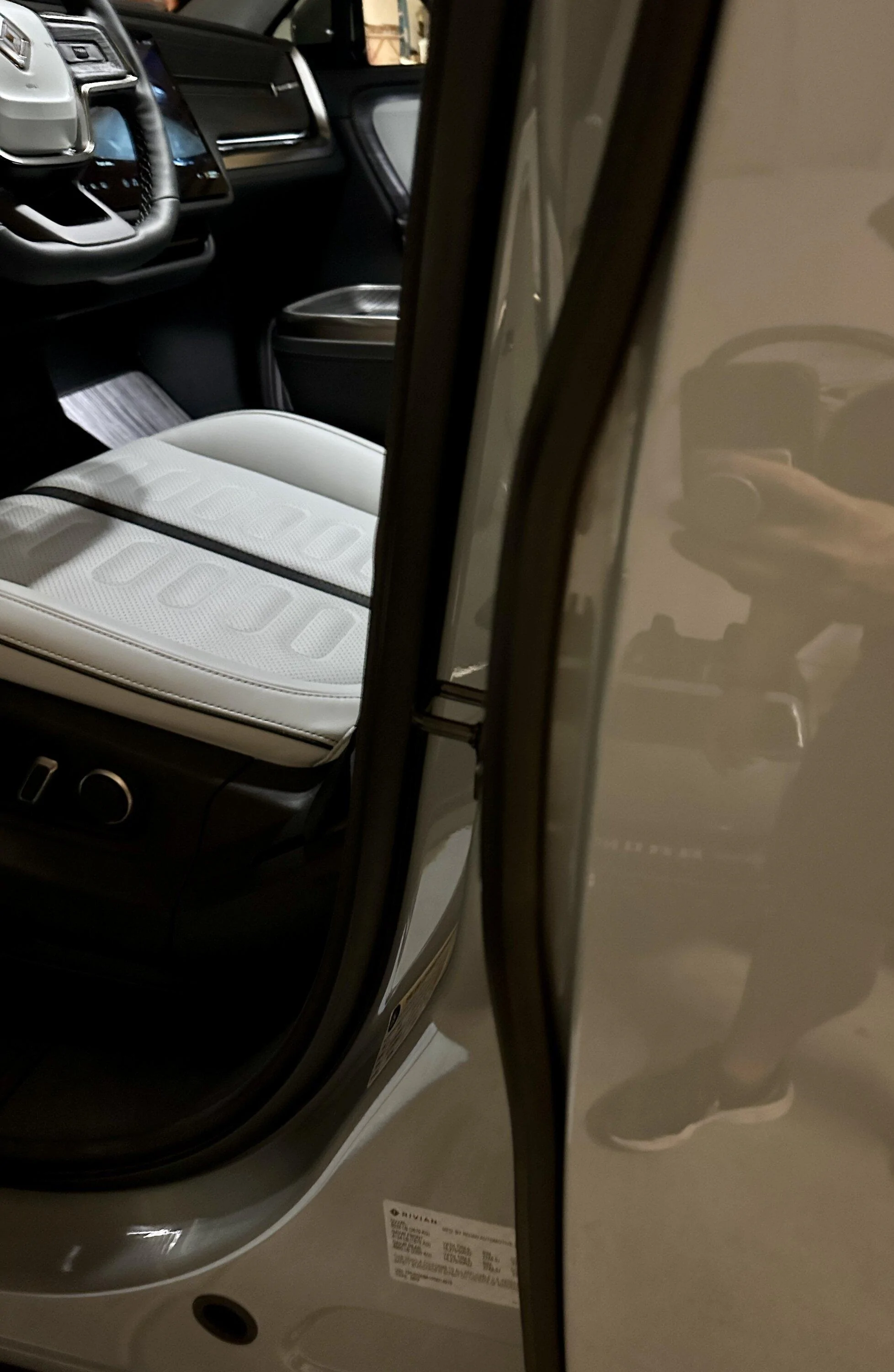

Issues caught / manifested weeks later:

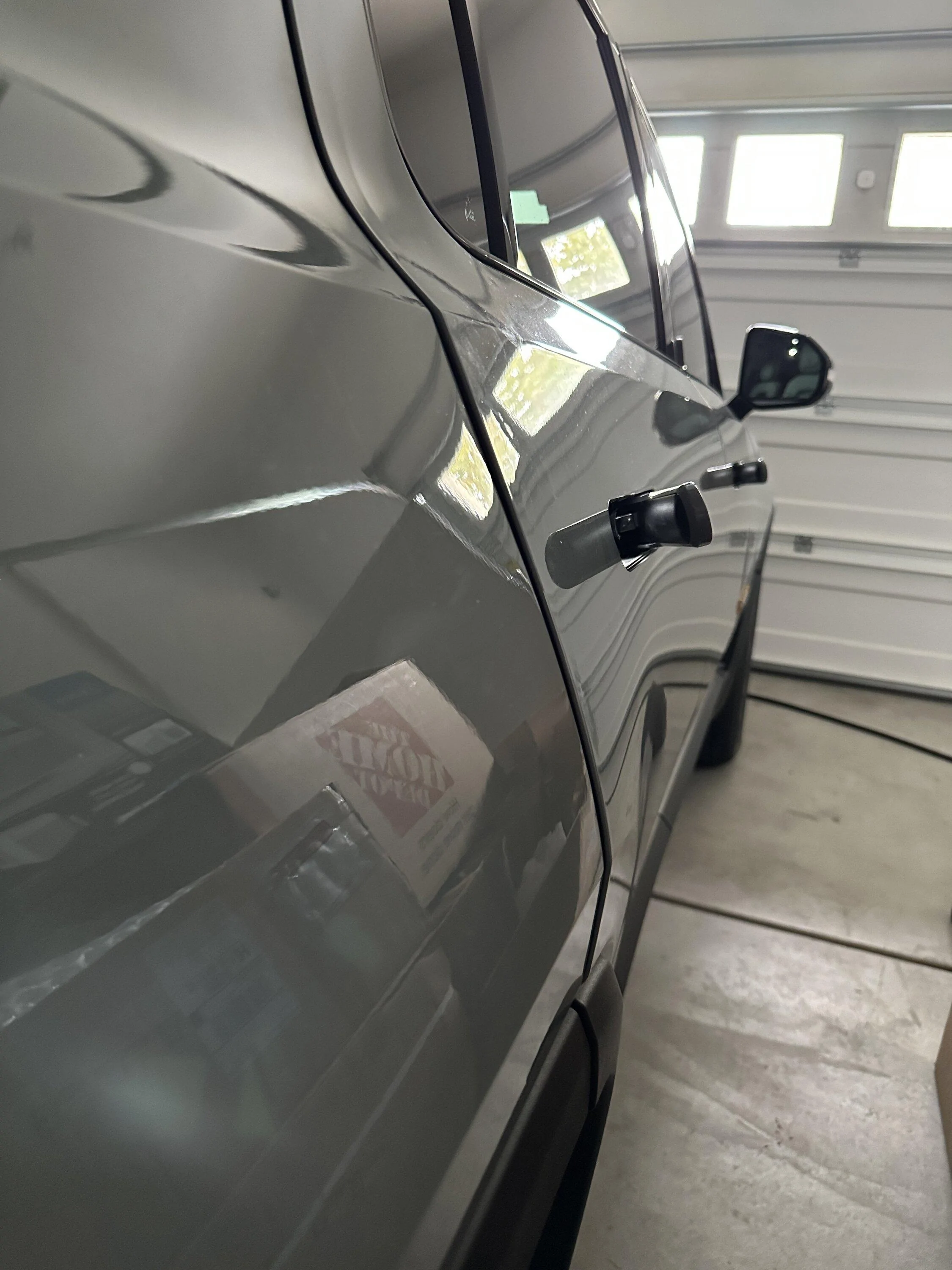

  1. Rear passenger door handle misaligned compared to the others. Front portion dips in, rear sticks out.

You should get 3 and 4 sorted too. They had seem to be doing better with panel alignment, especially around the charge port so yours seems to be an unusually poor one for being two years into manufacture.

#12 looks like they repainted that area, isn’t that your B pillar logo with tape over it? (Marked in black)
Wow that tailgate is way off! I had all the above and more on my R1S. That indention on the door I didn’t catch before but I have that as well. I wonder how they would address that. If it’s a full repaint of the door I’m just going to leave it alone.

1) Front fascia chipRequires separate visit
2) Scrape along glossy black trimPaint pen
3) Panel alignment issuesPunt, see 1) Front fascia chip, assume there will be an opportunity to fix the panel alignment when reattaching after paint fixes
4) Trim alignment issuesNot worth addressing
5) Small dent inside passenger rear doorNot worth addressing
6) Scrapes along front lower plastic bumperReplaced
7) Tailgate sits far away from bodyAddressed perfectly (also doesn't make any sound when opening now)

12) Indentation line down passenger rear doorNot worth addressing

The "rough metal work at tailgate" is body adhesive to connect the panels for no squeak.

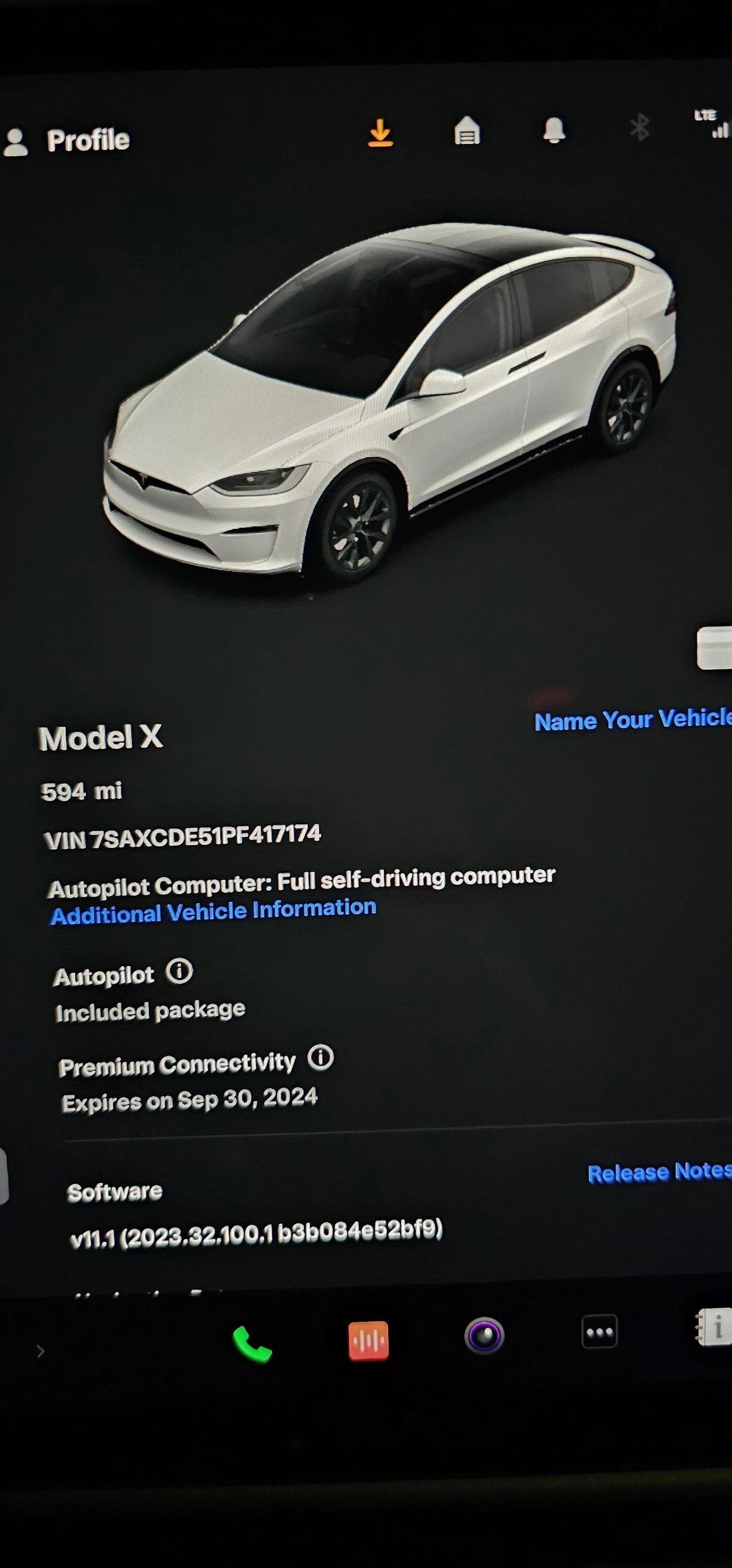

@citizen
Glad to hear it all worked out (for the most part).
Btw I'm literally sitting in that same model x loaner right now 😂
