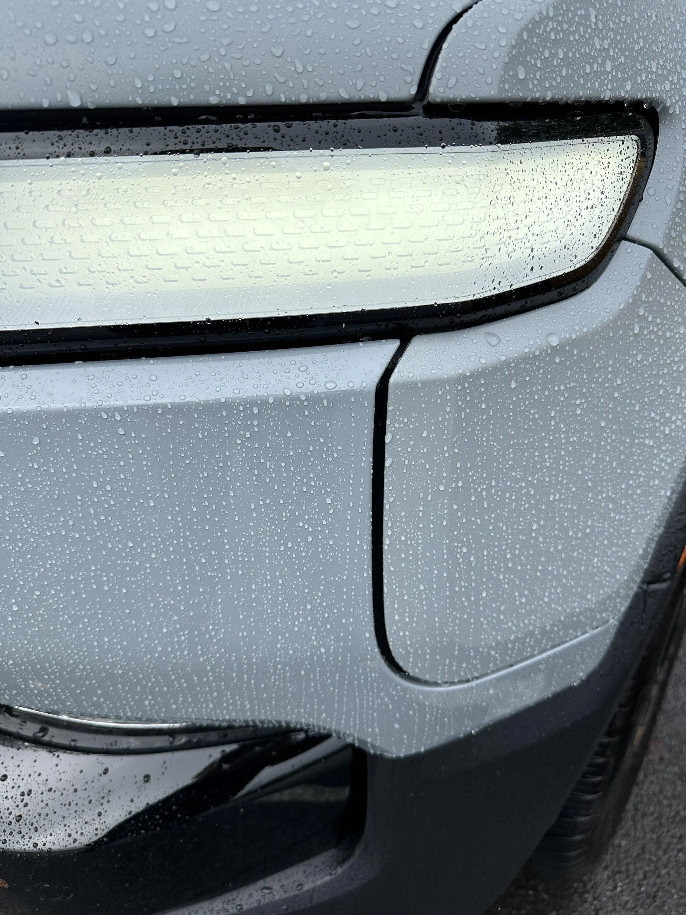

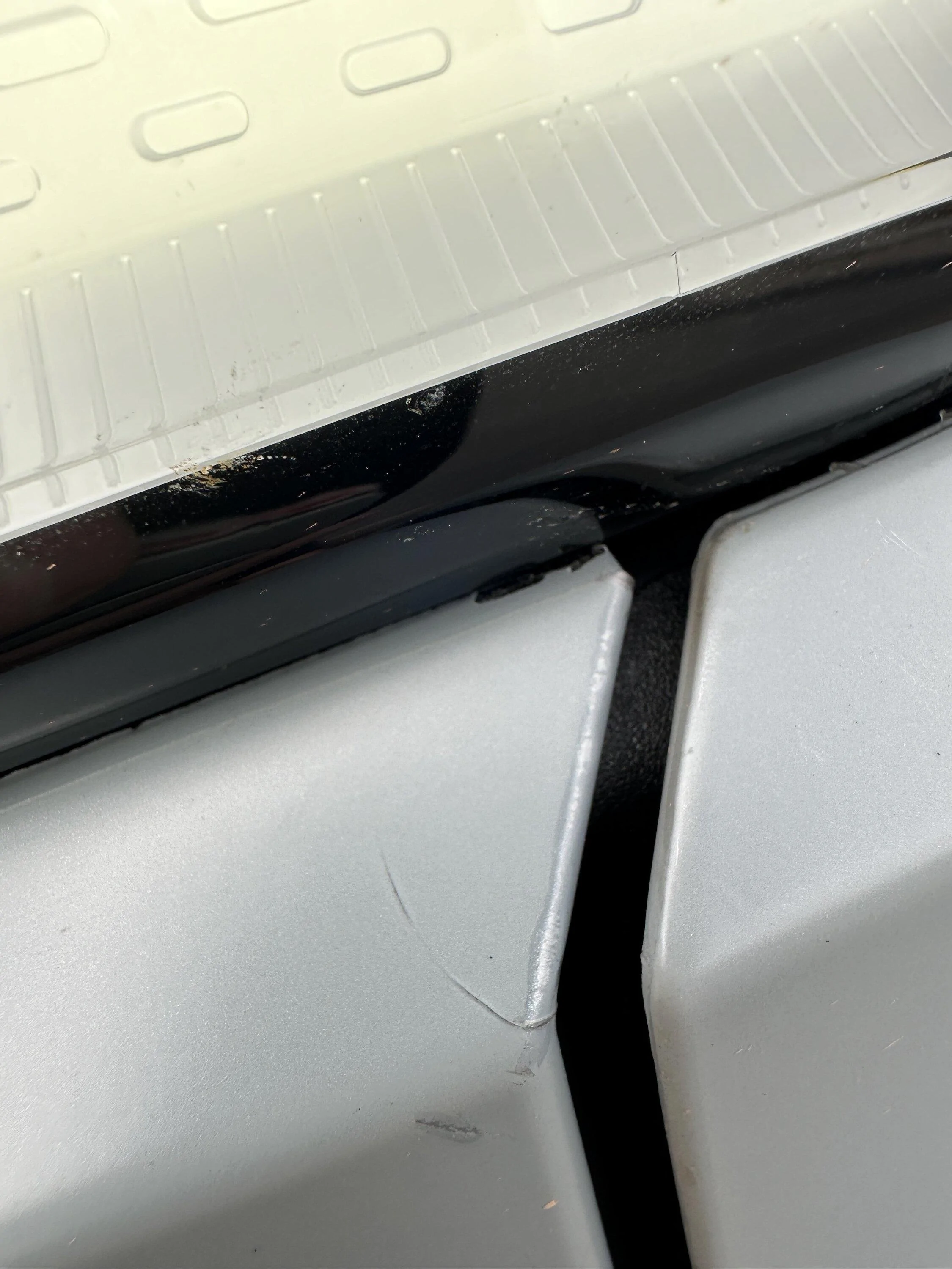

Here's the before with paint pen fixes and the chip that started showing up at the top right corner beneath the light assembly:
Rivian R1T R1S Took delivery at Costa Mesa SC [R1S 149##] 1705995126109
The after when I picked it up, looked pretty good and they fixed the panel alighment so it wouldn't rub up agains tthe light assembly:
Rivian R1T R1S Took delivery at Costa Mesa SC [R1S 149##] 1705995165242
But after I got it to my PPF shop and they prepped it for replacement film, they noted a bunch of paint defects:
At this point, I'm just going to live with the issues, not totally Rivian's fault. They couldn't have really caught it during the rain this past weekend. And honestly, it's fine, hoping the matte film hides some of the defects.

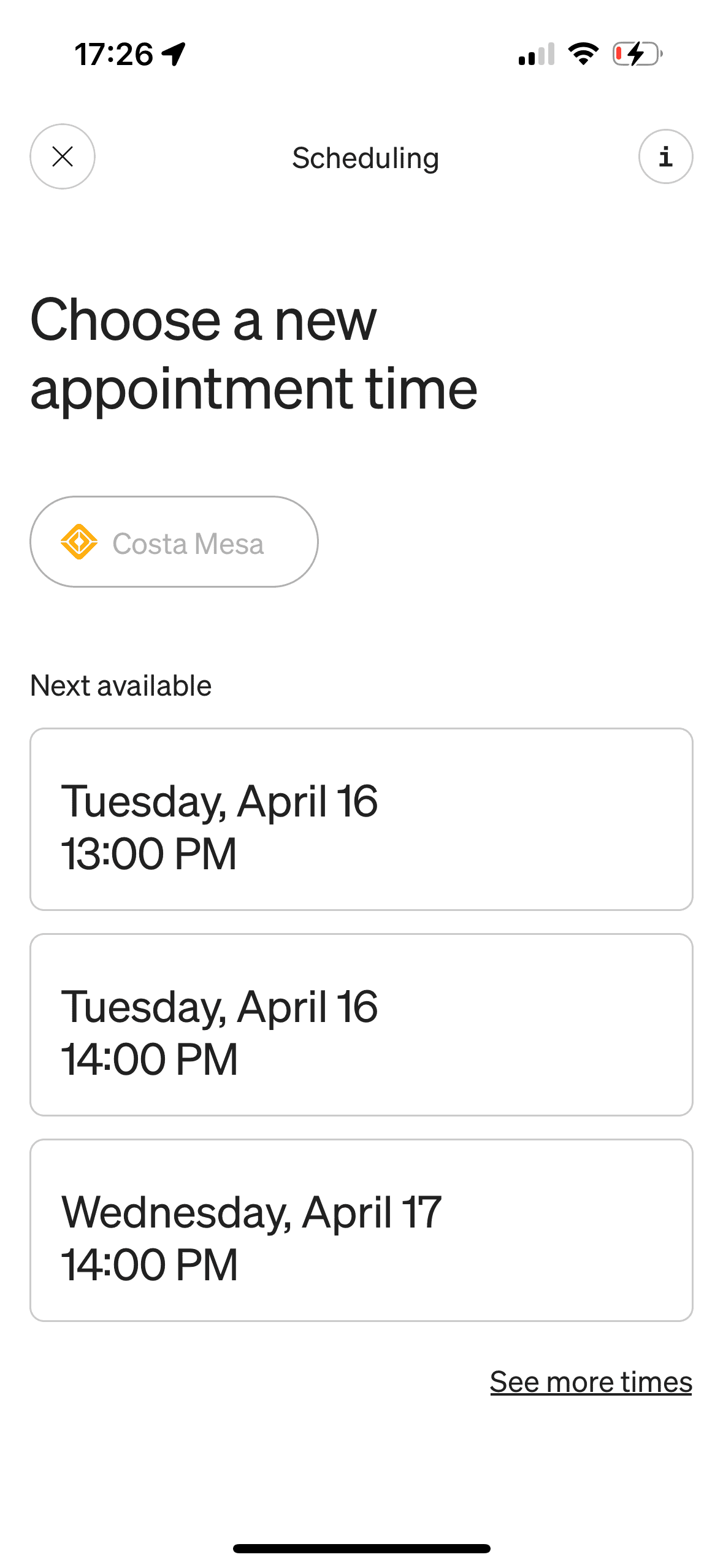

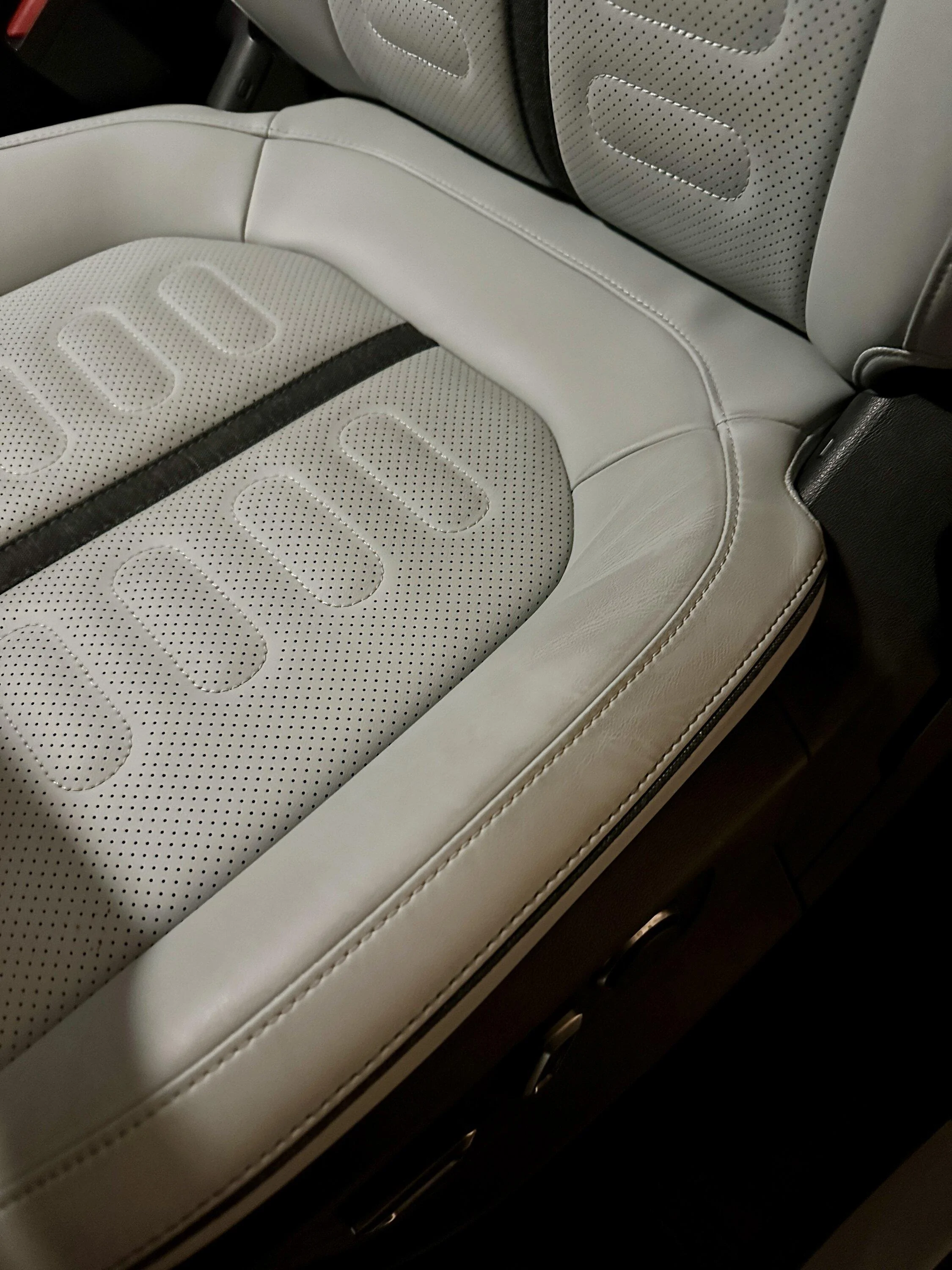

Looks like my driver-side heated seat doesn't work. I never use it but wife was driving the other day and decided to try it out. Turns off immediately after you tap the button to turn it on. Tried tapping it via the bottom row button, and also within the climate controls. Same behavior.
Steering wheel heat works, passenger heated seat works, both seats cooling work. Tried two hard resets and still no luck.
To my surprise, saw available appointments less than a month and a half out at Costa Mesa. Never seen appointments available so soon, especially for a low-priority issue. Eastvale / Lake Forest must be ramping up w/ their technicians!

Wrapped my third service appointment on Friday. This was a quick one. My wife dropped the car off Wednesday afternoon, we were told Friday morning the car was ready. Got another great rental from Enterprise Exotics by SNA. This time it was an MB EQE. Kiddos got to experience a sedan for once.
Rivian R1T R1S Took delivery at Costa Mesa SC [R1S 149##] Screenshot 2024-04-30 at 17.42.40
At pickup, the folks were wonderful. I got there about 30 min. before closing on a Friday so it was pretty quiet. My kiddo got to explore the waiting area for a bit as they processed paperwork and brought the car out. I took him to the back where there's a glass door entering the service area and he got a kick seeing all the R1s up on lifts. One of the service advisors even hooked him up with a snack which was so helpful as I had forgotten to bring his usual post-daycare snack. Very thoughtful of them!
Issues Addressed:
  1. Torsion spring disconnected so tailgate opened w/o any resistance; I originally wanted to fix this myself but others on the forum noted that there was a new assembly. I took a quick look at the fix and it didn't seem like there was a new assembly; no matter, it was fixed.
  2. Driver seat heating wasn't working (may have never worked); the issue was that whatever wire was needed for operation was not fully plugged in.
