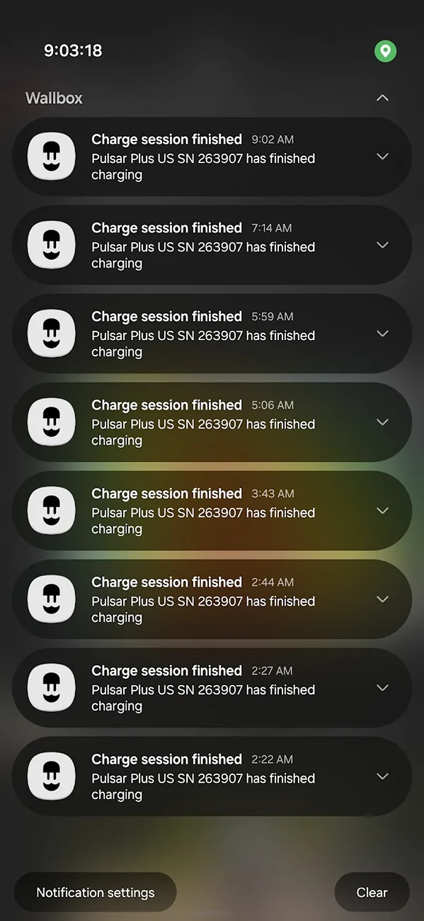

Anyone else noticed this? I've been charging at work a bit recently, so not sure when exactly this started... sometime over the last few weeks.
Vehicle didn't sleep last night either.
Nothing unusual in the car.... parked at home in usual spot. Car seats haven't moved, front belts aren't plugged in, etc.

Looks like maybe your vehicle isn't going to sleep. Check all the usual suspects - seat belt left buckled, package left on front seat, door ajar, etc. Do a hard reset t, leave it unplugged and stay away for an hour so it doesn't proximity unlock, then try charging again.

Honestly, not entirely sure. Definitely after the hotfix, was even possibly before that. It's been a busy few weeks and I have been charging at work more than usual.
My vampire drain hasn't been bad. Low 1.x. Used to hit 2s on the updates from a few months ago. I'm still waiting for this cycle to refresh, last vampire drain in the app is from 10pm last night, 1.2 kwh.

I have soft reset since the update because the remote camera wasn't working, but I haven't hard reset. I'll give that a go. Already checked all the others.

Soft reset aka infotainment reset. This is a charging and sleep cycle issue, not related to infotainment. You need a hard reset. Hard reset also include a diagnostic log capture. So if you end up engaging Service/Support, be sure to mention it so they can look for the captured data in their investigation.

Did you check the Energy section in the app to see what was using the energy? Also not sure where you live, but since it's getting hot out, if you use the 'Auto Cabin Ventilation' setting perhaps that's using some energy.
