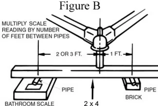

I can measure tongue weight with a bathroom scale if I want to know what it is. With a boat trailer the ability to adjust weight distribution is quite limited anyway making the weigh safe cost/benefit even lower.
I don't think my bathroom scale goes up to 600-700 lbs that the tongue weight of my camper registers at. But I suppose I shouldn't make an assumption that yours doesn't.
I’d hope no bathroom scales do but with the size of some people who knows.
