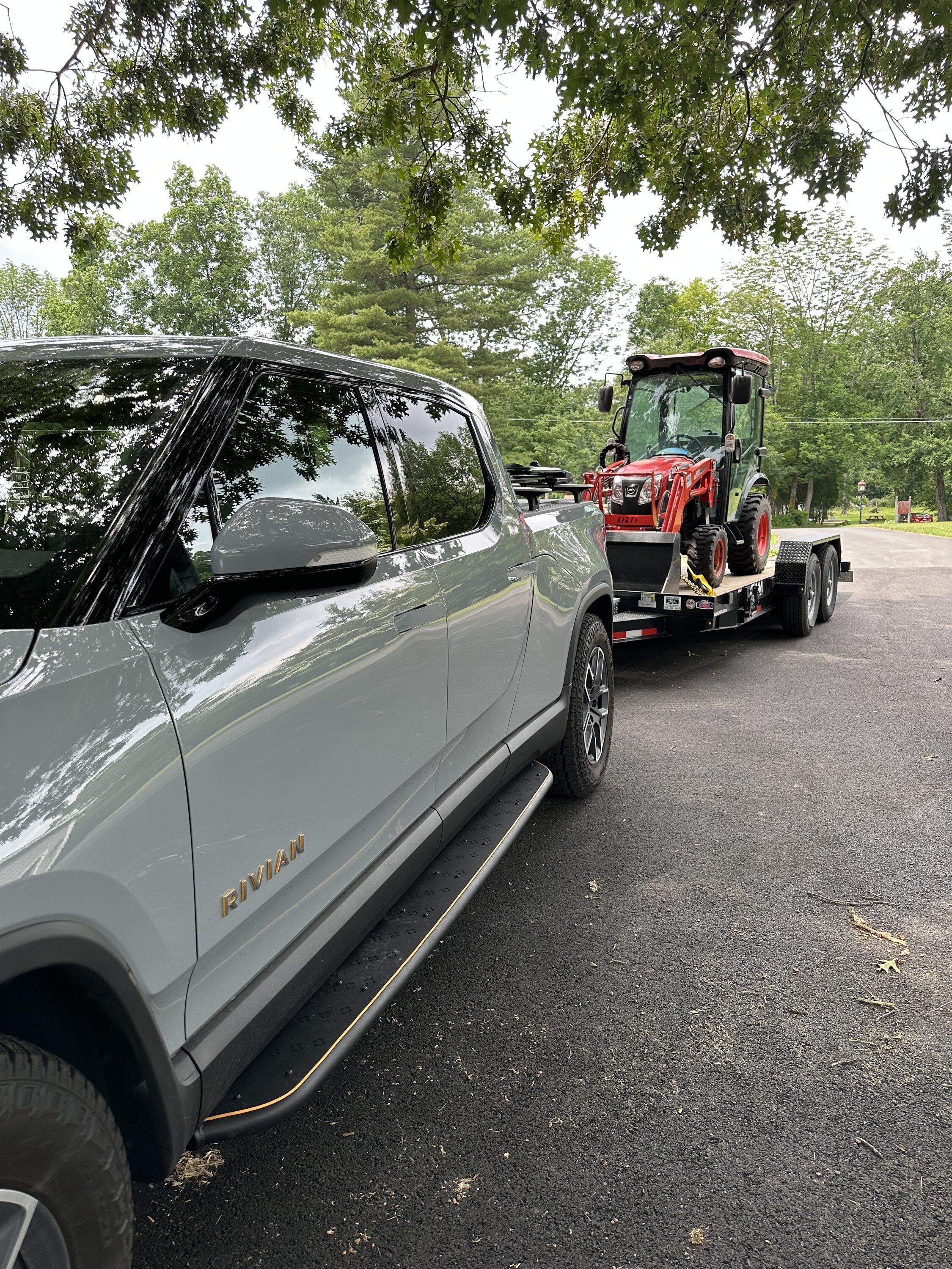

So the tractor was finally ready and I got a chance today to go pick it up. Here's some stats:
Weather was about 65F. Roads were wet with rain on and off, sometimes heavy but mostly just drizzly.
I charged to 100%, said 284 miles in all purpose. I drove no faster than 65mph on the highways, often slower with traffic.
As soon as I connected the trailer it said 142 in towing mode.
Drove 62.6 miles with empty trailer (3,000 lbs) and used 36.6kWh or ~27% of the pack. So that was 1.71 mi/kWh or 584 Wh/mile.
Truck claimed 72% charge left, 104 miles in towing mode.
Drove home with the full load (7,280 lbs) 61.6 miles (Rivian routing took me a slightly different route) and used 51.2 kWh or 38% of the pack. So that was 1.2 mi/kWh or 831 Wh/mile.
Ended up home with 30% range left, 82 miles in towing mode.
Charging fully plus managing the speed gave me a much more comfortable margin. I had a couple charging spots picked out but with the trailer i'd rather avoid them if possible.
Thanks for the tips people provided above.

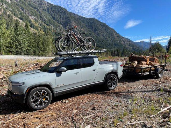

I'm pulling a 2 horse trailer and have taken to estimating that I get 50% range with both horses on board when planning any trip. I don't take them very far most of the time so it's not really an issue, but I'm always interested in hearing other towing experiences.

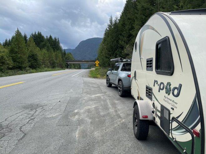

We recently completed a nice mini vacation towing our R-Pod over 1200 miles. This was our first trip and towing experience with our R1T (I have over 40k miles of towing experience between a 2010 XC90 and 2017 XC90 T8; Rivian replaced the 2017 sadly, would have been ideal if it replaced the 2010).
Mileage and range varied dramatically from as low as 90mi with an ending 12% SoC and as good as 160mi with quite a bit more buffer left. Throughout the trip we charged to 85%. Only our first leg leaving home was to 100% as I was trying to get us as far into the trip the first night to only need one DCFC charge stop before getting to our first camping site. On this trip I didn’t get a chance to properly weigh our totals. I estimate the R-Pod came in around 4000lbs for most of the trip as we traveled with full fresh water tank and enough gear for 3 of us plus pup. On another trip a 2 years ago with our XC90 T8 it was about 4300lbs for 5 of us plus pup - on that trip total weight was 10680lbs (Volvo was properly loaded too - 2 month 7100mile trip).
On the one leg half way through our first Rivian roadtrip where we got down to 12% SoC from 85% covering 89.8miles, was over mountain roads with mostly gentle elevation gain and also higher speed limit (70+). Both killers of range regardless of fuel. As I saw our range tanking from the originally expected 200mi (it creeped up at the start of the leg, easy going, slower speed and flat) I started slowing down to at first ~5mph below the speed limit and then ~10mph below. It helped and we arrived at our campsite where I quickly unhitched and drove 6 miles back into town to get a head start (fast charge) on the next day’s worth of exploring from our new base camp. That campsite only had 120v 30A outlets which would have been inadequate to the task of getting back up to 85% in one night.

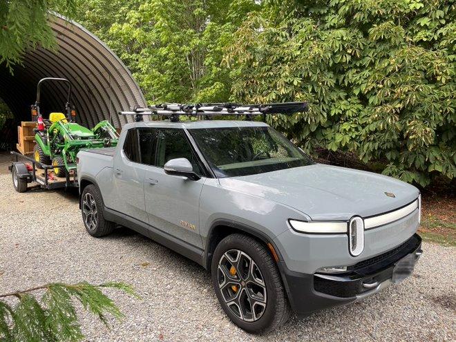

Since that first towing trip a couple of weeks ago I’ve logged quite a bit more towing miles with our Rivian. It’s quite good, in fact, it feels even smoother and more at home towing than without the load.
Rivian R1T R1S Tractor Hauling 3E02%21111986&authkey=%21AO_6PIQ4Q-qd_sU&width=660
Estimated trailer weight+load about 4000lbs.
BTW, @the_mace, nice choice on R1T ?, and love your CX2510. I wanted one so badly but in the end settled on the slightly smaller green flavored option which has turned out to be the perfect size and capability to get all tasks done at home.
Rivian R1T R1S Tractor Hauling 3E02%21111985&authkey=%21AIkJCzMQ3bSckLI&width=660
I’ve not weighed this setup, however, I’d estimate it at about 3700lbs.
