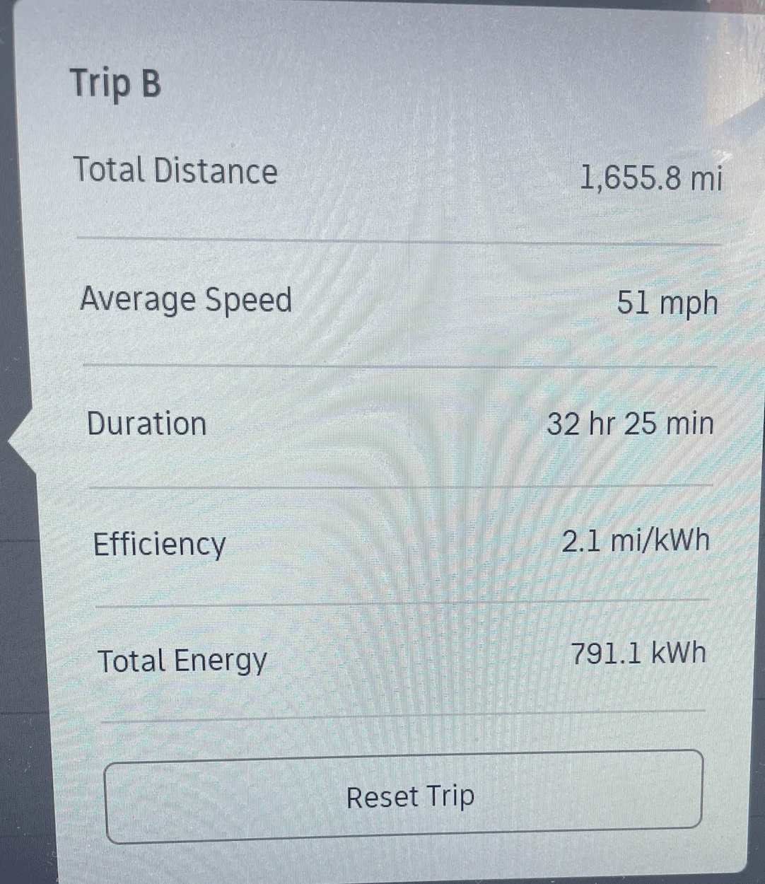

Here's the overall trip shot, all the highway driving was done in conserve mode on 20" ATs. I spent a total of $106 on all the charging for the trip.
Rivian R1T R1S Trip Report: Austin TX to Rosemary Beach FL Screen Shot 2023-07-09 at 3.42.25 PM
