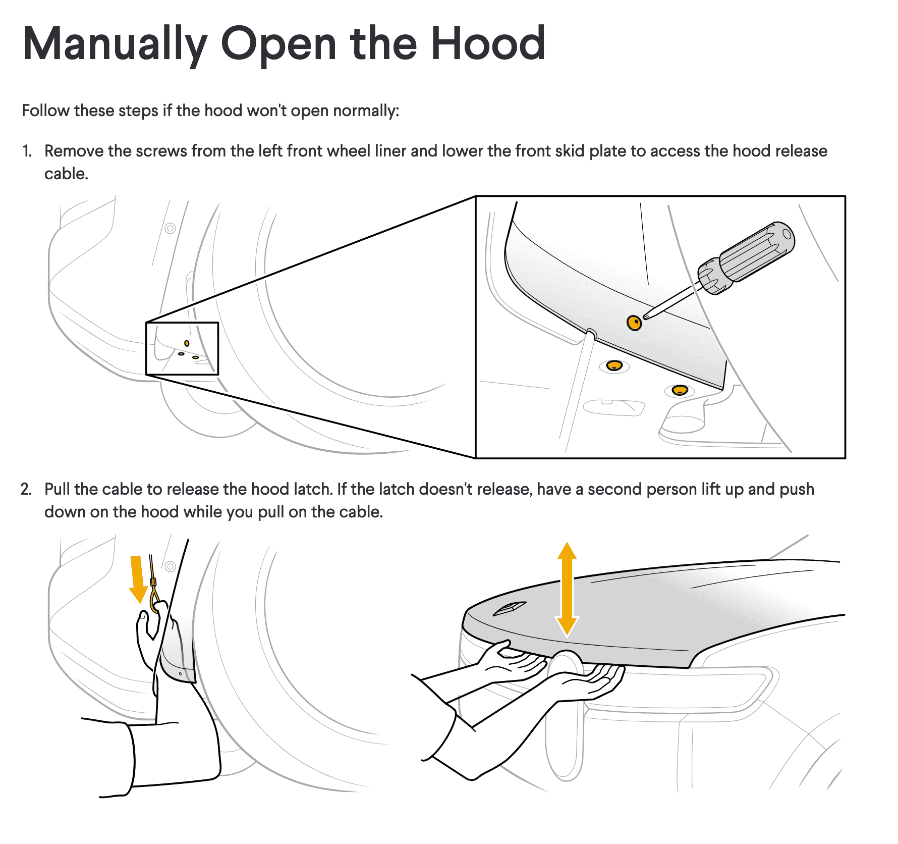

Is there a manual back up way to access frunk? Tunnel in case there's no power?For those of us who venture far from pavement and cell service, it may make sense to keep a fully charged compact jump battery with us if we are locking the vehicle. I could see getting annoyed with myself if I got back to the truck after a hike only to find that I couldn’t unlock it because of a low 12V battery while knowing there was a jump battery unreachable inside.
Edit: I just saw that you asked about the gear tunnel as well, I'm guessing no on this one. However, you can jump the 12V battery from behind the trailer hitch cover, so you probably would rarely be in a situation where you can't get in the vehicle at all that isn't catastrophic.Is there a manual back up way to access frunk? Tunnel in case there's no power?
Much obligedEdit: I just saw that you asked about the gear tunnel as well, I'm guessing no on this one. However, you can jump the 12V battery from behind the trailer hitch cover, so you probably would rarely be in a situation where you can't get in the vehicle at all that isn't catastrophic.
Yep, it's in the tow opertaor's guide (maybe the manual as well):
